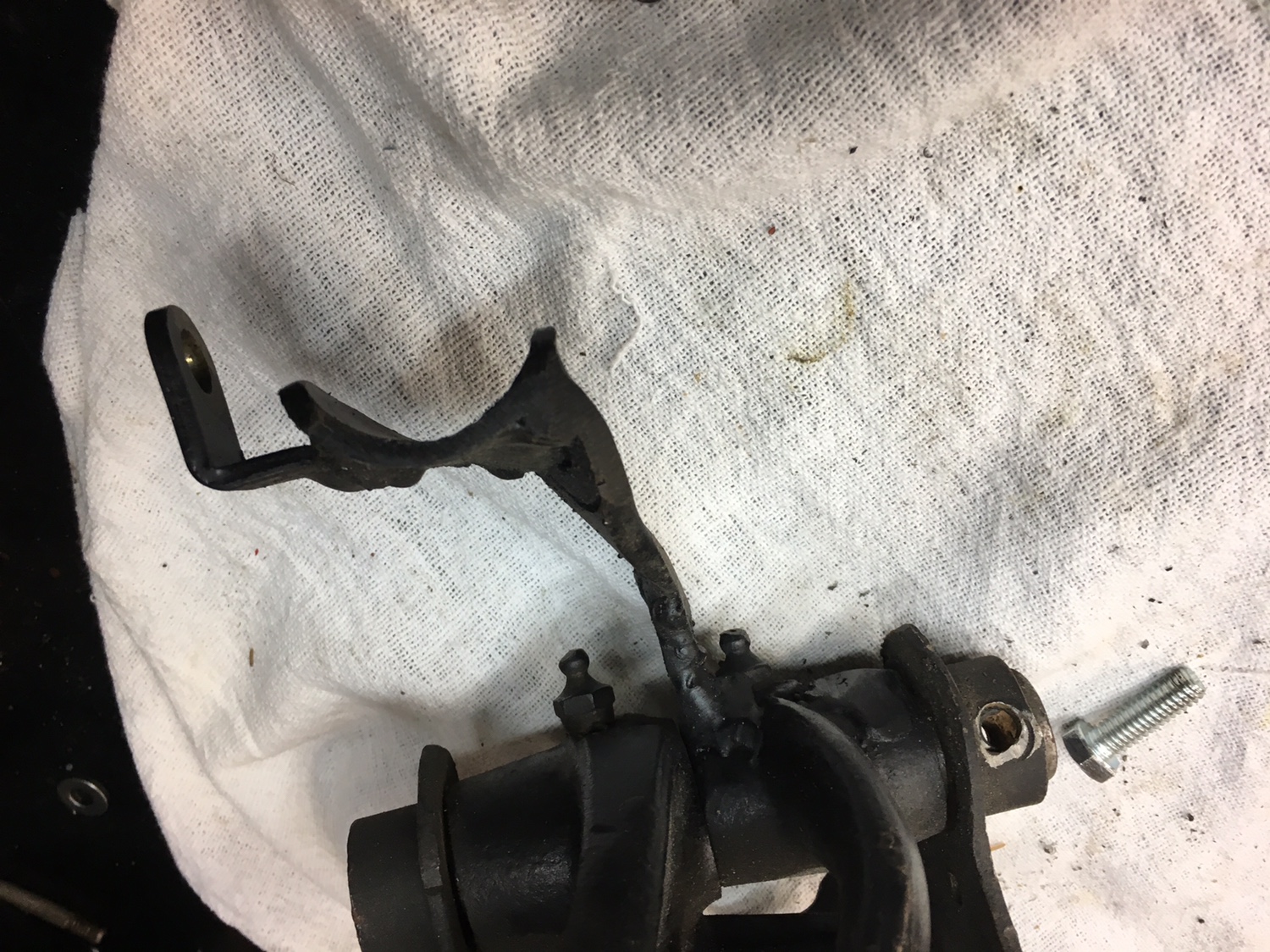

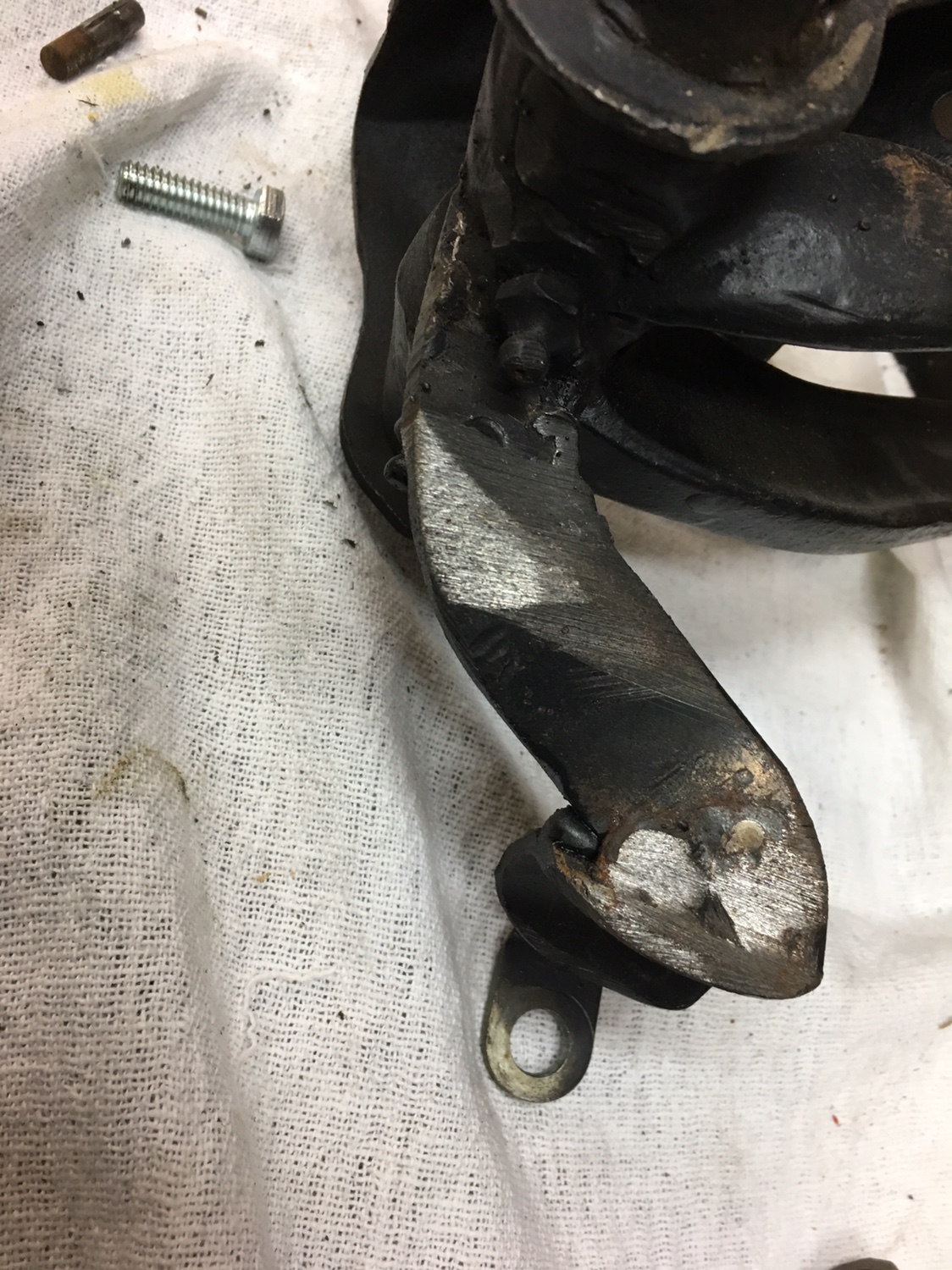

    [​IMG][​IMG][​IMG]
    Took these photos today of the brake pedal out of my friend John’s 34 coach. A so called Hot Rod Shop, who shall remain nameless, changed the brakes from mechanical to hydraulic. To accomplish this feat of engineering, they scabbed on some angle, chunk of tubing to clear the wishbone and some 1/8”x1” strap. Keeping in mind that it was welded by a blind person, would any of you stake your life on this modification? Didn’t think so. On the wall.

    The parent metal immediately adjacent to the weld is only 85% of it's original strength.

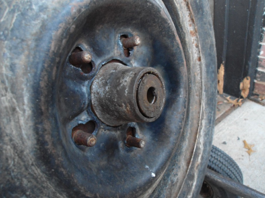

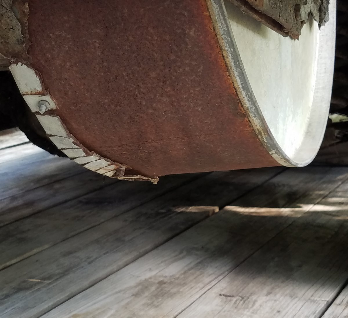

  6. I actually did this to a set of 4 dodge van donut spares to fit my 34 ford. They served to roll the car around the shop while building and transporting it on a trailer. I'm not proud.

    That's a little different than driving on the street.....sorta like using plywood discs for shop roll around wheels

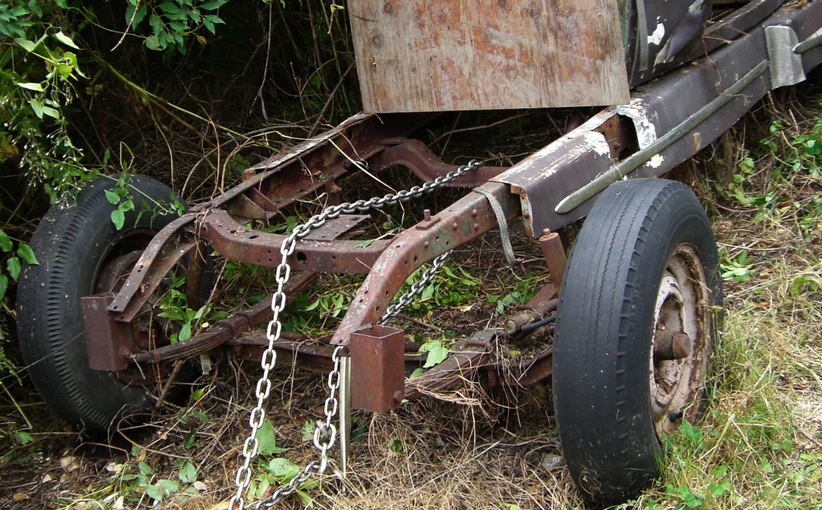

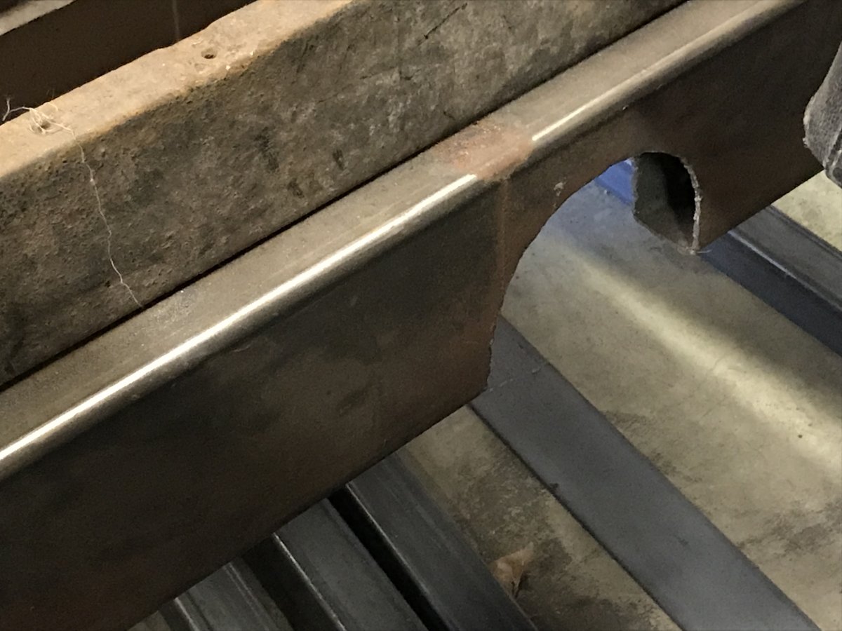

    The frame of my speedster, as originally found:
    For starters, we have the sqaure tubing welded to the frame horns as a DIY lift kit. But the crowning glory is the retro-fitted middle cross-member attached under the frame (and just barely--perhaps they were running low on acetylene). The only point of contact is the lower edge of the frame. Compounding the problem--sadly not visible--is that 6 inches of the left frame rail's lower edge were removed just ahead of this. This was done to accommodate an oversized steering box, and you could see where it had been flexing like crazy for a long time.
    I don't know whether this is Wall Worthy or just what they did in the day. Or both.

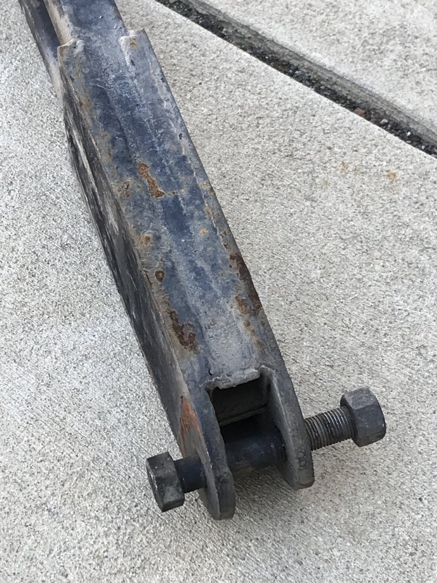

    After seeing some of the examples previously posted these don't seem all that bad but just the same.....

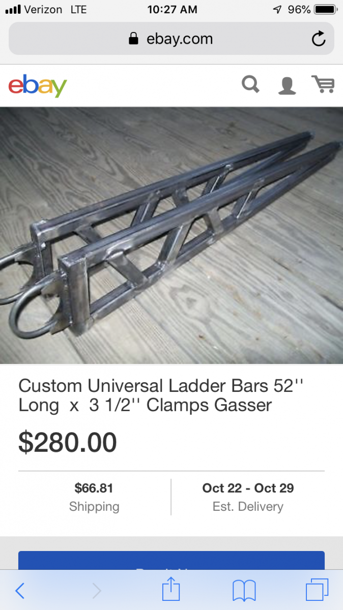

    The crude but presumably effective ladder bars from my Austin gasser. They did use "Supertanium" bolts though.
    The lovely trans crossmember and a 2 x 6 extra crossmember in my '33 pu. The frame was boxed with random pieces of 1/4" plate.

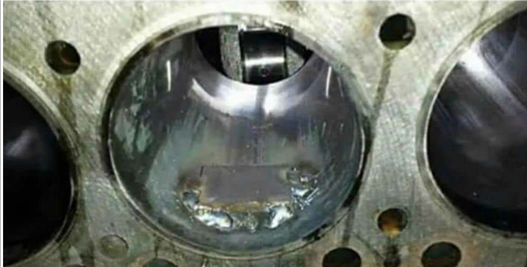

  20. Exhaust clamps are for exhaust.

    It's hard to believe someone invested time and materials on those, but then I feel that way about almost all of the "cartoon" rods some people are building these days. They would be better off spending the time and materials on something that actually works.
    But I may be wrong. They would be 'da bomb' painted yellow and bolted to the orange rear end in a jacked up 4 dr '59 Rambler station wagon gasser with clear coated rust and bolt-on spindle mount front wheels.

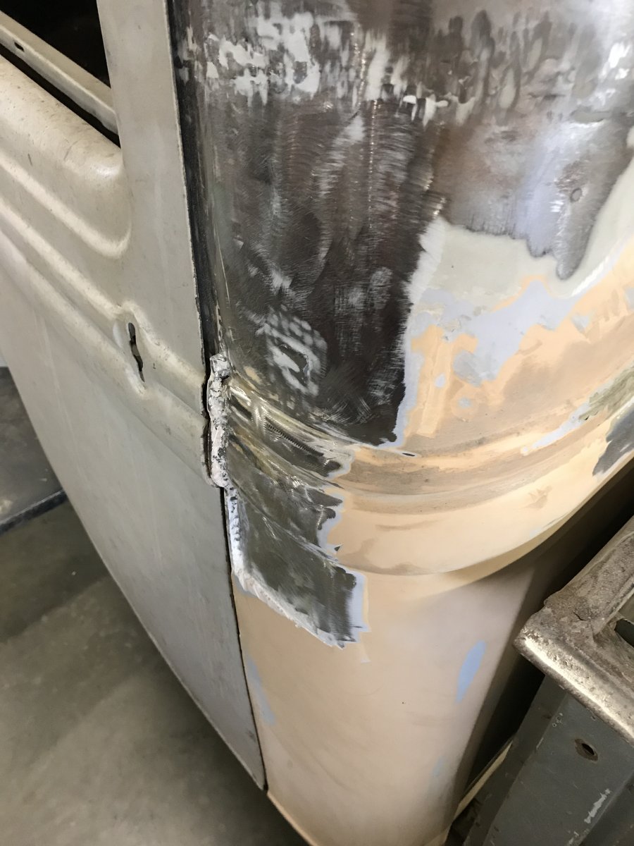

  23. Don't have a picture but you can just imagine. A friend called me up and asked if I could help another friend align the rumble lid on his Model A coupe. When I got there I was amazed. Both 1/4's were rusted out about 4 - 5" up from the bottom. Someone had "fixed" them with screen wire and about 1/2" of Bondo. The outside looked fair but :eek:. The opening was not square.
