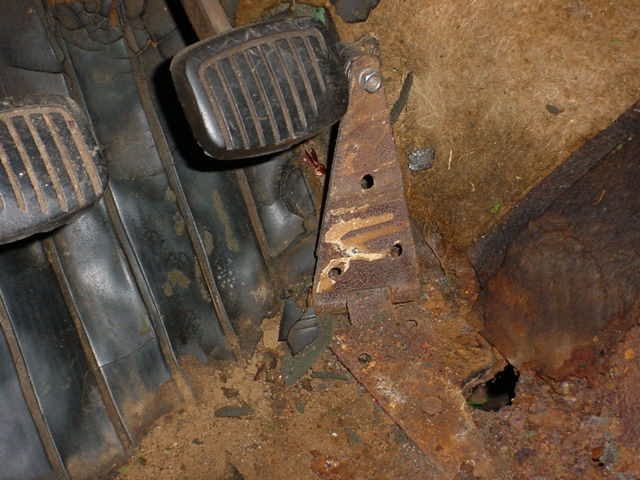

  5. How is this for a gas pedal, necessity is the mother of invention.
    My father-in-law was away on a fishing trip and the gas pedal broke while he was in Georgia being a creative sort he spied a old dilapidated barn any pulled a hinge of the door lying on the ground.
    Interestingly enough when we got the old wagon from him it still sported the same door hinge gas pedal, I still have it hanging on the wall in my old shop. HRP

  8. Initially I think that falls into good thinking on his part!;) After it falls into if it aint broke don't fix it.:rolleyes:
  9. True. HRP

    I don't know if I had heard the story behind that hinge gas pedal but when you posted that before I do recall thinking that was pretty ingeneous.
    I just hope there was an adequate return spring.

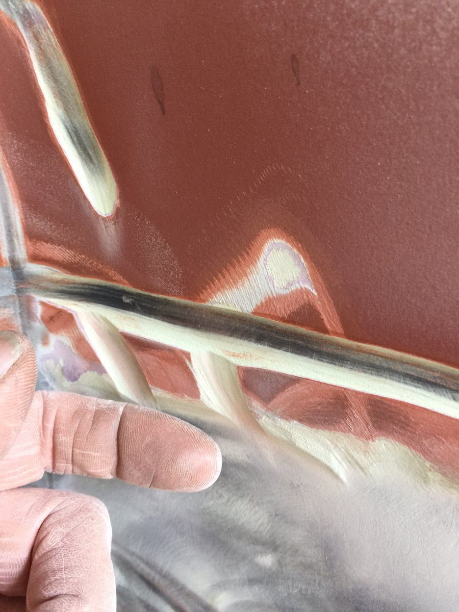

    This was on the same car. An extra inch of Bondo that didn't need to be there at all. Who the hell adds an inch of Bondo for no reason???

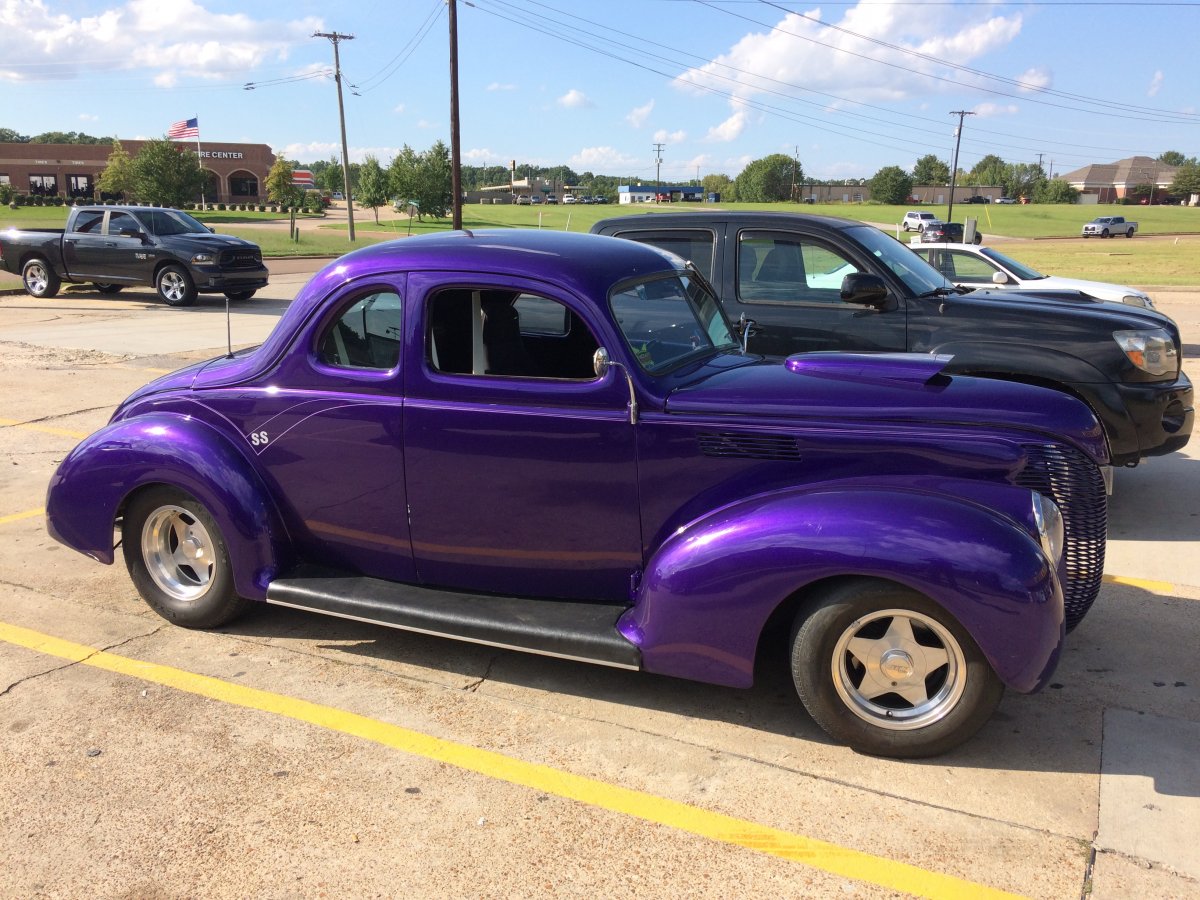

    AAB71217-846B-4AD4-8984-29FDC0028B30.jpeg I’d have to say this entire car... S10 chassis, 350/350, generic gauges in a piece hacked out of an old sign... he’s a friend of mine. His 36 was done right. This poor 39 though...

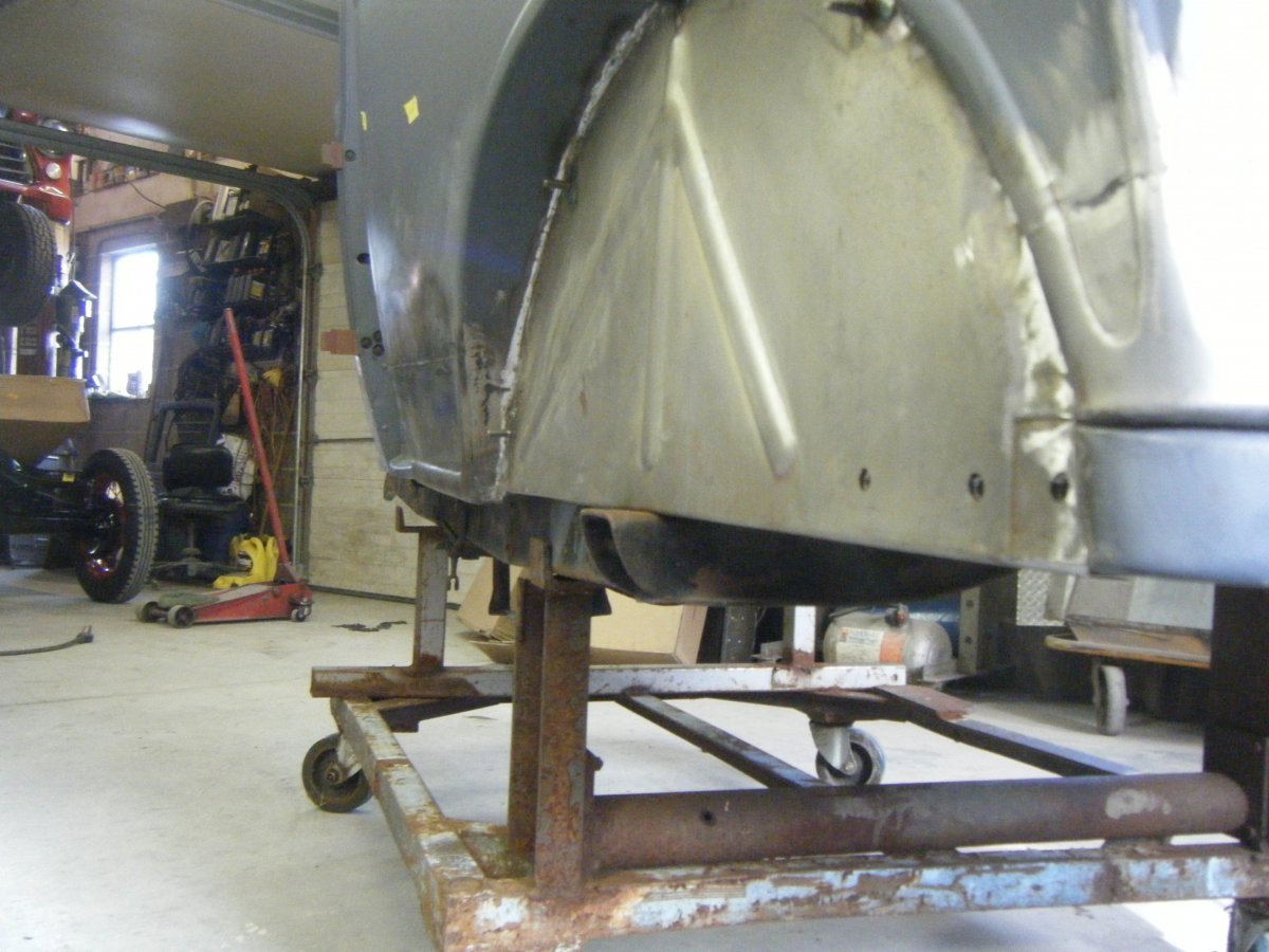

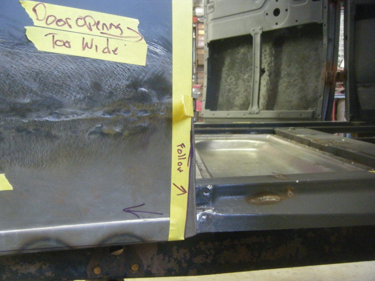

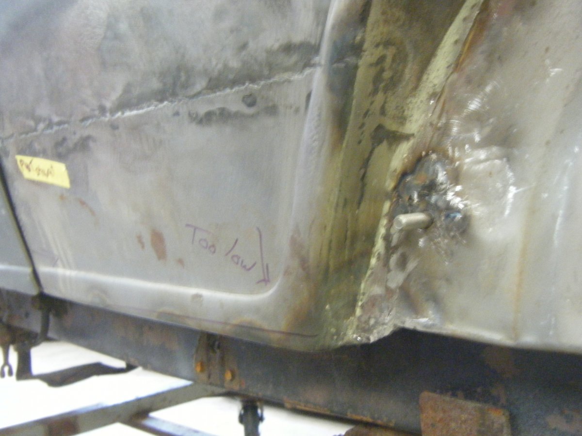

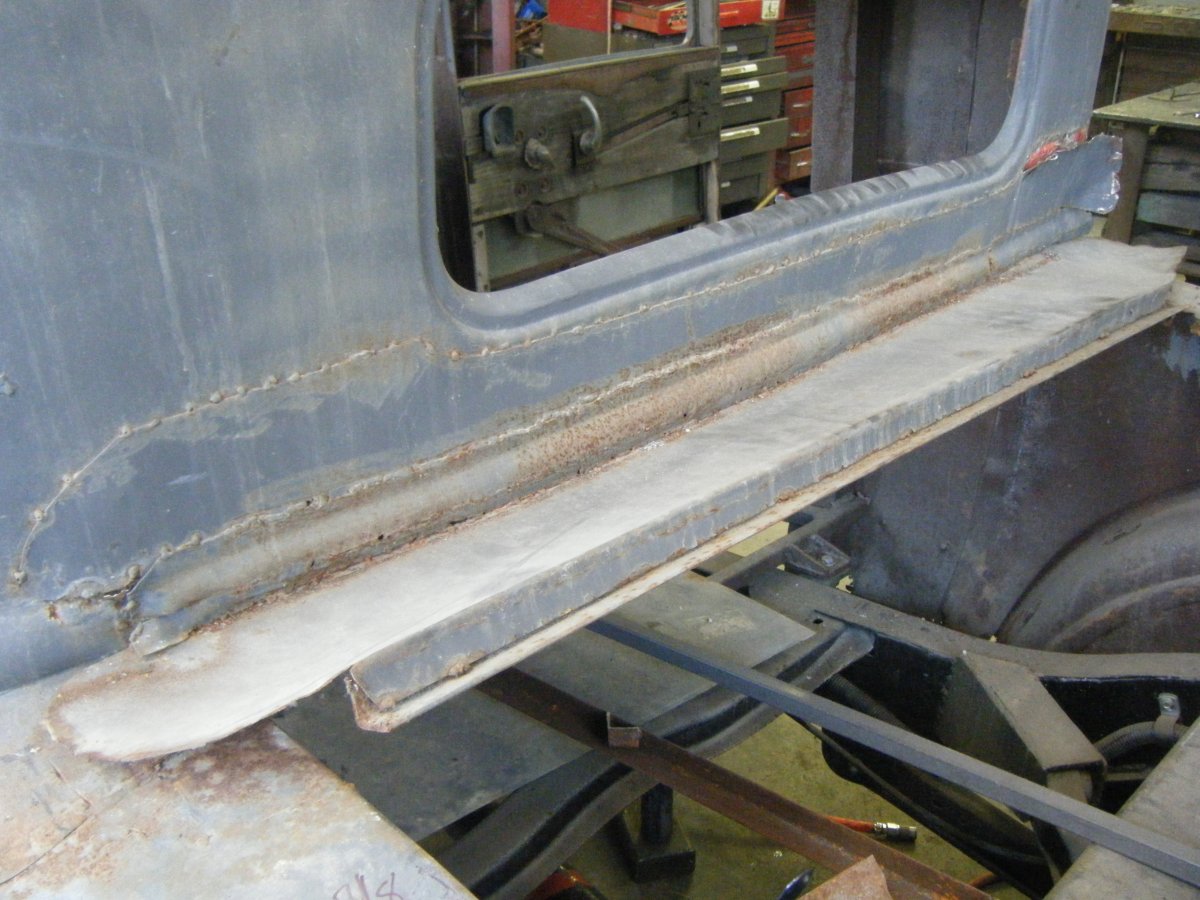

    a "professional" did this. check my notations. car was 17/32" longer on one side. panels were up to an inch off, door opening was 3/8" too wide at the bottom, wheel wells rotated. door jamb on one side was a 1/4" too low. nothing fit and they wanted me to paint it.....:rolleyes: DSCF0002.JPG DSCF0003.JPG DSCF0005.JPG DSCF0009.JPG
