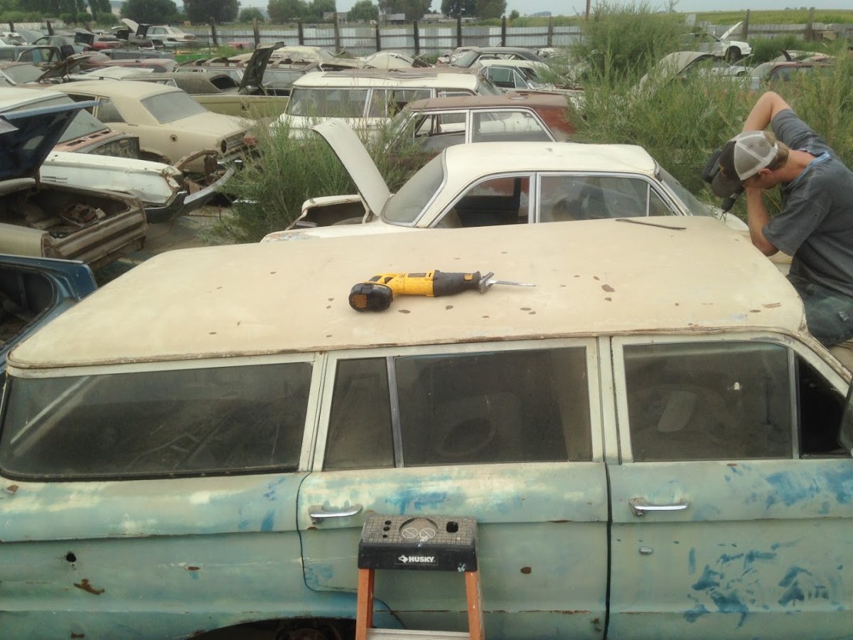

    [QUOTE
    Mike attacking with the Sawzall!!!
    [/QUOTE]
    WHERE...........on God's green earth did you find a junk yard with all those classics piled up like that??!
    WOW!
    WOW!
    6sally6[/QUOTE]
    Looks like Acme Auto wrecking to me?

  10. WHERE...........on God's green earth did you find a junk yard with all those classics piled up like that??!
    WOW!
    6sally6[/QUOTE]
    We're lucky enough to have this wrecking yard a couple miles from the shop. Without this it would've been way harder to pull this off.

    We're lucky enough to have this wrecking yard a couple miles from the shop. Without this it would've been way harder to pull this off.[/QUOTE]
    "Sunny Side Wash. must be on the east side of the Cascades?!

  17. "Sunny Side Wash. must be on the east side of the Cascades?!
    6sally6[/QUOTE]
    Yes, in the Lower Yakima Valley

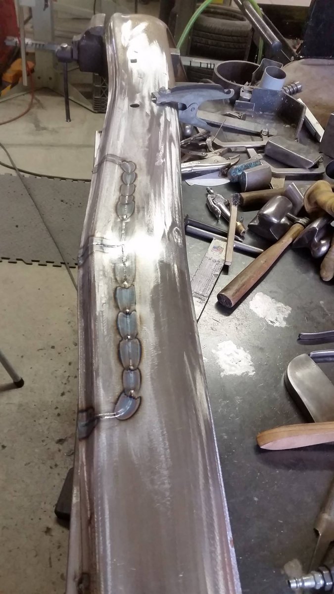

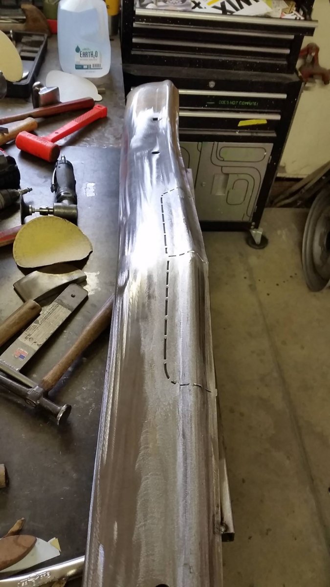

  18. Break from the "body mods" to shave the front bumper license plate depression. As performed by Mike!
    Start front.jpg 15369298_678326455682370_2436526045287701339_o.jpg front bumper welded.jpg front bumper smoothed.jpg 17157503_729124310602584_69863086196490698_o.jpg
    Outback, BigO, brEad and 30 others like this.
    Is that the yard close to the hwy heading into Yakima from I-84?
    We went to the 85 NW Nats, good gawd what a BUNCH of old tin, haven't been that way since, heard it was really being thinned out.

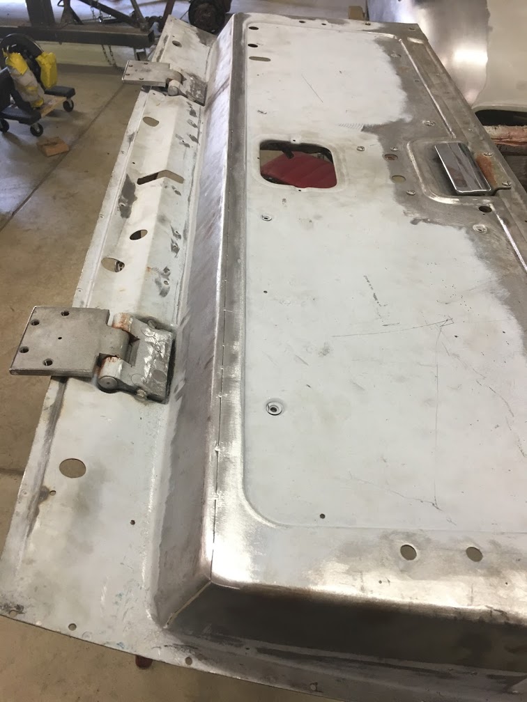

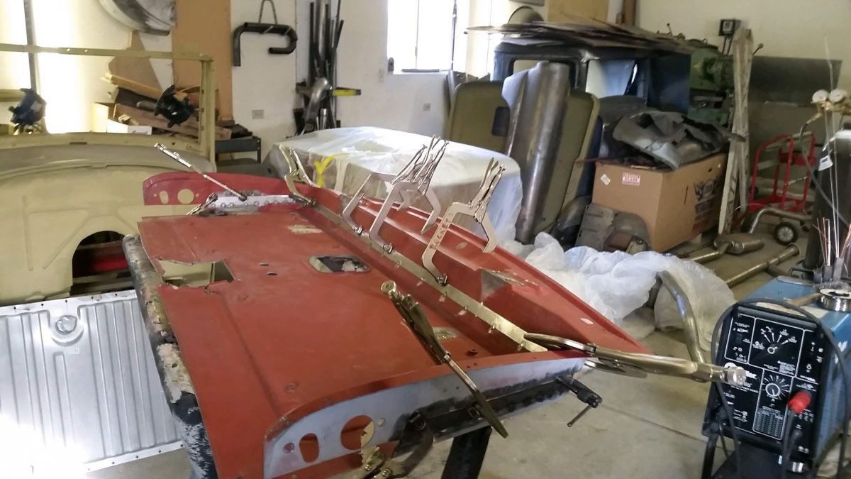

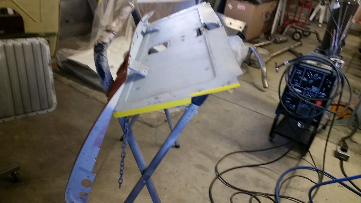

  30. Good morning. Continuing on with more tail gate modifications.
    We had to add a little over 1" to the "thickness" of the tail gate in preparation to add the roll down window mechanism & window tracks borrowed from the later Ford full size wagon.
    The top of the inner gate was changed using the narrowed portion of the later Ford wagon gate structure. We had to integrate the new latch handle to work with the stock '55 latches.
    We also figured out we needed to change the angle at the bottom due to the tailgate being leaned ahead.
