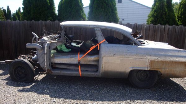

    We started with a basic '55 Ranch wagon I had bought for my wife & a pretty rough Crown Vic project car I found & couldn't pass up.

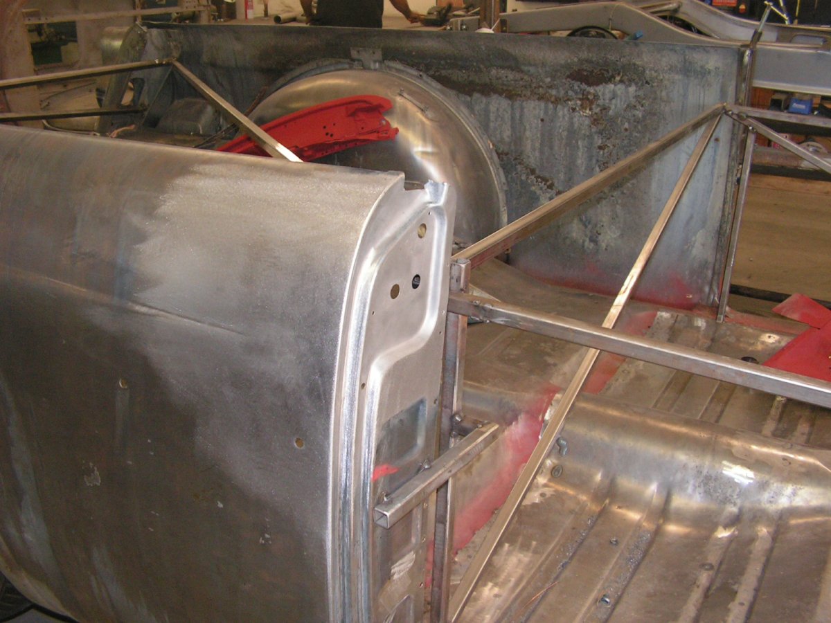

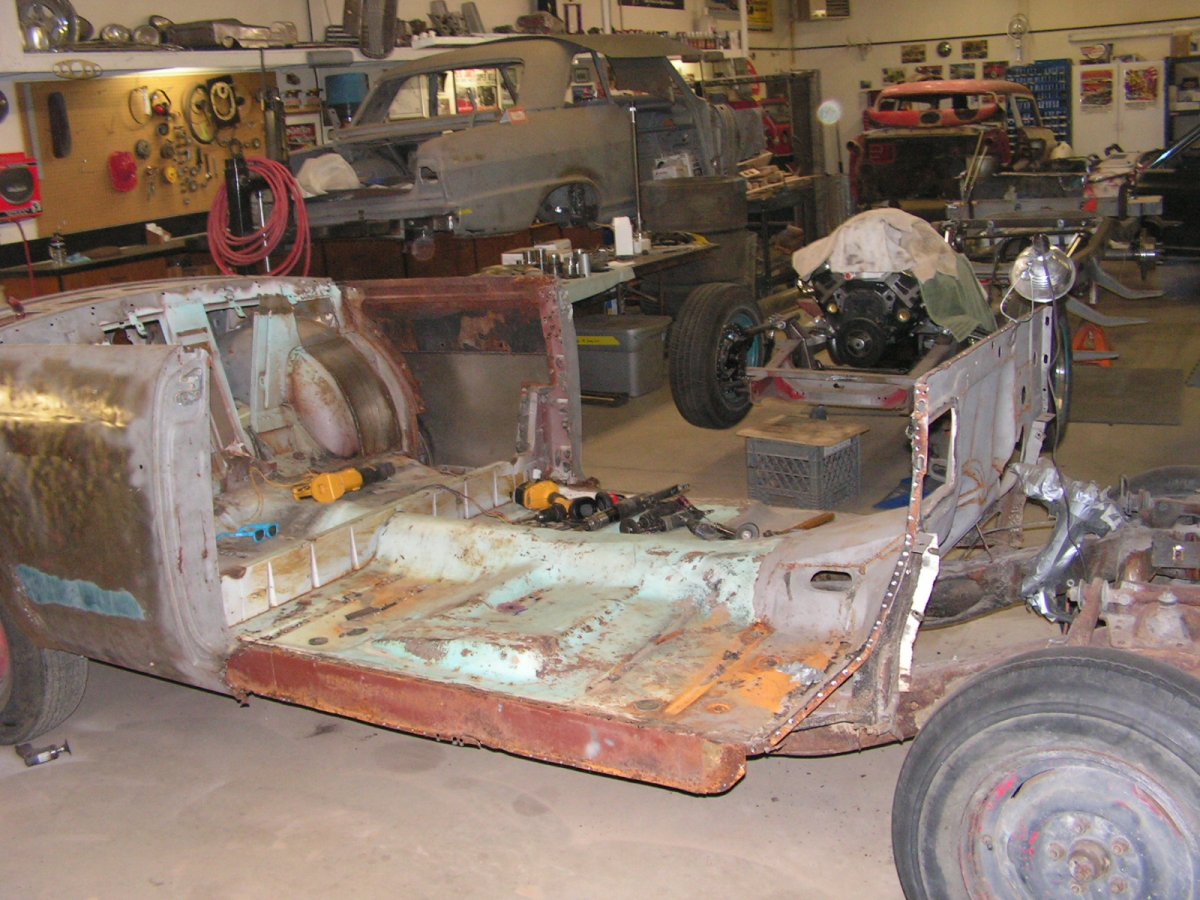

  13. For the sake of not making this thread to picture heavy I'll try to just touch on the good stuff & not bore with the rust repairs & junk like that. Tear down......
    We removed the Crown Vic top & relevant parts at the factory seams/plug-welds. In the front It was a matter of just swapping the cowl top and windshield frame due to the fact that the Crown Vic has somewhere in the neighborhood of a 2"-3" shorter windshield.
    The wagon body & parts we knew we where going to use was totally dissembled & dipped at Metal Works in Oregon.

  19. Next up was cutting the Ranch Wagon up!!!!! Well, before we replaced the front floor, rockers and filled some holes on the firewall & basically got the base of everything solid. Then mounted it on the chassis. You can also see we're running a Y block & had already started mocking that up.
    We thought we might be able to re-use the Wag. roof skin & drip rails so we carefully removed them before cutting off the roof. IMG_3959.JPG
    We discovered in order to use the Crown Vic B-pillars & hard top doors we needed to swap the tops of the door jams along with the structure.

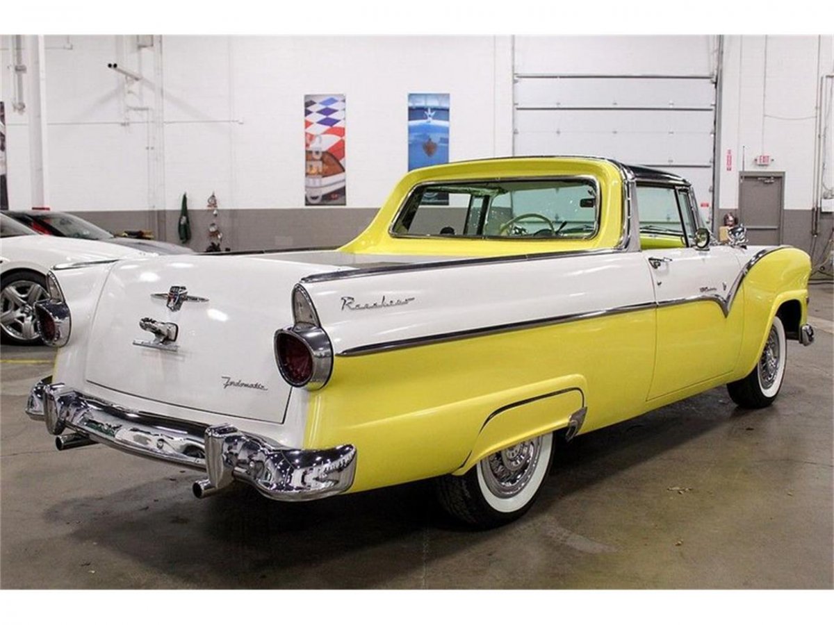

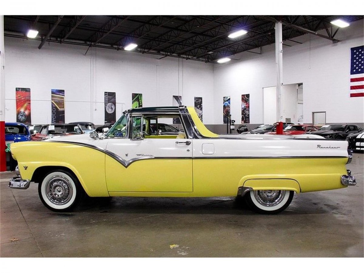

  25. It's been done. I stumbled on these doing research. Glass roof & Mopar taillights too!
