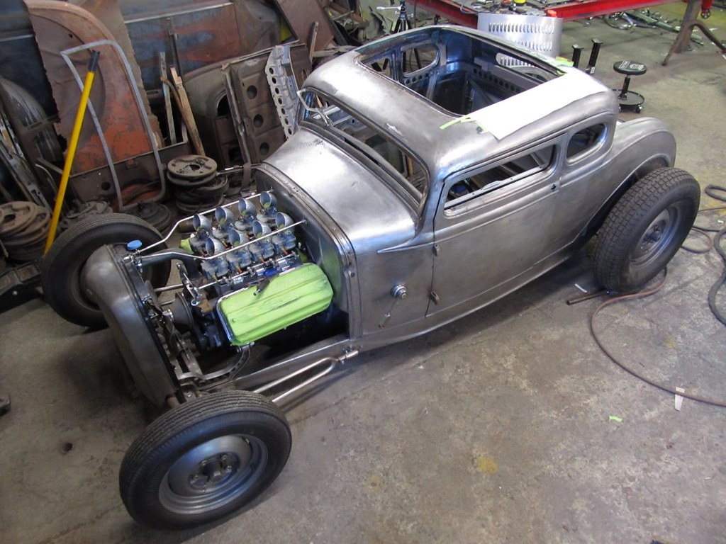

    Birds-eye view of the flange I'm making for the new top insert.

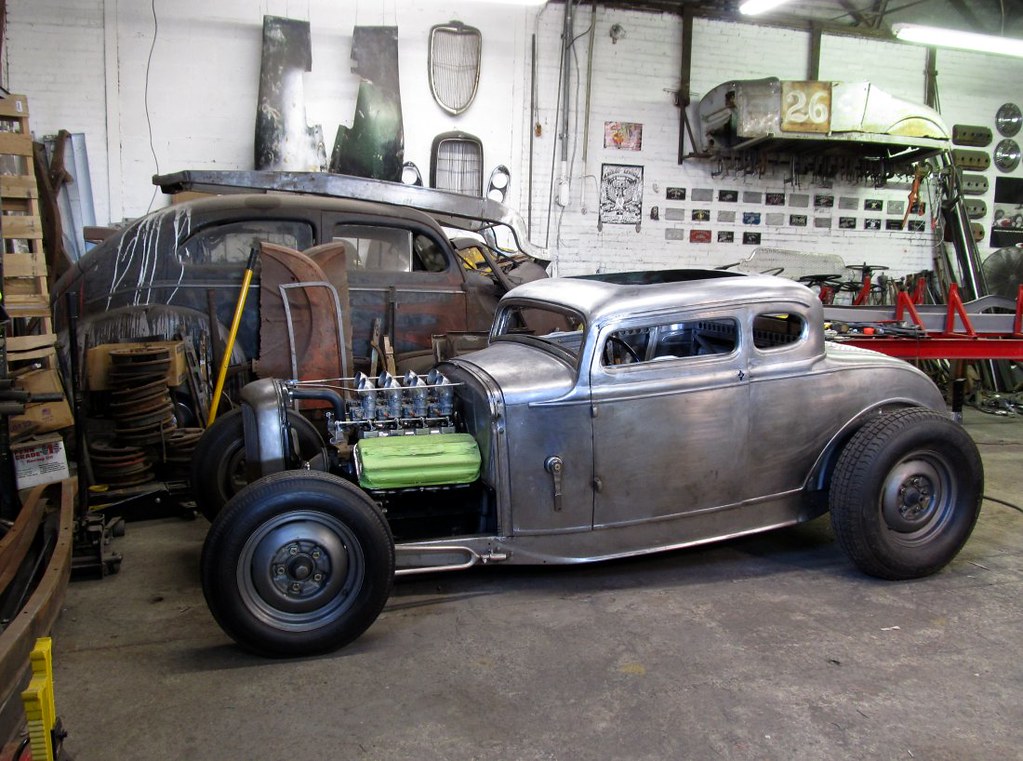

    I just finished up the top insert flange yesterday, and the car is now ready for the insert to be Dzus fastened in place. Here are some pictures of the process of making the new flange:
    Flange finished:
    '34 inner header structure re-installed:
    Finally, here's a shot of the finished roof profile (minus the insert). I'm happy with how it came out.
    Thanks again for all the good words, fellas.
    -Brian
