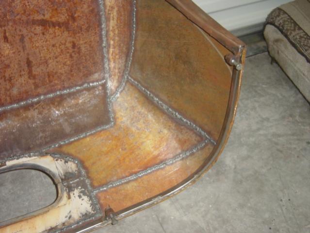

    Here are some more pics of the Hardtop.
    I didn't have a lot of Metalworking Tools at the time, so I made it out of sections that already roughly had the right shape.
    Or parts that were small enough that I could shape them with just a Hammer & Dolly.
    You can see lots of hammer marks on the inside of this piece...:D
    I already had bought my Beadroller, so I put a bead in the side
    ( when I built the car I didn't have one yet, so I made the Panels at home and brought them into work to put Beads & Breaks in them after workhours...)
    some more detail of the Driprail.
    And the Driprail wraps around the inside as well.
    To finish off the edge, and to protect my head from the sharp edges off where the roofskin attaches to the frame.
    More Info on this Thread...
    http://www.jalopyjournal.com/forum/showthread.php?t=11722
