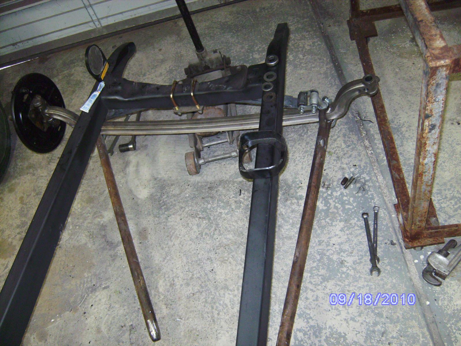

    Now I have 3 sets of wishbones,one which is TOTALLY useless,but the other two seem good.Now what I wondering is which set to use..? One set is 35 inches long and the bottom one is 45 inches long.Will it make a difference..? I will wait to hear from someone on this before I go any further.Man..I'm tired....LOL.

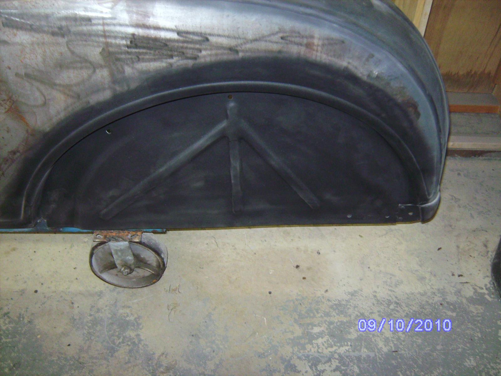

    I REALLY didnt want to spend all kinds of hours doing body work BUT you gotta do what ya gotta do.GRAB the cut off wheel and follow me ..!!!!Rear inner fender wells get it first.!! Hmmm..UPS is here..MY INNER fenders parts are here...!!!! After I made me cut I noticed something kinda off when I laid the new ones up there.It seems that the frame on a 30 coupe has a double contour to it....meaning the front of the inner has it and the rear BUT no so on the new ones.A call to Synders and I was told.." Well,thats the way there made and it is for a 30 coupe like you ordered."But its not going to work like that....hmmm...Ok..lets cut something...!!!Frame was in worse shape the I thought so time to make some repairs..! 4 hours later and both sides are fully repaired..!!
  10. lowongas
    Joined: Mar 8, 2009
    Posts: 282
    lowongas
    And this is what we get...after several more hours of trying to make the inners fit.!!!!!!!

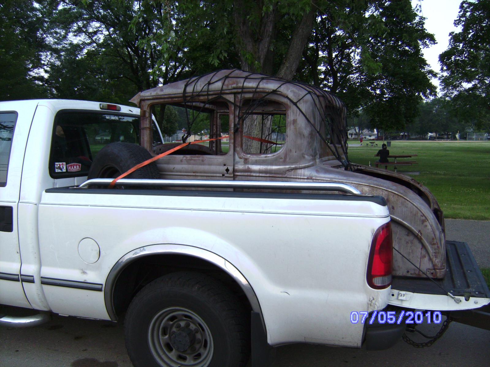

    THATS what was bothering me the WHOLE time I was making this deal...!There isnt anything for sale locally here in Michigan,and what you do find is WAY over priced...The gut who sold it to me took pictures in an interesting way as so not to show how much needed done...BUT..make do...There will be another coupe build..BUT I am going with a 28,29 as parts are MORE available for them then 30s.Cant even find full door skins for a 30 and BEFORE everyone says yes..NO there isnt.I called Macs,who told me to call Synders who told me to call Macs.I also called Mikes Affordables A parts and he doesnt have them either.And NO I wont deal with Howells,hell I cant even get them to answer there PHONE..!!The guy at Macs said.."If Synders say no,then its the truth". I told him I see them online...He said.." Those are 28/29 door skins,you will have to modify them to work..".I called Synders back and he said.."The guy who does the stamping for the 30 door skins isnt doing them anymore and getting out of it and is selling his dies,but wants WAY too much..".Oh well....

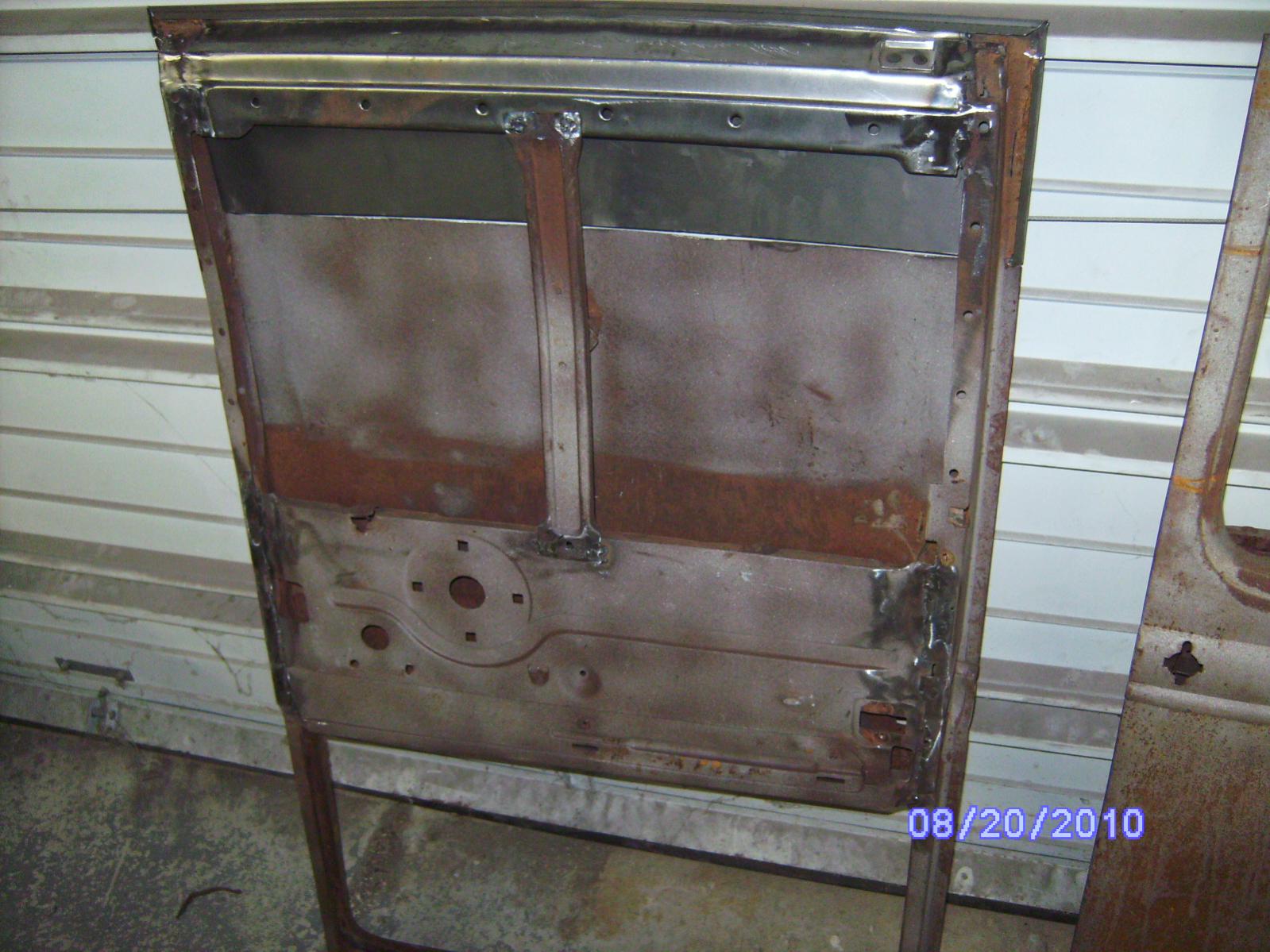

    Well it was time to try and tackle the doors..I dreaded this part.OK...The new inner door bottoms had gotten here a few days ago with the new lower door skins...and off we go..!! I cut the inner door bottoms off first and welded in the new ones..Hmm..nice fit..FOR once...!! Now you see in the pic how the center section of the door has been welded..?? Well the moron who decided to cut off the hinges must have thought that by standing on the center section of the door he could see how stupid he was...The WHOLE section was so crushed in it touched the front of the outer skin.I had to cut the center section out and spent a few hours trying to make it fit back and then re-welded it back inside the door..NOW to the outside skins...!! And looky ma....

  17. If you can use longer ones, they will have less angle to travel thru when articulated, so less stress on the parts. They may not look right with your overall build though, or where you have to attach them to get the correct axle caster.
  18. Antny
    Joined: Aug 19, 2009
    Posts: 1,071
    Antny
    from Noo Yawk
    I've purchased patch panels from Howells recently for my '33. I received them quickly, and they are very nice.
  19. x2....But there's more to it than that!
    The first worry about length comes from spring travel vs. pivot. The longer the pivot (wishbones in this case), the less caster change when the spring loads and unloads.
    Just imagine using a 6" wishbone and then compressing the spring....that'll give you the hyper exaggerated version of what I'm talking about...using shorter wishbones.
    With the lengths you showed, it's not going to make that much of a difference. however,
    Second thing is steering, if you're using cross steering it's not an issue....but with a push/pull set up, the wishbone pivot point(where it attaches to the frame), combined with the draglink angle have to be considered together. If not set up correctly, when the suspension moves up and down in the front, the wishbones will move differently than your draglink, causing bumpsteer. There are lots of creative ways to make it right on any given build, but you gotta do some homework on steering geometry if you plan on building this thing yourself.
    Bottom line is, you can't have the movement of your wishbones binding up with the movement of your draglink when your suspension is going up and down. If it's not set up bind free, If you're holding your steering wheel tight and you go over a big bump, the binding force will turn your wheels because they are free to move.

    Yeah I am going. with cross steering.Eric form Riley said the best was using a Vega box.I have a saginaw 525 sitting on the shelf so thats what I will probaly use.I won an auction today for my dropped steering arms and there on there way.I forgot to order my lower shock mounts so off to Speedway to use my credit and they were free too.Got my rear end today from a 1993 Ford Ranger,8.8.DAMN nice and clean.The 66 Mustang one I bought was totaled inside so off to the scrap yard for that one.The guy I got the Ranger rear end from even said 8 inch stuff is getting hard to find and getting expensive.
  22. I'm not sure that those bolt on lower shock mounts are gonna work for you with those bigger wishbones. If I'm correct, they're the same ones that I'm using....37-41. The aftermarket perch pins weren't long enough for me to use the bolt on things... I ended up fabricating mounts on the inside of the bones, about 4 inches back from the axle.
    Just mentioning it...you might be fine!

    HOLY CRAP..you guys are right..I CANT use those thicker wishbones DAMN IT.!! I checked it out after reading what you guys said and yepper...Perch bolts arent long enough.Hmmm....Dubbzilla..got a pick of how or what you made for shock mounts...?
  24. I don't, but I'll take one for you. I hacked some welder series brackets...used the top parts for the frame mount and the bottom parts for the lower shock mounts. Here's a pic of the brackets in the mean time. It's actually a 4 link batwing axle brackety thing. But I like the look better than their actual shock mount brackets.
    I'll get you pics later this week of how I did it. Let your imagination run wild till then! haha

  29. I used Magnum deep drop, forged steering arms, made to take a tie-rod end. Puts the tie-rod under your wishbones, should work for your application no problem at all!
    I got the photos of the shock mounts I made up using those tabs. As you can see, the way I cut the tabs, I ended up with a bit of a gap to weld up on a small portion of the lower shock mounts. Not a big deal.
    Everything is still tacked, and I plan on adding a small gusset to the top and bottom mounts. You can do whatever you like. I like how the bracket has that little notch that sits so nice on the top of the framerail.
    -Steve
