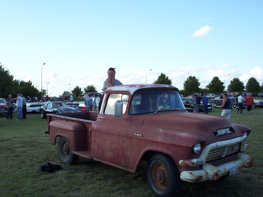

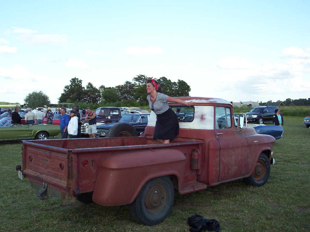

    is this a all chevy tread? is gmc engines questions wellcome here?
    i have a 1957 gmc 270 4-speed,i drive it almost every day in summer .i like the engine and is there any aftermarket parts for this engine,i want to build a spare engine with extra hp and strength.
    ken sweden
