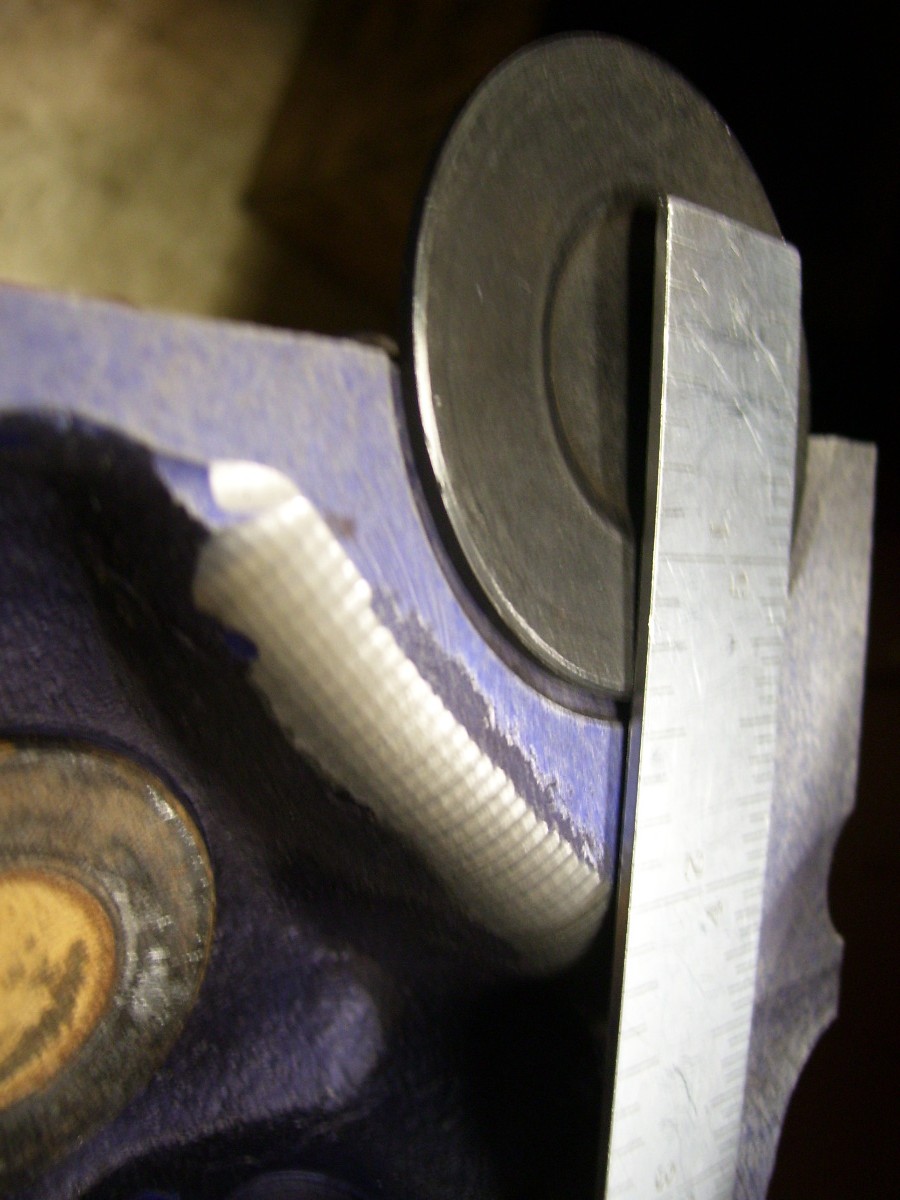

    In the article linked above it is stated that milling 1/8" off the 261 head was equivalent to removing .030" from the higher compression 848 head so one needs to be certain of what they are starting with. Recessing the intake valves enlarges the combustion chamber which is completly opposite of what is desired by milling the head reducing benefit. I have spent a great many hours digitizing, sectioning, chamber shaping, porting, and flow bench testing this head and continue to collect data.

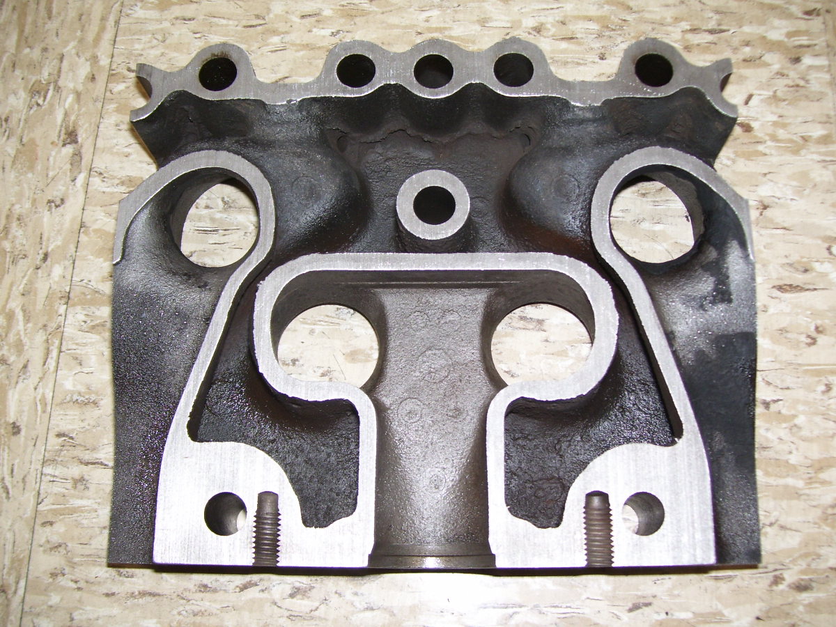

    Yup. And if you actually want them to do something useful and intersect the jacket drill them at 12 degrees from the face like GM did.

    Picture #4 in Curt B's post should be studied real close to get the most out of these heads.
    If you use the 848 head on a 261 and move it you also need to move the location of the steam holes to match.
    Always use a pair of head bolts with the heads cut off or some long studs to align the head and gasket on installation and push the them to the driver side even on a stock rebuild for best results. There are no dowel pins in these motors for head and gasket placement.
