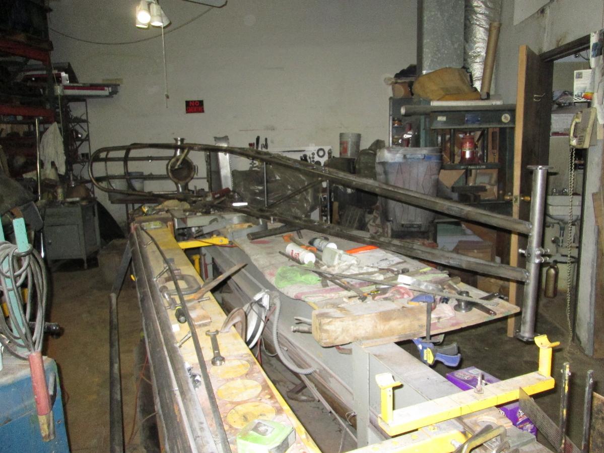

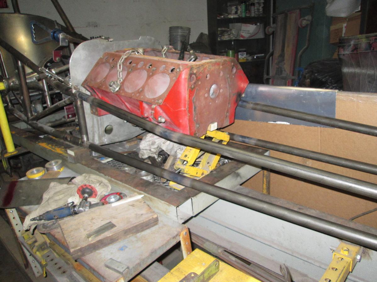

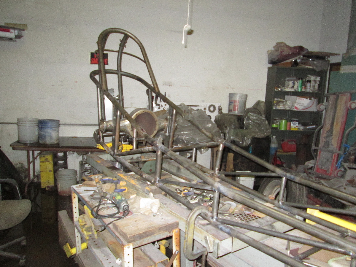

    Just after the drag geezers Reunion last year(2012) I had to put my dragster roll cage up on a rack so I could work on customers projects. I didn't want it to stay up for a complete year so I pulled it down this week end and put it back on the big chassis table. Today I went down and aligned it close to straight . I assembled the clutch can and bolted it all to a block. My wife and I rolled it to the chassis and clamped the fire wall to the all ready tacked on tabs. I was just about to go home and started sticking the front rail tubes in and heated them to pull close to the correct bends. I have to build a new torsion bar tube as I sold the one I had for this car.

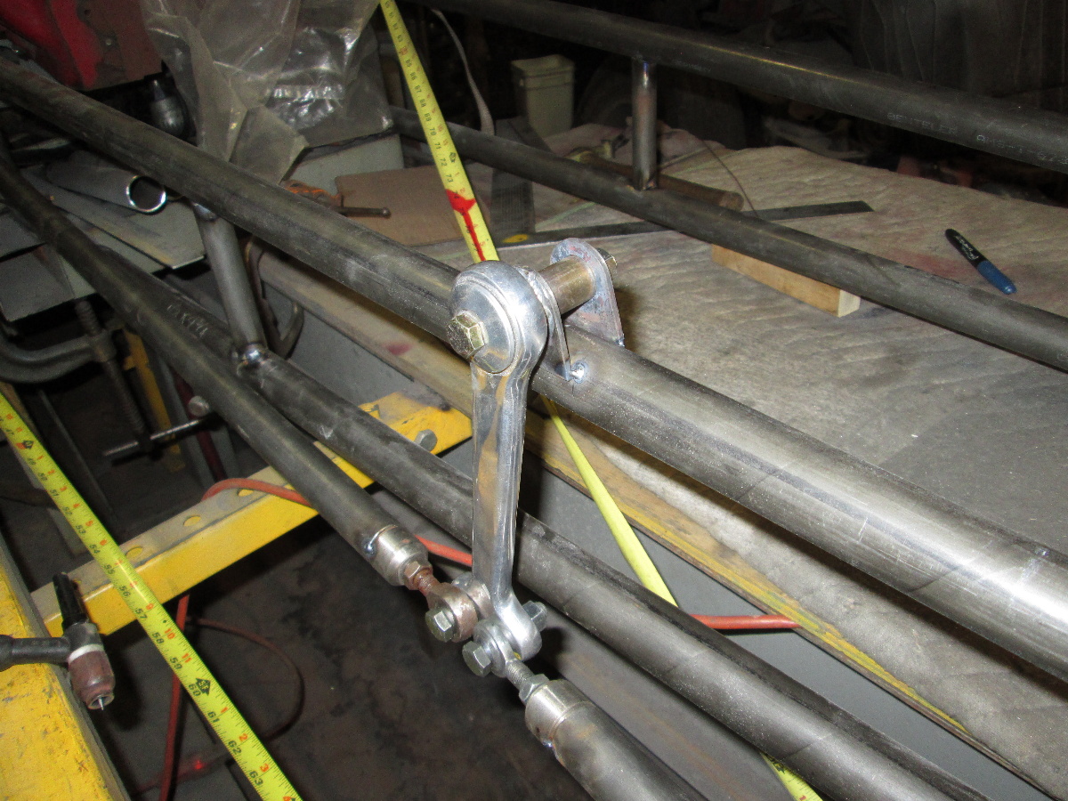

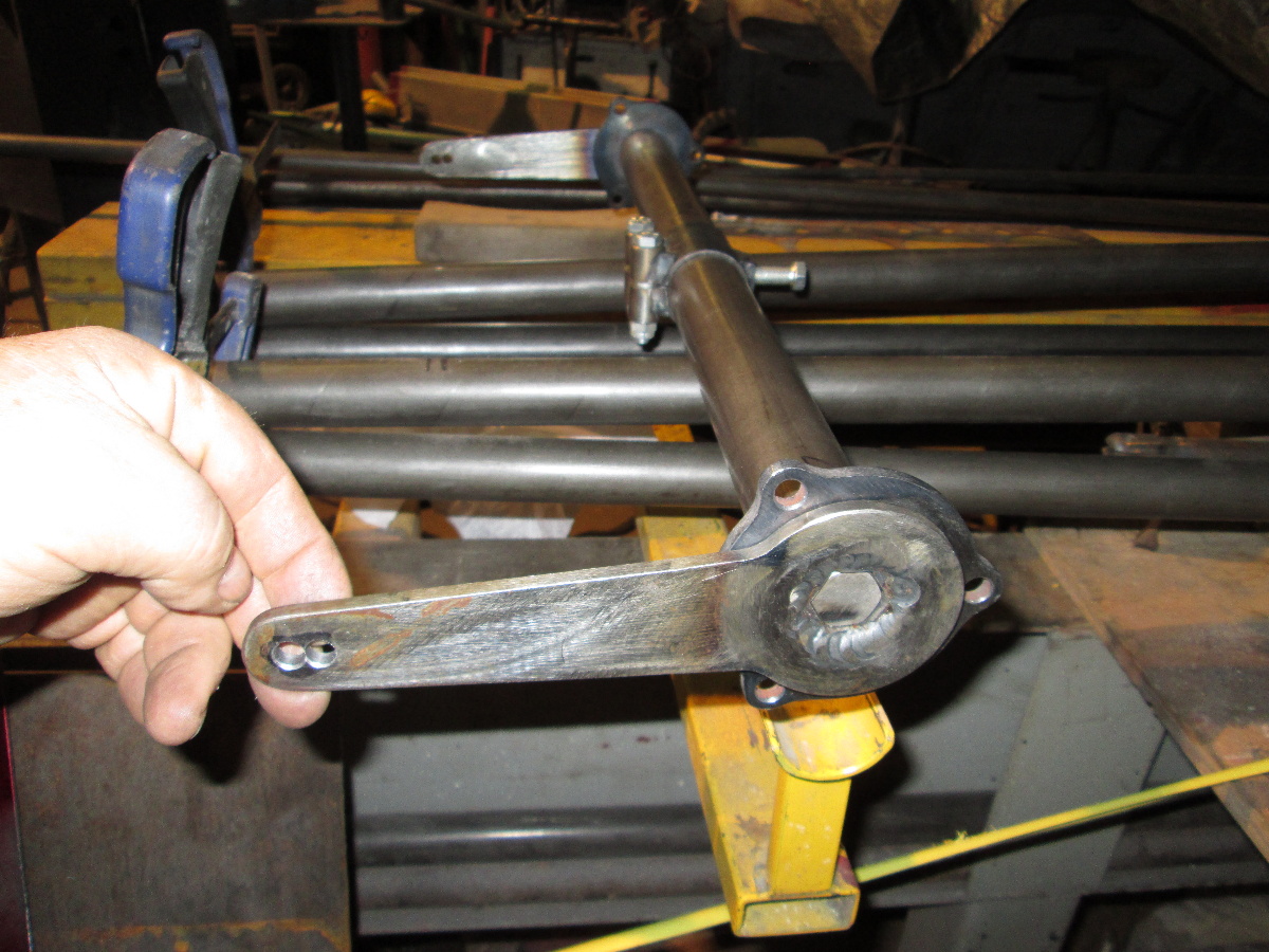

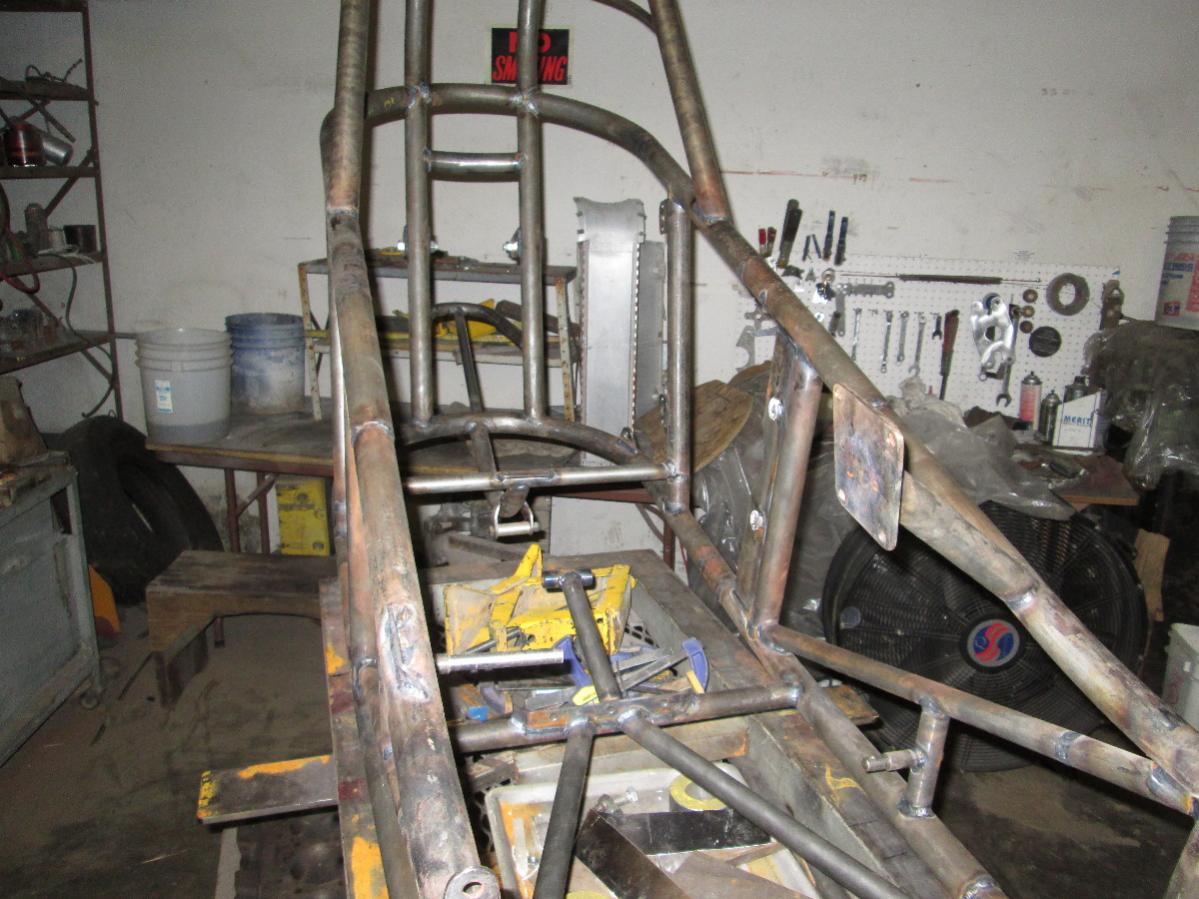

    We had freezing rain and ice her in Dallas this weekend. But I still got my new torsion bar built Saturday and trimmed the main rails off then fit the cross member and tack welded it. As I was going home I set up the front axle and one radius rod for a look.

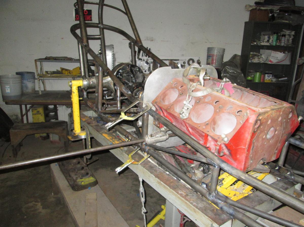

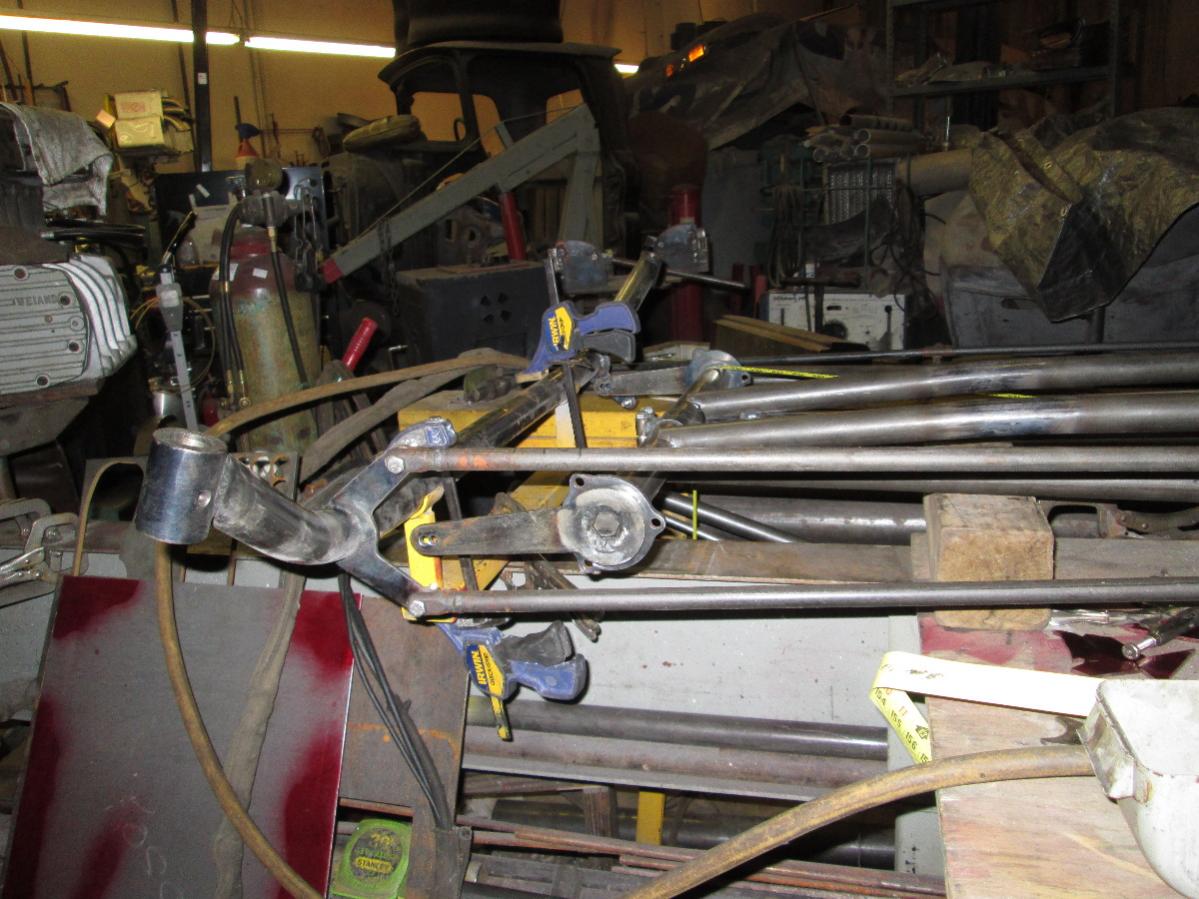

    I made a mount for the aluminum idler arm, which I built two years ago. then I cut and tacked up the two drag links for steering. The next few days I fit all the uprights and diagonals along with two cross members and one diagonal.

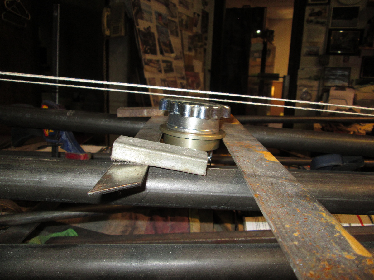

    Our original body had a recessed groove the full length of the nose and up the cowl. To plot the lay out of the groove I bent sheet metal strips to the front and rear shapes and pulled string lines down front to rear. This allowed me to see where the fuel tank filler cap could be and make sure the body would clear it. The tank will be flush with the top rail and about 38" long, to hold four plus gallons of Nitro. Today I planed the complete body and deturmined that I will need three sheets of .040" aluminum to form up the body.

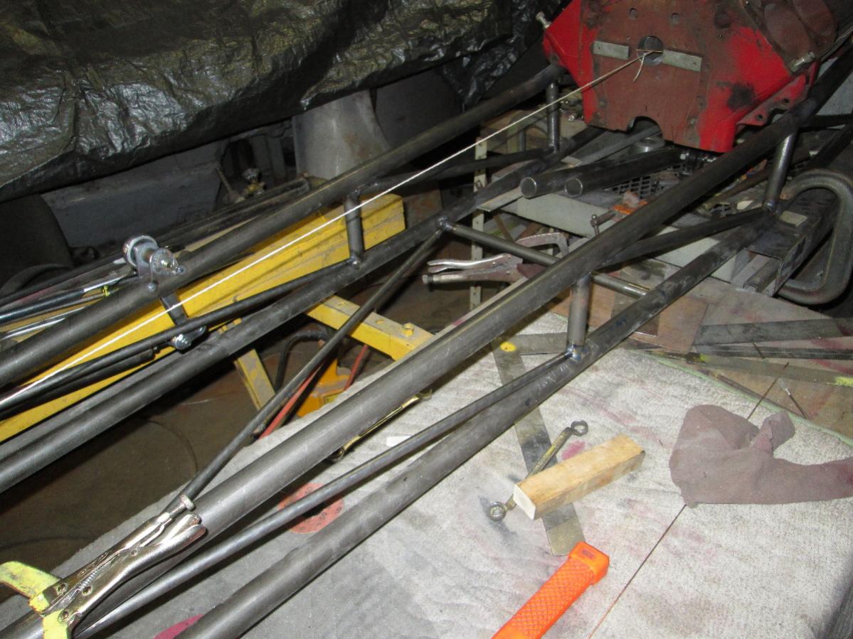

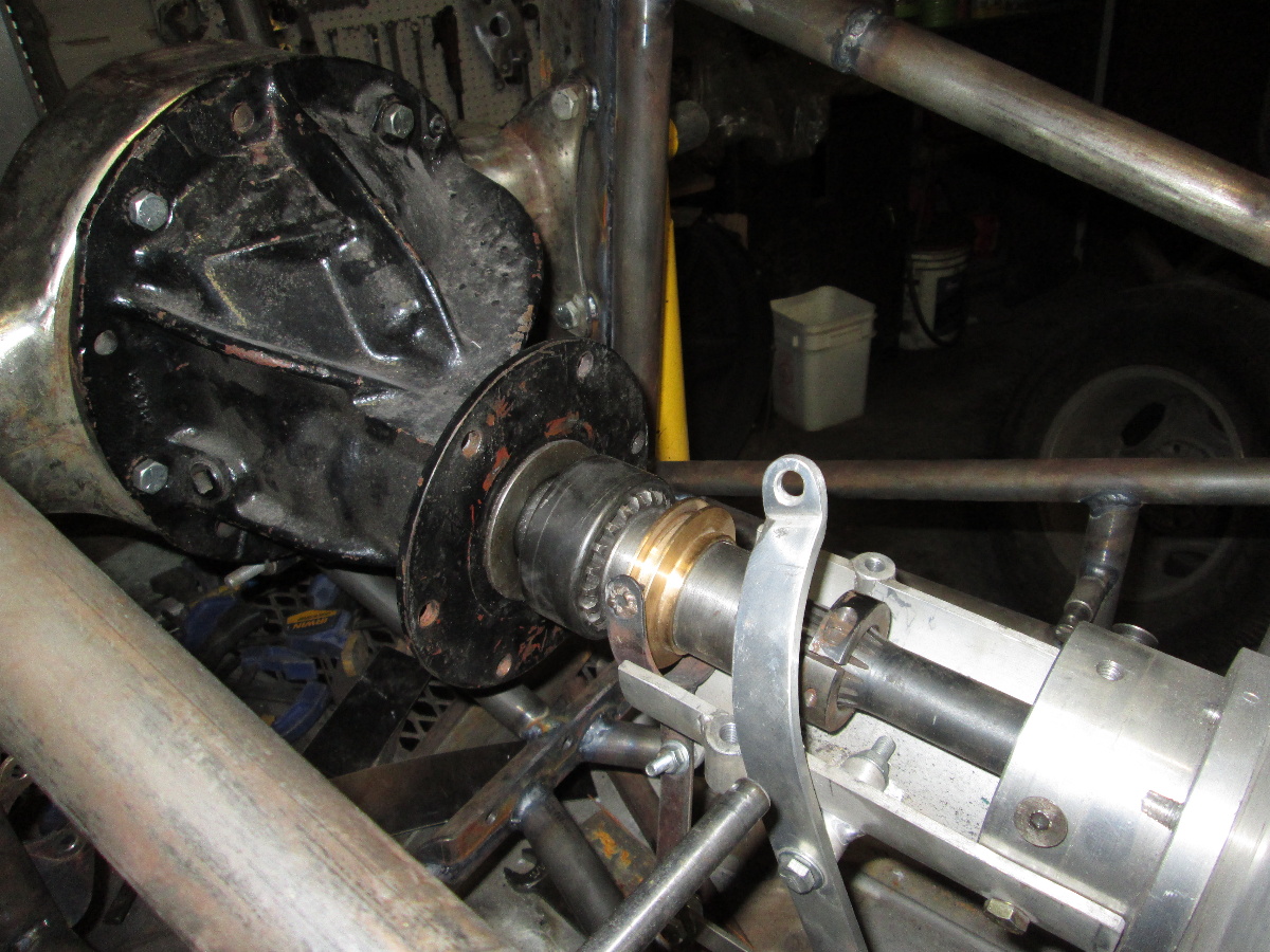

    The last two weeks have been filled with customers work in the day time. Then I would weld some on the chassis after 5:00. I added two more short uprights near the front. Then added 1" round "K" member behind the clutch can and a anti rotation tube under the rear end. There was already two tabs there so I used them. Now today I slipped the rear end and dummy block back in to fit the front motor mount tabs and make the coupler work easily.
