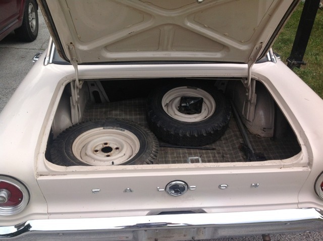

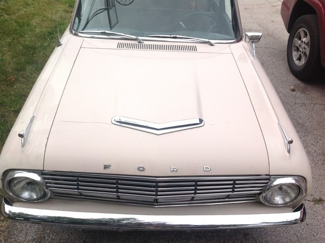

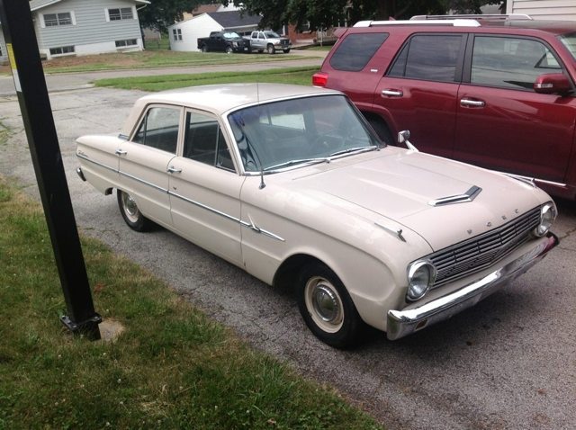

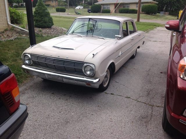

    Anyway here are some pics.

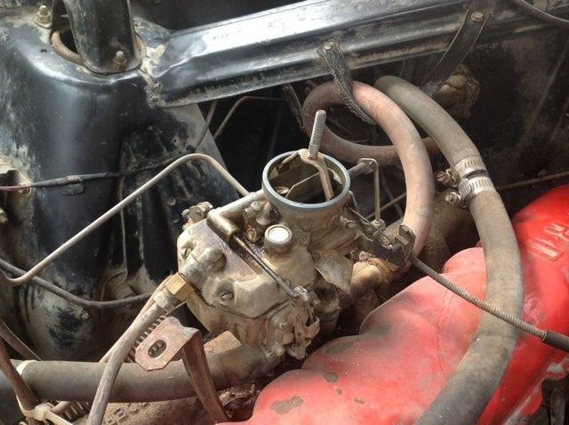

    Engine shot its the 170ci
    The old 1 bbl does look pretty tired

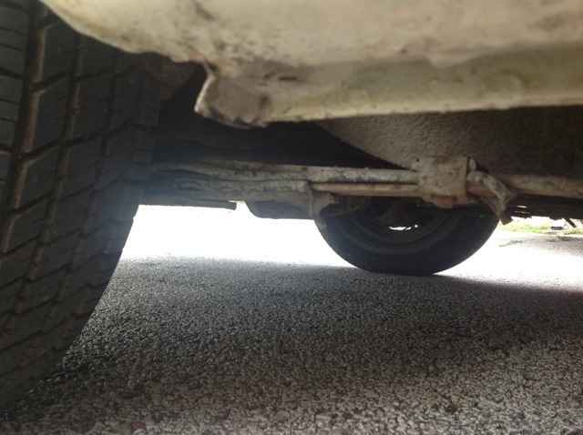

    Look free dry rotted snow tires lol

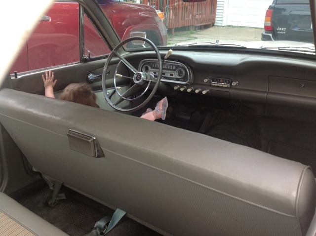

    Tenley likes checking out the inside interior shots
    Hey dad whatcha doing

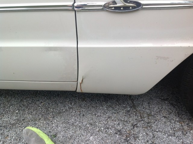

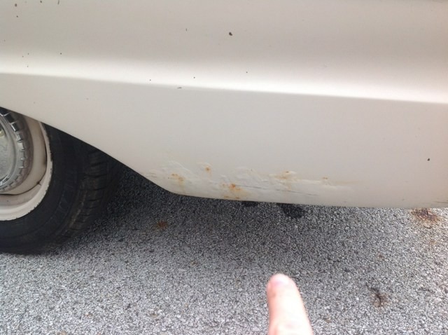

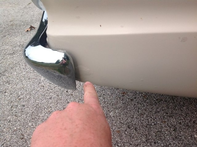

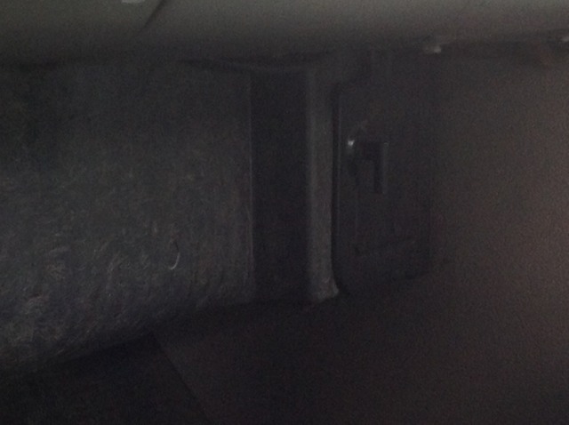

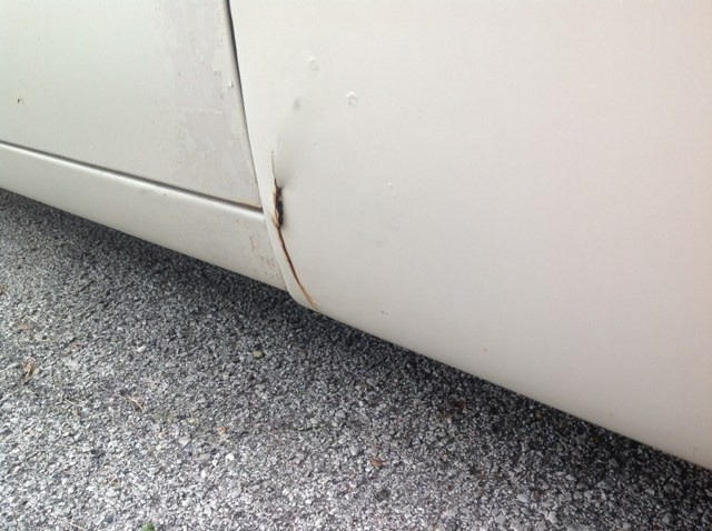

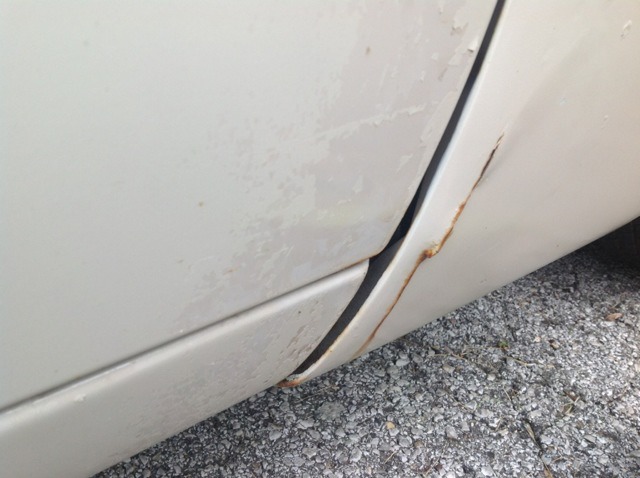

    Quarters behind the rear wheels
    Drivers side the color doesn't show it well it's about the size of a football but not too bad really
    Passenger side is pretty small

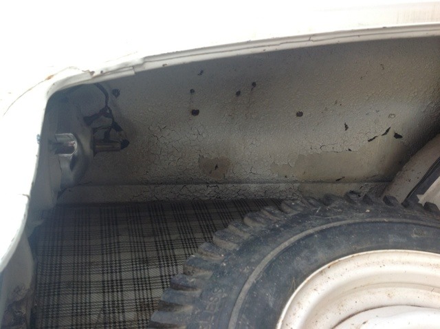

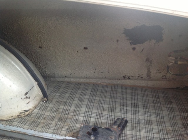

    Inside quarters through the trunk still have most of the factory deadener
    Pic limit onto the next post

    the choke needs to be out almost all the time even when its warm (warm = needs about 1/4 choke)
    the Previous owner said he rebuilt the carb and the float is sticking a bit. but the more I drive it it seems like the carb is just not set up very well. its got a crazy fast idle not sure it thats the choke or the adjustment. anyway I figured I'd ask you all if what you thought. could too high an idle speed make the carb run crappy to the point of needing to choke it or am I crazy?
