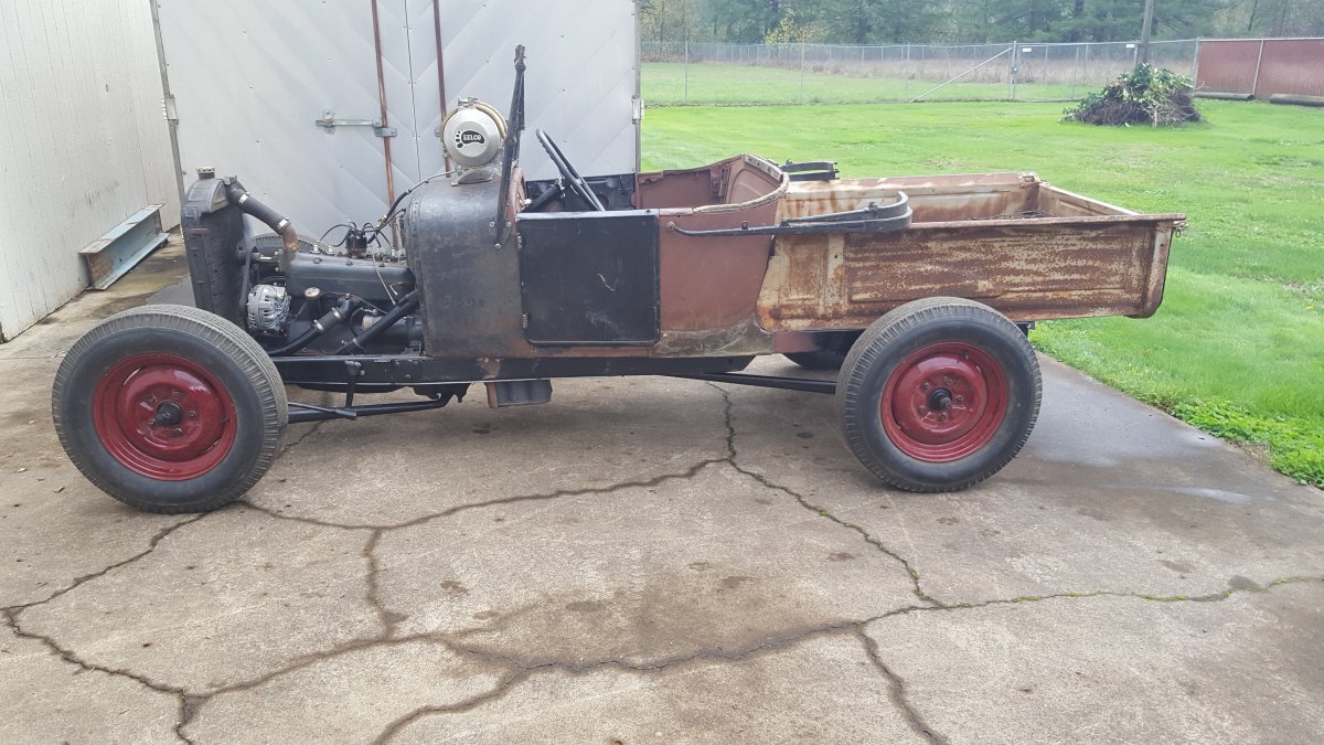

  7. Wow! story sounds way to familiar. Here is where I'm at on the same road. Notice the Fan is turning. That means it runs and drives as you see it. Same basic parts list but with a Truck bed.
