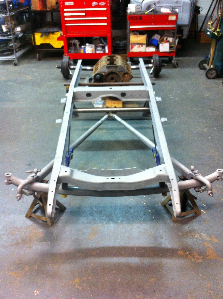

  13. A few weeks ago I flipped the frame upside down and started working on the front end, the truck had a 1937 V8-60 axle wishbone and spring. To the best of our knowledge it was going to be straight forward. We had looked at the photos, the rear crossmember used the running board bracket holes. We assumed the wishbone was going to "Just Fit". Well, it was 3 inches too short. Duane and I scratched our heads, we measured Merc, Lincoln, and Ford bones and couldn't find the exact fit.
    So we decided to stretch the wishbones, Duane took some 1.5 pipe home and turned it down into two spacers, and I welded it in the next day.
    The Spacers..
    Mocked up and fit...
    I welded them and cleaned it all up.

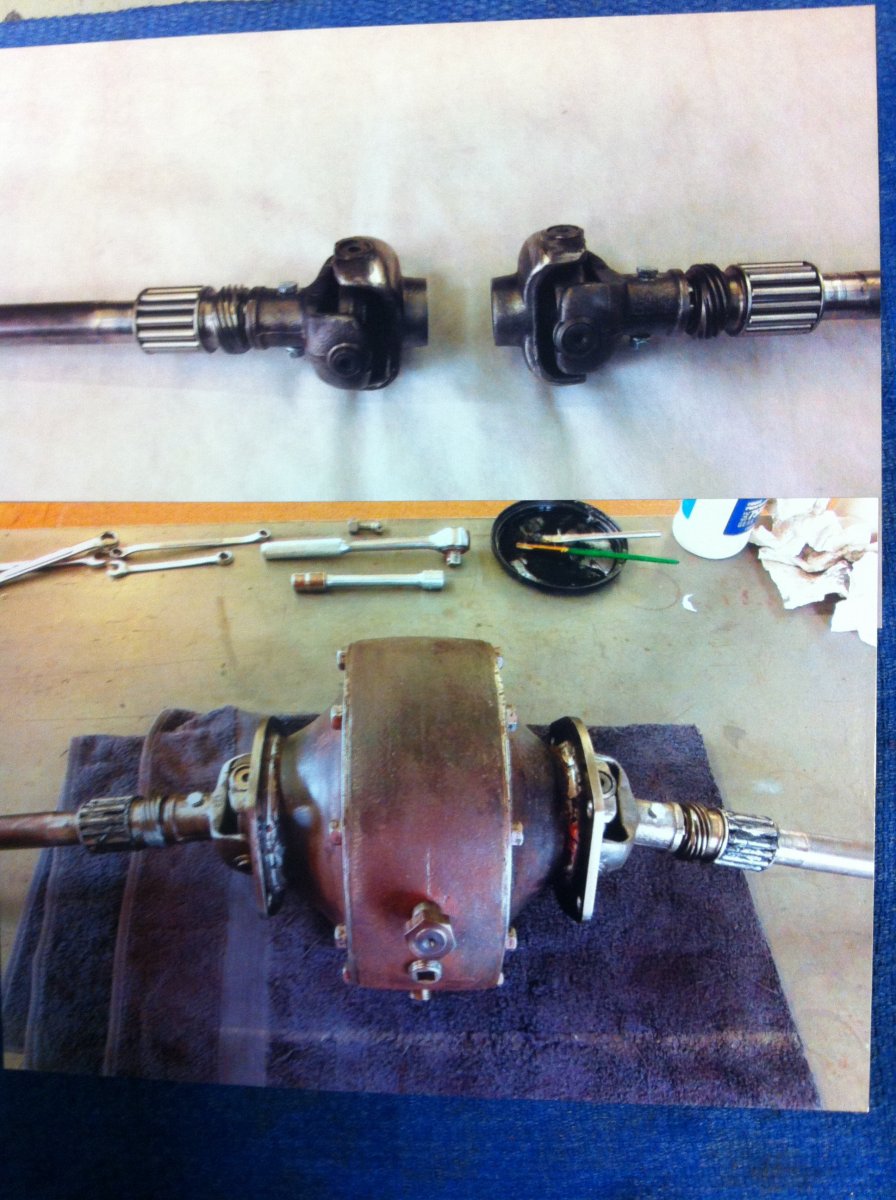

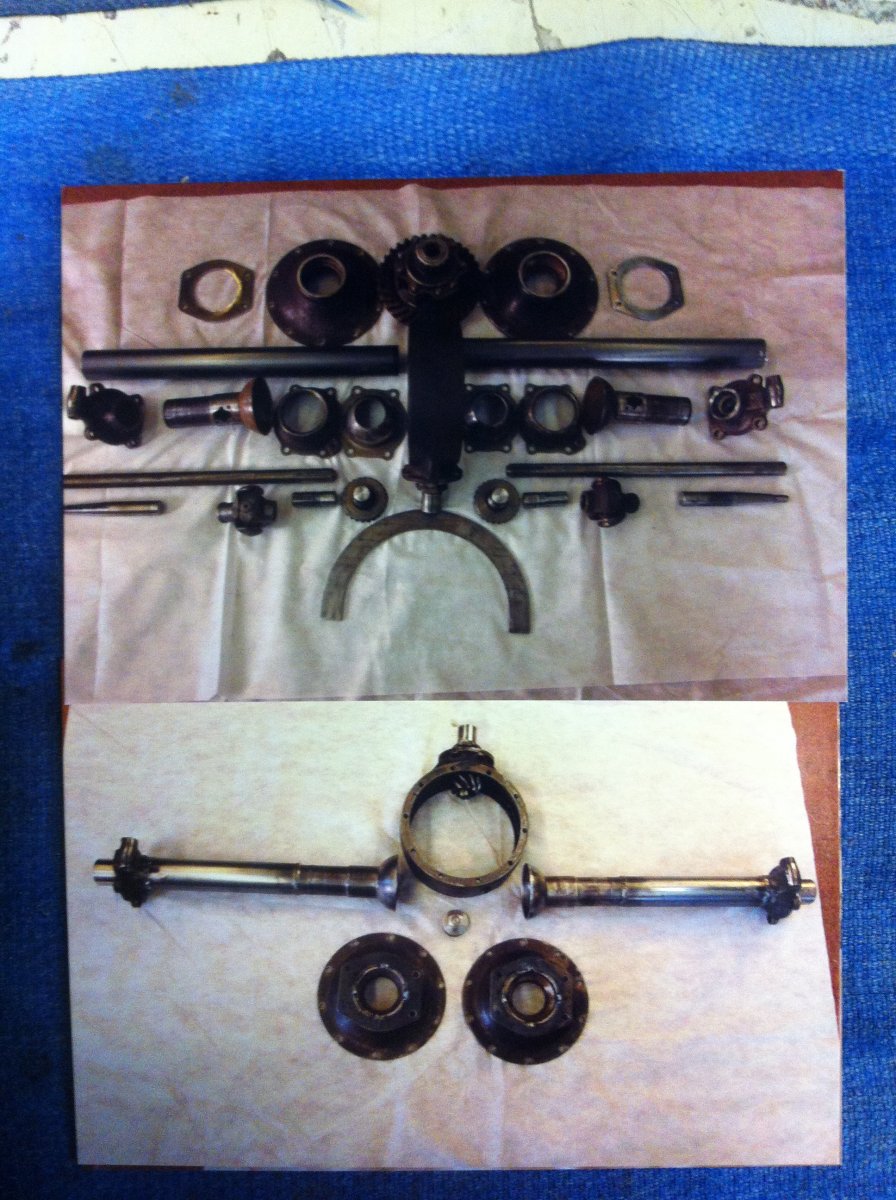

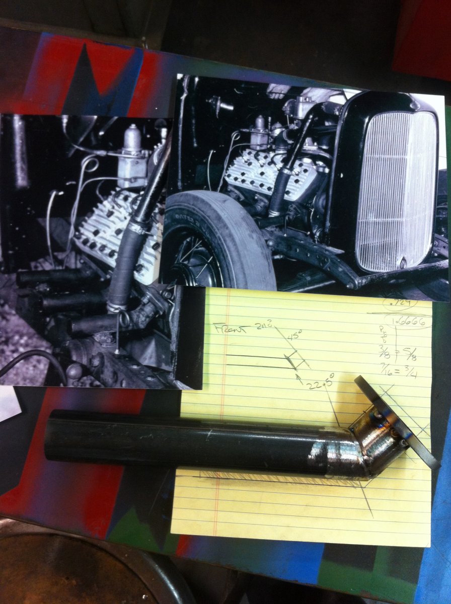

  18. Last week we were in a thrash to get ready for the Rocky Mountain Auto Show, I was making headers, which double as motor mounts on the front motor, mounting the rear axle, and tacking it all together.
    Alot of people have asked about the rear axle, yes it is independent, yes it uses torsion bars.
    It is constructed out of all early ford parts, this truck was originally built in 1943 and 1944 with junkyard parts.
    Duane had figured out the whole rear axle, and collected the basic parts. He had some of the other old-timer machinists help too, Butch Salter and Bob Marcheese turned the hardened axles and stubs down. We cut out the axle flanges and mount plates. He built the whole thing in his little shop and brought it to the shop so we could get it in the frame.
    At some point I'll post all the details of how it was built, and what parts were used, for now, here's the basics...
    Its a model A center section, 34 ford torque tube ends and u-joints. heavily modified spider gears and axles too.

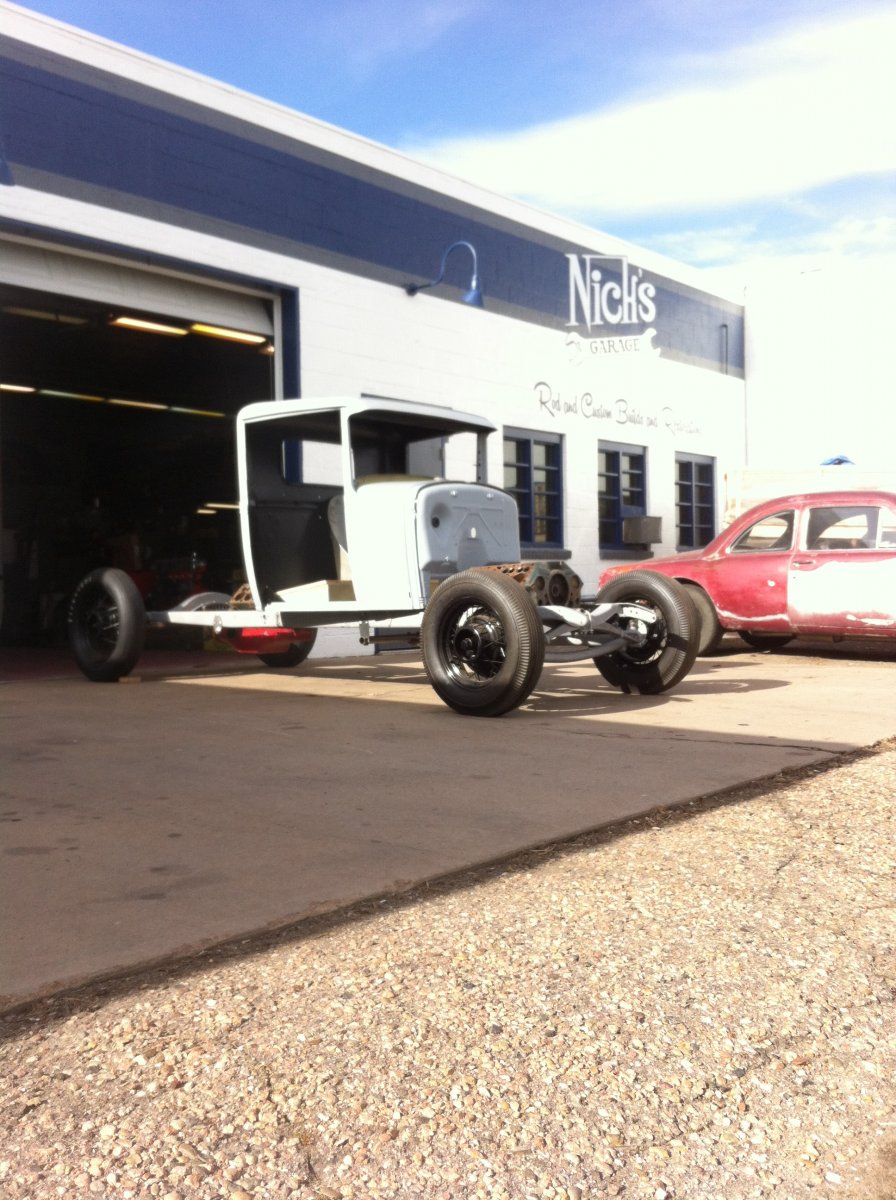

  19. Here's a few shots of the truck on wheels for the first time!

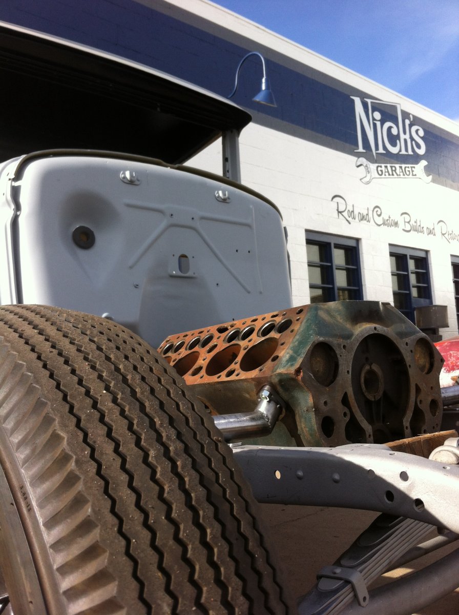

  23. Another Shot from the Show
