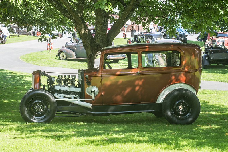

    At the early part of this year I was asked to display the car at a BIG indoor car show that Miles at jackhammer was organising in Holland. Hmmm European road trip, indoor custom show, 3 days on the beer? I was in.
    This prompted a pretty major 'semi' rebuild of the car that pretty much took up all my spare time prior to the trip. I was happy with the way the car looked but there were a couple of things I wanted to improve and generally just tidy it up as there were some very impressive cars going on display.
    So, in no particular order...
    The complete front and rear suspensions were removed, cleaned and repainted. I also swapped out the mono leaf on the front for a conventional spring pack.

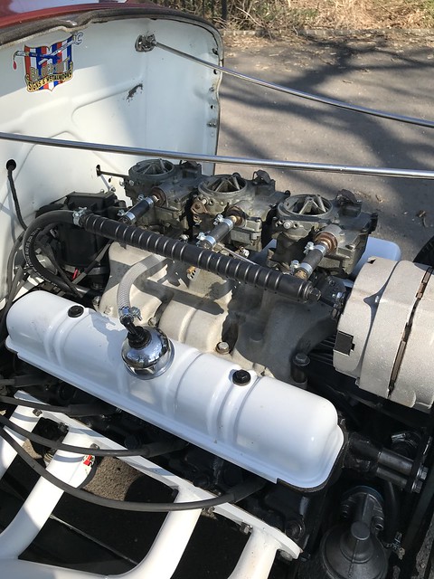

    A new slimmer gas tank was mounted up against the rear panel and all new fuel lines ran. I plan to fit a back seat eventually.
    I replaced a number of suspect lifters as it suffers from occasional tapping noise.
    I finally fitted my Eelco intake manifold and 3 Rochester set up.

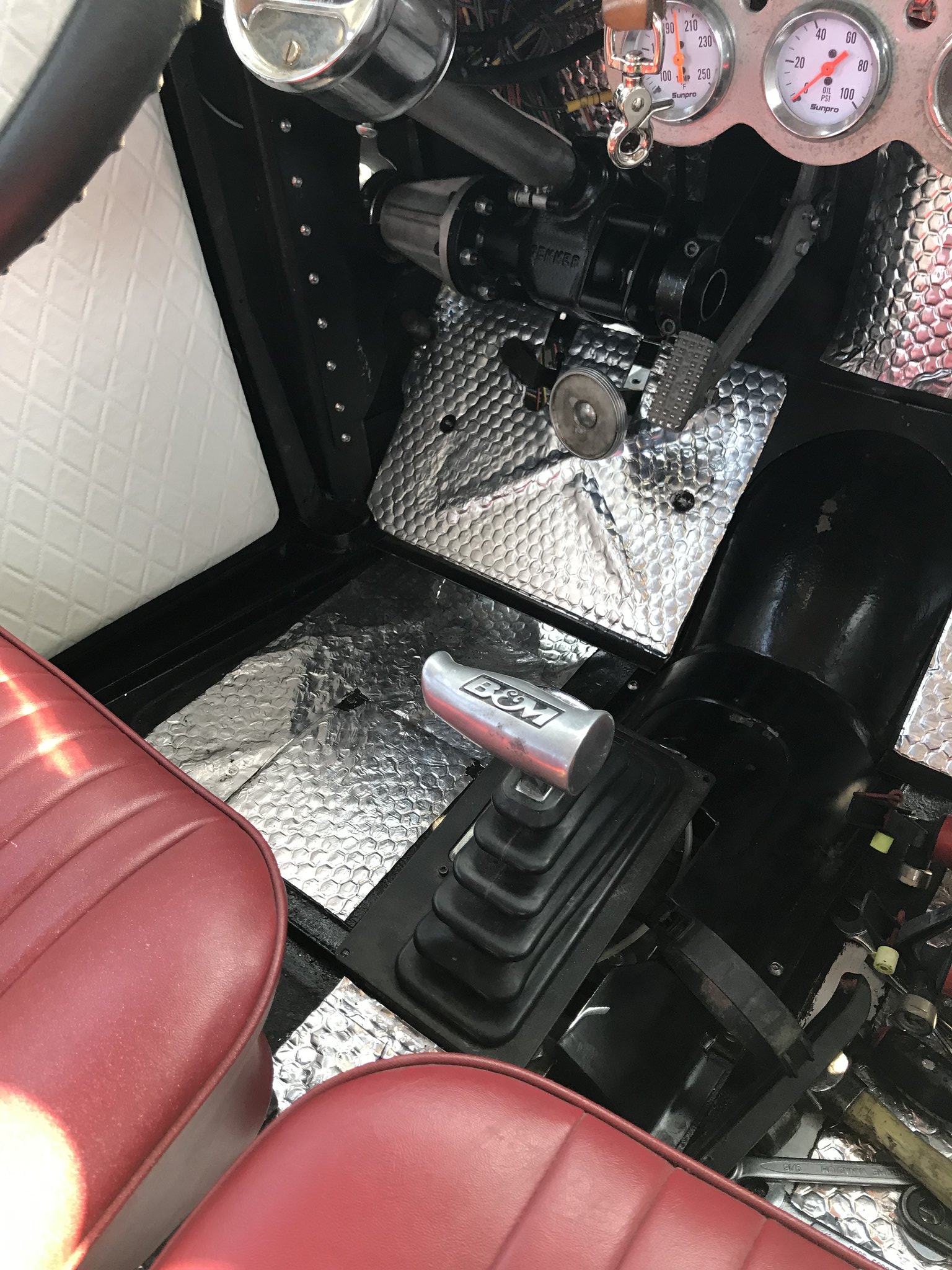

    The interior was lined with sound deadening which has made a hell of a difference.
    Windows were fitted.
    Fitted a ratchet shifter.
    I started on the interior but ran out of time to finish it.
    I continued the white accent colours onto the I beam, backing plates, screen surround, and head lights.
    The best improvement I made was fitting a cowl steering box from Mikes speed shop to replace the Schroeder. These are based on F1/F100 Gemmer boxes and are a work of art. The ratio is 18-1 and has made the car a heap more pleasurable to drive.
    So here's how it ended up for the show.

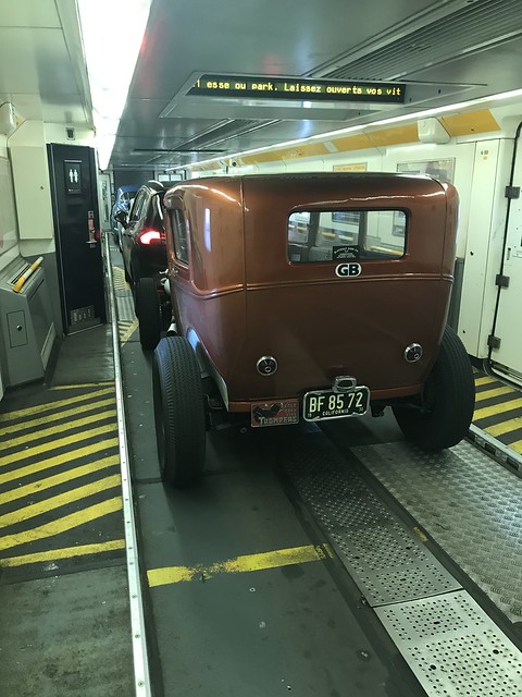

    The route took us through the channel tunnel then up through France, Belgium and then into Holland. Didn't take many pics. Too busy enjoying myself.

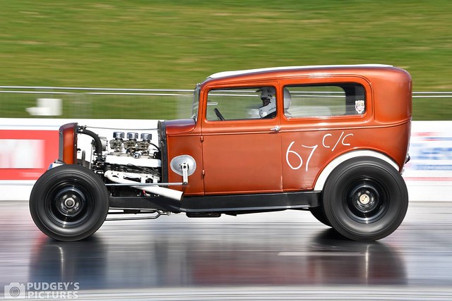

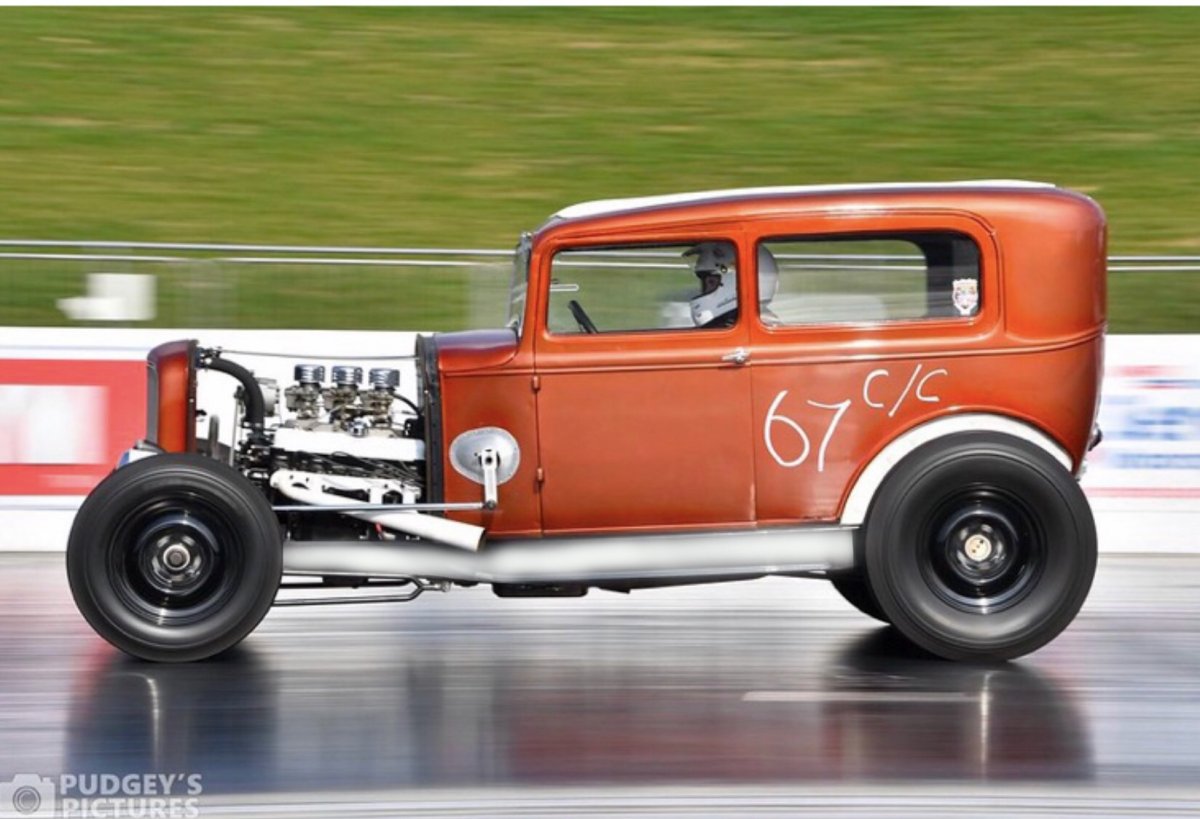

    As I'm writing this I'm not long back from this years VHRA vintage nationals where again the car ran great and bagged a new pb of 13.6 secs at 98mph.

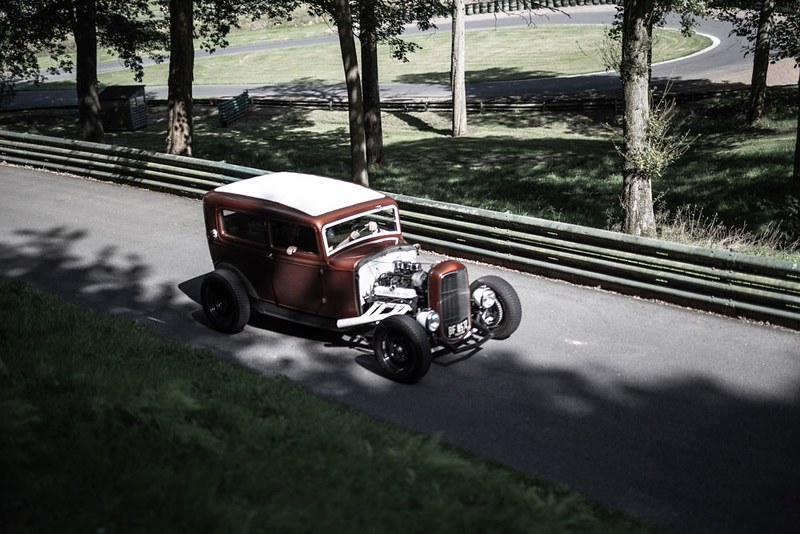

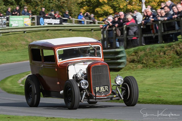

    In early August I was invited to be a guest 'demonstration' car at an event at Shelsley Walsh hill climb. The majority of the day is a RWYB type of deal with people taking their cars up with the guest cars going up periodically throughout the day. Again the old sedan was a fish out of water with the rest of demo cars comprising of purpose built vehicles ranging from a pikes peak prepped Audi to a RS200. Non the less I tried to put on a good show and I think I achieved that, helped some what by the fact that there were no noise restrictions and I could uncork the headers. The nailhead sounded sweet! and the car felt good. I had fitted racing bias plys in the form of some Engelbert's which were made by Michelin and used on 70's-80's Ferrari' and also invested in some adjustable shocks all round.
    Some clips and pictures.
    [​IMG]Untitled by Gavin Meanley, on Flickr
    The following week was the VHRA GOW event back at Prescott hill climb. I had a blast running up the hill that I have come to know quite well and was able to give a few friends a bit of a thrill ride.
    Going off my camera footage my times are similar to when I competed there last year which is slightly disappointing given the improvements I have made ie tyres, shocks, etc but I wont know for sure until I compete there again in a few weeks and will be officially timed. Guess I will need to push harder!

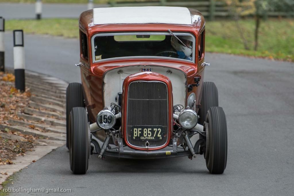

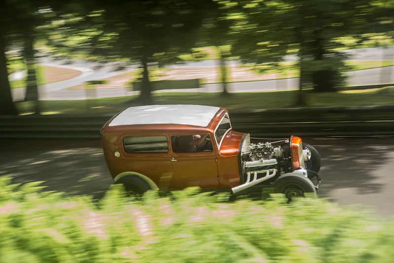

    Following my 'guest' appearance at retro rides back in August Hillclimb monsters have seen fit to do a little mini feature on the sedan which is cool.
    I also competed at Prescott hill climb a couple of weeks back and managed a new PB of 57.45 seconds so the tires and shocks must be working.
