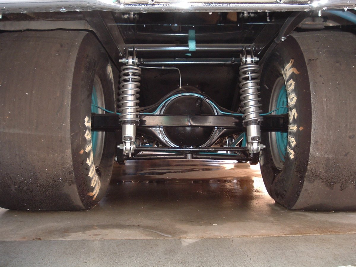

  26. DSCF0273.JPG You guy's crack me up..... I ran a spool for years....Street MT's and slicks..... 18'' wide. NEVER had a problem,BUT, and I mean BUT- it's how you drive and how you maneuver.....
    No- it's not an OT that you get in and go......... I never had a prob with chirping,bouncing,clanking, whatever.........
    Never tried to turn on a dime either.........
    Street driving was as seemed to me normal,despite the noise (HP barking)
    IDK what the issue is,and how people's perceptions are, BUT, there all always adjustment's to be made.....
    There's always two camps= love /hate...........
