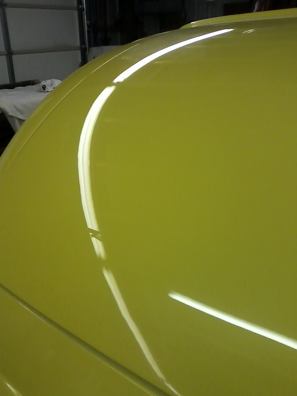

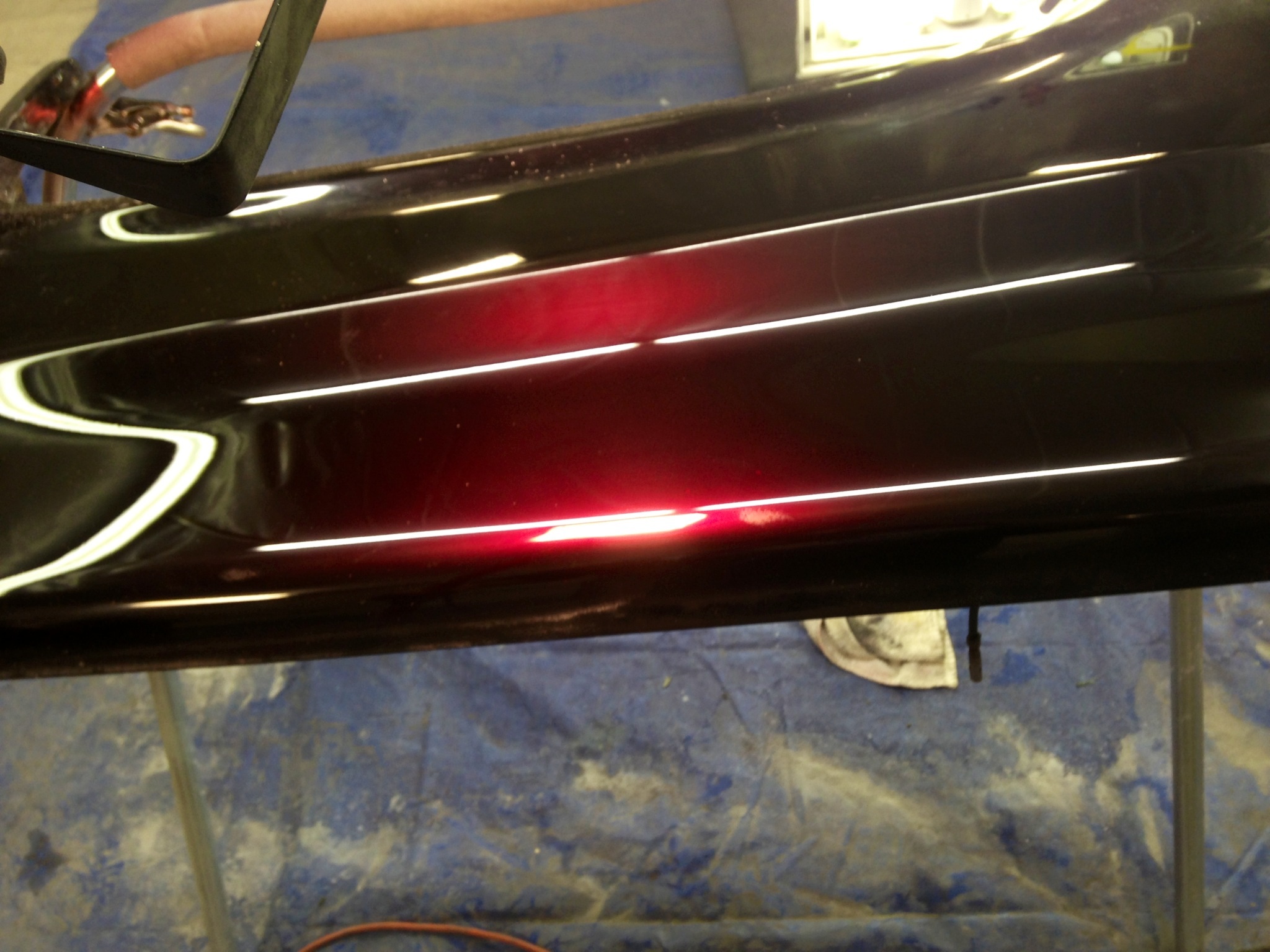

    Latest "garage" finish and a few others. I make a "booth" at home with some surplus white shrink wrap for boats. I can't show the whole yellow car as it's way O/T, but the Ruxton was essentially a "garage" refinish. No booth at the shop where it was painted. All of my latest woodgrain jobs were done in the garage too. 021.jpg 033.jpg rxtn.jpg 0227141917.jpg 0226142113a.jpg
    Gasser 57 likes this.

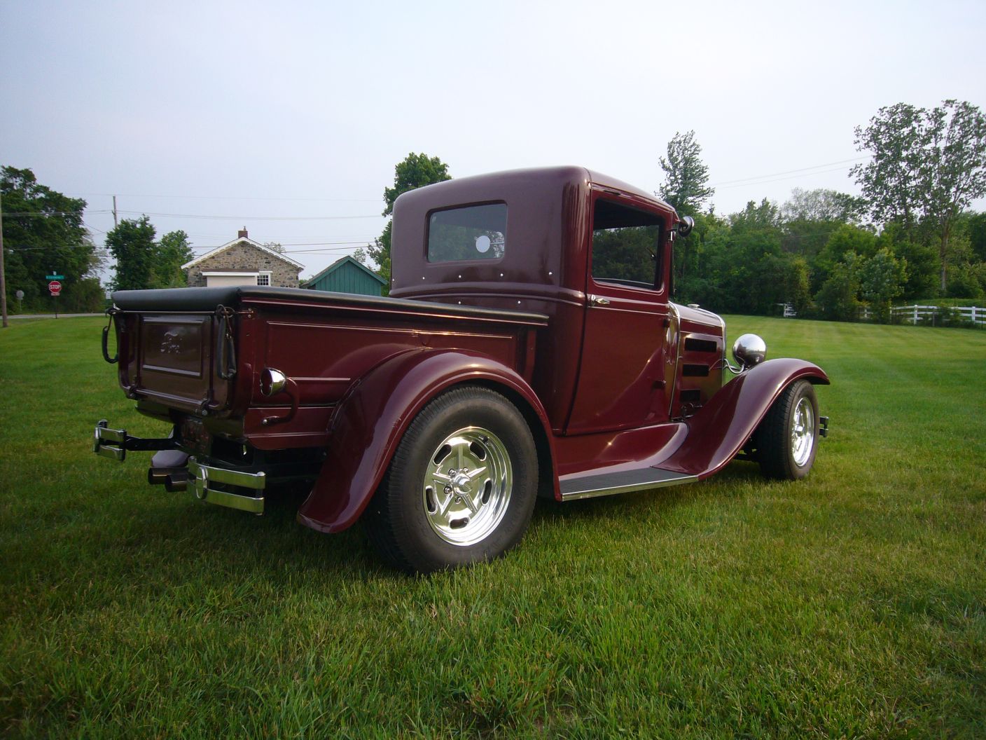

    Painted my 31 in my Dad's garage back in 1986 with acrylic lacquer. It's held up good through the years, has chips, etc. Bought an air supplied respirator system back in the 90's used it with bc/cc and for sandblasting, it's a worthwhile investment as you only have one set of lungs.
    Hotrodmyk likes this.

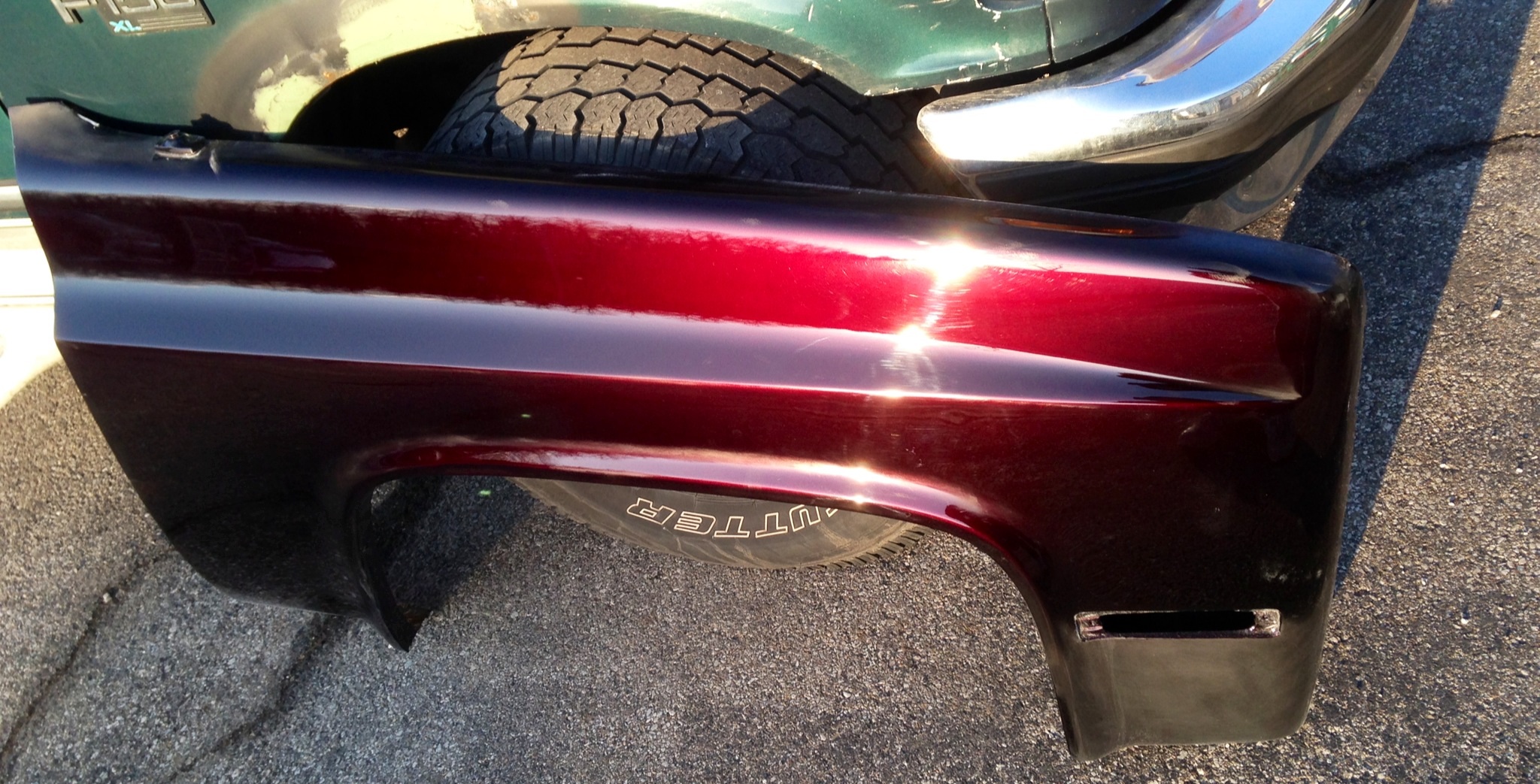

  27. Custom paint in my plastic sheeted booth. Its just a junkyard fender with minimal prep. The method and material is a little unorthodox so this fender stays outside 24/7 and been there for over a year receiving no attention testing its durability.
    Black as black can be
    Until the bright light hits it then it pops candy apple red.
    Out side at sun rise
    About 11:00
    alanp561, rbrewer, brEad and 2 others like this.
