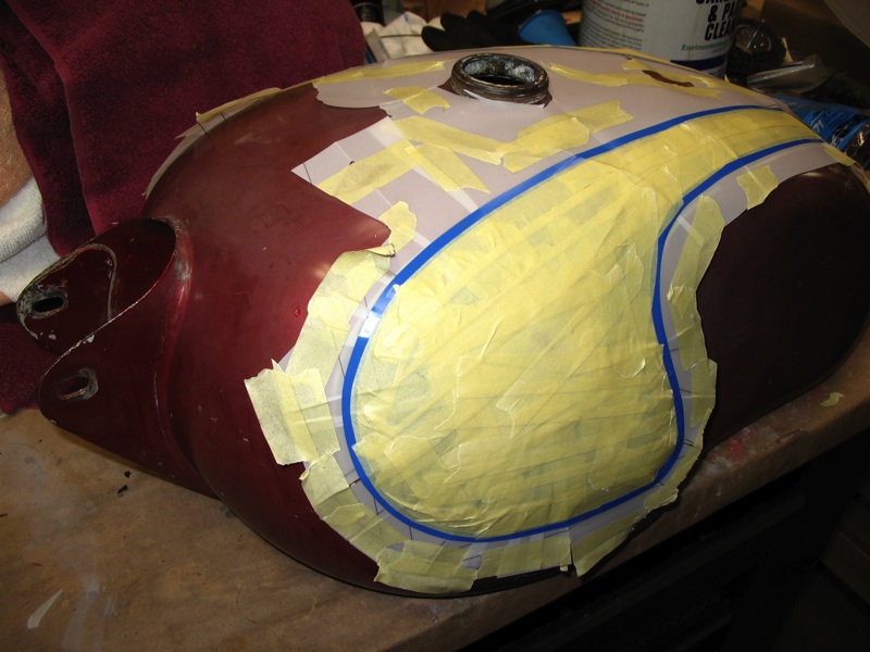

  2. I haven't painted a car yet but I have done a few bikes. The most on topic is probably this guy.
    A late '50s tank, I was trying to copy the stock scheme but in different colors.
    Cleaned up amazingly well for a 50 year old tank. Took me two years to get up the nerve to strip the original paint.
    Pearl silver, intercoat clear, and the lines laid out
    Graphics and cleared.
    Then after a few days to set up, off to Safari Knut to be striped (along with the tool boxes)
    Final product

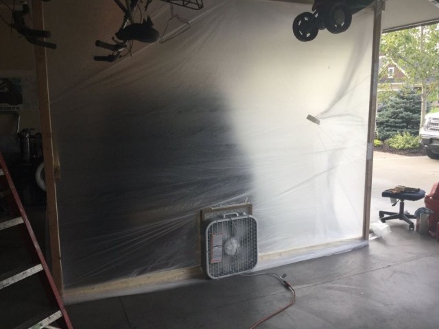

    Painted the '41 in my pole barn..hung plastic from the ceiling, wet the floor and had a squirrel cage fan for exhaust. IMG_20170704_162426228.jpg

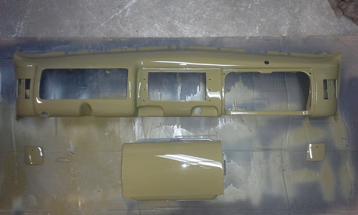

    my garage is way too small to paint my 40 coupe in, but i did paint the dash and firewall in my garage.. omni single stage.. not bad for a novice IMO 20170626_151806.jpg dash 4.jpg recess 4.jpg roller 5.jpg

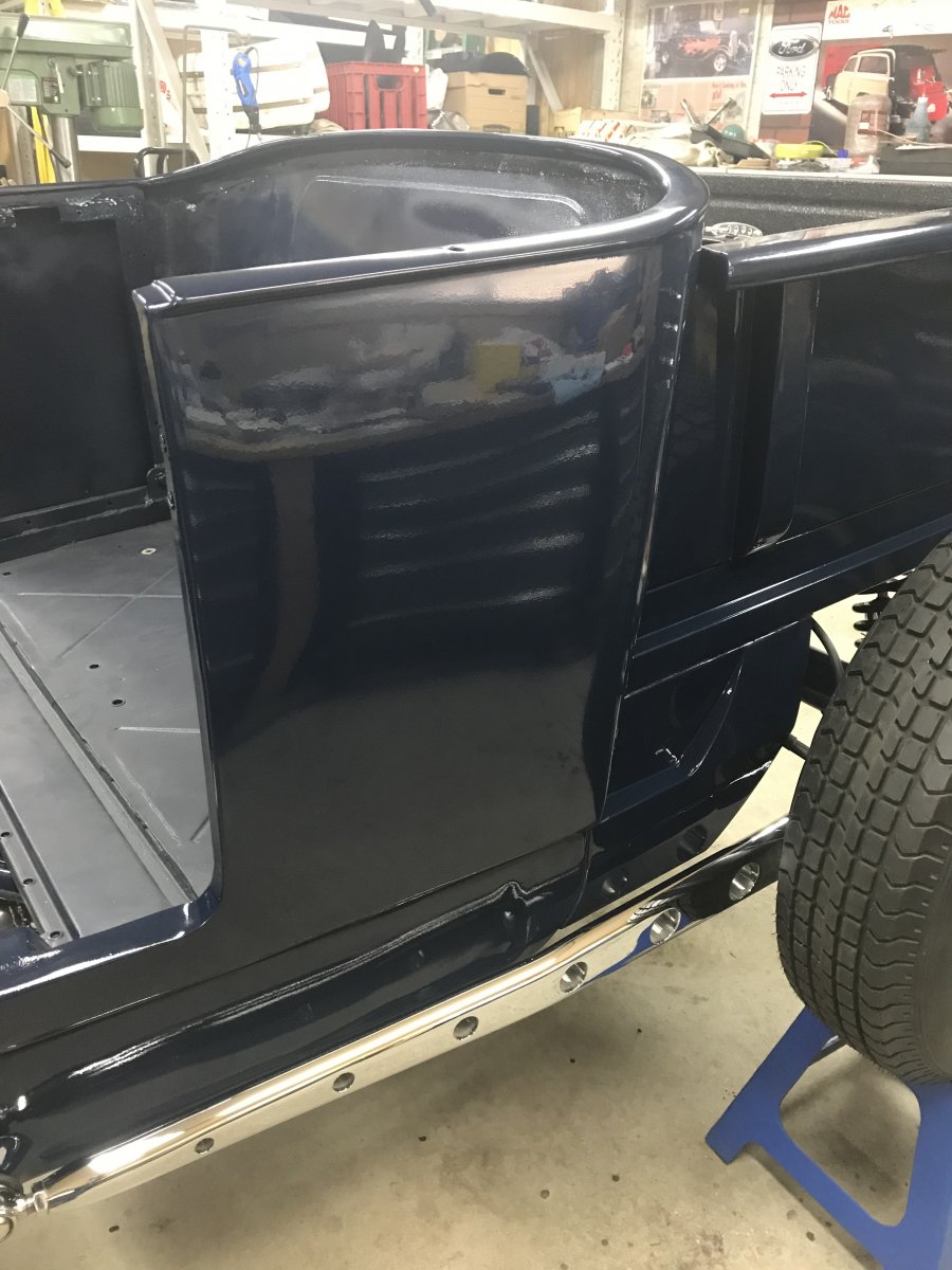

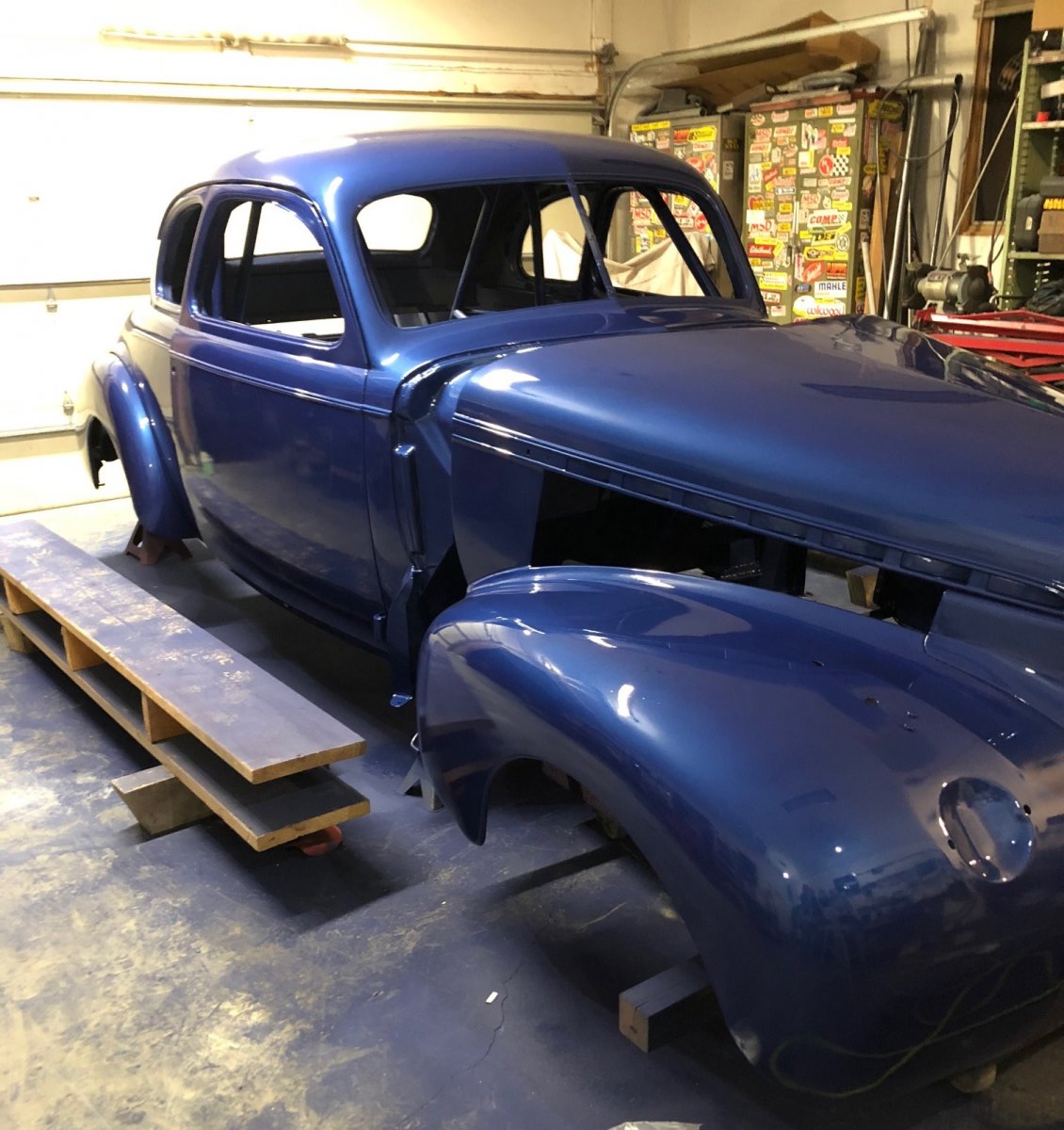

    I’m assembling my RPU now and did some polishing of the Washington Blue paint I shot in my home built booth last summer.
    (Pictures earlier in the thread).
    3M Trizact foam discs with a spray bottle to wet it down. First 3000 and then 5000 grit.
    That followed by 3 stages of 3M perfect it polishing compound.
    7E8F9C3E-7876-4874-894C-3024B97FD64F.jpeg 858FE254-0CFD-41B3-BDBA-5AEC2AA0F315.jpeg 6DADE228-7560-41CB-8806-A7844BA826B2.jpeg AC198CE7-5CCD-4C73-B7EB-557D8F583689.jpeg 970D8027-0A98-420B-8912-9F23C9474800.jpeg 8E6A411A-EA1C-46E3-AA7D-27093C753280.jpeg 5AE6533B-E569-4454-8D9A-D656F345DA65.jpeg
