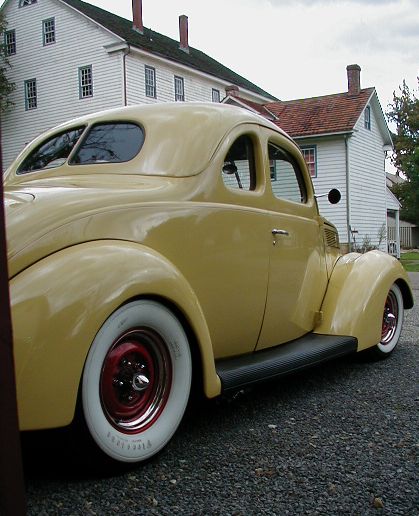

  2. My Deuce pickup was built & painted in my shop at home,we also built and painted my pal Dave's 40 Coupe in my shop at home. HRP
    First time it rolled out of the shop and read to start for the first time.
    Daves 40 coupe. HRP
    AB Normal, alanp561, Steves46 and 9 others like this.

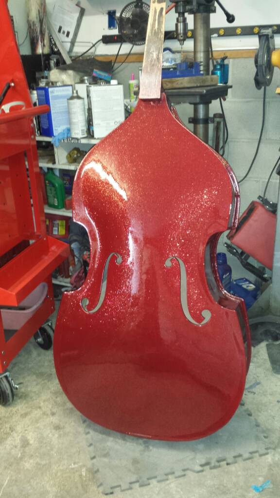

  5. Gearhead Graphics
    Joined: Oct 4, 2008
    Posts: 3,887
    Gearhead Graphics
    from Denver Co
    Painted the engine bay and interior of my unibody in the garage.
    All my painting aside from the flake is done with a 4 oz touch up gun as I haven't made up my mind on what to buy as a better gun.
    Also shot this bass and pedal car. Shadows make the pedal car look zebra striped.
    little red 50 likes this.
