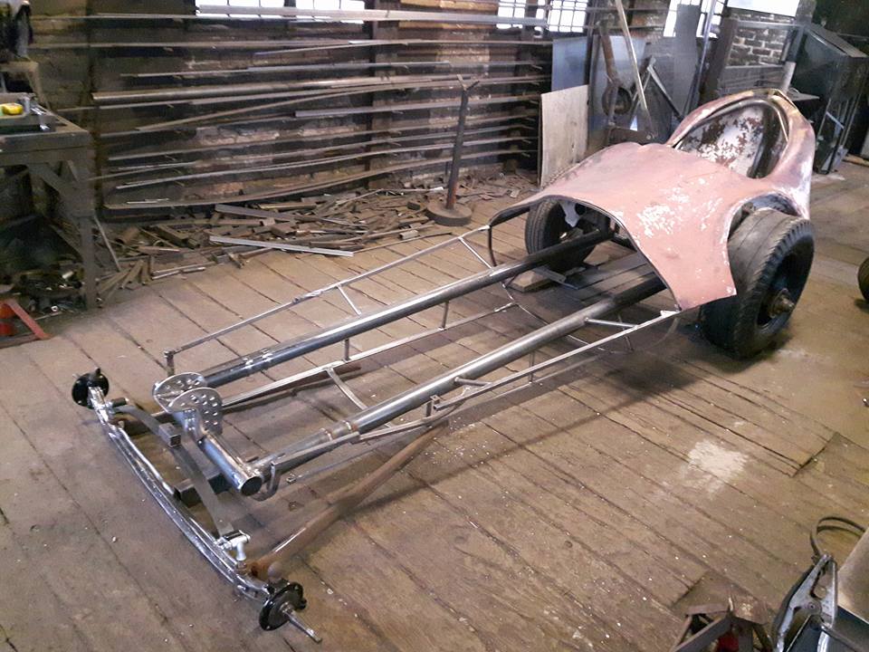

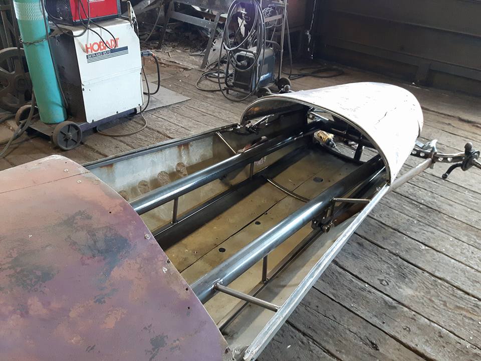

  1. The Purple People Eater Frame coming along .....it runs a 1934 Ford axle (drilled out), early Ford spindles with 1940 Ford 16x4 rims, early 1940's airplane gas tank cut down, 1950 Olds steering box, 1957 Ford 9" rearend (44") with 4:11 gears and a spool and 1955 Ford master cylinder for the hand brake just to name a few of the rails neat build items. 30707860_2116644721897792_8868747453491314688_n.jpg 30705498_2116729995222598_3915888813825589248_n.jpg 30707860_2116644721897792_8868747453491314688_n.jpg 30709618_2116645615231036_4795118385102848000_n.jpg

    catdad49
    The first couple of pics of the "remains", as you called them, I was very skeptical. Then seeing the body assembled, I thought Yes, that's Better! This is going to be Great and what a Perfect place for the resurrection. Hopefully, someone is on "fire watch" when there's sparks flying with that ancient wooden floor. Keep us posted, Carp.

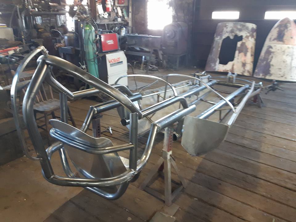

  8. More pic's of the frame construction by my pal Russ Moore.... all from 60 plus year old photo's. 29495947_2105020049726926_3331451130432454656_n (1).jpg 28161865_1583047141778501_6093141291686366192_o.jpg 30710027_2116645651897699_31239053785432064_n.jpg 30705972_2116730365222561_6987963965854711808_n.jpg

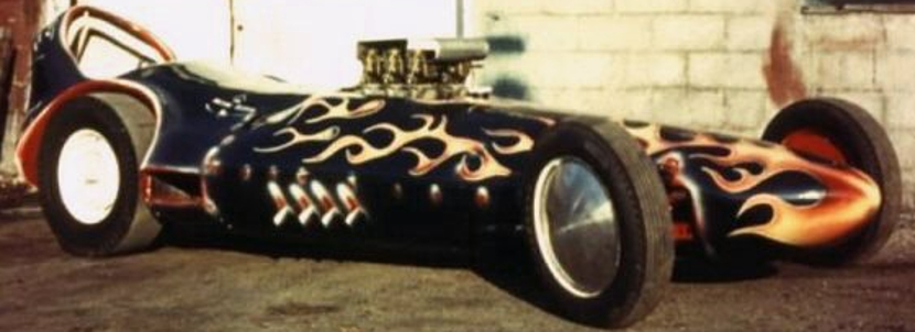

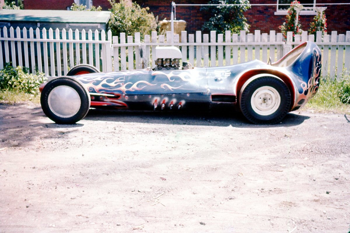

  16. The "Purple People Eater" got flamed up by a young Kenny Kay back then in around 1959 because the Strokers Car club wanted to do the indoor shows and felt the flames would bring it more attention by the judges at those shows. img255.jpg
    scott27, mad mikey, BigO and 8 others like this.
  17. You can still see those flames today but very faded. 13029679_1264646513557820_8887334071344252222_o.jpg

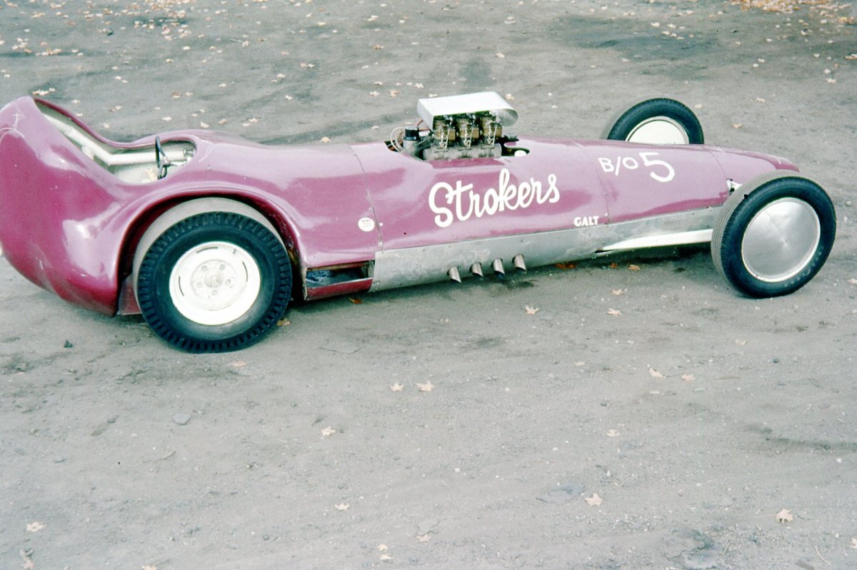

  22. Good question brother..... I'm shooting for the early look without the flames. When I told the original Strokers this they all confessed they liked it with out the flames..... so no flames but with that bold "Strokers" writing across it's centre section and it also had pinstripping on its front nose and rear section.
