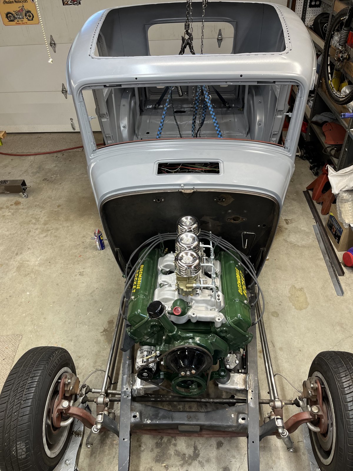

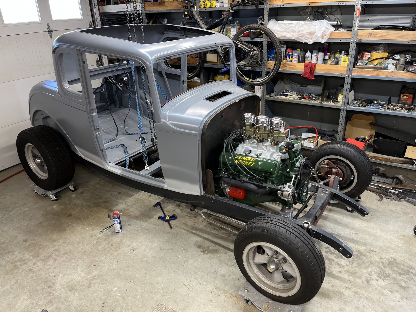

    Yep, bore to 4" and then use 371 pistons. That's the set up in my 32. C8EB42F1-B54A-4735-85D7-E40BCE036ACD.jpeg

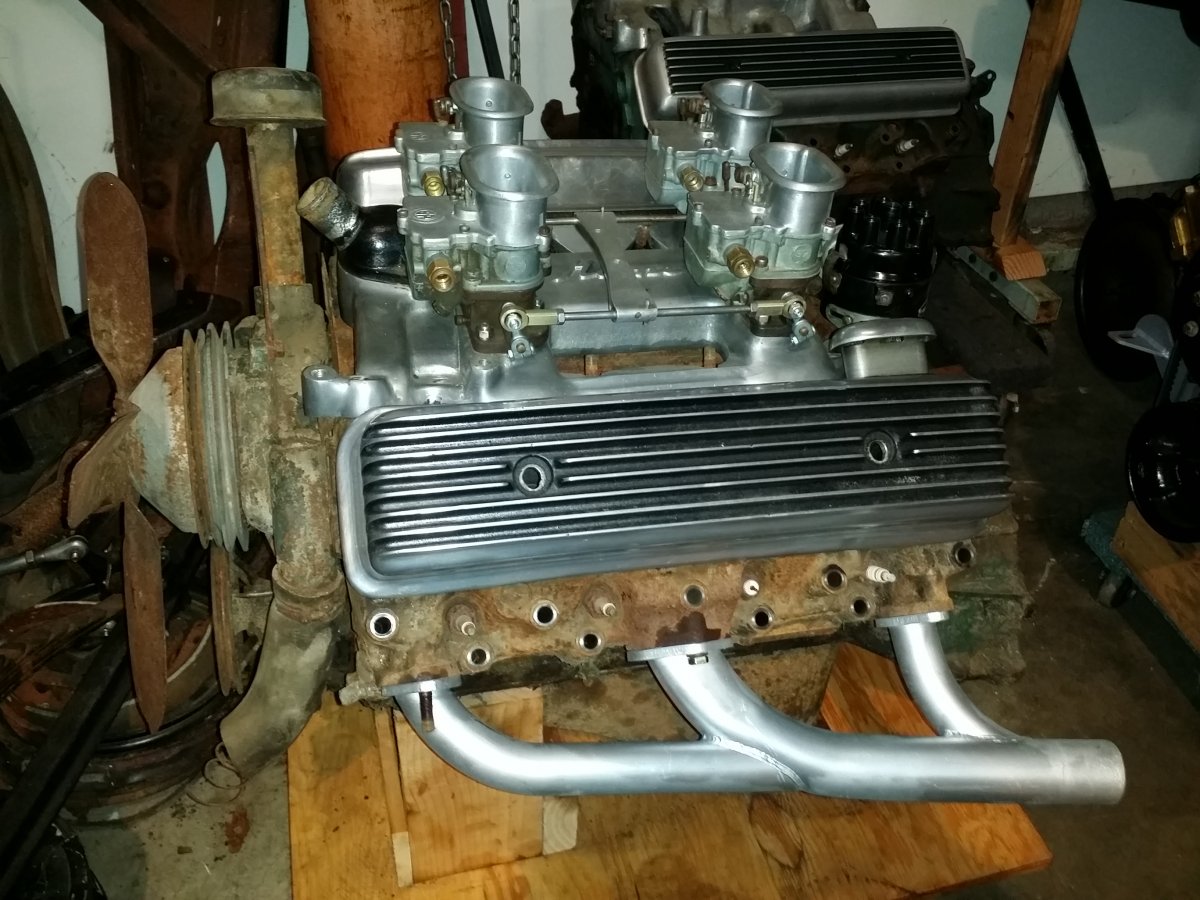

    Just picked up this 56 324. Check out the cast double water pump pully.
    I heard it was out of a fire engine.

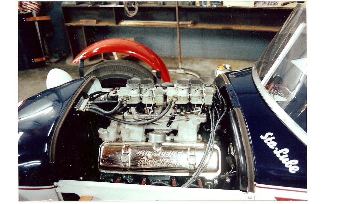

    I've been partial to the "Rockets" since rebuilding Ak Miller's El Caballo. It had a 303 originally that was out to 370 ci, so when looking for a mill I bought a complete '58 Olds with the 371 ci, sincee it was close. Larry Spengler in San Pablo, CA put the engine together, and it wasn't that radical. Al Blazic did the balance, and I believe it was one of the last he did. Ak Miller and Ed Iskenderian reground the original camshaft, and he they never would tell me what the spec's were. Carburetion was similar to original, a Weiand Wo4D, with adaptors for the 4 97's. I used 48's i.l.o. 97's, just for size.... Needless to say, the engine ran great, and I tortured it for 10 years of vintage racing before giving the car to the NHRA Museum.... 371olds (2).jpg
    warbird1, don colaps, BigRRR and 5 others like this.

    interesting, that lower pulley is different too with additional smaller groove at front.
    bchctybob, saltracer219 and gonzo like this.

    love it
    my current hot rod is also running a '58 but with two 4 barrels (probably very similar to the 4 2's) and slightly warmed up stock cam.
    just right for a light weight hot rod ;)

    @cabong I remember you saying that about the cam before. Last fall I had Isky on the phone so I asked him about it but it must have been too long ago. I hoped I could jog his memory about it but he wasn't sure. Crazy the details he could still tell me about stuff on the engine in his roadster. That guy is amazing. If we all could be around that long and still be that sharp just think what we could get done!

    I was rooting throught a junkyard years ago, and found a Chevy medium duty truck with an Olds in it with pulleys like that.
    gonzo likes this.

    Cool. That backs up what I heard about it being in a fire truck.
    I used 371 head gaskets to match the bore.
