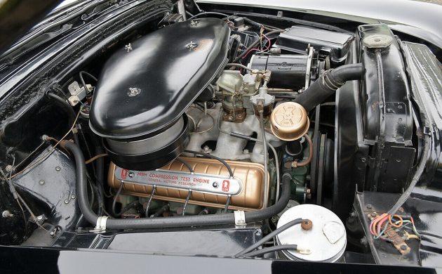

    Here's a rare pre-production, 1 of only 36 287ci GM high compression test engine and the only one purportedly installed in a car. I didn't know it existed until I stumbled onto by accident. All I was aware of was the Kettering experimental OHV V8.
    An original manual from GM Research accompanies the car along with additional factory manuals, brochures and other items, all of which are detailed in the photo gallery.
    I've previously come across this R&D test mule engine however I can't recall if it was 287ci or 303ci?

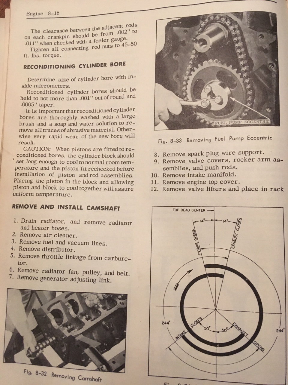

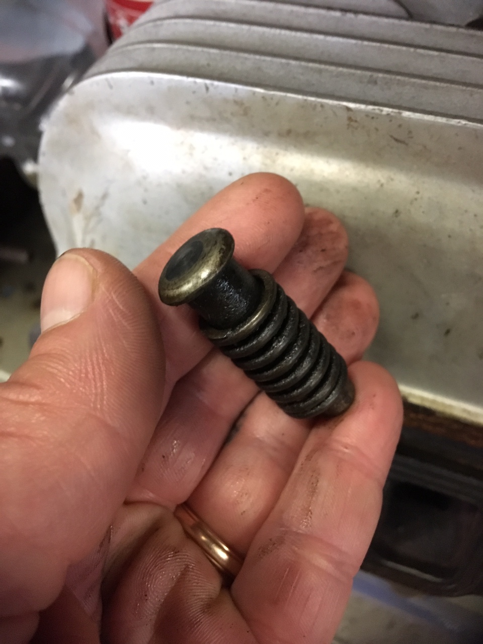

    Hi guys. This may seem to be a dumb question maybe, but I’m rather new to rockets and I bought this 303 ”semi completed” from a fellow. So, this spring clad pin in my hand, I’m guessing it’s some kind of thrust thingie for the camshaft? Can’t find any pictures of were it should be located. In the front of the camshaft??
    Thanks a lot
  13. goes in the front of the cam after the fuel pump eccentric is installed if I recall correctly. Been a few years now since I have had one all apart. The Olds gurus will surely be chiming in....
    don colaps likes this.
  14. Paul
    Joined: Aug 29, 2002
    Posts: 14,461
    Paul
    Editor
    Yes that is correct

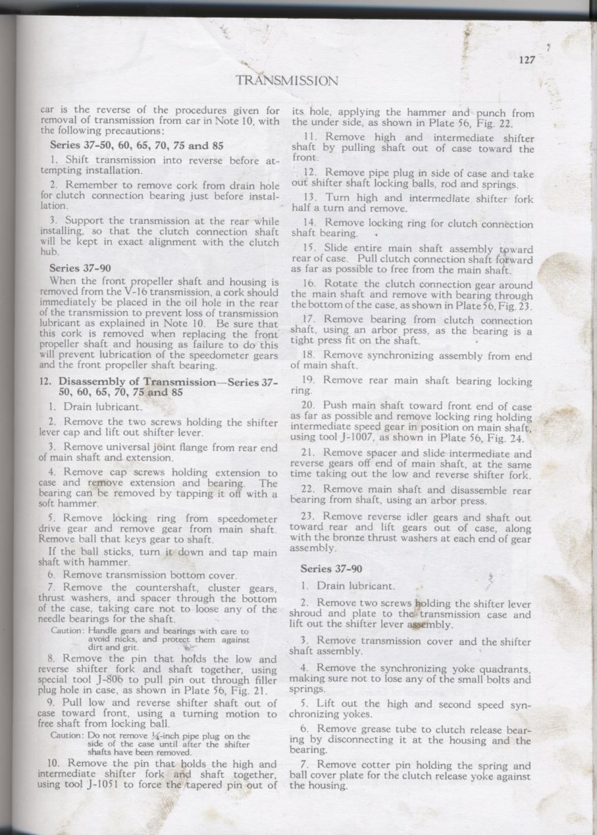

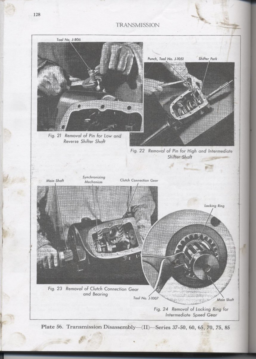

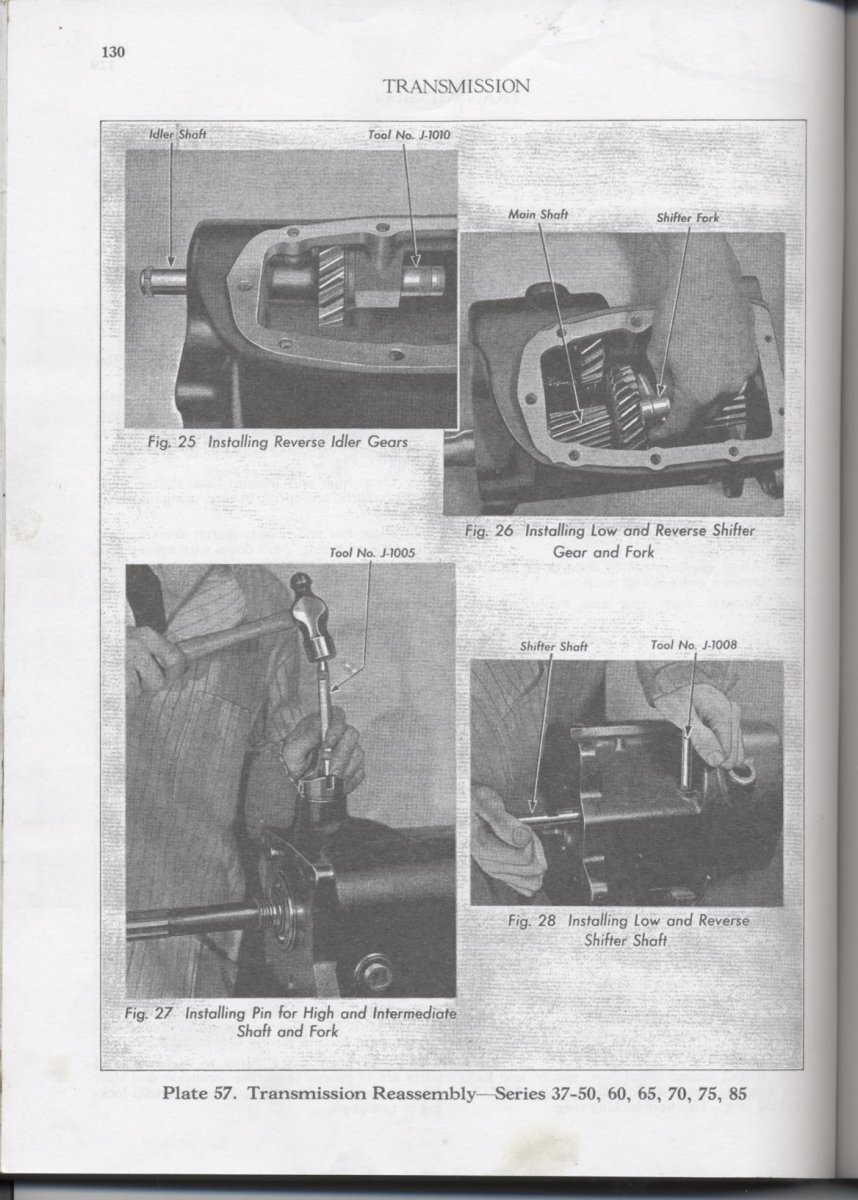

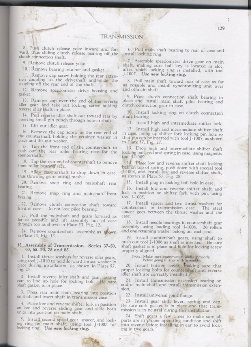

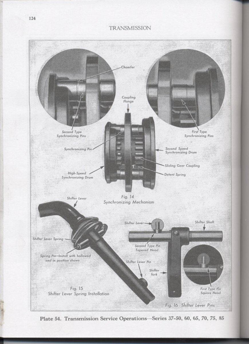

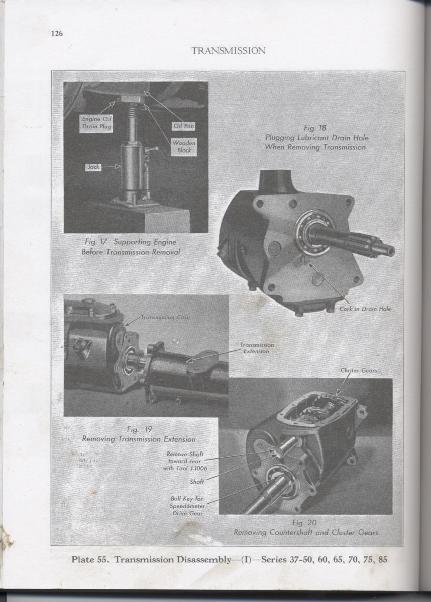

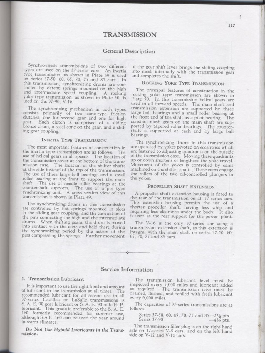

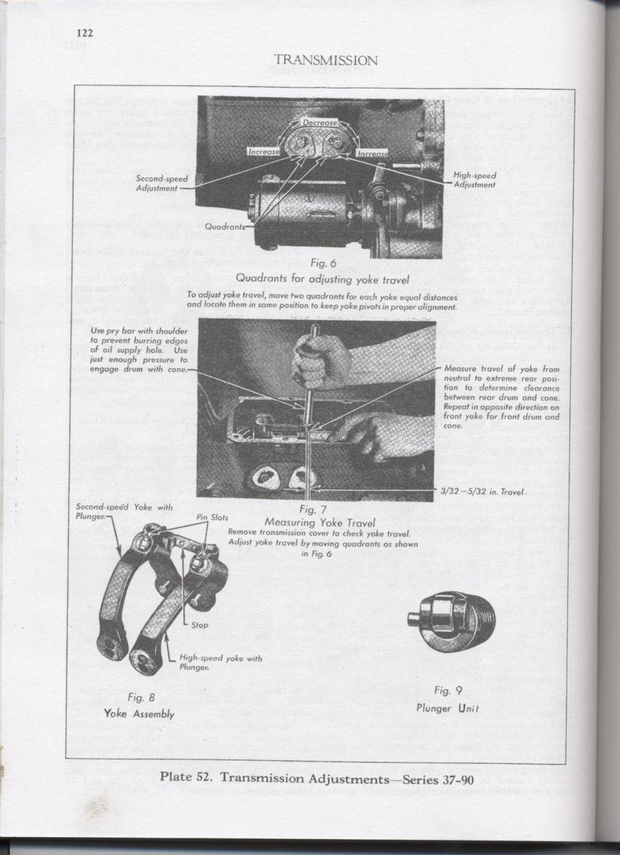

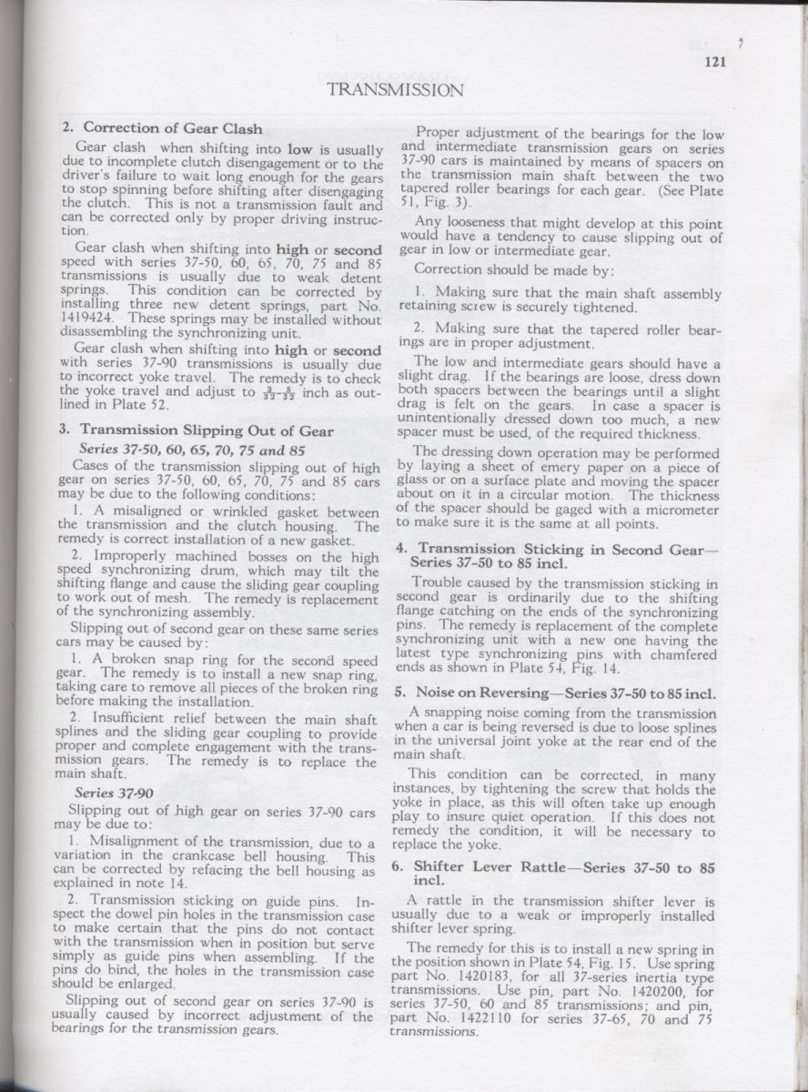

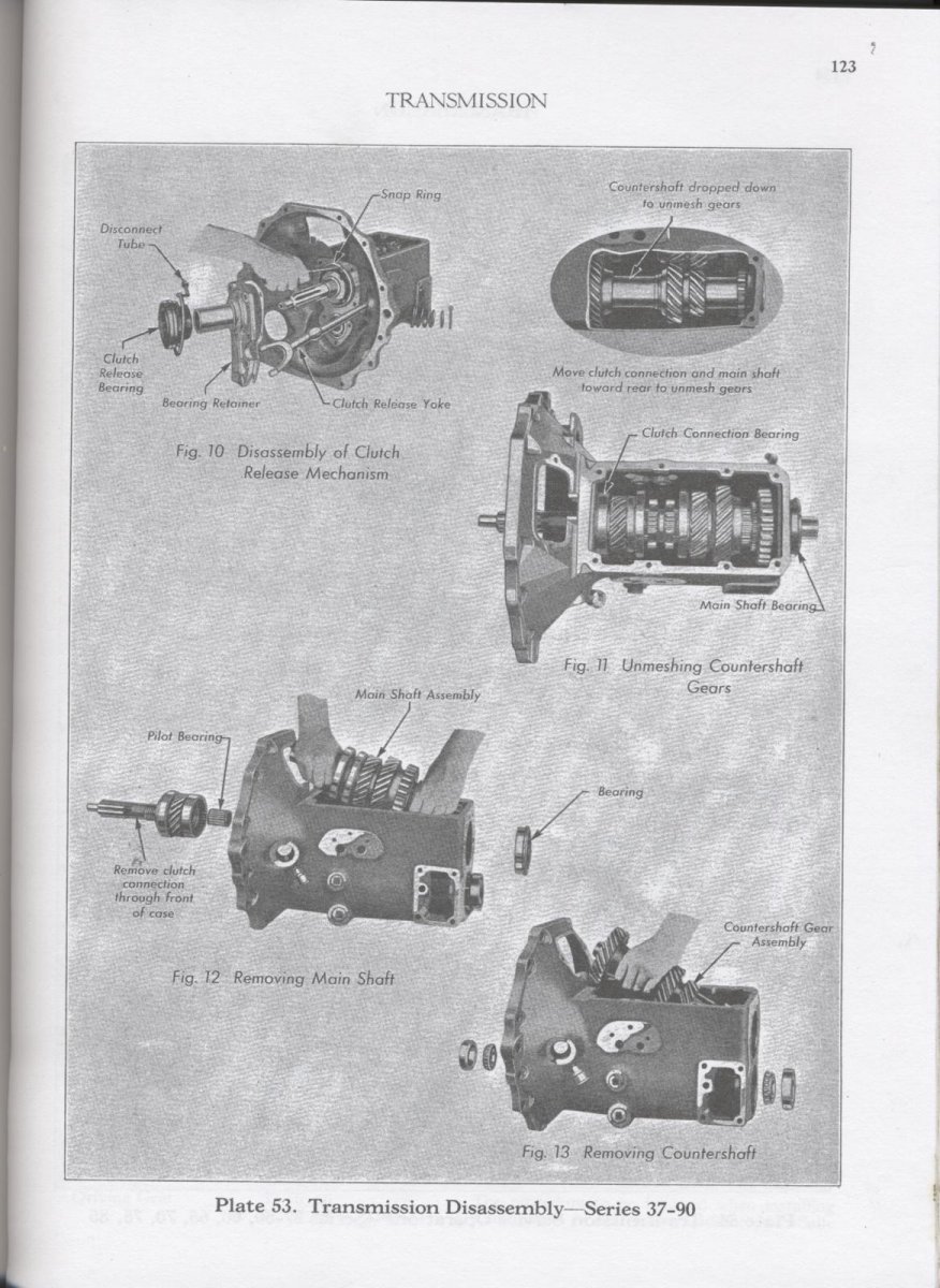

    I'm posting this in an attempt to assist with answering questions about disassembly of the '37 LaSalle top shift transmissions..
    cover.jpg page 117.jpg page 118.jpg page 119.jpg page 120.jpg page 121.jpg page 122.jpg page 123.jpg page 124.jpg page 125.jpg page 126.jpg page 127.jpg page 128.jpg page 129.jpg page 130.jpg page 131.jpg page 132.jpg

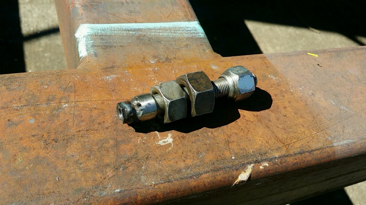

    8518.jpeg Picture of version of tool J-806 as shown in figure 21 on page 128 above, made from whatever was on hand at that time.
    The tapered pin has a 1/4" 28 threaded end, screw the tool onto the pin and draw it out through the plugged hole on the side of the case.

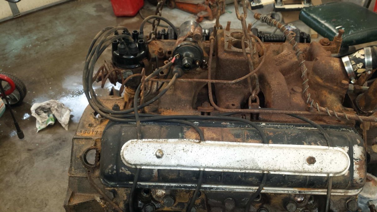

    Olds 303 7-30-19 (3).jpg Does anyone know how to distinguish a 49 from a 50 Olds 303, heads and intake and exhaust manifolds, water pump, timing cover, crank balancer/ pulley, flywheel.
    It was a complete engine with back draft carburetor. Has 49/50 stuff on a Rogers Remanufactured Engines cyl .040, mains .020, rods .010 but the Engine Block Serial number R422249 says the block is a 53. I wonder if the flywheel and lower bolt bellhousing and starter is for a 49/ 50 or a 53 ?
    My casting numbers do not agree with the records I have found so far. My numbers are all numerically lower.

    fwiw, my Olds parts catalog shows the same number for '49 and '50 heads
    I have read conflicting versions of decifering date codes.. but that seems like the logical path

    49 has a different dip stick and tube and the distributor hold down is also different.

    also, the plug wire looms were aluminum in '49 and steel in '50
    the four barrel carburetor wasn't available in '49 but both 2 and 4 barrels were available in '50
    manual transmissions were not available in '49

    My 2 bbl intake has 555693 casting #, the list I have found says 556714, 557709 for 49/50 and 560676 for 51-53.
    Maybe I have the early experimental manifold :)
  30. Didn't that two bolt distributor hold down carry through till 51?
