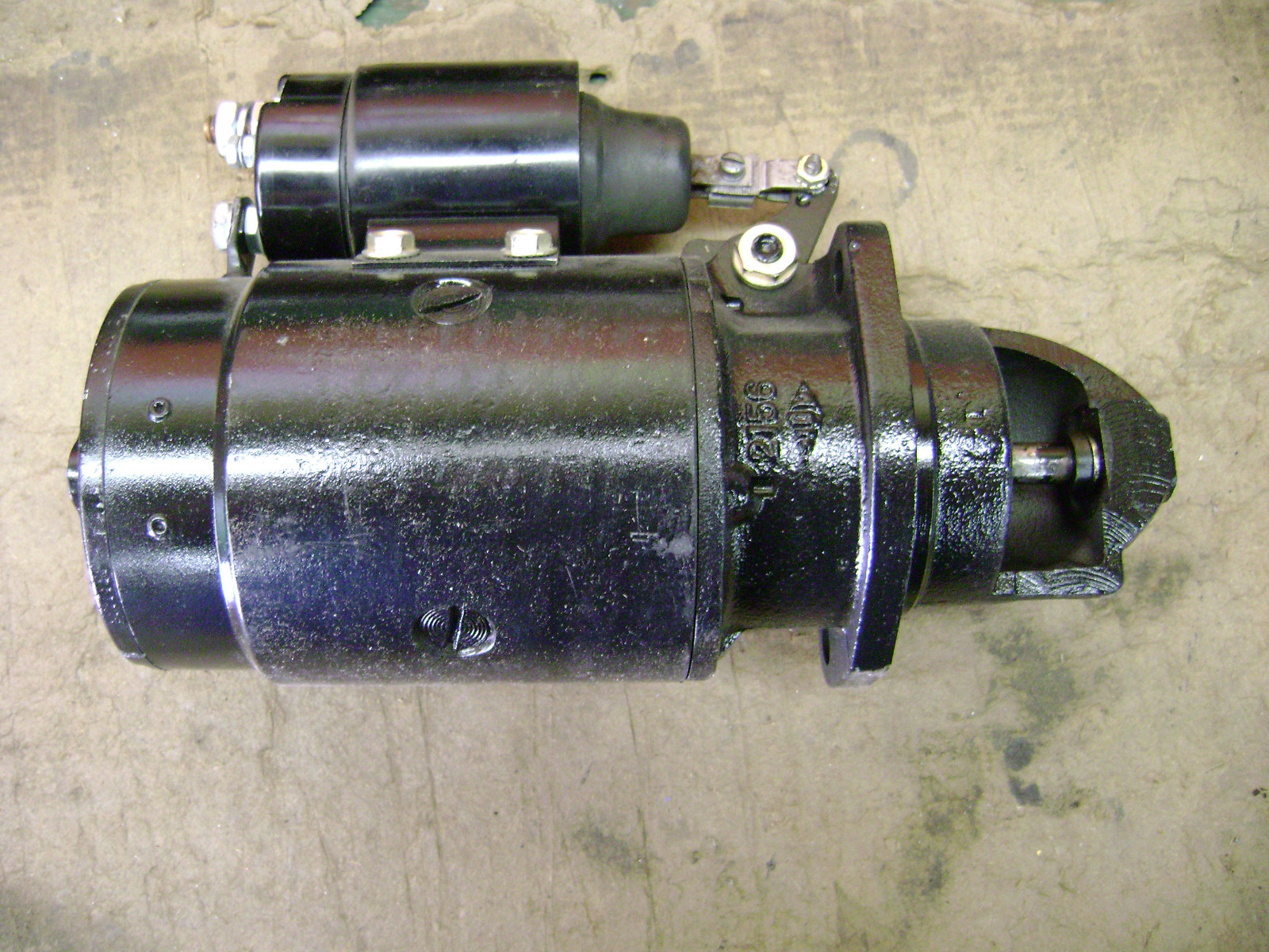

    looking at pictures I don't see any Chevy starters that look like they would work in the Olds.
  2. falcongeorge
    Joined: Aug 26, 2010
    Posts: 18,341
    falcongeorge
    from BC
    you have to look close, on the chevy 6 the upper starter bolt is canted in towards the block, when you look at the photo of the starter installed, the top bolt is hidden behind the solenoid. So when its on the six, the solenoid points straight up. but the bolt pattern on the olds crossover is vertical, so when you put the chevy starter on the olds crossover, the solenoid is tipped outward, away from the block.

    the nose is too short on the Chevy

    chevy:
    olds:
  6. falcongeorge
    Posts: 18,341
    falcongeorge
    from BC
    Heres a better pic of the business end. Guys, before you get carried away, go back and look at my post. the word "might" is bolded and italicized for a reason. But I still think this "might" work. If I see one at a swap for cheap, I will count the teeth on the starter gear, if there are 9, I will take it home, bolt the flywheel and starter switchover on, and try my luck.

    mid series Olds starter:
    have to estimate total diameter of gear being that it has an odd count
    but it looks like 1"
    measuring from mount surface to gear thrust washer looks like 1.562"
    I do not have a Chevy six starter to compare

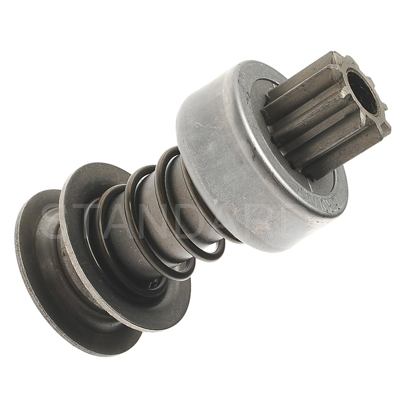

    I have both Ross drives for his mini-starter. Yes, I got right around 1.0" with vernier, spun the gear because it's odd number teeth, to get the rough OD.
    on the other one, it's around 1.150" for 303 olds and early Cad OHV8

    Paul if the crank gear on the chevy starter is wrong, do you think it would be possible to swap bendixs?

    Paul and Frank especially, take a look at this. Look at the writing on the box. Does this look like a '54/'56 olds bendix to you guys? It was listed online as '56 chevy PU.
  22. F&J
    Joined: Apr 5, 2007
    Posts: 13,223
    F&J
    I can't remember from when I had both starters apart. One was 54-56 Olds, other one was 53 Olds.
    The 53 is the only 303 12volt, but still uses the coarse teeth flywheel like earlier 303.
    Back a few posts, I mentioned the starter body differences between the two. The pieces won't swap. The armatures are even different lengths, along with the field case.
    So, looking at the box writing, it sounds like a lot of GM vehicles went with the newer longer starter in 54?. So, there may be hope.

    This is listed as '56 chevy bendix for sixes and V-8
    My thinking is, if the rest of this bendix looks the same as the one in a '54/'56 olds starter and just the gear is different, then it follows that if necessary, you could swap the olds bendix into the chevy starter. Another thing I have been looking at is the chevy 6 starters themselves. I had it wrong, I was thinking '53/'54 would be the same, looking online its actually the '54-'56 chevy 6 starters that look the same, which dovetails with the same year Olds starters. Maybe its a '54/'56 chevy 6 starter with an olds bendix that is the hot tip.
