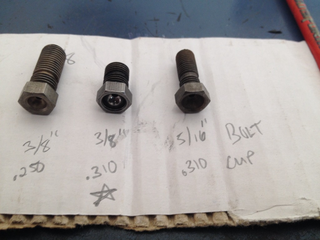

    To date I've only found one screw(bolt) that has been correct; which I'm thankful for.
    But as a point of reference for others here's a pic of some of the more common.

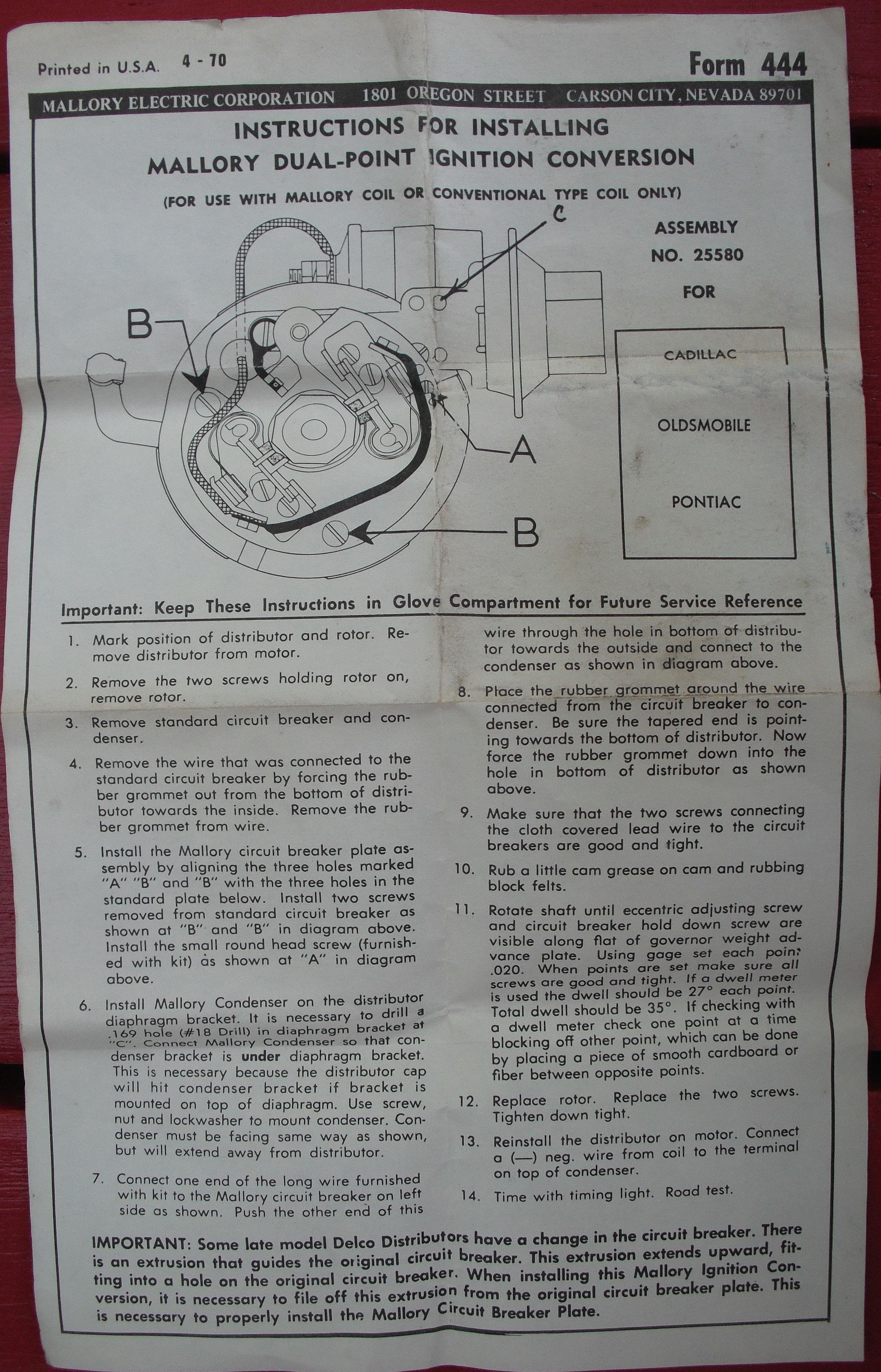

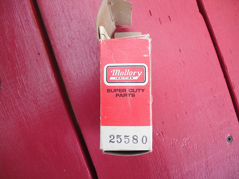

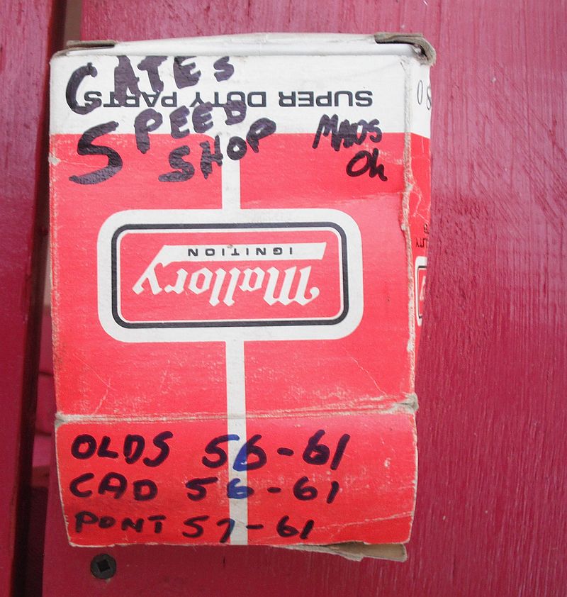

    picked up this little box of NOS goodness recently, but I'm a little puzzled by whats written on the box in felt pen. One would expect that there would be a change to distributors in '57 with the tall deck motors, but was there a change in the distributors in '56? So if I am going to use this with a short deck motor, I need a '56 distributor? Can anyone shed any light on this? Anyone have an old Mallory catalog they can look up part # 25580 in, and see if its listed as fitting '56-up?
    olds dual point conv. 001.jpg olds dual point conv. 002.jpg olds dual point conv. 003.jpg olds dual point conv. 004.jpg
