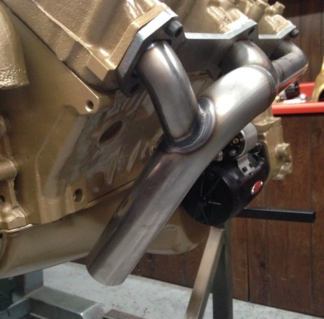

  26. I don't know anything about the noxious customs headers, but check out the slick headers Matt (SaltFlatMatt) has at GearDrive. Tight fit, super solid piece.
    Support a fellow Hamber!

  27. The_Stig
    Joined: Nov 30, 2012
    Posts: 54
    The_Stig
    Matt's headers look cool and flow gas certainly better than stock. However, equal-length tubes make the best headers. Anything short of that is a waste of time

    Joined: May 5, 2008
    Posts: 2,315
    Koz
    Those headers are the nuts! Sort of feed my Sandy Belond fetish!
    I'm back working on my 324 for the roadster and amazingly my headers look very similar to the above. I know equal length is the way to go but Sandys' just have the look!
