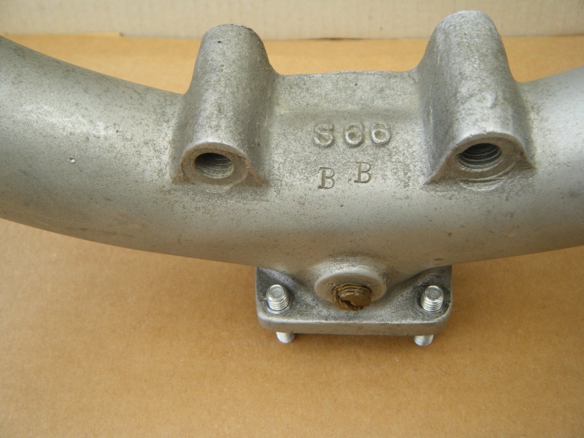

    A word on Winfield part numbers & stampings; the company apparently used the "S" prefix for all S/SR carbs & intakes. The typical 90* elbow choke housings are numbered S-41 (then size; A, B, C, etc.) Fuel inlets are S-31, "S" float chambers are S-26, and so on and so forth.
    S-66 would be the Winfield part number for an S/SR downdraft manifold. The 'size' would then be stamped near the cast-on S-66 part # (FWIW, updraft carb adapters carried p/n S-65). Here's a photo of mine;
    I am 99% sure that the intakes were matched to each size; A, AA, B, BB, C...with the differences being found both in throat diameter and in the mounting stud spacing. Don't think a BB would work on a B intake without modification. Our own @Carter runs a BB (I think) along with matching intake...hopefully he'll chime in.
    I'm positive that Winfield's name was cast into most, if not all of the intakes. The one you saw may have had the lettering filed off, or may be a reproduction which copied the manifold but omitted the name.

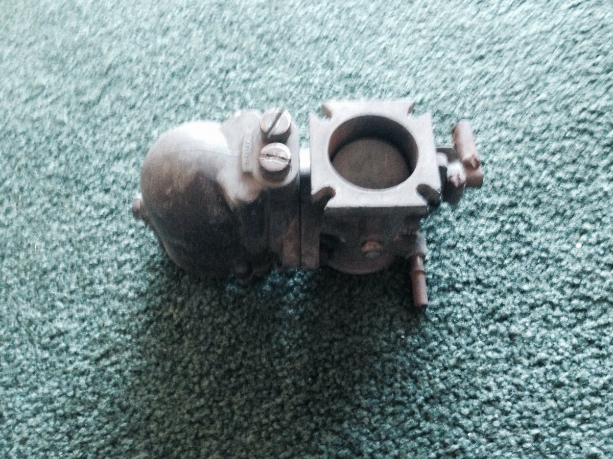

    You're welcome waxhead. And yes, I would tend to agree with Gary. By the way here's the base of my BB carb with modified bolt holes...I've seen a few like this. As suggested, to fit on different size manifolds. Make it work...that's hot rodding!

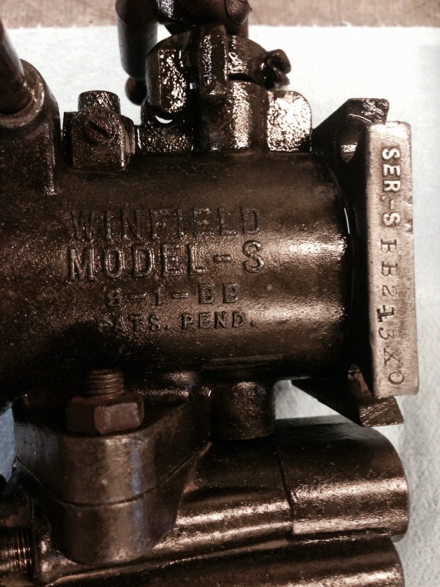

    Here are some pics of the carb numbers Gary. The internal tubes in the first pic are all AA and the inlet is stamped A as well. Not sure if there are more I should look for. I'm trying to learn more about these so any and all help is much appreciated. I also have a beat up "red head" to complete the package. I'll get some pics of it as well. Thanks again to all for the info!
  19. Looks like you have a BB throttle body with a AA float bowl. I seen a lot of BB's with B float bowls. I would try it as is, might work just fine. If you really start looking for this stuff your going to see all kinds of arrangements.

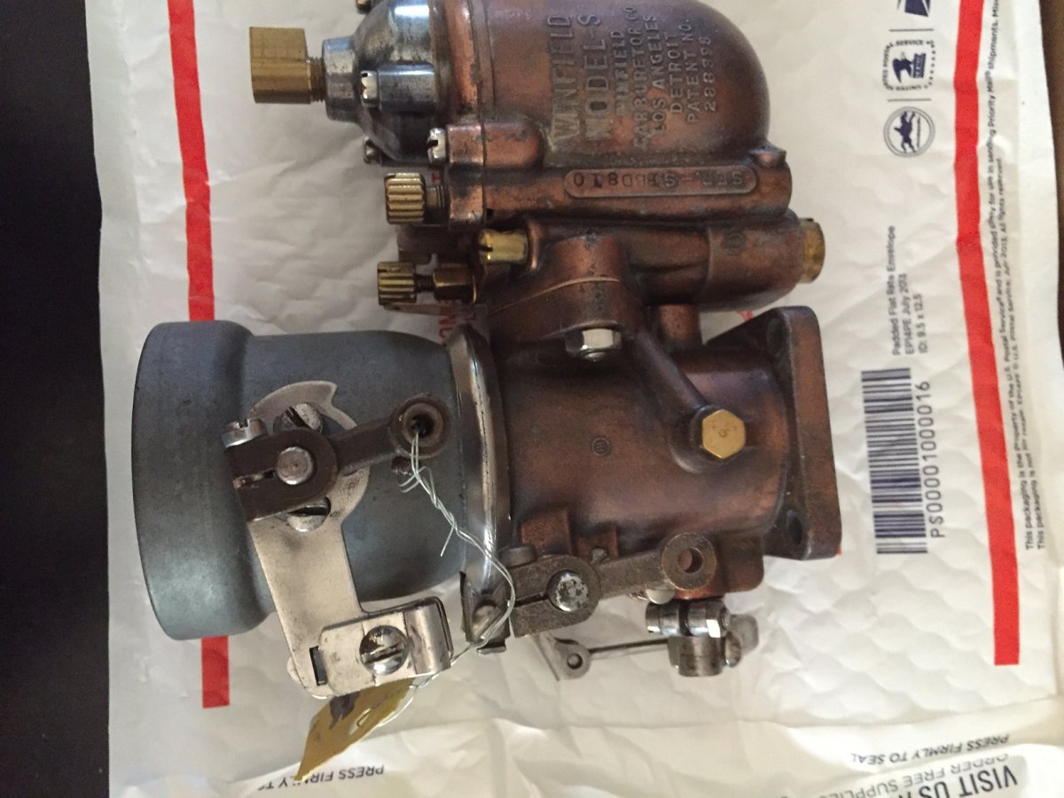

    My xmas present arrived early this year. It is a shame I am at work and haven't seen it in the flesh. Pictures taken by my 11 year old son from home. S-BB-D carb. It appears that there is a small threaded hole in the top of the choke (see 3rd picture). Does anyone know if it is standard, and if so, what purpose it serves? To maybe hold an air filter in place using a grub screw??
    Carter likes this.
  22. Not sure what the hole is for, never seen anything attached to a Winfield choke in any old photos. I have a Winfield SR BB with the same choke, same holes. I do run a small brass screen between the choke and throttle body to keep bugs or whatever from entering the carb body. Cut it to fit the top of the throttle body and the choke housing and clamp hold it in place. Can't be seen unless you look for it. Nice looking Carb. Ken

    Merry Christmas! Nice carb with the original plating in good condition. Bob

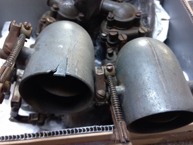

    I'm in dire need of a replacement choke horn, just bought these and they didn't survive the ride very well. winfields 001 (640x480).jpg

    ^^^^^^^^^^^^^^^^^^^^ Stuff like that really bothers me, carb is 85 years old and some clown can't wrap and pack it for a ride to its new home. How much of the profit would he have lost on fishing some bubble wrap out of a dumpster behind a shopping center? Bob

    Bob, That's about how I felt but I contacted the seller and he offered to make it good, just have to find a replacement.

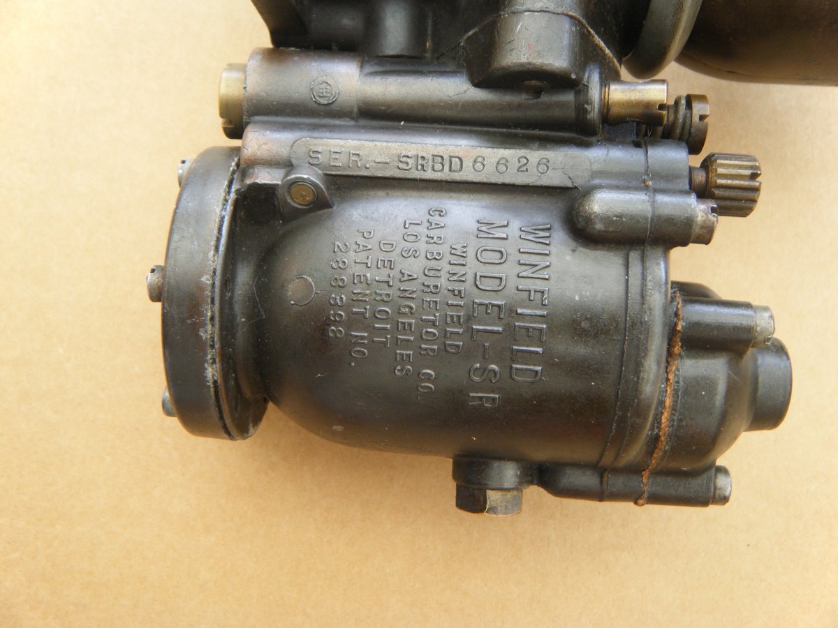

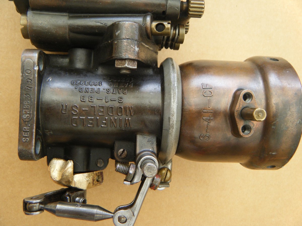

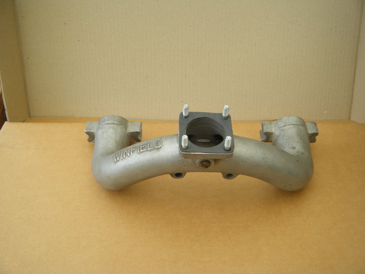

    I finally managed to get myself a Winfield BB intake manifold. The only catch was that I had to buy the carb it came with also. The dilemma I have now, is which carb to run. I have a Winfield carburettor S-BB-D with BB float assembly and BB throttle body. The carburettor that I just got is a SR with B float and BB throttle body. I definitely like the look of the SR carburettor better, but my guess is that the S-BB-D will probably run better due the matching float and throttle sizes.
    Will I have issues running the SR carb because the throttle is a BB and the float a B?? Open to suggestions and recommendations.
    SR carb
    SR carb float
    SR carb
    SR carb throttle

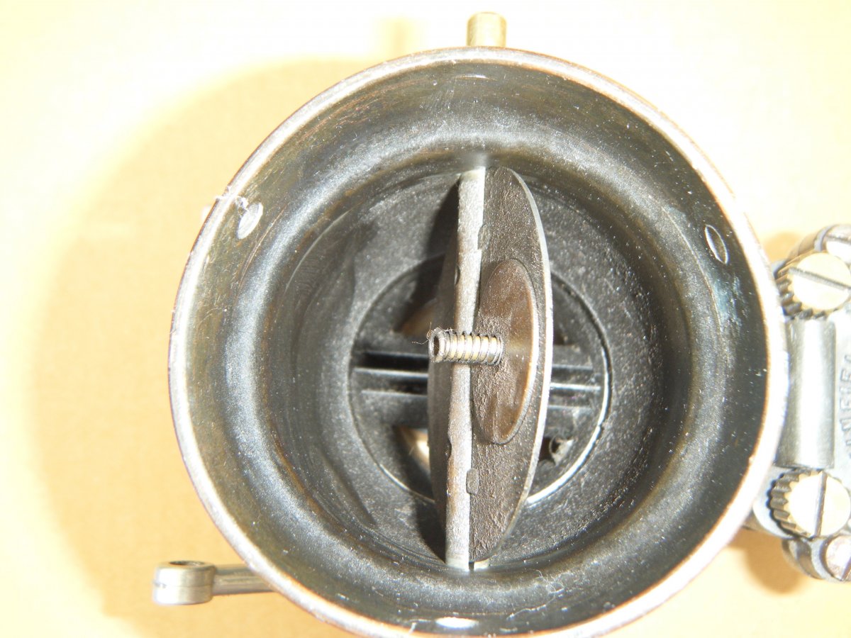

    Here is the SR carb choke disc. Does anyone know why this disc has a smaller spring loaded disc on it?? The S-BB-D carb choke disc does not have this.
    And the BB intake
