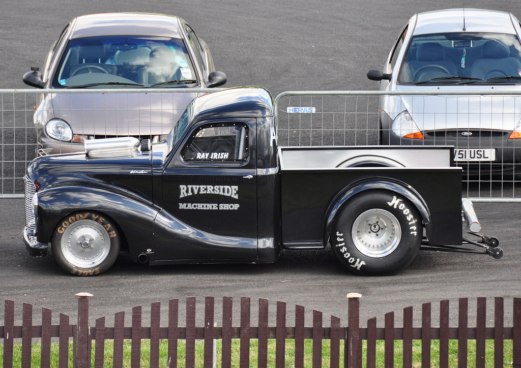

    If 9sectruck jumps across the pond and his ride lives up to the name, then he may have to put a tow bar on the back of it and haul me a cross the line just to keep it close. The again, I'm, hoping for a bit of improvement on the performance this year. I just need to find the time to actually put the little beast back together and sort it out. The Prefect is taking up a ton of time.
    Saxxon,
    Username refers to my last ride, an Austin pickup which I never thought I'd sell but temptation in the form of the Willys came along so after 19 years we parted company, ran 9.60's with a 434 small block.
    Think I might have to make my new username 11sectruck as don't think this one will go much faster...........yet.
    Love the farm truck btw and the Prefect, guy that crews for me has one.

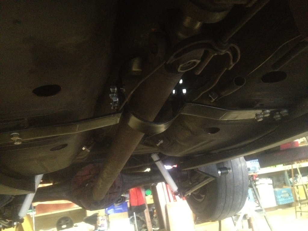

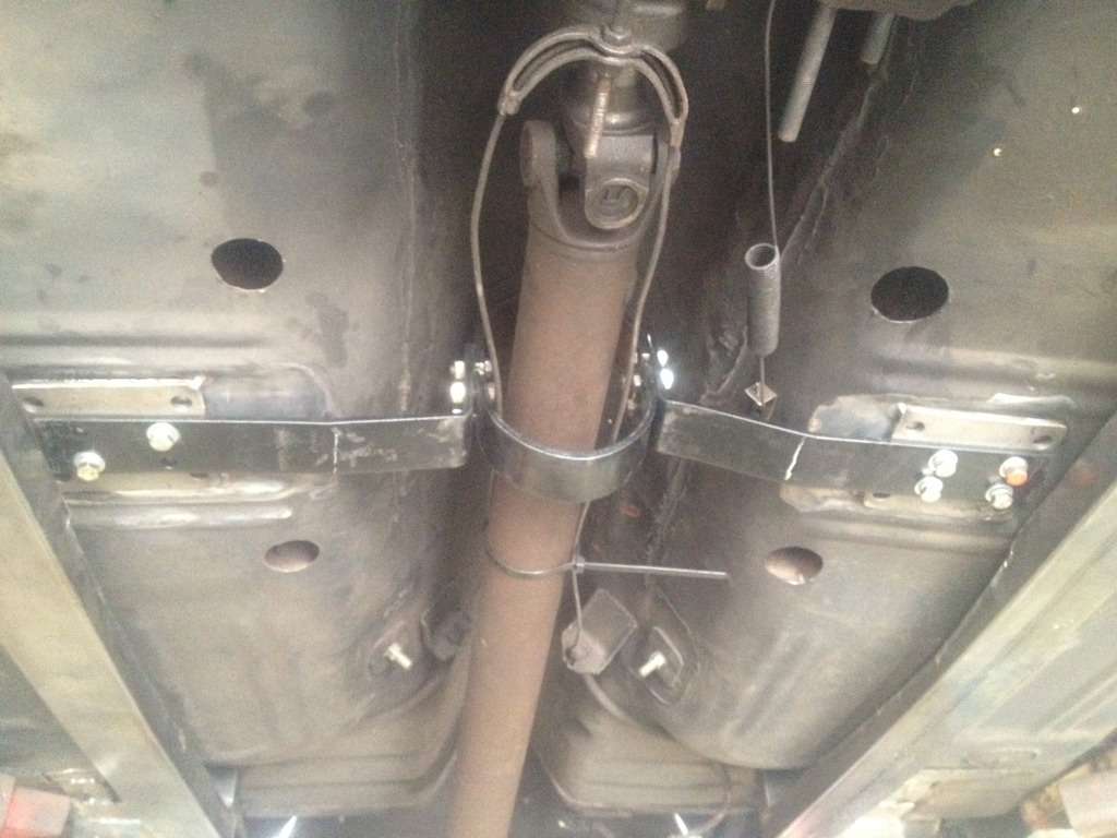

    Got the driveshaft loop finished up today....some modified kit pieces,some fabbed pieces,but it all went together.
    It's just hanging there mocked up in the picture,not finish installed.
    Also got the Traction Masters in with a new fabricated mounting point,but my pictures didn't turn out...will post more tomorrow.

  11. Bad Banana
    Joined: Jun 20, 2008
    Posts: 834
    Bad Banana
    Hard to tell from the pics but that looks more than 6" from the U-joint?
  12. Finn Jensen
    Joined: Dec 20, 2008
    Posts: 675
    Finn Jensen
    I was going to say the same thing, but it doesn't look like it would be difficul t relocate forward a bit if required.
  13. powrshftr
    Joined: Mar 29, 2013
    Posts: 4,543
    powrshftr
    Fack....there were beads in the floor pan in either direction so I mounted the brackets there.Its about 8 or 9 inches at most.Is that going to be an issue?I thought it was 12" from the u-joint?
    Scott
  14. saltflats
    Joined: Aug 14, 2007
    Posts: 12,602
    saltflats
    from Missouri
    Scott the rulebook says 6 inches from center of front U joint to the front edge of your drive shaft loop.
  15. powrshftr
    Posts: 4,543
    powrshftr
    Ruh Roh......Guess I have a wee bit more fabbing to do!:(
    Scott
  16. Bad Banana
    Posts: 834
    Bad Banana
    That is maximum. Can be closer.
  17. powrshftr
    Posts: 4,543
    powrshftr
    I must have finally hit on a bit of good luck:
    From centerline of my front u-joint to leading edge of my loop is......
    EXACTLY 6"....!
    Now that I have used up all my luck,I'm preparing for every other job on the car to leave teeth marks in my ass....lol
    Thanks guys.I really appreciate everyone's help.
    Really looking forward to meeting everyone at the Meltdown.
    Scott

    Got the loop installed for good today ImageUploadedByH.A.M.B.1398475676.933560.jpg

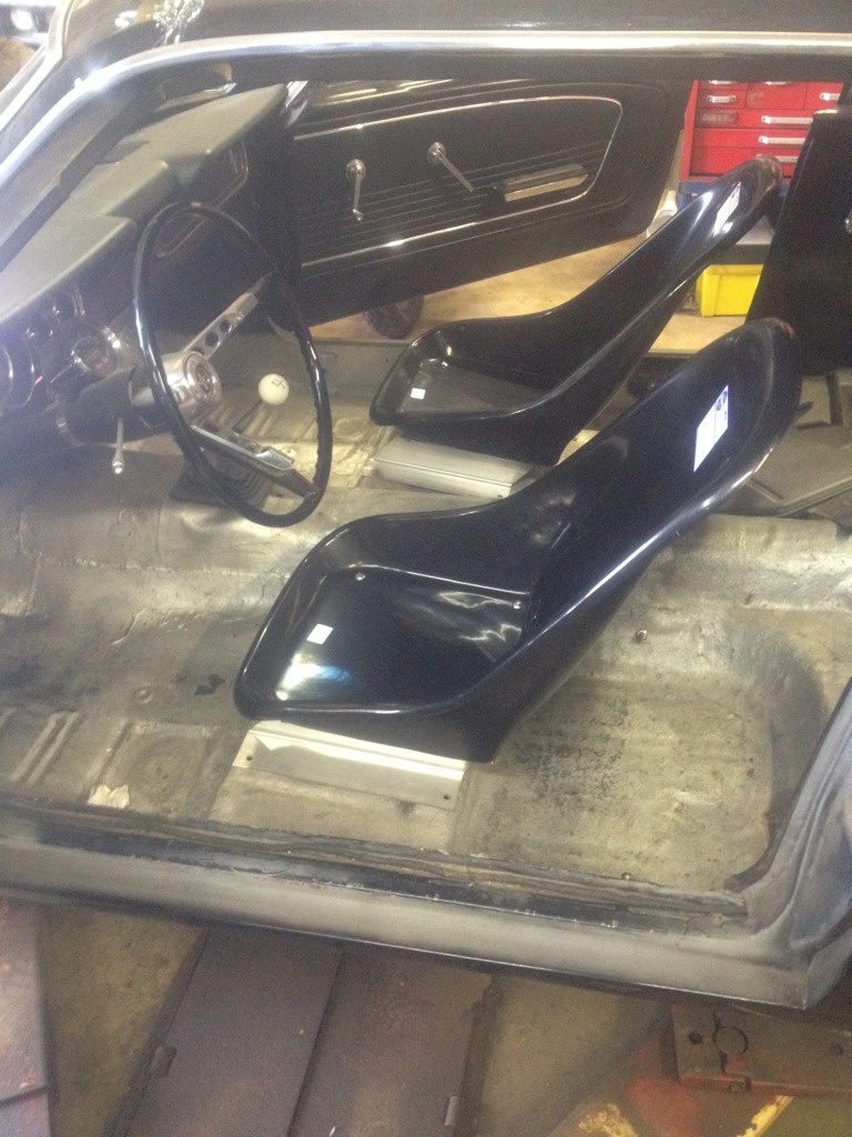

    Got the seat brackets bent,cut,drilled,and test fitted

    The Prefect took it's first tentative steps out of the shop... Ok...we pushed it into a trailer and took it to a car show... in snow storm.
    The Rodarama show is put on by the Manitoba Street Rod Association. It's a no frills up close and personal event held in the middle of 2 hockey rinks. It's a very cool little gathering. The MSRA barely tolerate drag cars and are totally against trailer queens of any kind. But the hard core rod guys really liked the Ugly Beast and it's one of the few cars there that had folks stopping and there was a lot of smiles, pointing and and headshaking... I love it. A few of the old school guys actually asked if this was a restoration of a true barn find. We took that as a compliment...
    Here are some crappy pics of the Ugly Beast's first public appearance
