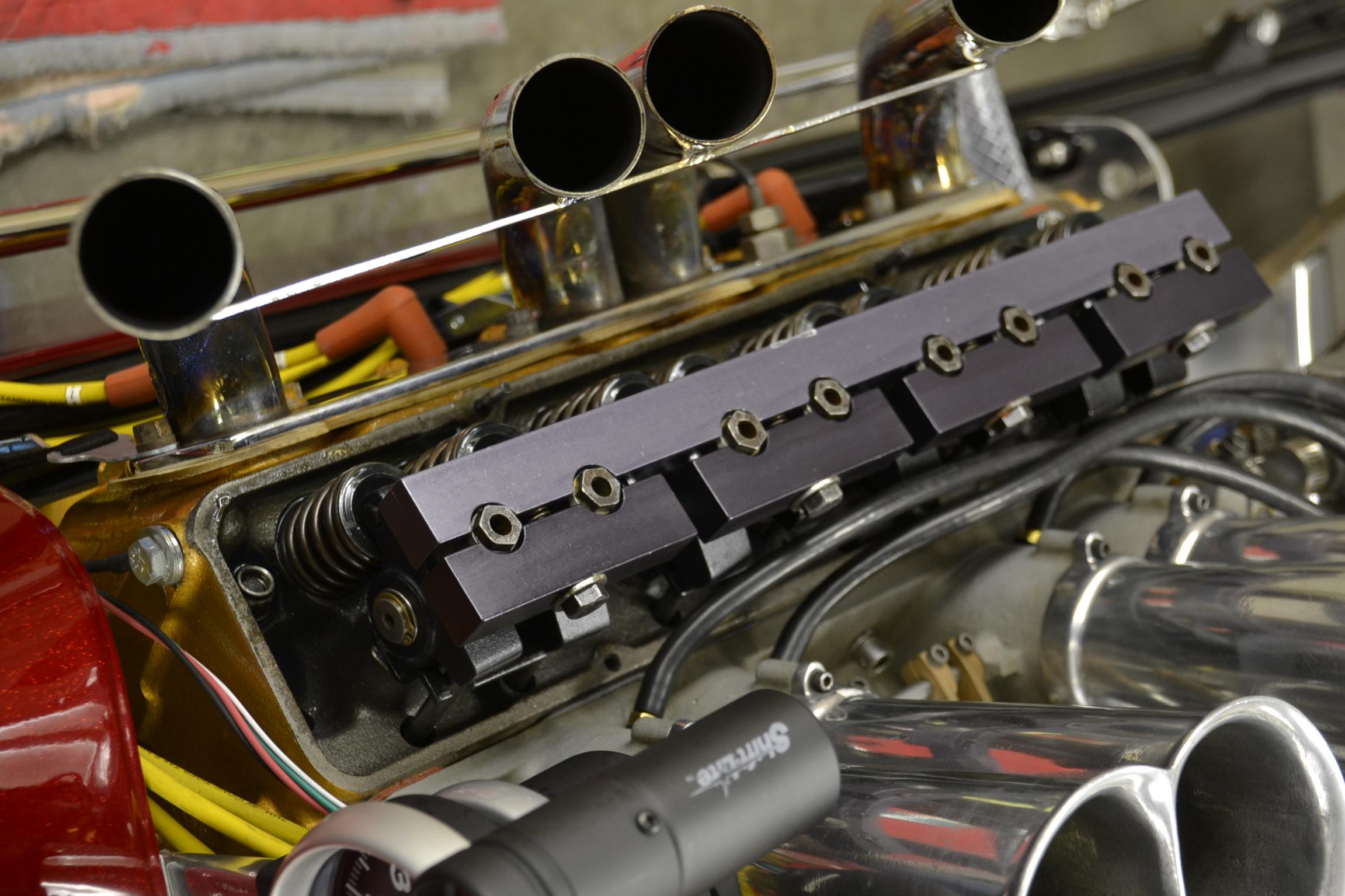

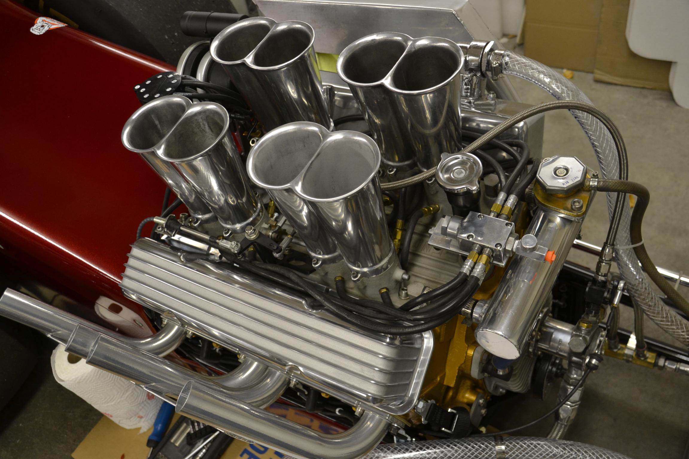

    I have a question for you guys, How close can I set the stud girdle to the rocker arms. I bought some finned valve covers with the crested top and the ends hit the girdle. I have thick gaskets and spacers but when I raise the valve cover the flange hits the start up fuel lines.
    Wondering how close can I set the girdle to the rocker arm.
    thanks

    Shave the corners off of the stud girdles. Doesn't take much...never had a problem
    I had to do that to get my valve covers to clear between the rockers and the blower manifold

    I have a pair of B&B spacers, they won't work for this set up. The valve cover flange has to stay below the outside fuel lines. I need to lower the stud girdle or remove the warm-up fuel system....I'd like to keep it on the car even though I'm not running nitro. Just wondering how close can I drop the girdle.

    I thought about rounding the corners off, I'll probably need to machine them a little as well. The girdle Has about 3/8" clearance on the rockers right now. I think I'll need to take from both to fit them on.

    3/8" is a ton of room. You can get pretty close as long as they don't touch anywhere as you turn the engine over. I would leave maybe .040"-.050" from the closest point to be safe.

    Sounds good, I'll set them to .050 and round the corners as well.
