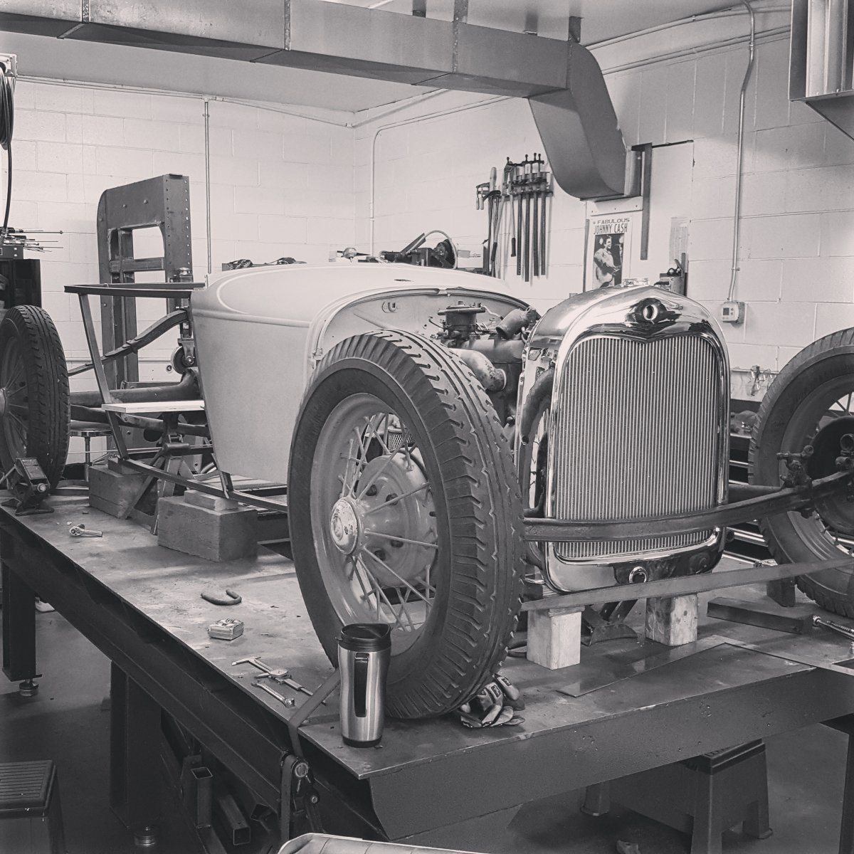

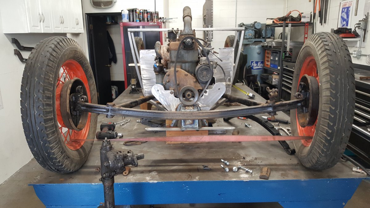

    I recently came up with a running and model A chassis, not really sure what I had planned for it I put together some of the pieces that I had laying around. I formed up this Model A Roadster pickup, and really it just didn't do anything for me.
    In truth I probably should have just went forward with it after all was just a flip project, but I prefer to just let my mind wander little bit and make a project that I was actually excited about. So I extracted all the drivetrain running gear from the model A chassis. And set the frame out against the fence. After I had all the pieces on the chassis table and mocked up I came up with a perimeter frame that resembles a Lakes modified made from 1 inch square tubing. The Late Model Model A Grill shell was just too tall so I swapped it out for a 28 29 Grill shell and radiator.

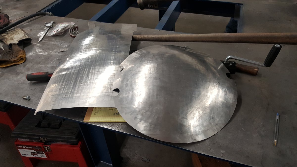

    To really do this right I needed to get my English Wheel Parts out of the attic that I have had for probably over 10 years and never fabricated the pieces to use them.
    First few attempts at metal shaping on the Wheel.

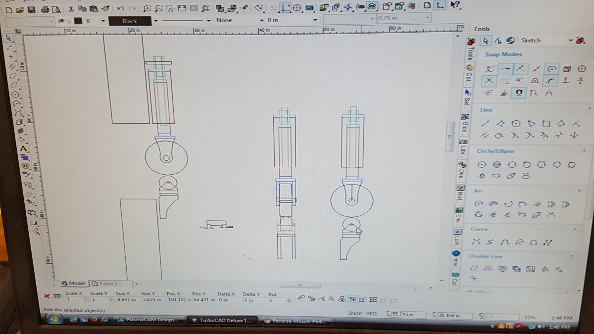

    Design and mockup of parts using .060 aluminum. Cut a piece, fold it up and learn what you need to, adjust the CAD drawing and cut another....makes for interesting scrap

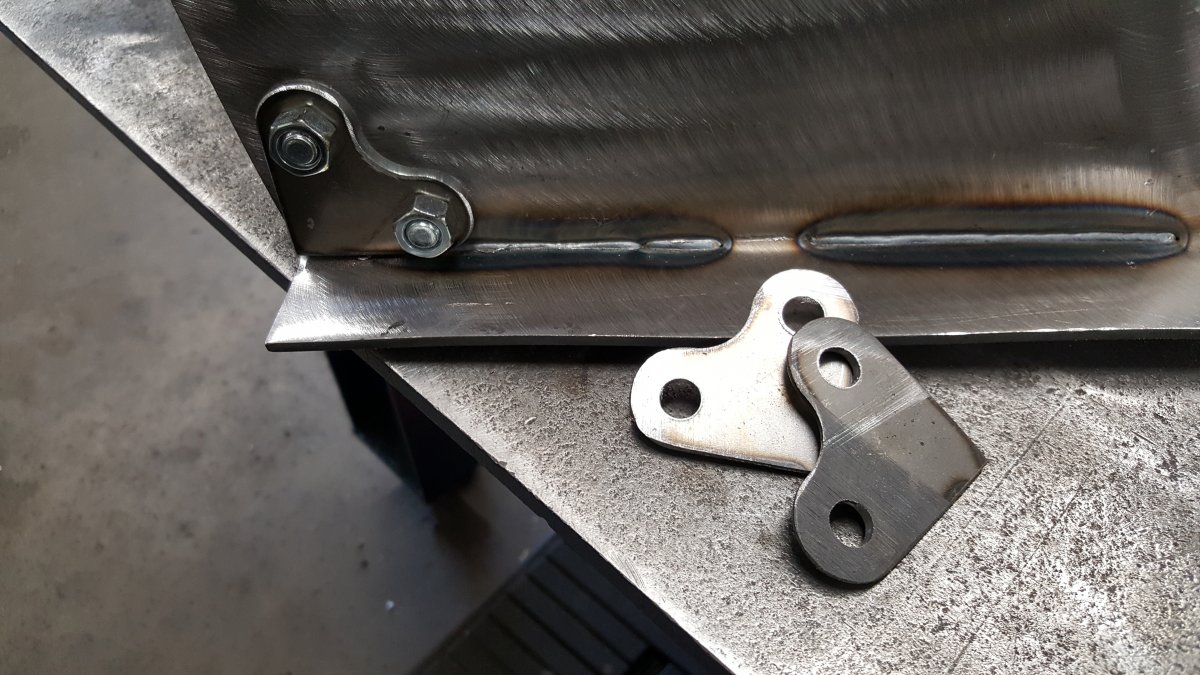

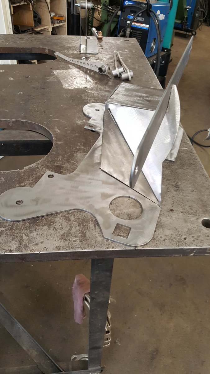

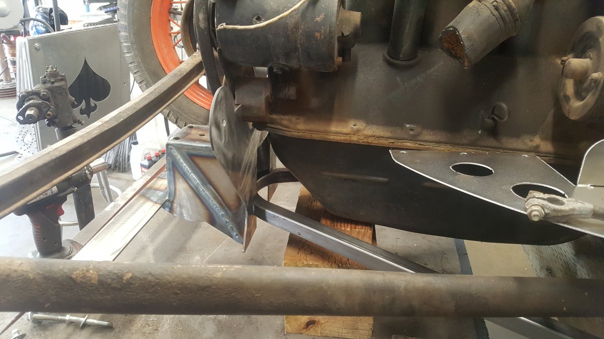

    After a good sit and stare i decided that the side wings where I was at attatching my support struts was going to cause an issue with flexing and would require a ton of gusseting to make it work, therefore I decided to cut off those wings and attach my cross support structure differently.
    Plasma cut out some pockets in the back side.
    Cut out some brackets for the struts that would allow tge front structure to be removed from the motor plate.
    Bent 2 sides of a triangle from 1" x .125" for the support struts.
    While i think we are getting to where it will work I think I will keep thinking of a more elegant design.

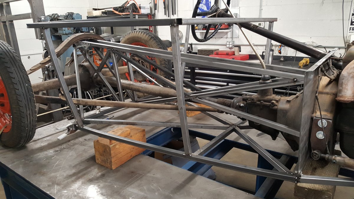

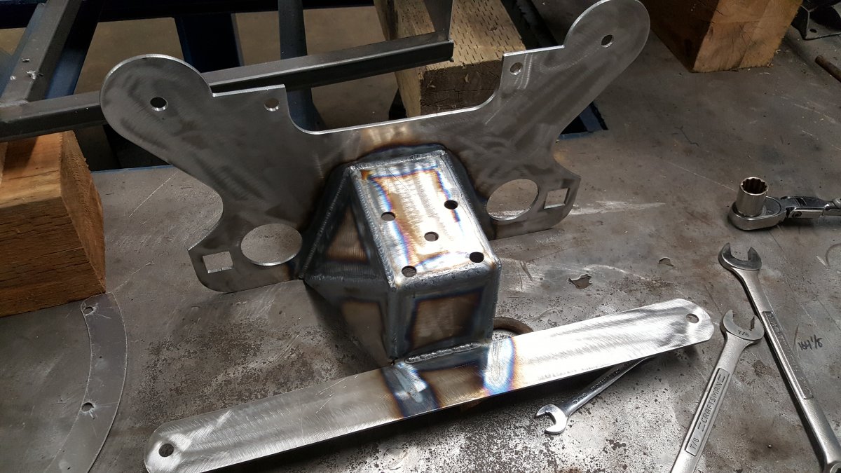

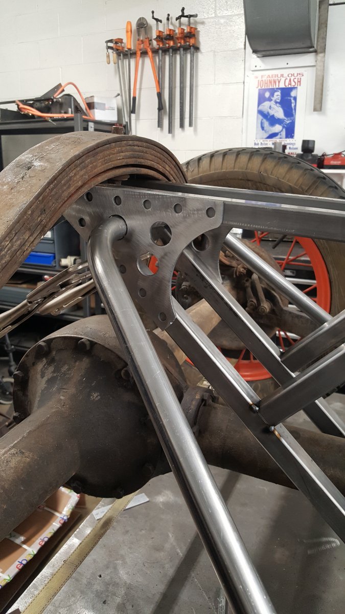

    Next step I built a substructure in side of the body to transfer the forces from the rear suspension to the front, I built these weld plates that bolt in at the motor plate so that the firewall/motor plate is still removable.
    The upper holes shown above will go through tubes which will sandwich the throttle bracket and into the block for a little extra support.
    If you can look through the Maze of square tubing you can kind of see how it is shaping up.
    This is a shot of how the rear spring will be supported. The gas tank will Mount above it and there will be a gusset to tie the top of the body into the substructure.
    The rear suspension is triangulated into the floor assembly and this transfers up to the transmission and this is how it will tie into the back of the transmission.
    All of the holes in the gussets are for rosette welds.

    Here is how the rear spring is shaping up. I ditched every other leaf as a starting point. 20171007_141842.jpg

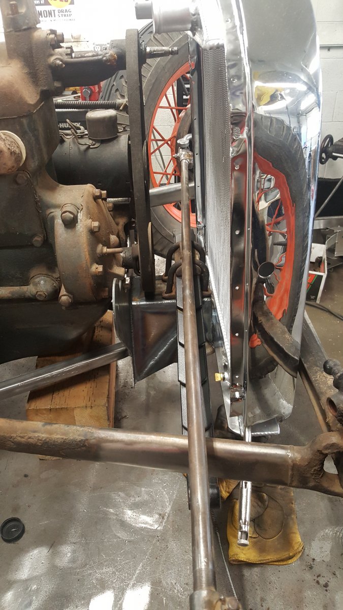

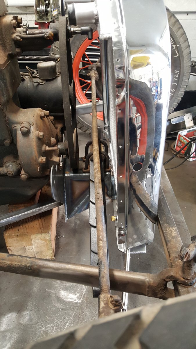

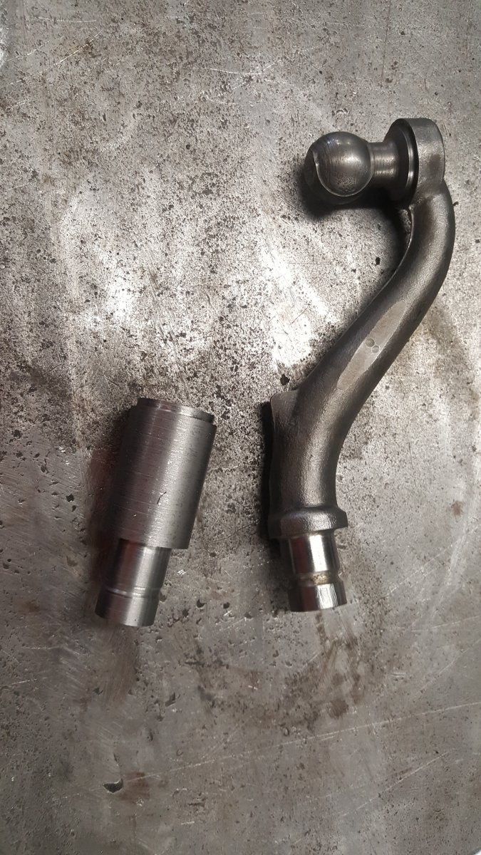

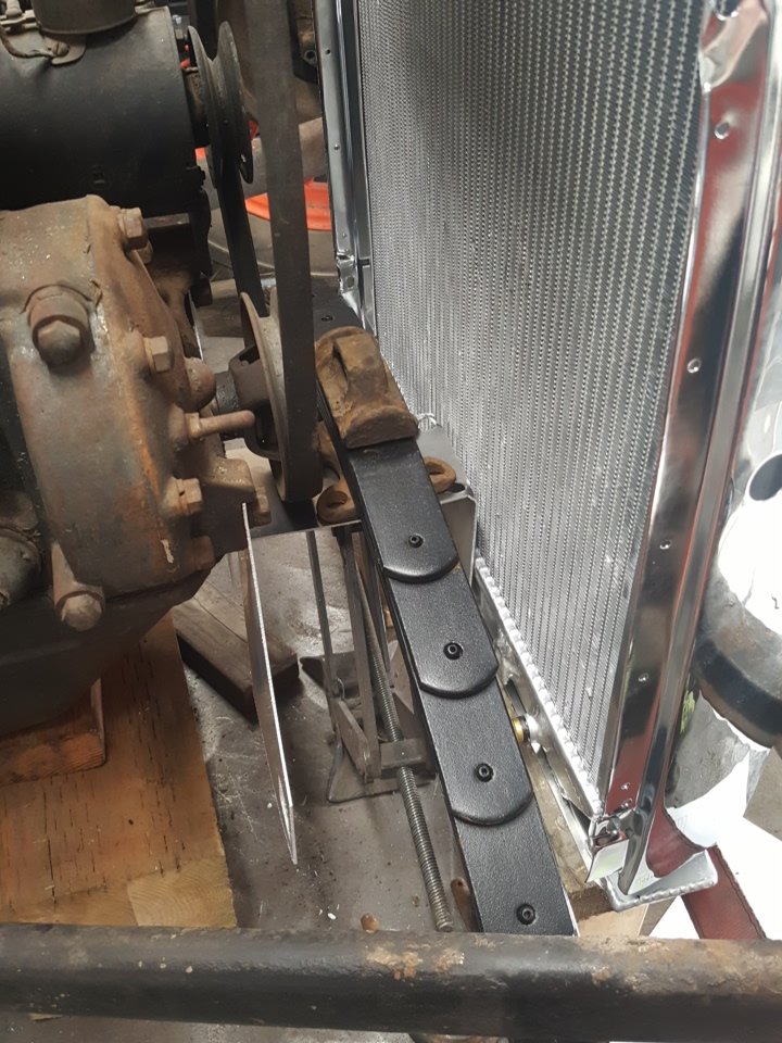

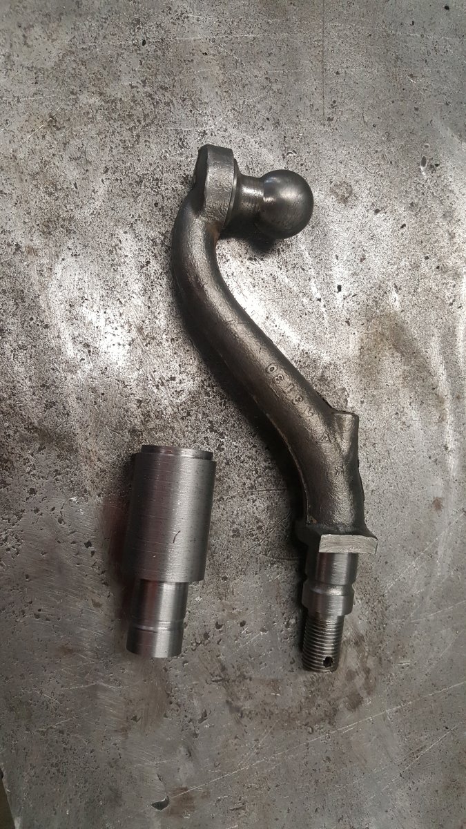

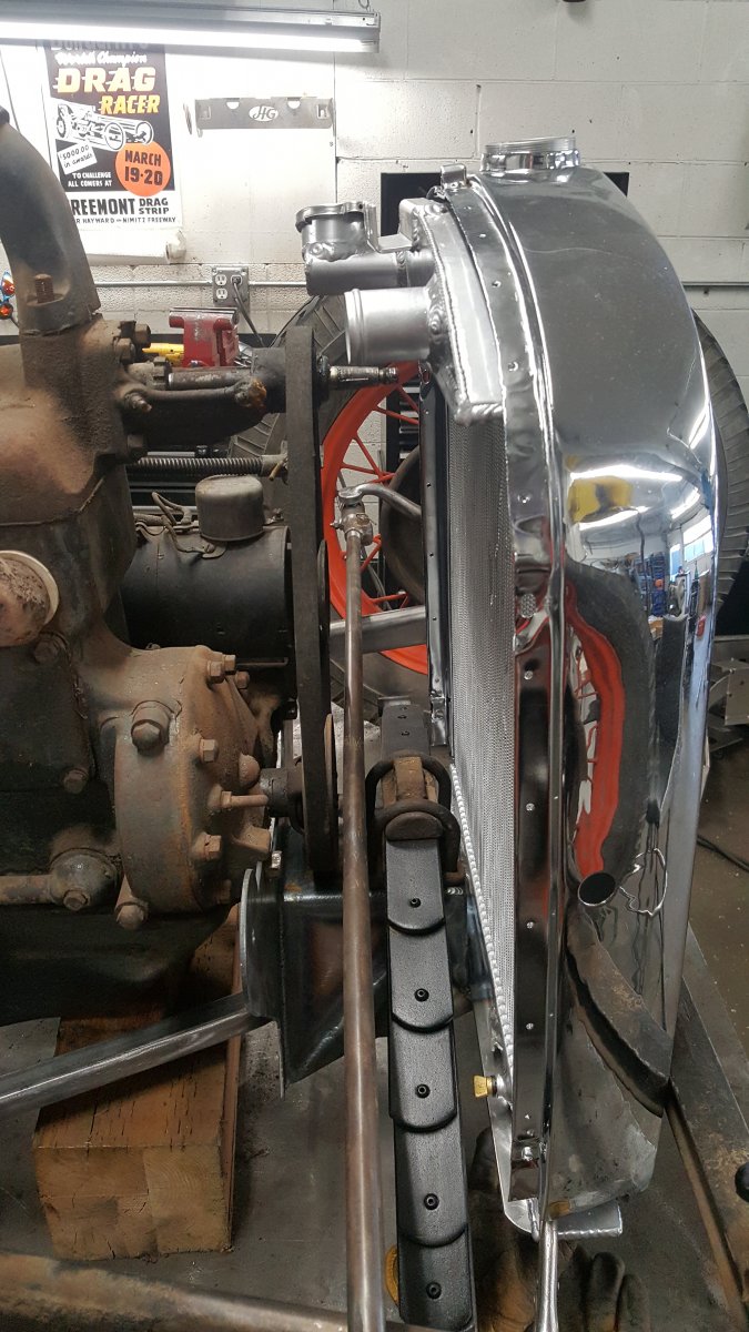

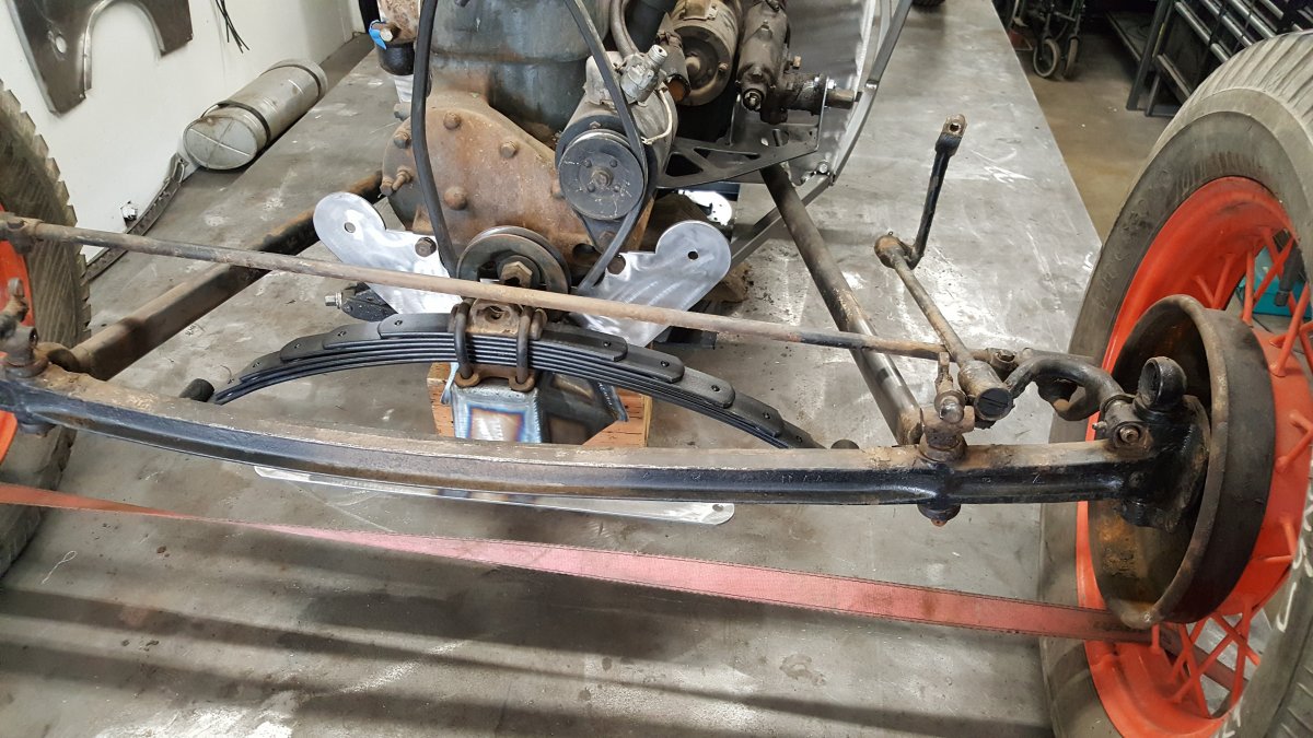

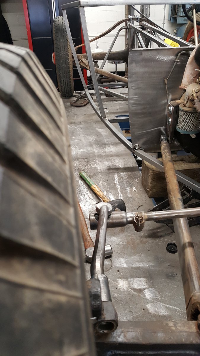

    Working on the steering a little I found that the stock tie rods would nearly pass above the spring, and at full lock left no room for a cooling fan.
    Back to the sit and stare
    Turned the whole assembly upside down, this cured the spring clearance issue but required cutting off the drag link arm.

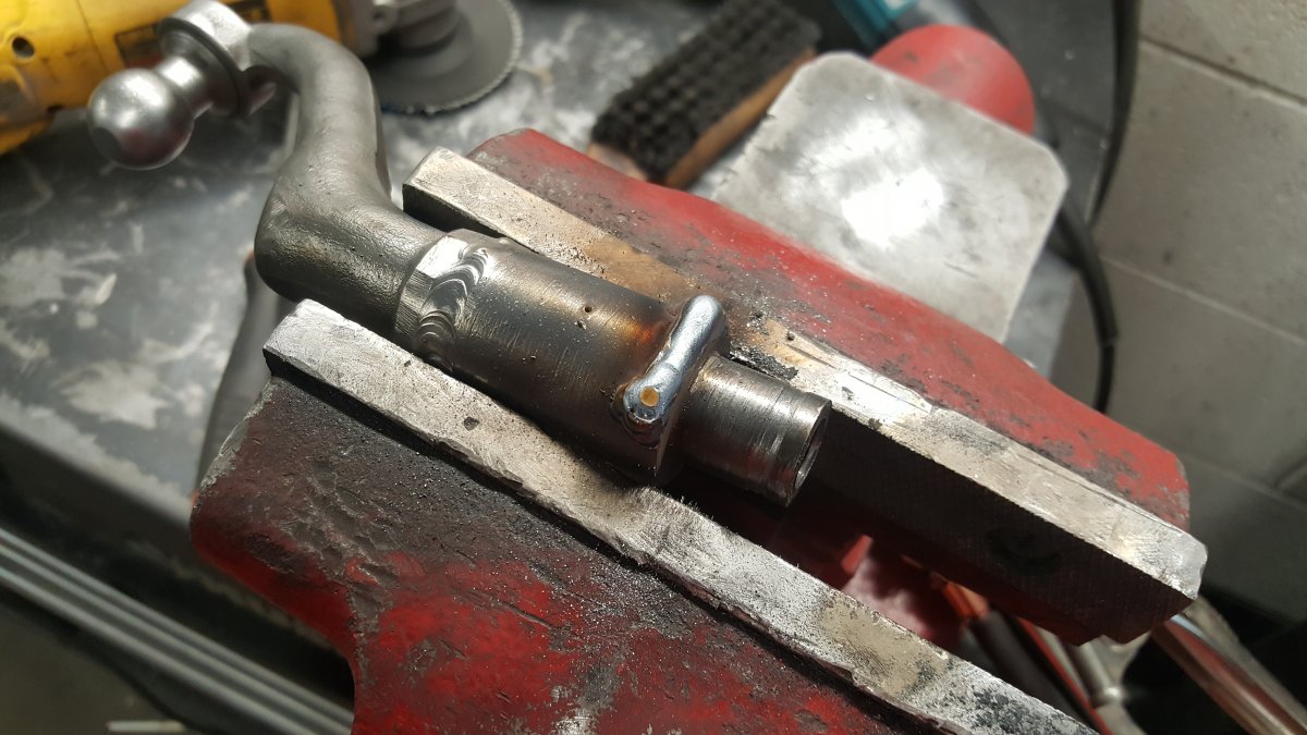

    To fix the fan clearance issue, I turned these inch and 3/4 spacers to go between the tie rod arm and the spindle. I machine them to an interference fit.
    I cut the threads off the original steering arm
    I probably got a little bit greedy with the interference fit and nearly didn't get them drove all the way on, but finally got them driven home.

    20171009_150734.jpg the arms after tign on the extensions. The model a's use a square shoulder to keep them from spinning, this required a little additive manufacturing.
    20171009_153128.jpg and work with the hand held milling machine.
    20171009_154147.jpg 20171009_155502.jpg clearance at full lock looks much better
    20171009_155828.jpg clears the crank pulley when centered.

    What happened to the KPI when reversing the spindles? Did you bend the axle near the king pin bosses?
    Superb machining and welding...
    Unkl Ian likes this.
  26. rottenleonard
    Joined: Nov 7, 2008
    Posts: 1,935
    rottenleonard
    Actually i just changed the steering arms side to side and upside down, the spindled are still in their stock location.
