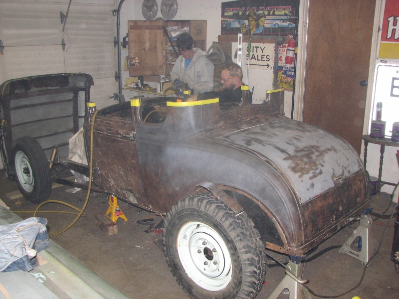

    This is a build of a car between 2 friends in a small garage. My buddy Kevin bought a (barely) running Model A Coupe, after driving around the block a couple times he pulled the body off. The plan is a Traditional Model A with a 283 and 4 speed, a REAL Hot Rod ! all this takes place in my garage. We are both family guys with kids and full time jobs so time is sometimes hard to get, mostly 3-4 hours after work so progress has taken a while but it has been a blast I will catch you up, then update from there Thanks Joe The first set is when the new running gear meets the crusty body for the first time

    cool! is that a boxed original frame?

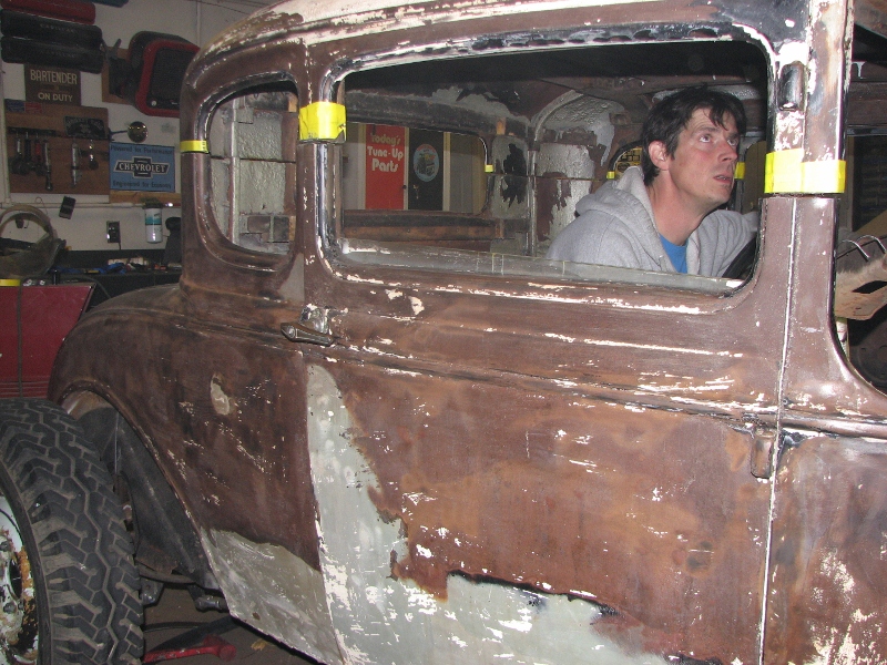

    next are some of the channeling

    yes sir with all pete and jakes cross members

    frame is original boxed and stepped in the back, motor is 1963 283 ,saginaw 4 speed, ford 8.8 all pete and jake cross members and ladder bars, axel is 4inch drop so cal, 40 ford juice brakes, clutch and brake pedal set up is also pete and jakes, shocks are original nos oil filled bought from kevin bacon! he is on the hamb, crazy i know he lives in omaha..weird huh?

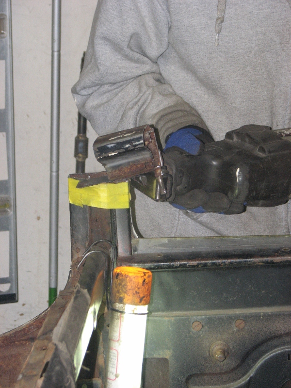

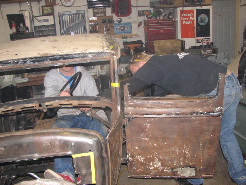

    no east coast here boys she got a 3 inch cut! DamnitDave stopped by so we cut the top off, why not

    next was saving the top the previous owner had welded a patch on the top(very very poorly) so very carefully we removed it..it was lucky we went past the nailing flange with the top welding massacre. after paint we will install the vinyl top on!
