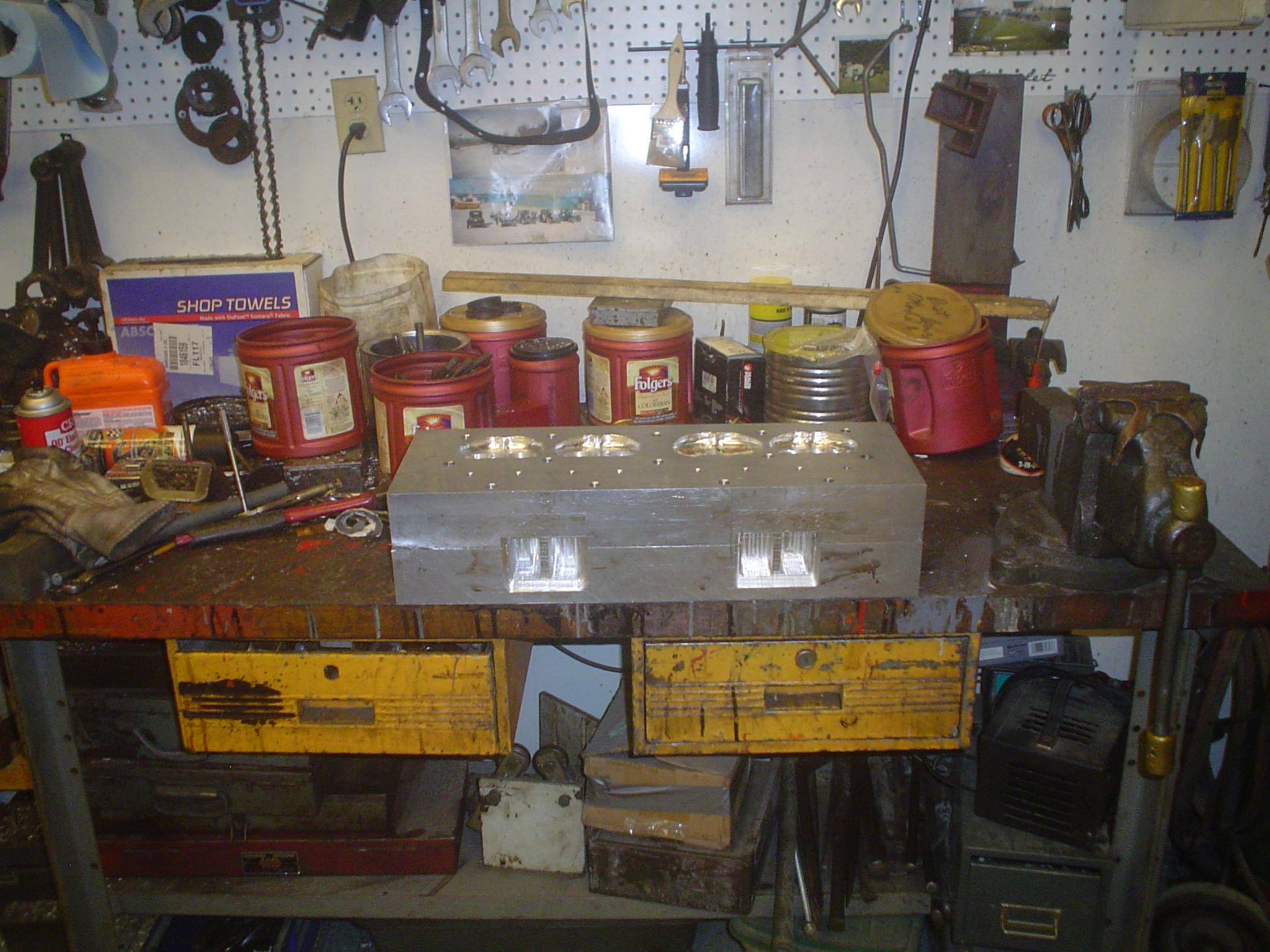

    Started the intake ports to day cc the heads. It is about 9-1 compression a little more than I want. The intake ports are a little hard because I have push rods and head bolts in the way, plus it is a long way through the head to the valves.

    from NC usa
    When you free hand on a mill you use both hands, and move the table two ways at the same time.

  17. George Miller
    Joined: Dec 26, 2008
    Posts: 413
    George Miller
    from NC usa
    Now dammit George, your cheating. Show us the set ups. Just seeing the result teaches me nothing.
    ___________________________________________________________________
    Sorry but there really is nothing to see. Just bolt the head to the table, or angle plates and go to work. I used drill bits, end mills. Different sizes some with a hand ground radius on the end. Then just free hand the big radius.

  21. George Miller
    Posts: 413
    George Miller
    from NC usa
    This is it tell next week. Putting in the exhaust ports.

  24. Flipper
    Joined: May 10, 2003
    Posts: 3,395
    Flipper
    from Kentucky
    Those look like some pretty long tunnels that you are carving. I had no idea that you were raising the ports so high. How big is the chunk of metal you are starting with?
  25. George Miller
    Posts: 413
    George Miller
    from NC usa
    Yes the Intake runners are long, the head is 8" wide. The reason they are high is to get a better line to the cylinders.
    That is the bottom half of the head, now the top half next.
    Material is 2 pcs of 2 1/2 x8x20
