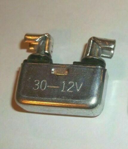

    "I have a couple of those little square breakers with the round terminals..."
    Squirrel, or anyone, could you post a picture?

    I'll borrow a pic from ebay of one I bought for the car....
    I noticed that you can buy new ones that have the "ears" pointed the wrong way, towards the center. That's one problem with Chinese copies...sometimes they just are wrong.

    I got the 30 amp breaker in the mail yesterday...NOS Wagner, made in USA, stamped on it. I put it in to replace the 20 amp main fuse.

    That breaker has a large moment arm for vibration (At my age, the only moment that I can calculate is a "Senior Moment" ;)). I had a blade style 30 Amp breaker in an OT 1975 Scout II, the vibrations eventually tore-up the sockets in the fuse holder - the intermittent connection resulted in some truly impressive backfires at 75 MPH. Expanded the muffler case a couple of inches...
    I fabricated a small sheet metal clip to secure the circuit breaker in position. Sorry, no pictures found on my computer, a crude "word picture" (less than 1,000 words) follows:
    Breaker end of the clip goes over the top of the breaker - Imagine a hand clasping the top of the breaker - Thin layer of rubber between the breaker and the clip to dampen any vibration.
    The firewall end of the clip (imagine an elbow) is bent 90 degrees, has a hole and is screwed into the firewall with a self-tapping screw. Length is adjusted to lightly compress the rubber at the breaker end of the clip.
