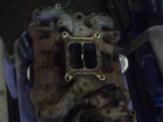

    Plenum
    Plenum is opened up to match a holley four bbl two slot space ALL the way to the bottom. Sharpe edges rounded. ports matched to gasket.
    Don
