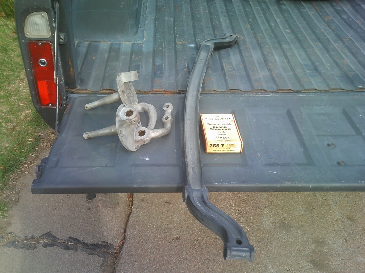

    I dropped the '41spindles off with Okie Joe at the Roundup in 2011 and a few weeks later took a trip down to his place to pick up a dropped Model A axle. To say that he lives in the country would be an understatement. My truck has never been so dusty.
    He used my spindles to make sure the camber was correct. He also threw in these spiffy NOS kingpins.

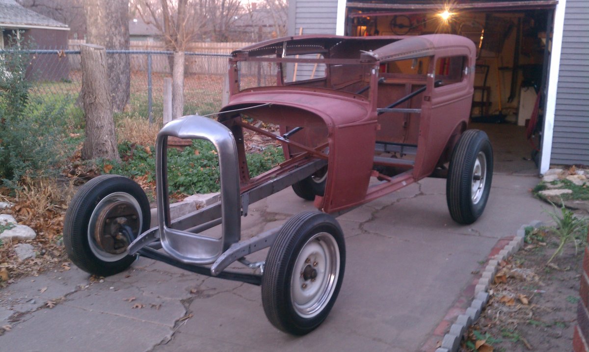

    Somewhere around this time I also picked up a '46 rear with a 3.78 gear from my pal Ryan (oldsboy on the HAMB), and as these pieces began to pile up in two different states, it occurred to me that I was pretty close to a rough mock-up. I had owned the car for over three years by this point and had never seen any of the parts together. In a weekend thrash, I built a flat front crossmember and a spring clamp, then started to excitedly throw parts together. Here's what a lot of vice-grips can do…
    I was super happy to see something that looked like a car for the first time. Still a long way to go; at this point there's no rear suspension, the axle is just sitting inside the stock crossmember. You may notice that the front wishbones look a little funny. At some point in the life of that poor '41, someone had bent them in an effort to get more caster in the frontend. Those had to go.

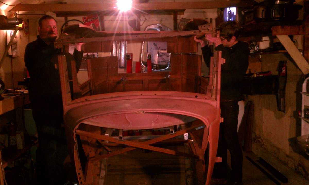

    In 2011 I took a major leap of faith and quit my job to attend McPherson College's Automotive Restoration program. The focus of the program is restoration of early cars using early tools and techniques; imagine the shop class of your dreams and you'll be close.
    I can't overstate how much I learned in my time there, particularly about sheet metal fabrication. I managed a little work on the Model A while I was in school. I scratch-built a door patch to repair the crappy job that I had done years before.

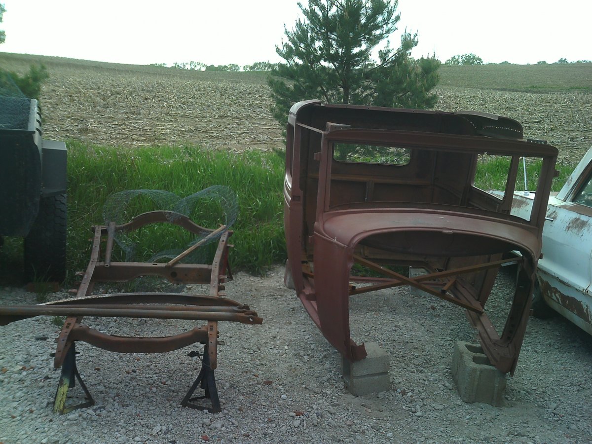

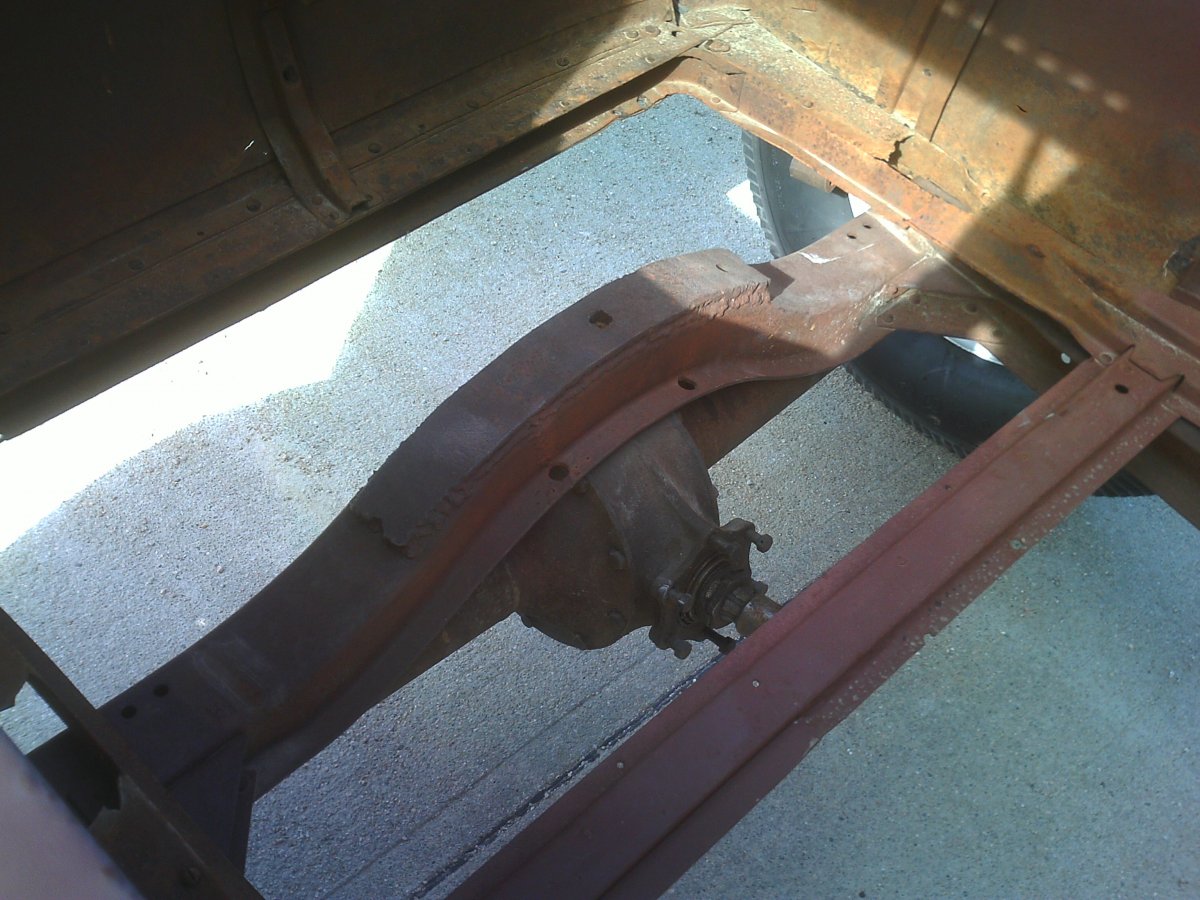

    While I was in school my time to work on the car was fairly limited, but I did get around to a little chassis work. The rear crossmember on my frame had been cracked and "repaired" at some point in its life and had a big chunk of leaf spring booger welded to the top.
    Since I was planning to use a '46 rear spring, I needed to redo the rear crossmember anyway. I used 2x3 tubing to fabricate a Z at the rear, then chopped the daylights out of a '40 rear crossmember and came up with this.
    Around this time I scored a '39 transmission and was actually able to pull it from the car.
    The car had been sitting for a while; this was on the floorboards…

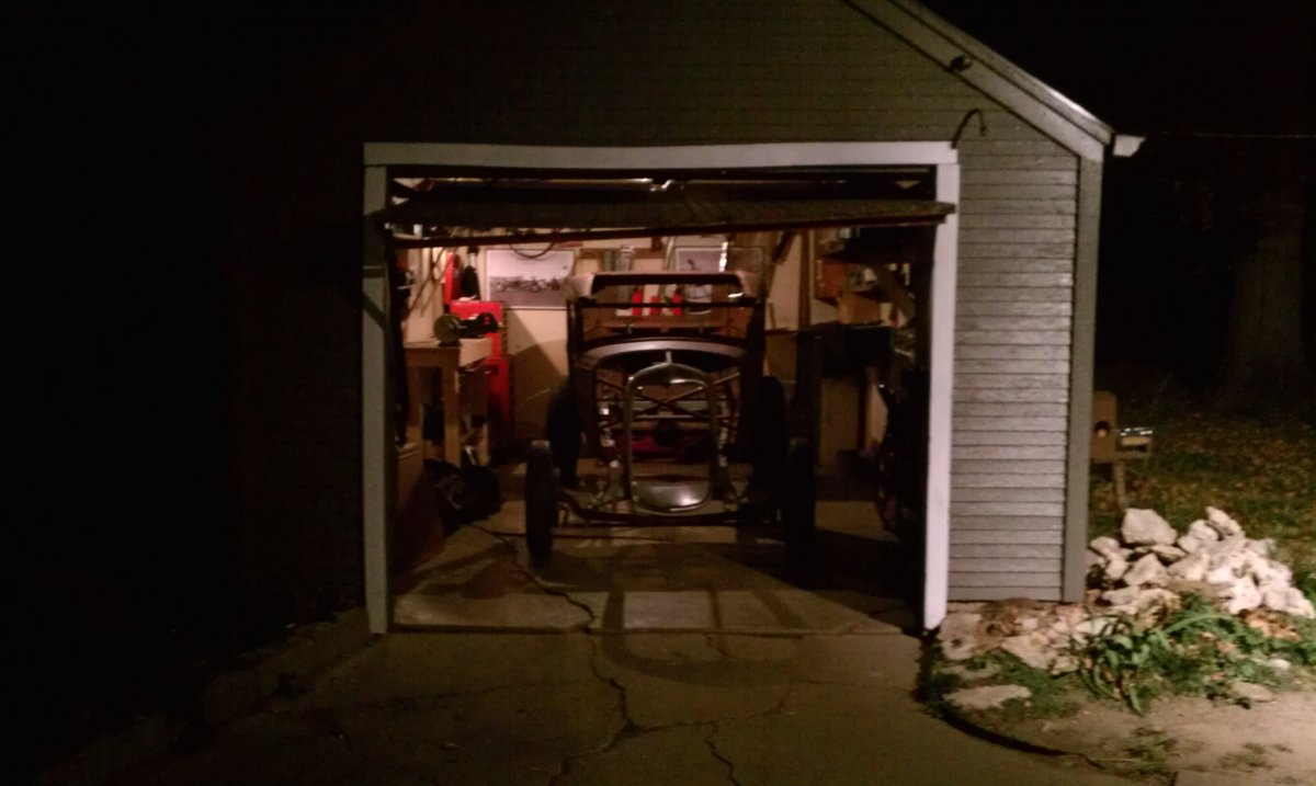

    With the chassis roughed in, I moved the car to the world's smallest garage behind my house in Wichita. I had been daydreaming about chopping this car forever, and after years of deliberation, looking at pictures, drawing pictures, and messing around in Photoshop, I finally settled on a 6" chop.
    I had to roll it out that night to see just what I had done…
    It's only roughed in here, but you get the idea. After 5 years of looking at a stock-height sedan, it's amazing how much this changed the car's attitude. It's getting a lot closer to the evil looking car that I had been imagining, but it's still not totally there.

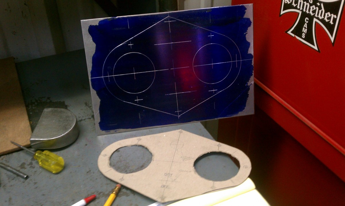

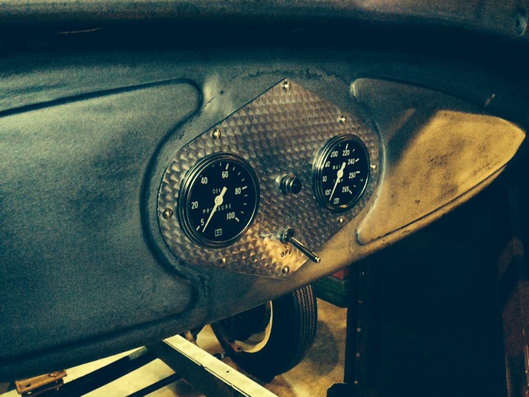

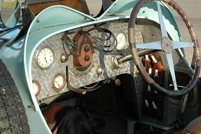

    While in Tulsa, I also made a gauge panel. This was another area where my plan changed a dozen times, but I kept going back to the strictly functional theme that I want to follow throughout the car. I want nothing hanging on it that doesn't absolutely need to be there. As such, I made a panel to mount only oil pressure and water temperature gauges. A tach will come later, either on the column or on the driver's side of the dash.
    I engine turned it in the mill using a kratex stick, but I intentionally didn't measure the movement on the x-axis. I wanted it to have a handcrafted feel, like an early Bugatti, not a store-bought, mass produced feel.
    I’m happy with the result…

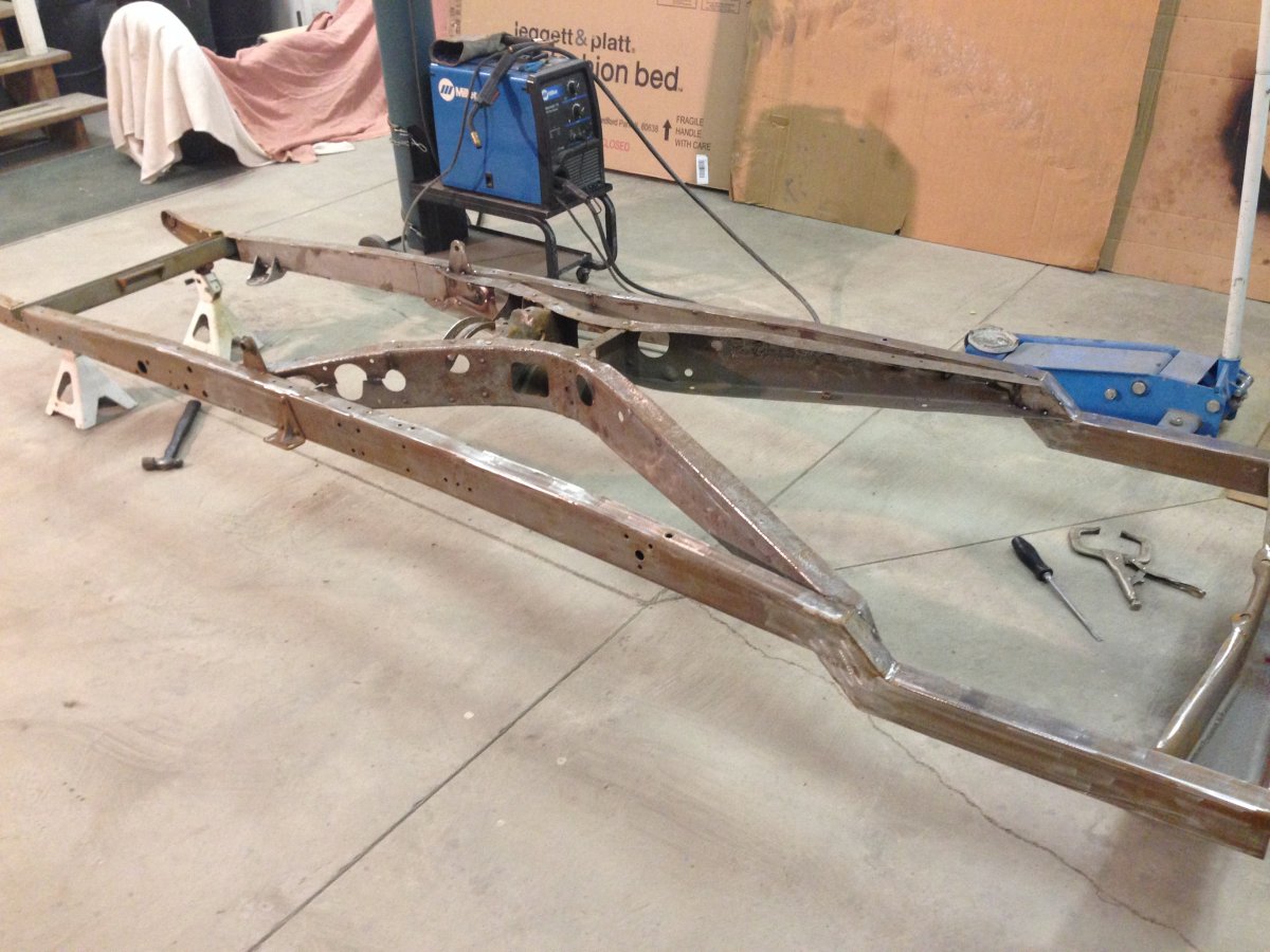

    This was a little over a year ago, and the car was then broken into pieces once again. You guessed it, another move. This time back to Nebraska. With the car back in my dad's shop, I've been able to get some additional work done on the chassis. Some time ago I picked up a '40 crossmember with the plan to use the trans/pedal mounts as Henry intended them, just stuffed between Model A rails. A little cutting and it looks like it belongs there.
    Incidentally, I had seen center crossmembers done like this on the HAMB (particularly those by Mr. Bass, who is a personal hero of mine), but it’s a pretty old idea; here’s an old speed handbook I found with an illustration of this very setup inside.

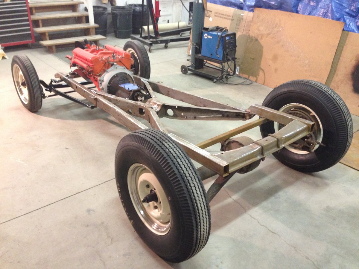

    I also fabbed some motor mounts. The 265 has no side mount provisions, so I used a saddle style adapter and made some quickie frame-side mounts.
    Now we’re getting somewhere...
    This pretty much brings us up to date. It's been a long road to get here, and there's a long road to go, but all I can do is keep pushing. I'm going to do my best to update this thread with progress on a weekly-ish basis, so if I haven't lost you yet, stay tuned for more of the world's longest hot rod build. Thanks for reading.

    Cool Build, gonna "borrow" that instrument panel design, I dig it!
