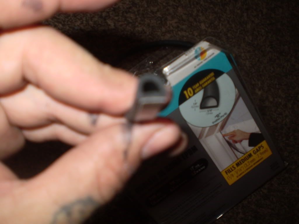

  1. It really looks great! For the rubber on the skirts, try the hardware store weatherstrip section. They have a black D shape that should work well.
  2. LostHope

    Thanks "Cactus1", I went to home depot and think i found the "D" shape weather stripping you suggested, they only had this kind and the other square foam type, my pops used the square foam style on his skirts and I didnt really like how it turned out and was on the fence on what to use but this "D" style looks like it should work out and not look out of place thanks for the lead on what to use..And for around $6 you get two strips that are 8 1/2 feet each cant beat that!........I'll try and install it on the skirts tomorrow and snap a picture or two:

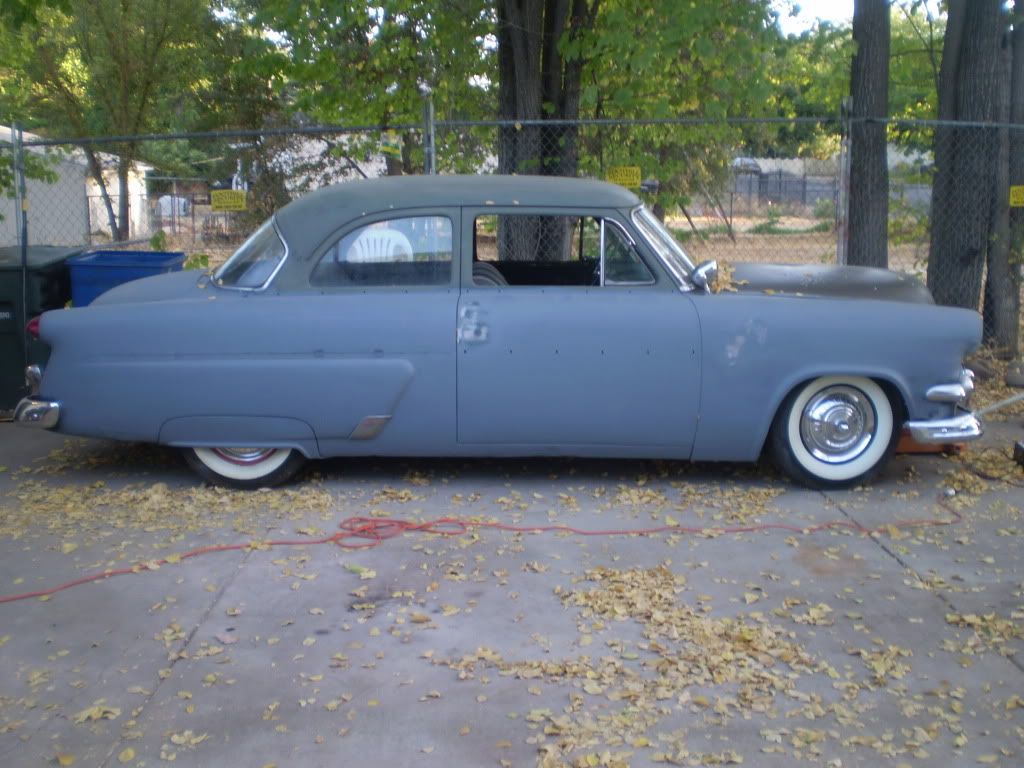

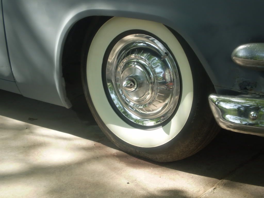

    Had A little spare time to work on the ford! I had cut the springs a long time ago and remember only having a inch or so of travel with the bump stops cut in half , but over the years of sitting I guess the springs sagged some more and was riding on bump stops, and the ride was shit....So I finally bought the ford aero star springs everyone's using:
    Here's the before pictures with the front riding on the bump stops, I Loved the way the whitewall just started to tuck under the fender lip:
    It measured 24 1/4":
    Got the front end up in the air and started taking it apart:
    When I compared the new springs with thw cut springs I was kinda skeptical if they were going to work since the cut springs were taller?:
    With the new springs in with the car on the ground it now measured 26"
    raising the car back up 1 3/4" in the front:
    I guess it dosent look to bad, but WOW at first it felt like it was a 4x4 when I let the jack down.....its not tucking the whitewall anymore but it gave me some room between the bump stops and id rather have function over looks at this point....Might lower the back a little more and try and give it a little of a tail dragger look:
    until next time!
