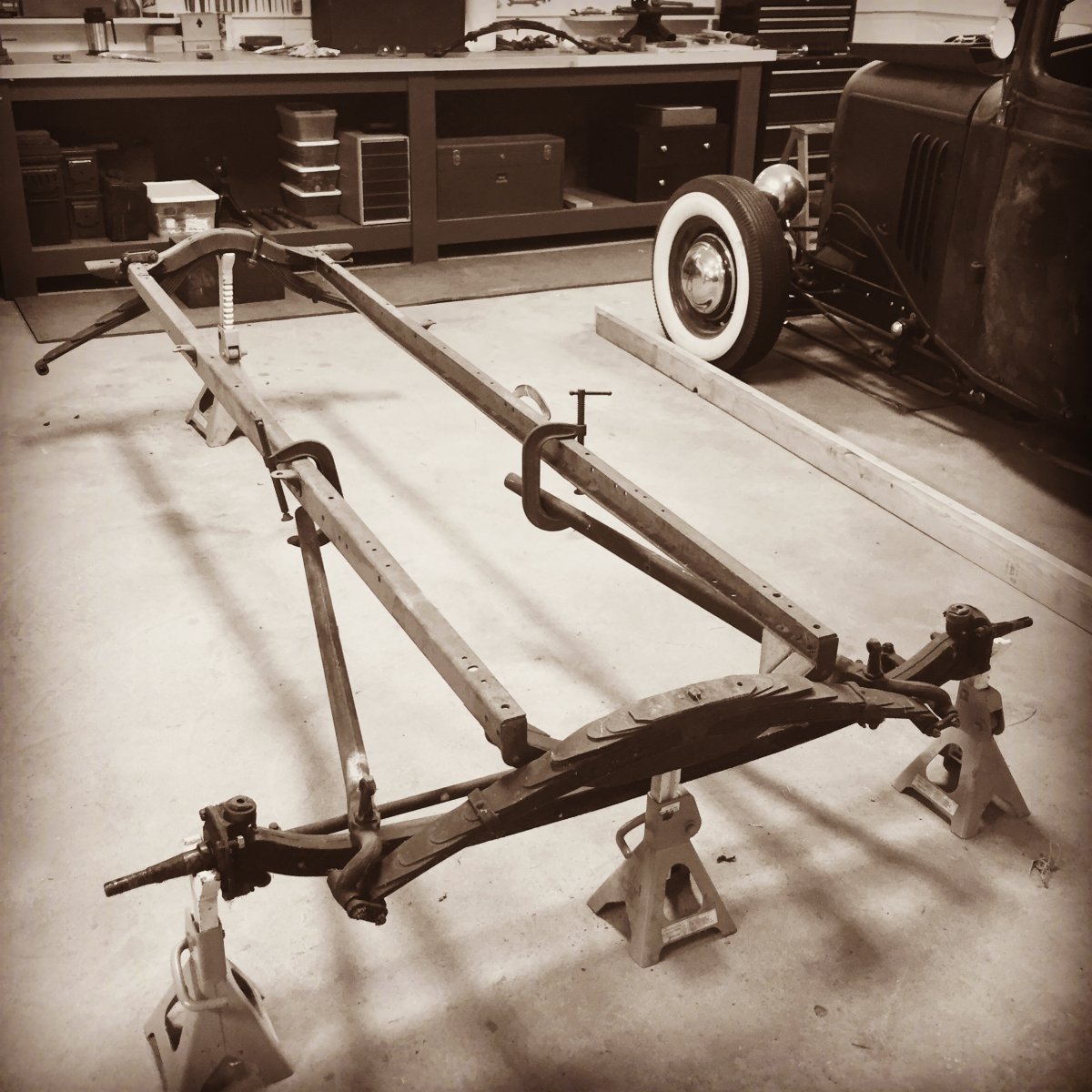

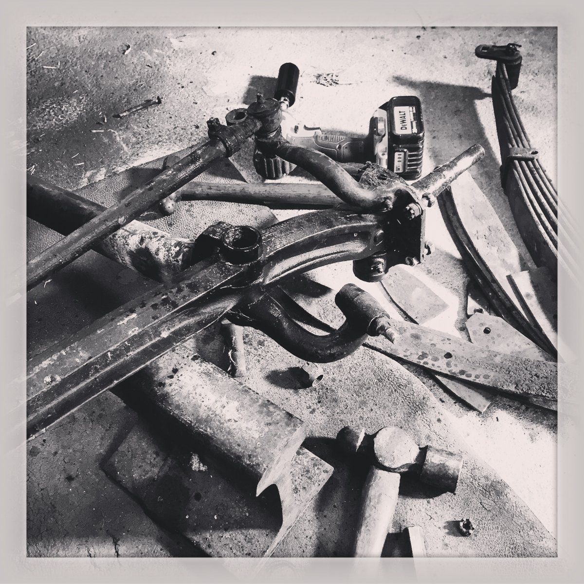

    I have a bent '36 axle from the pile. Most of this will be built with parts that I have on hand. I hope to not have to buy too many things.
    I pulled it apart as I will be using a spring over arrangement with '32 spindles up front.

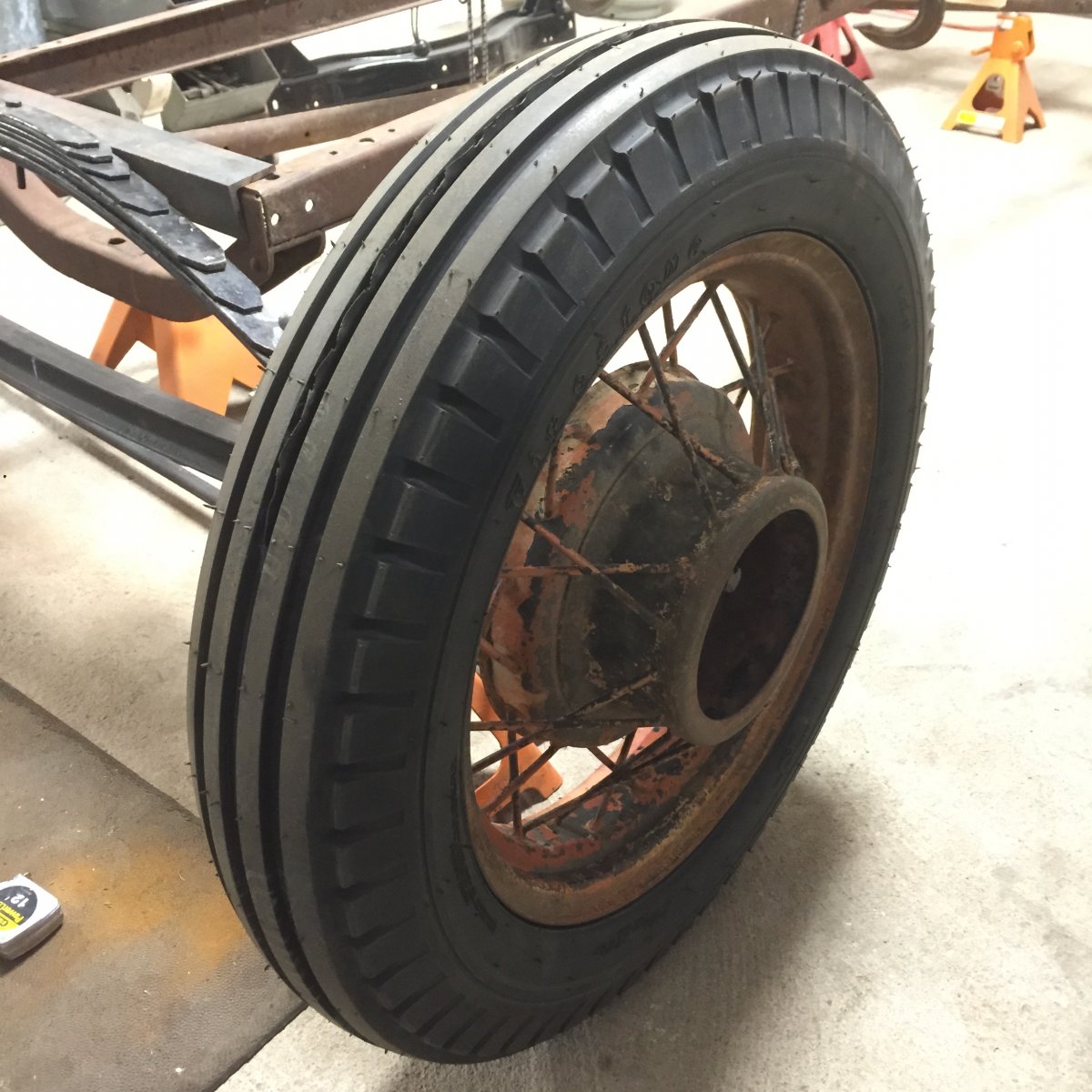

    I straightened out a couple wire wheels and was delighted to find "dirt track" tires for 17" wheels at Coker.
    I bought some Excelsiors for the rear as the 17" options are slim. If anyone has an old set of Ascots I would be interested!

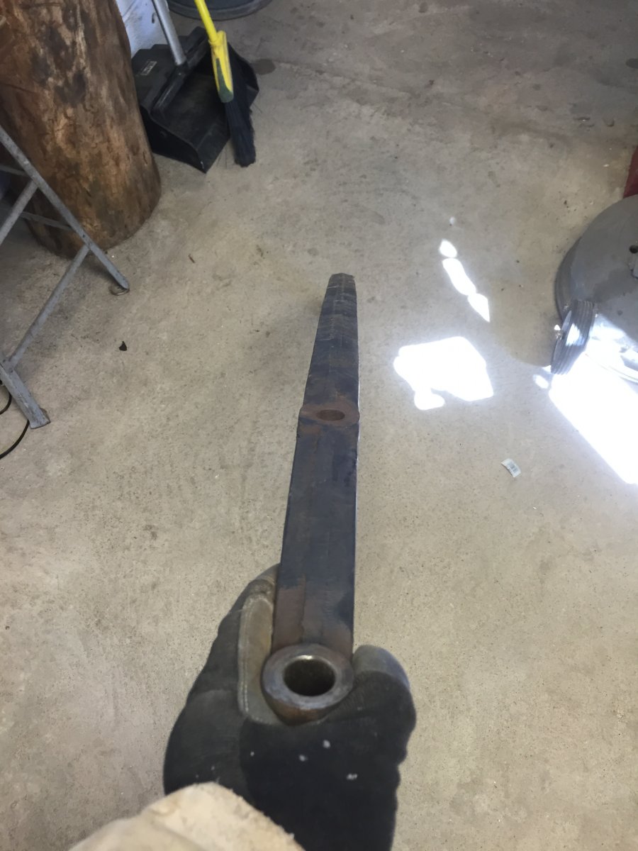

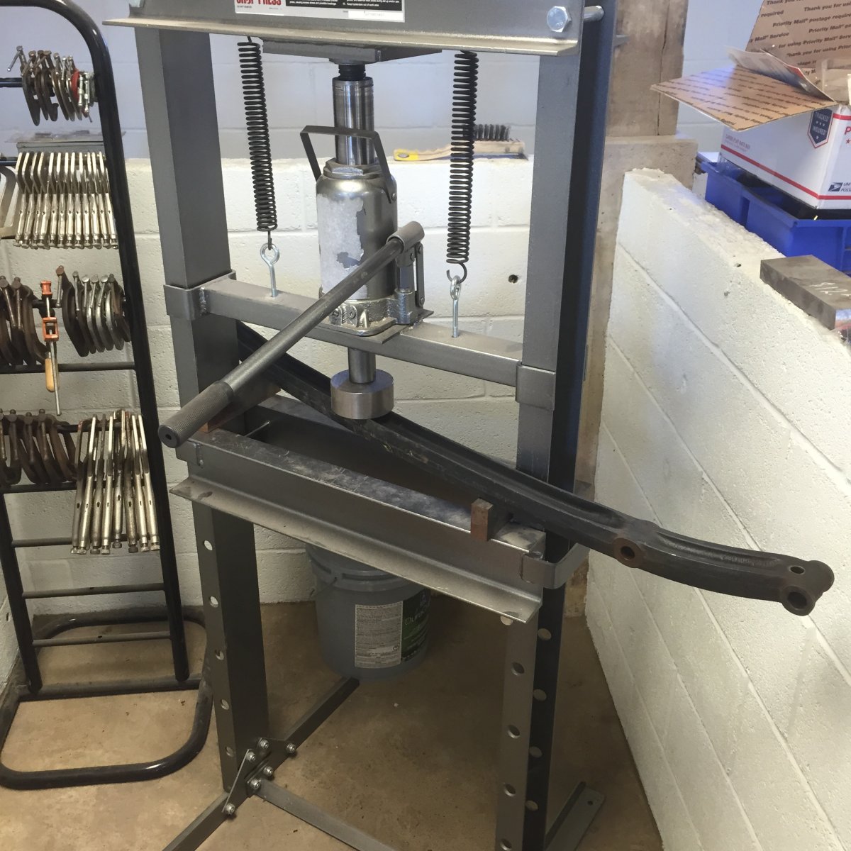

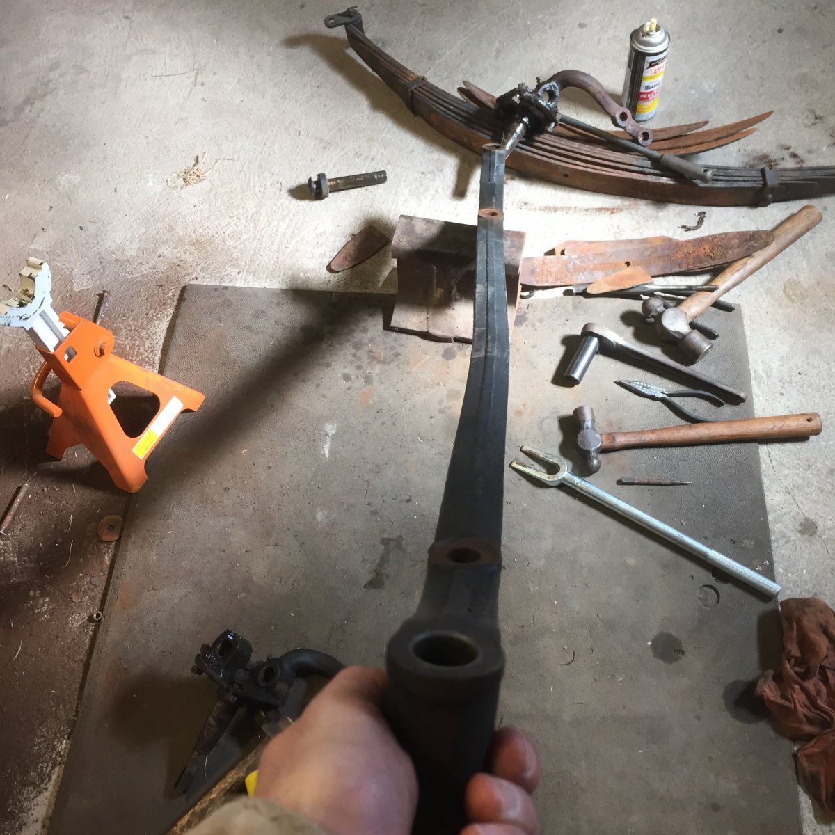

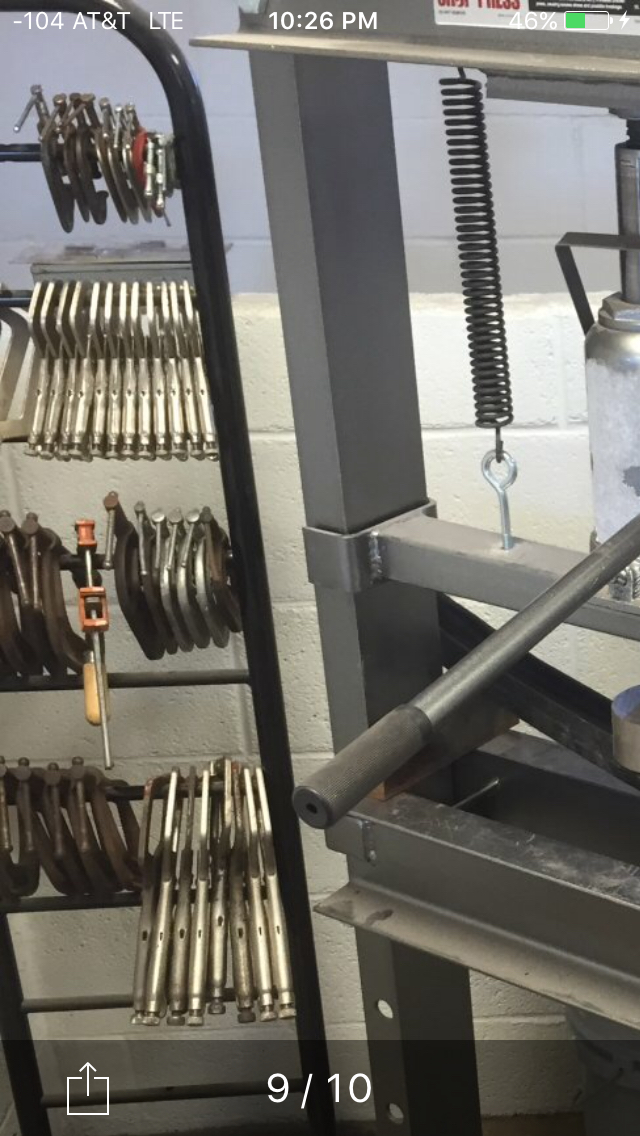

    Clamp-hoarder..

    You can NEVER have to many clamps ;)

    The shop looks great. Got any more pictures of it?
  19. Thanks man! Your truck looks great too!
    Guilty! No, it will be a single seater with a simple hand built body (hopefully!)
    It's so true!
    Thanks! I will try to sprinkle some in here and there.

    Very nice organized shop.

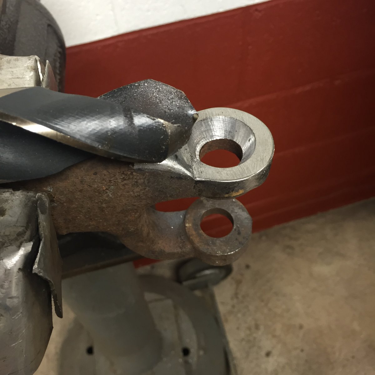

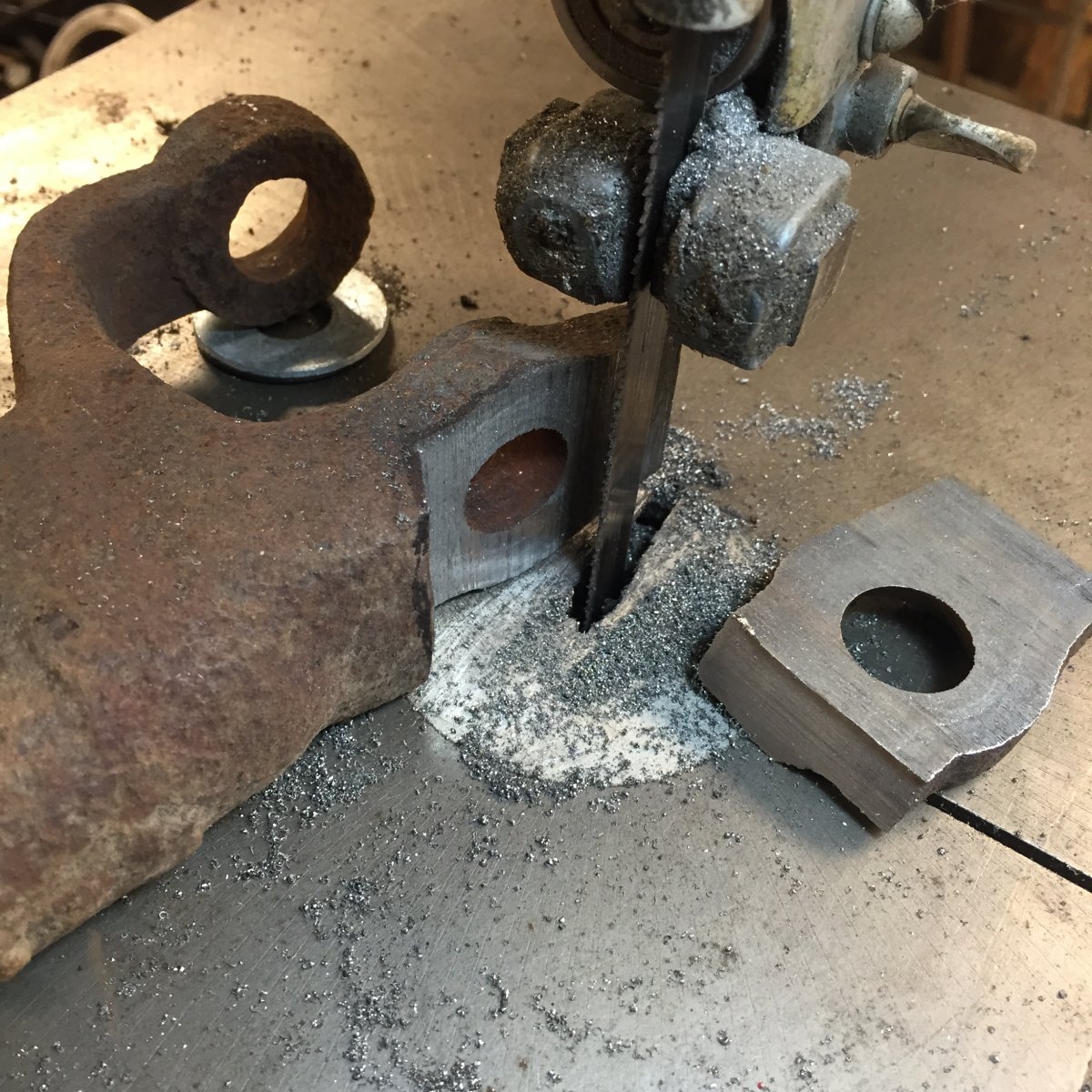

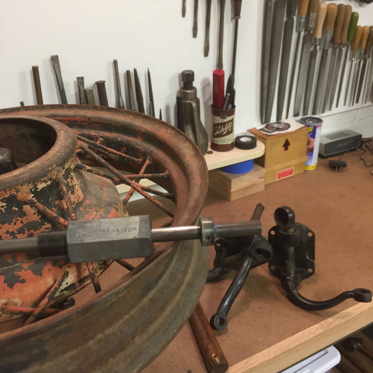

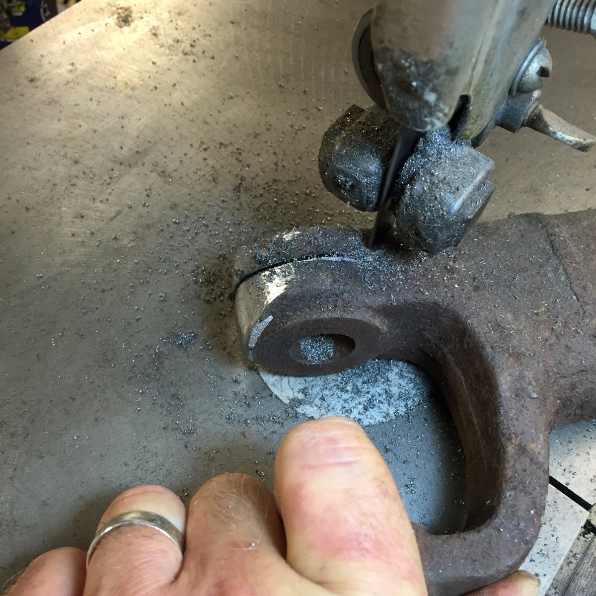

    So, as I said I'm using '32 spindles as I had some I was going to use on another project. I also had a set of '32 perch pins and some '36(?) bones that had been split. Obviously those won't work with the short pins so I had to modify them. image.jpeg
    I reground a bit to make the countersink.

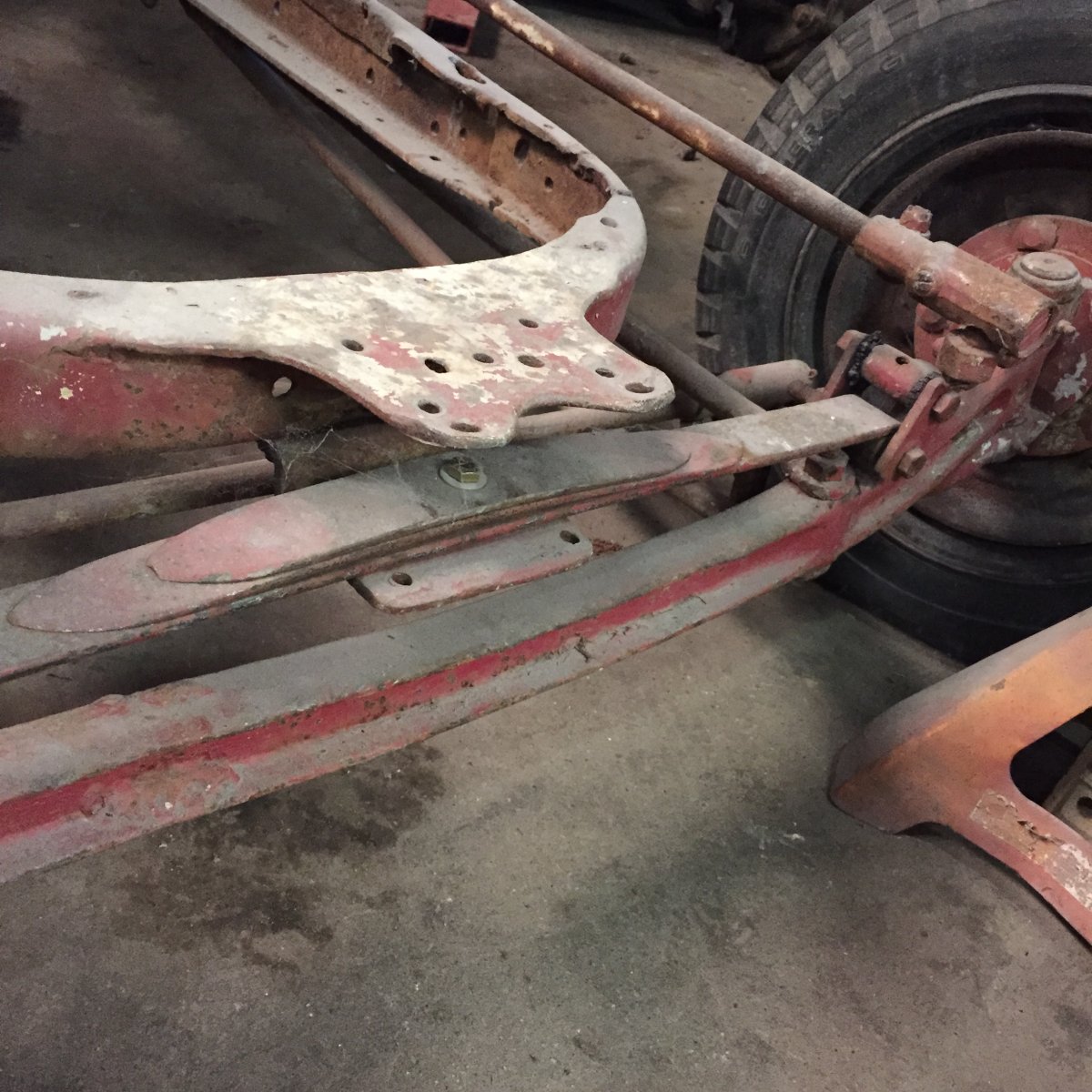

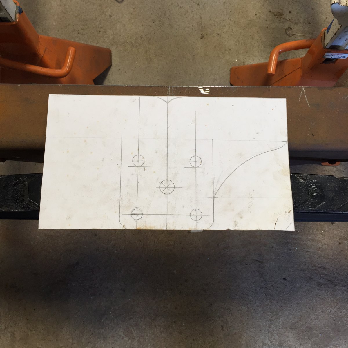

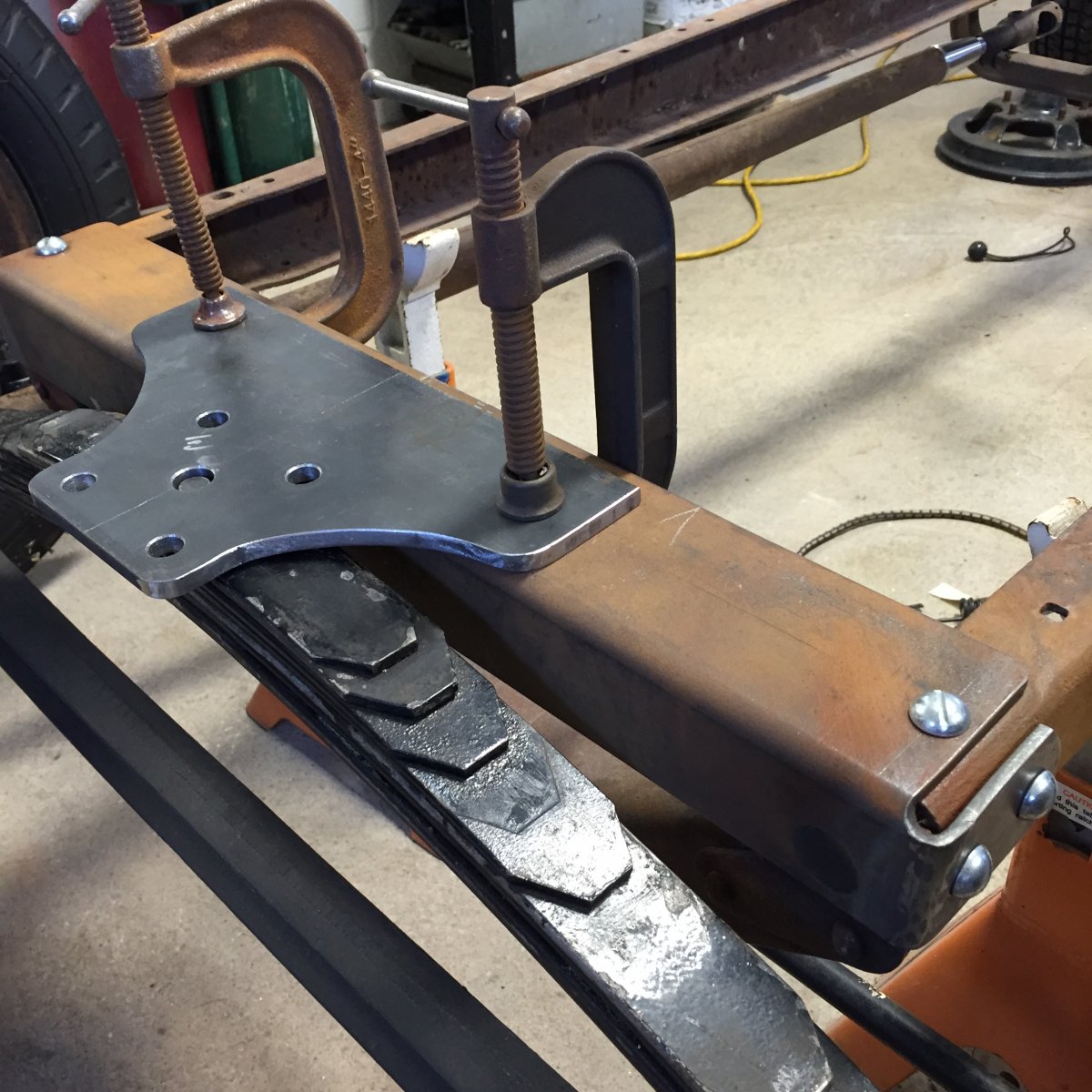

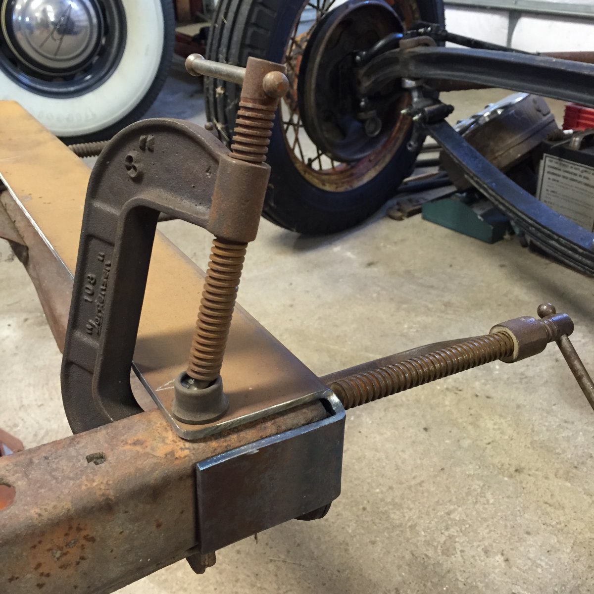

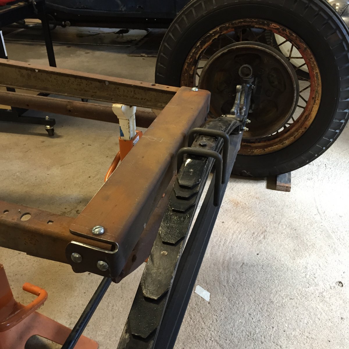

  29. After looking at many pictures of vintage racers it seems that anything goes as far as front spring mounting. I've seen bulldog type perches, narrowed/ flattened cross members, spring behind, etc.
    I decided to add a front crossmember and bulldog perch after looking at a friend's original Kurtis midget. image.jpeg
    I also tried to bolt everything up using the original frame holes as I had heard that these old T frames were tough to drill. (I haven't really had any problems though?)
    I should also add that after a little research I learned that these cars did not have much caster built into them to make turning the wheels right to left faster and easier. After all, they went around in circles, not straight so I only have a couple of degrees built in. Hopefully it will be ok for what I'm doing? We will see...
