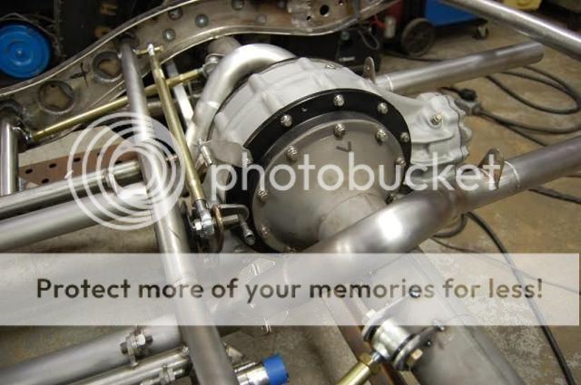

    Once again because of the dropped rear floor some of the components had to be kept well below the top of the frame rails. You can see here how the upper arms of the triangulated four link are bracketed to the front side of the axle tubes. There are two reasons for this with the first being the lack of clearance above the axle housing. As we showed earlier in the body photos the tail pipes actually come up through the trunk floor as they pass over the housing. The second reason is that the front of the link also needs to be low to keep the suspension geometry correct and avoid unacceptable pinion angularity as the suspension articulates

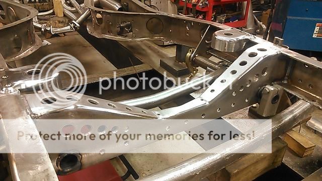

    Last time we talked about the fact that the frame is not boxed and here is one of the reasons that joe felt it was unnecessary. Where the factory cross member/x bracing runs parallel to the frame Joe welded everything together, rosetting the holes and also fusing the edges of the flanges.
    Here you can see the stop for the torsion bar anchor/adjuster
    And here is the arm and adjuster bolt in place. You can also see how the front mount for the upper four link bar is tied back into the frame structure along with the fact that the lateral tubes tie the various elements of the frame together.
    Just an overall view of how it all fits together
    If you scroll up to the torsion adjuster photo you can also see the original frame mount for the panhard bar which was a clevis attached to the side of the rail itself. When Joe added to two lateral tubes from the arched cross member above the pinion he added a boss to the right hand tube to mount the chassis end of the bar. The lateral tubes had been added to better brace the arm end of the torsion bar tube
    A top view of the overall package with the entire exhaust system in place and mounted
    As well as another look at everything these photos also shows the spreader bar which Joe bent to follow the lower body contour.

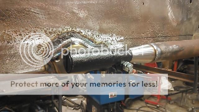

    Here is a closer look at the now fully welded exhaust and also a better view of the upper four link mount

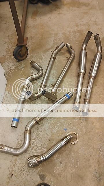

    Due to the way that it winds through the frame the exhaust system has multiple slip jointed and tabbed connections.
    The exhaust system is in place in this photo which serves to illustrate the fact that no part of it is visible below the frame rails
    Note the flex connector in the down pipe from the header itself
