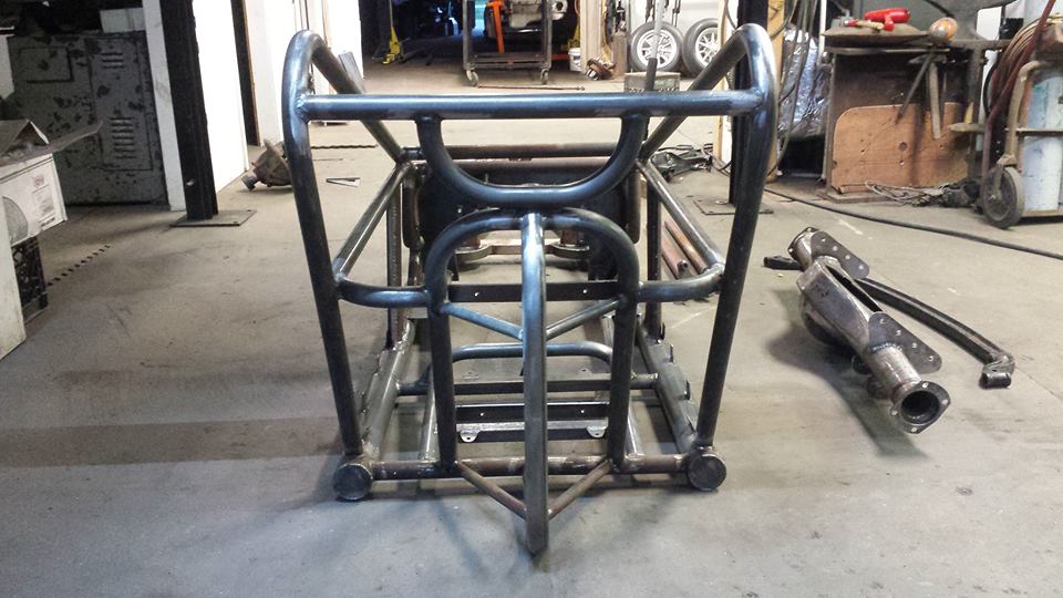

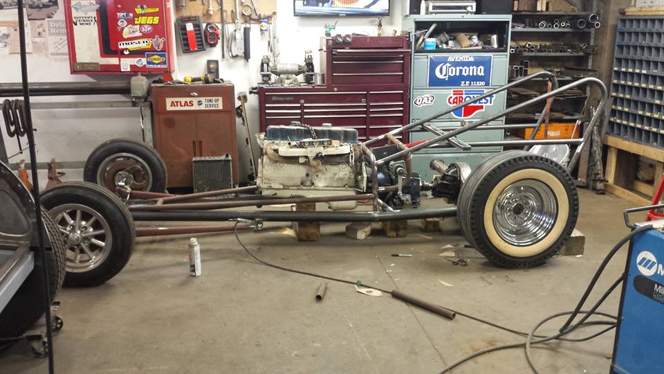

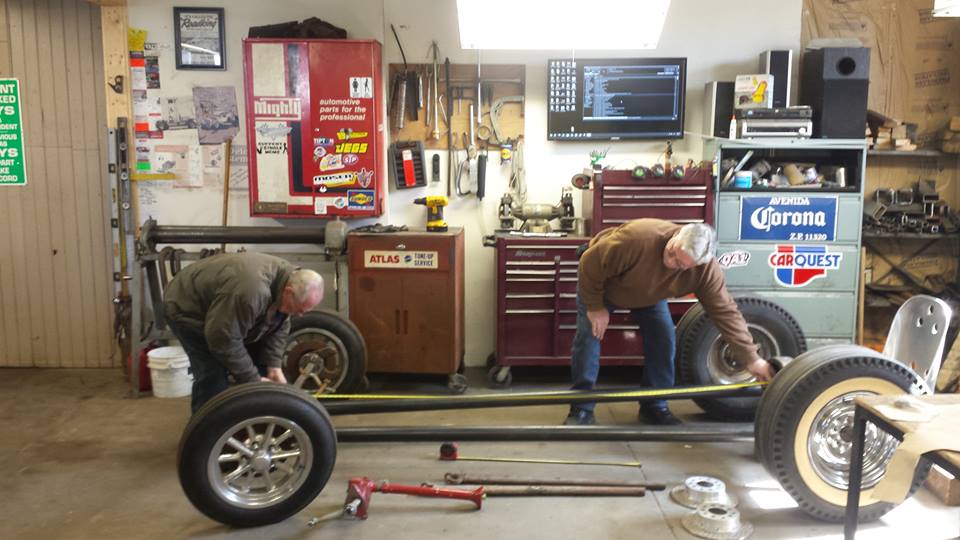

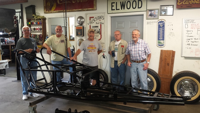

    After purchasing tubing, a mandrel bender and dies Butch, Dale Holden and I got started. Here Butch and Dale are marking out the wheelbase that he would like to run. Dale was nice enough to Donate a narrowed 31 spline 9" that he wasn't using.

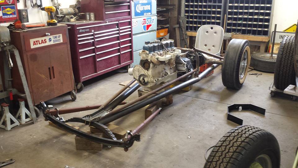

    Time to start putting her together.
    F100 box has been altered to allow for cowl steering.

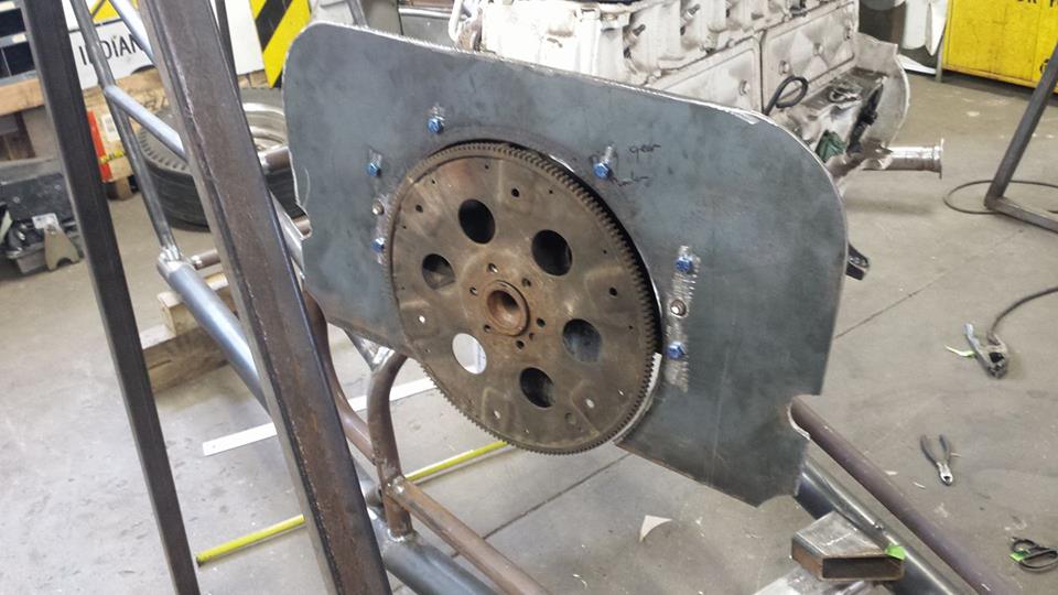

    Mid-plate fabricated by myself and ready to go in.
    Yup, she's got the right look..

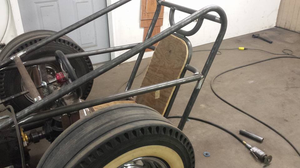

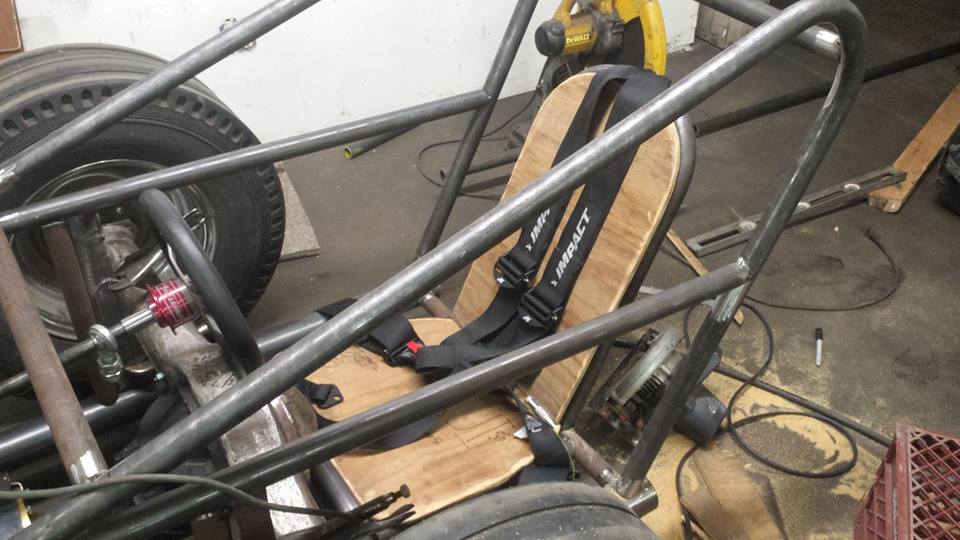

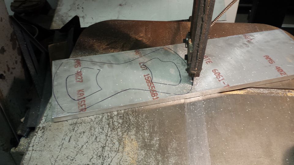

    Building a seat..
    Continued..

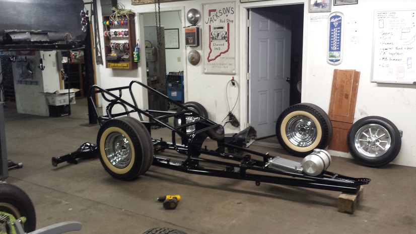

    Assembly time..
    Rolled her outside the shop for a little air and pictures. I ended up having to bring it back in because of all the time I spent talking about it with random people. :)

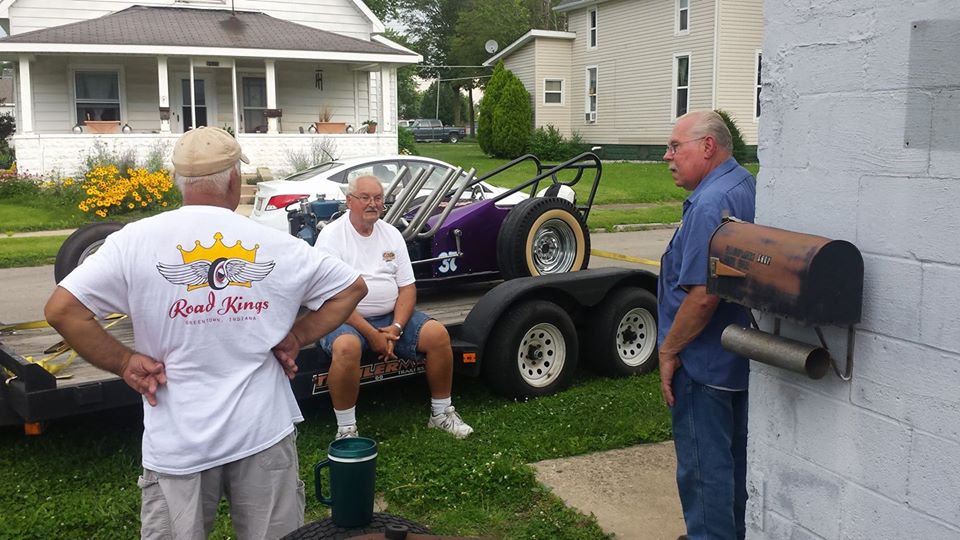

    Dave Kinnaman and I loading her up to go fit the motor at Jim Hayes shop.

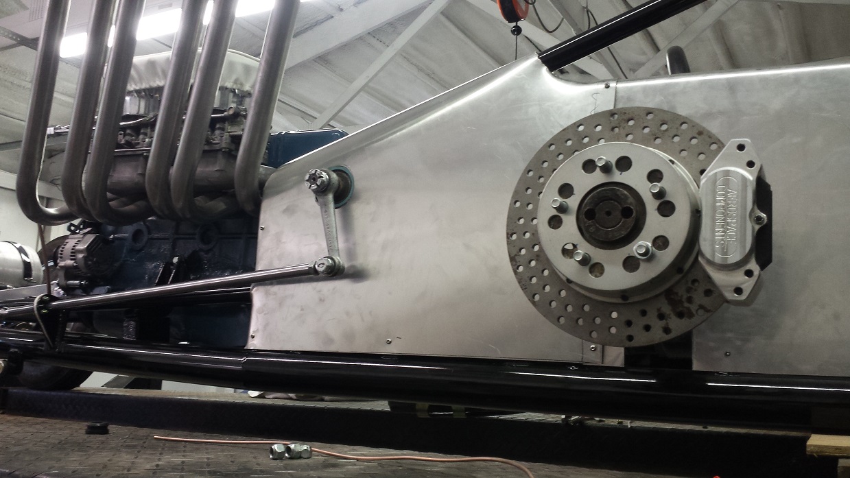

    The brake kit was donated by Dale Holden of Alexandria, Indiana and let me tell you they will stop her in a hurry.

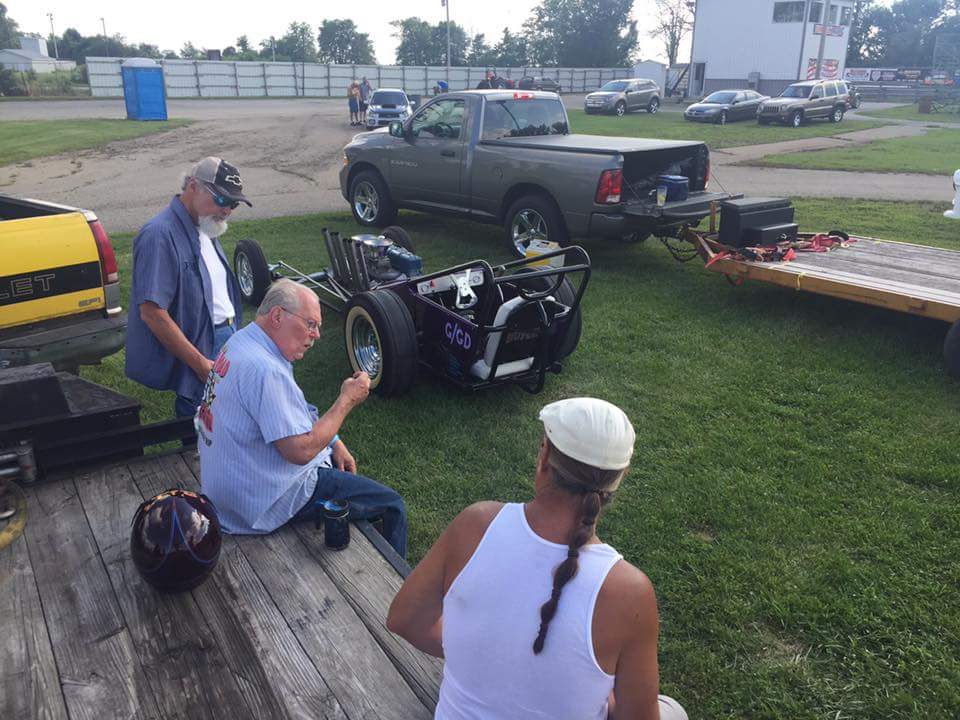

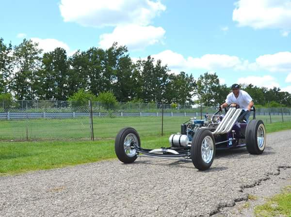

    Butch and Doug Lewe waiting for her to cool down after a pass at Bunker Hill Dragstrip in Indiana on test and tune night.
    Rick Hayes and Primer Dan from the Road Kings C.C. chatting with Butch after a run down the track at Bunker Hill Dragstrip.
    Team Agitator on the Road Kings C.C. event "Battle at the Hill" June 30th 2017 hosted by Bunker Hill Dragstrip in Kokomo, Indiana.
    Butch waiting to take his first run down the track at the Road Kings C.C. event "Battle at the Hill" June 30th 2017 hosted by Bunker Hill Dragstrip in Kokomo, Indiana. Not a worry in the world..
    Butch looking determined as he waits for his turn in the lanes.
    Butch and myself coming back in the return lane.
    Butch lined up and ready to go for his second lap down the track.
    Here is a picture of Butch making his maiden voyage.

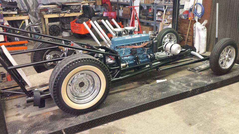

    The rear end is a 3.73:1 locked 9", 2 speed shortglide with 32oo stall and transbrake, but the engine internals were kind of a mystery as the gentleman that built the engine for his sons dirt track car is unfortunately no longer with us. We don't have a scope so once we open her up for the first gasket replace we will know more. Nothing looks remotely stock on the bottom end. :)
