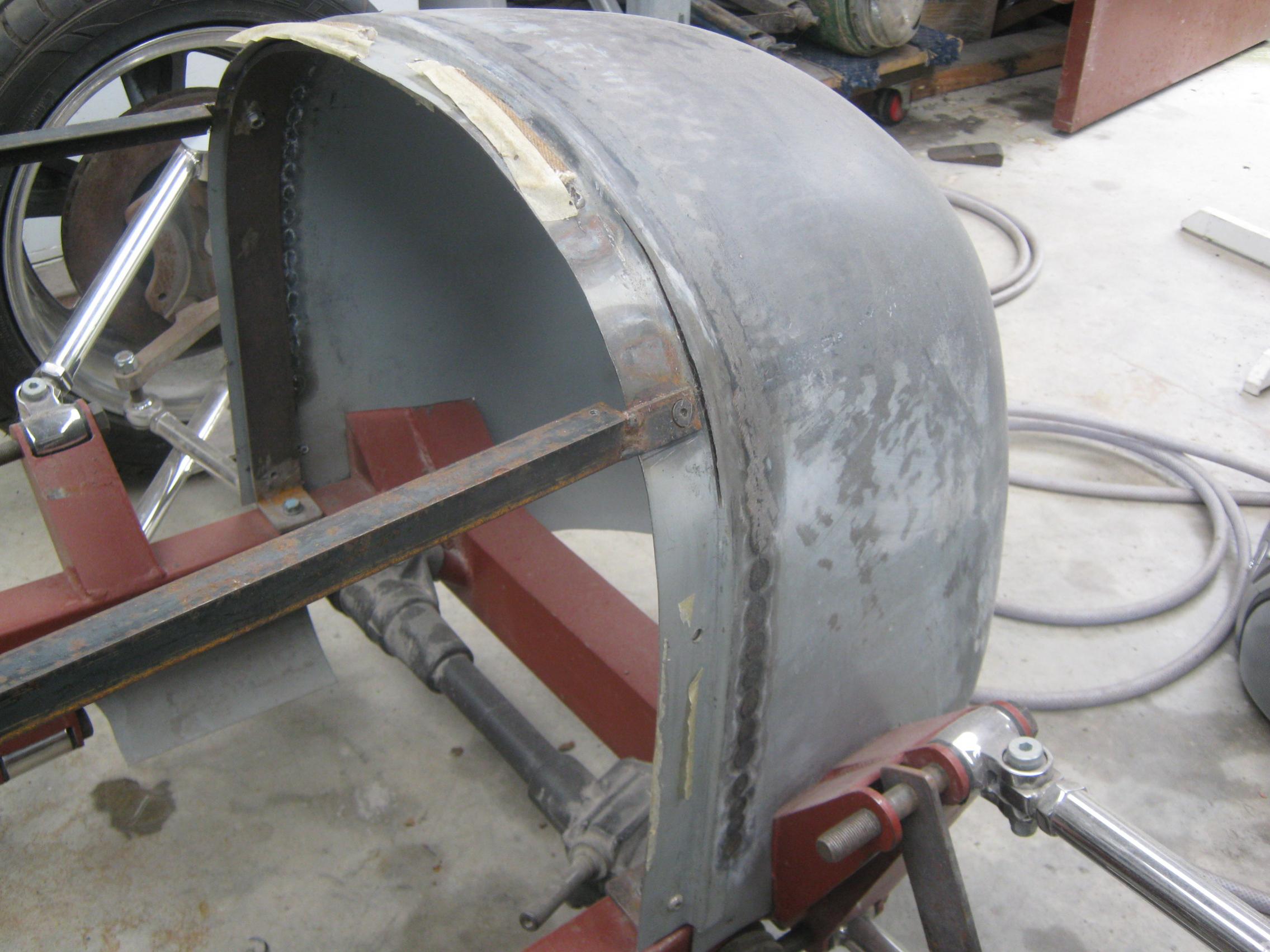

    Congrats on the fab metal work. So few people have these great skills and you are at the top of the game. Very impressive, here is one of my brothers car he built last year.

    Very nice build. In my opinion a duval or halock windshield does not look right on a track T. The early Dodge roadsters did not have stachions, just round rods going in to the cowl. With your sheet metal talent I think you could build 1923 Model T style stanchions or make a version where the post hold the glass. Very nice build!

    Thanks Matt and Spike...cool info on the foam. I'm planning on putting a sender in the tank so will need to box it off for sure. I'm wondering if theres an electronic type of sender rather than a mechanical one ? may take up less room and be less likely to foul up with foam. I'm also wondering whether having the foam in tank affects fuel pressure at all?
    maybe I'm being paranoid on the safety side ,don't think I've ever seen a tank explode in a collision but I know it can. Another consideration I have is the repairability of a tank filled with foam should the need arise... hmmm think I'll mull that one over some more..
    DTW I've just bought a 26 Dodge cowl with one stanchion still in place so can look into that style and method of attachment.
    Cheers guys for your input.:)
