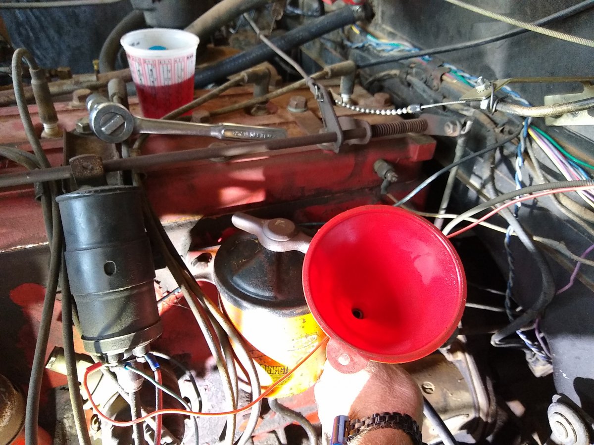

    Most hudson guys including me use ATF in them. There is a place that sells their own version of Hudsonite clutch oil, though. If the thing is leaking, it's kind of expensive, I think around 10 bucks per small can (one fill)

    You would think....also, they changed to a normal clutch in 55 I think, but they changed the crankshaft length and some other things, and didn't make very many cars by then, so it's a difficult conversion.
    Adding oil isn't too hard, have to get the flywheel in the correct position with the plug showing through the hole in the bellhousing above the starter (same hole you check ignition timing), then remove the plug, and use a long skinny funnel/tube to add oil. Of course you need to drain it first, so you don't overfill.
