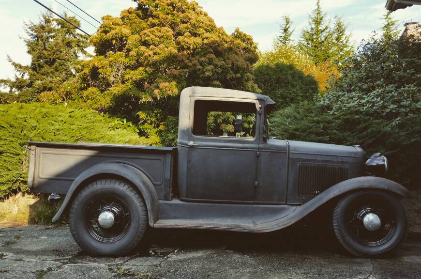

  18. Pictures
    Jeff34, Dannerr, redzula and 4 others like this.
  19. woodz
    Joined: Feb 23, 2010
    Posts: 544
    woodz
    That truck looks so killer!
    So, are these older pics or are these "I got the brake drum clearance sorted out and bleed the brakes and its now on the road" pics?
  20. These are the I ordered shims and have done everything I can, so I threw the drums on loose and pushed it outside so I can sweep under it pictures.
