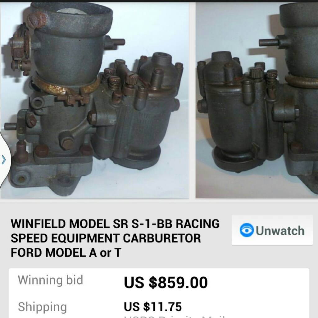

    I was hoping to win the one in the picture below..but as you can see it got a little crazy.

    Yeah, I was watching that one. Wow, that thing went high. Was that the one that had a BB throttle body and an AD float bowl or am I thinking of a different one?
  3. No, the one with the BB throttle body and the AD float is listed here. This one was on ebay.

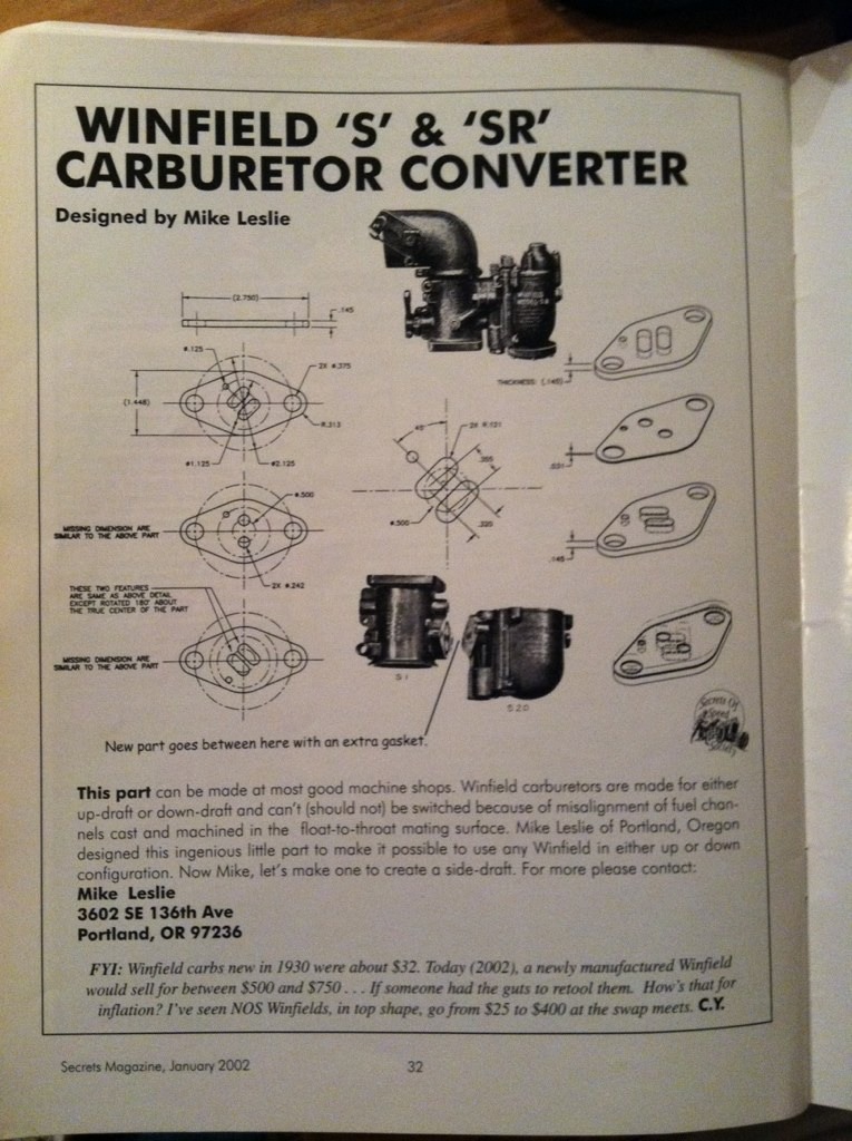

    So you have a Winfield BU and need a BD? Have you looked into making an adapter to covert a Winfield bowl? ImageUploadedByH.A.M.B.1390282866.925467.jpg

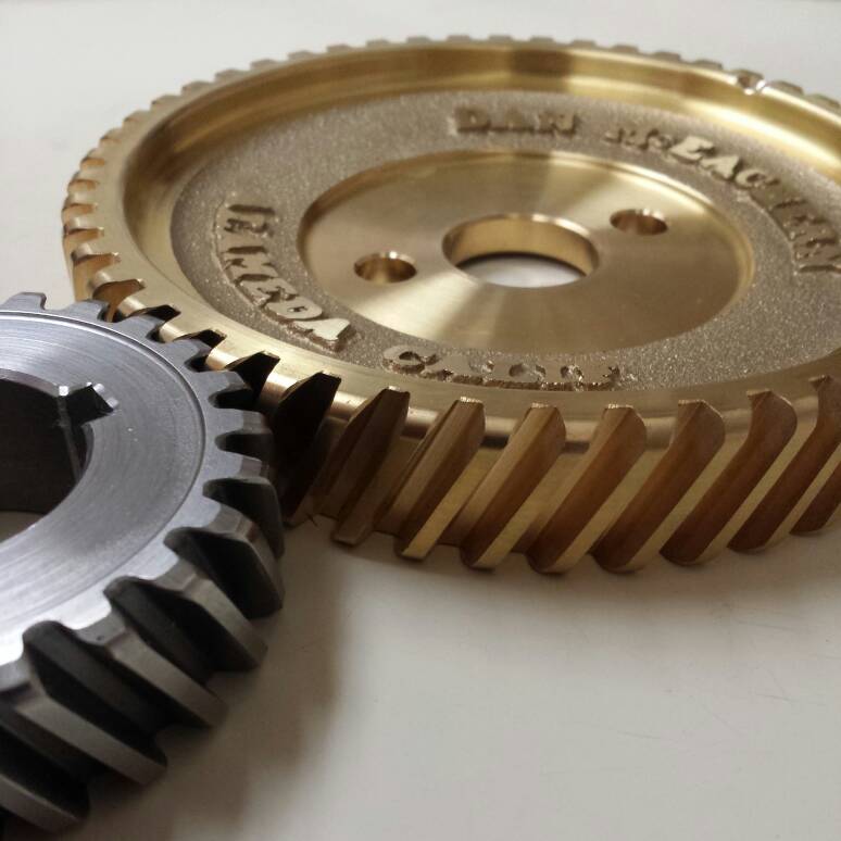

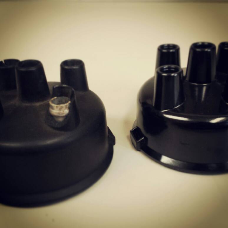

    While I was degreeing the cam, I noticed a +3 on the timing gear. Sure enough, advanced 3 degrees. So I ordered a brass timing gear with a matched crank gear. That showed up Monday. I also found the correct distributor cap for my vintage mallory distributor. I hope I can button it up soon.
  9. Hmm interesting... I havent seen that before. I have actually found a downdraft Winfield, should have that this coming Monday. I may give that a try though. Thanks!

    Dans gears are great you will never break them
    If you ever want to sell that +3 deg gear I will be interested they are very handy
