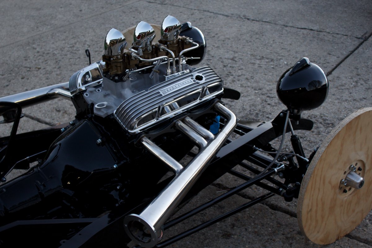

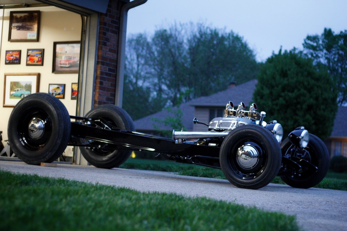

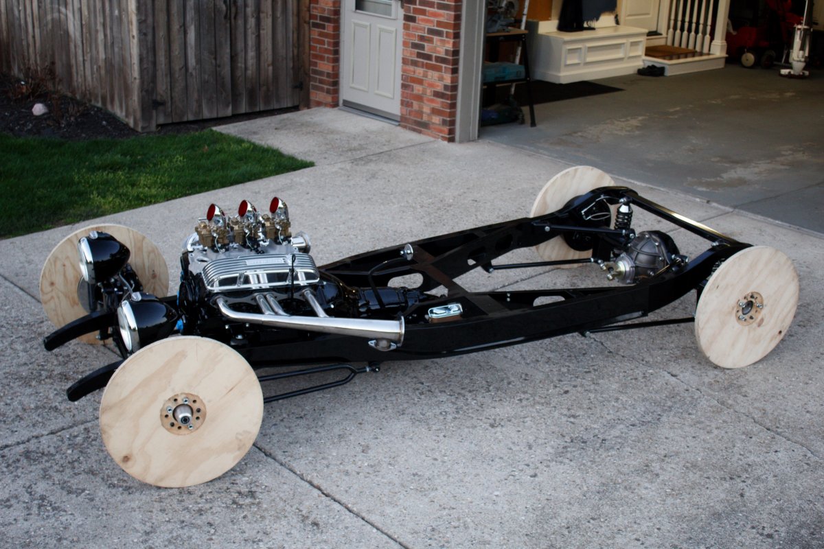

    I spent most of the Winter 18/19 gathering parts together, and prepping things for the chassis.
    Most of the suspension is SoCal, Ford 9", and a 383 SBC stroker that I already had (hasn't even been turned over yet).
    I have always loved a high-boy with black frame and a different color body. So, I sent the chassis parts and frame out to be powder coated black.
    The engine I had was just a longblock, originally meant for a different project. But now that I knew where it was going, I started bolting some parts on it. Decided to go Tri-Power / Rochester 2Gs, lake style headers (nothing fancy but may change them down the road - easy enough), Offenhauser intake and Offenhauser valve covers.
    A buddy of mine came over and base/cleared the drivetrain gloss black.
  3. HerMink
    Joined: Sep 14, 2018
    Posts: 173
    HerMink

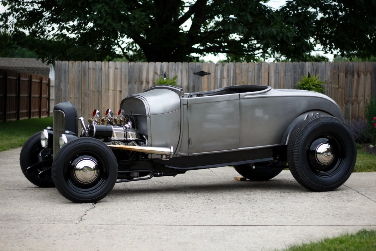

    Finally, after what seemed like a lifetime of pushing this thing around on those plywood rollers (and a few splinters along the way), I picked up a set of wheels. I went with, surprise-surprise, '40 Ford repops with '41 caps. At the last minute I decided to go with 18" on the rears. Picked up some Firestone 4.50/4.75-16s for the front and 7.00-18s for the rear. Has some serious rubber rake!
    That's pretty much where I am at on the car right now. The body still needs tons of prep work, I need to drill and fit a lot of things before I'm ready for a body shop but I'm hopeful I can get it all accomplished this Summer.

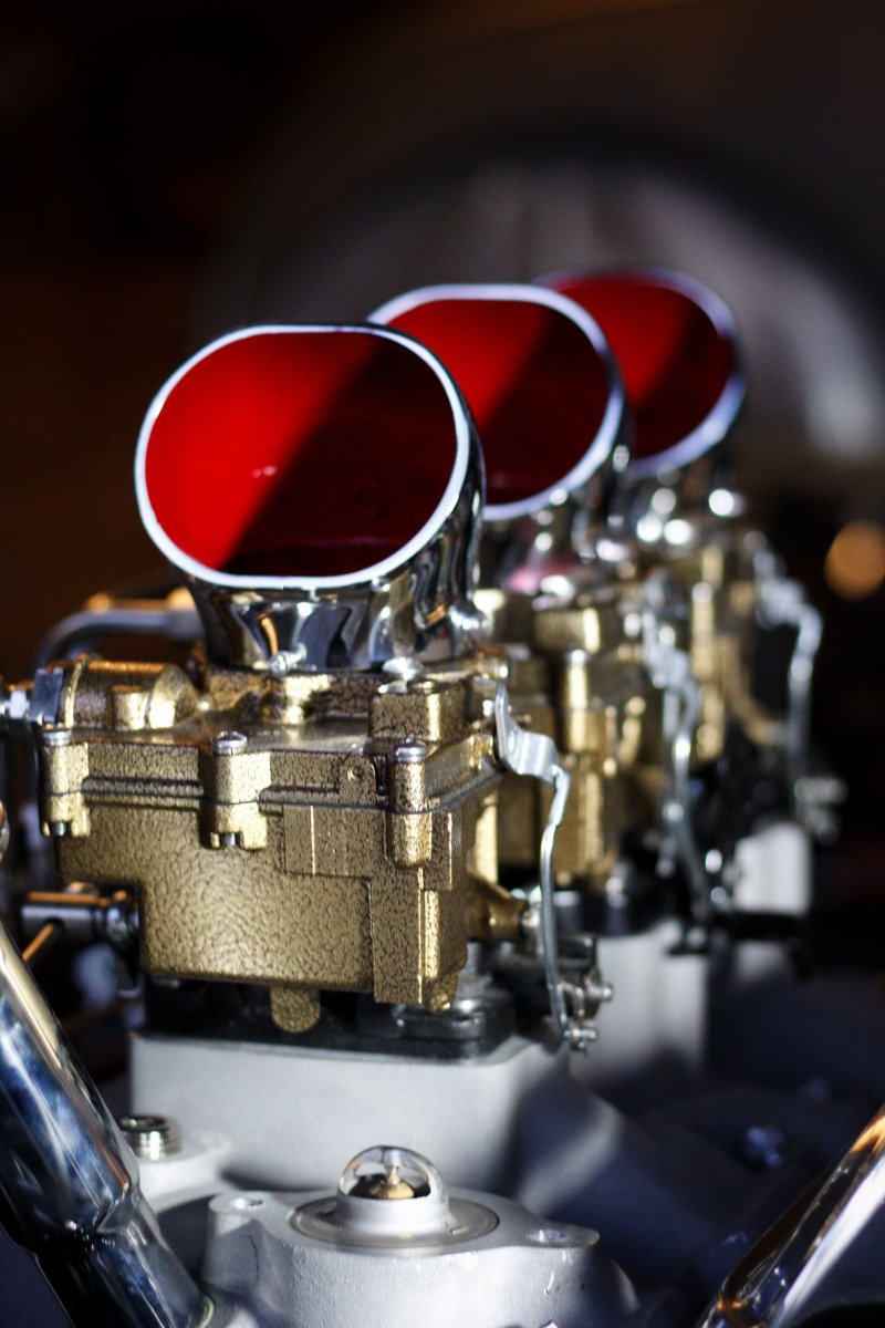

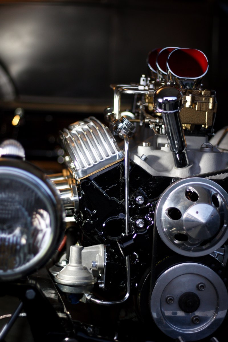

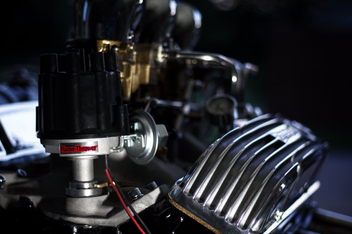

    Been spending an hour here and there finishing up some details on the drivetrain. Just need to build the plug wires and I'll be just about ready to turn it over.
    I spent the last week building the fuel line from pump to carbs, installing the regulator and gauge and all of that good stuff. Had a little generator mount fabbed up and threw my PowerGen on as well. It will all be taken back off and painted gloss black to match the drivetrain once I verify that it all works. Still need to polish those front two pulleys as well, I picked those up for free from a friend.

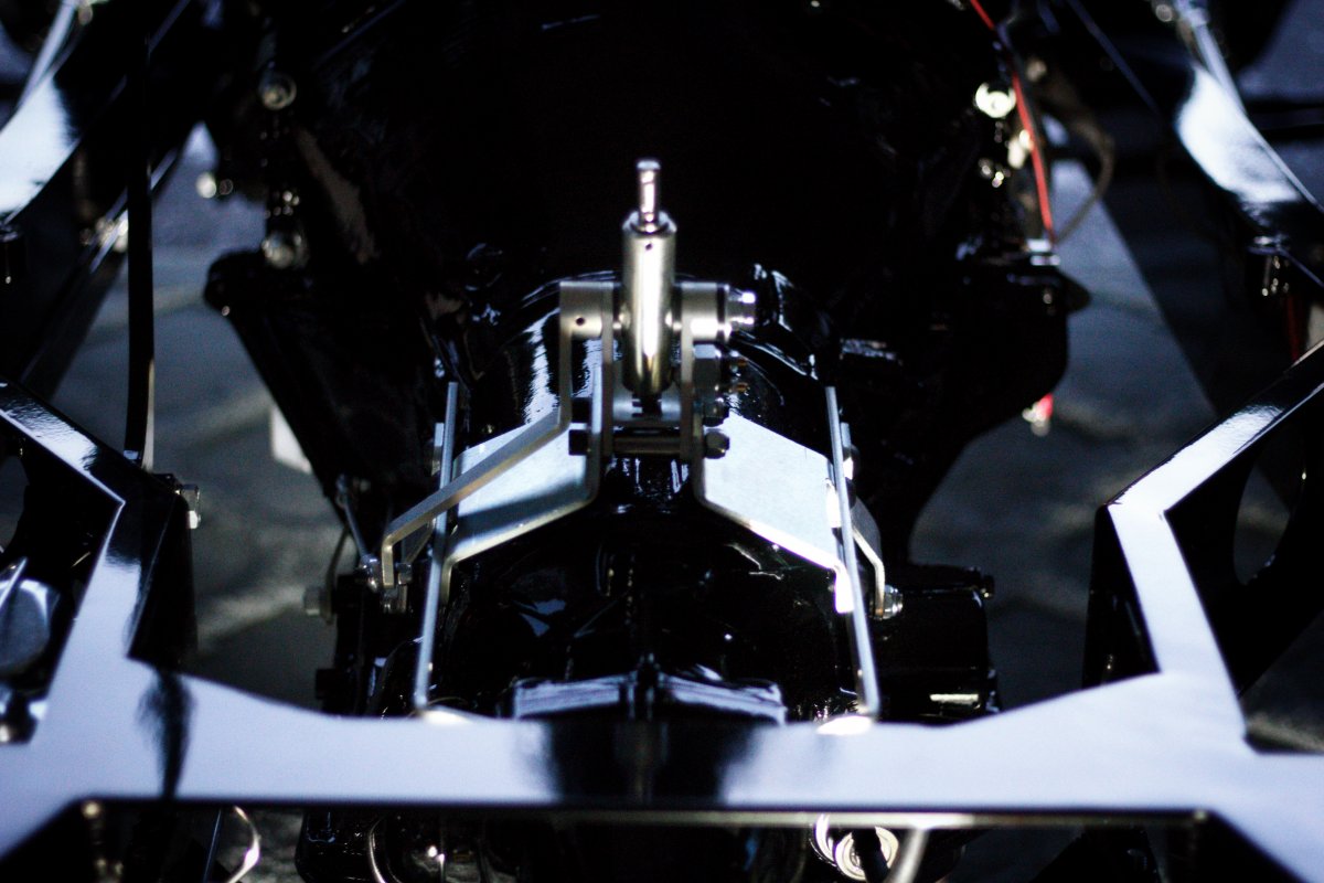

    The shifter is a Gennie, still debating on what height stick I want to run.

    Short shift handle. Don't make it the focal point.

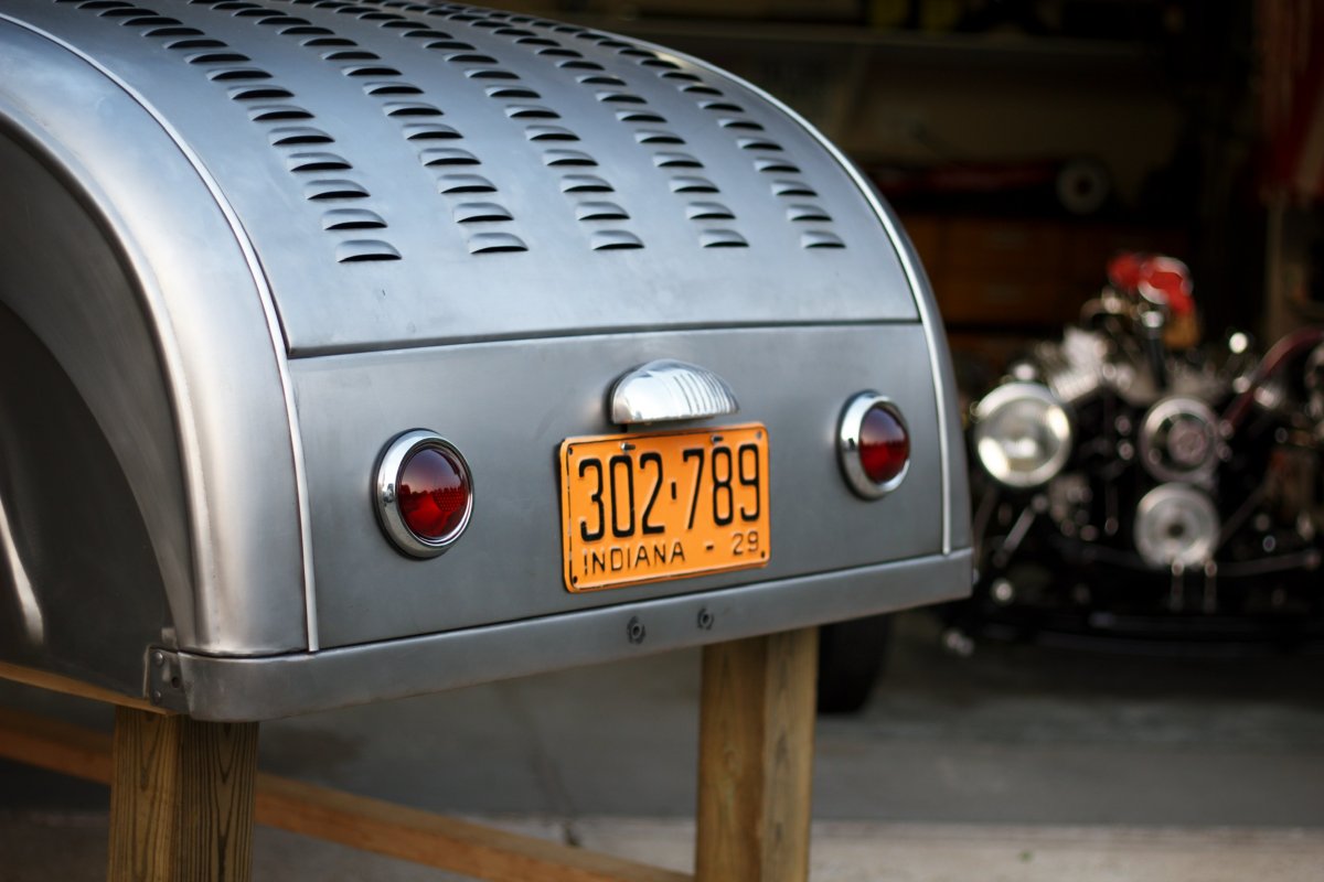

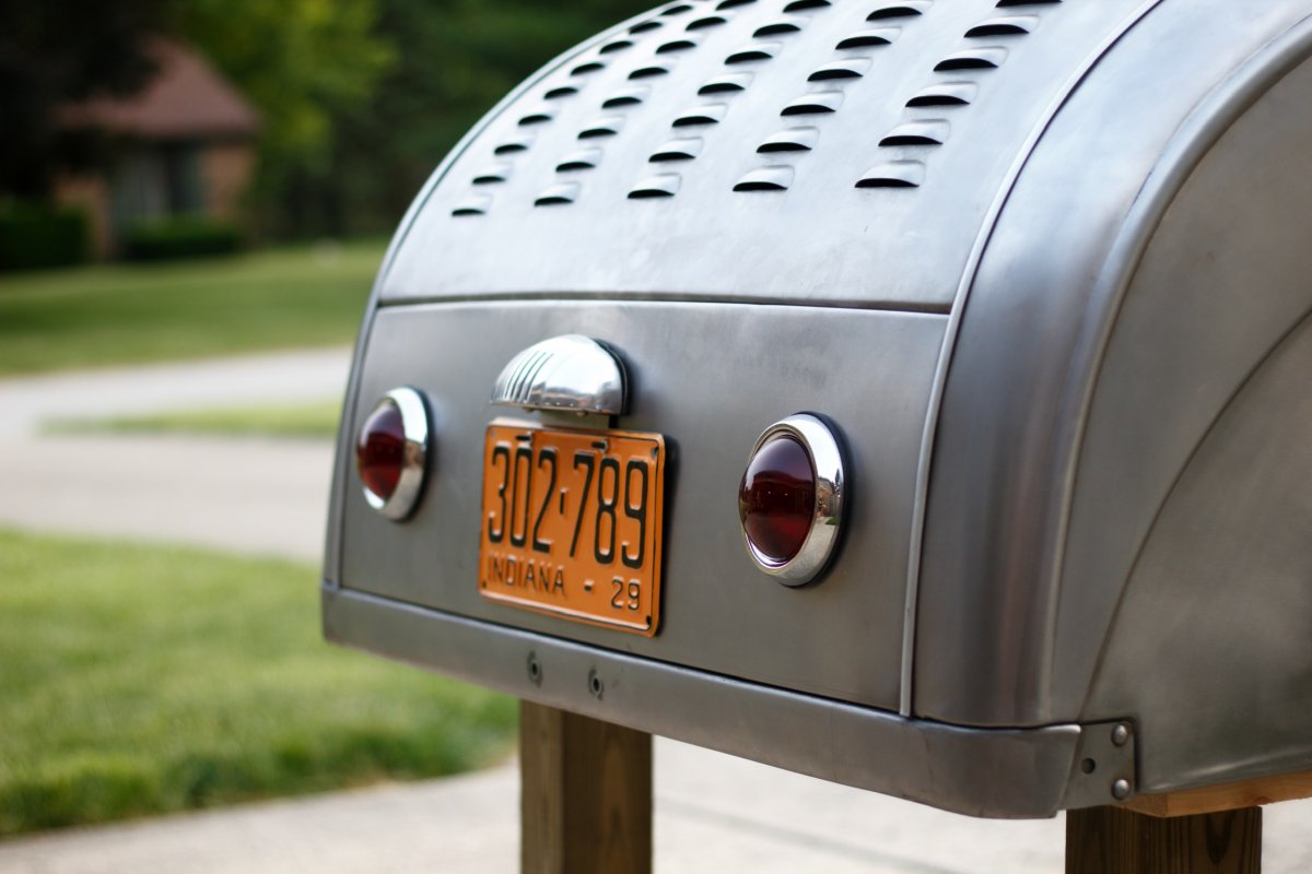

    Finally made the first hole in the body.
    I mounted up a simple set of ‘50 Pontiac taillights and a plate light from Granite Castings.

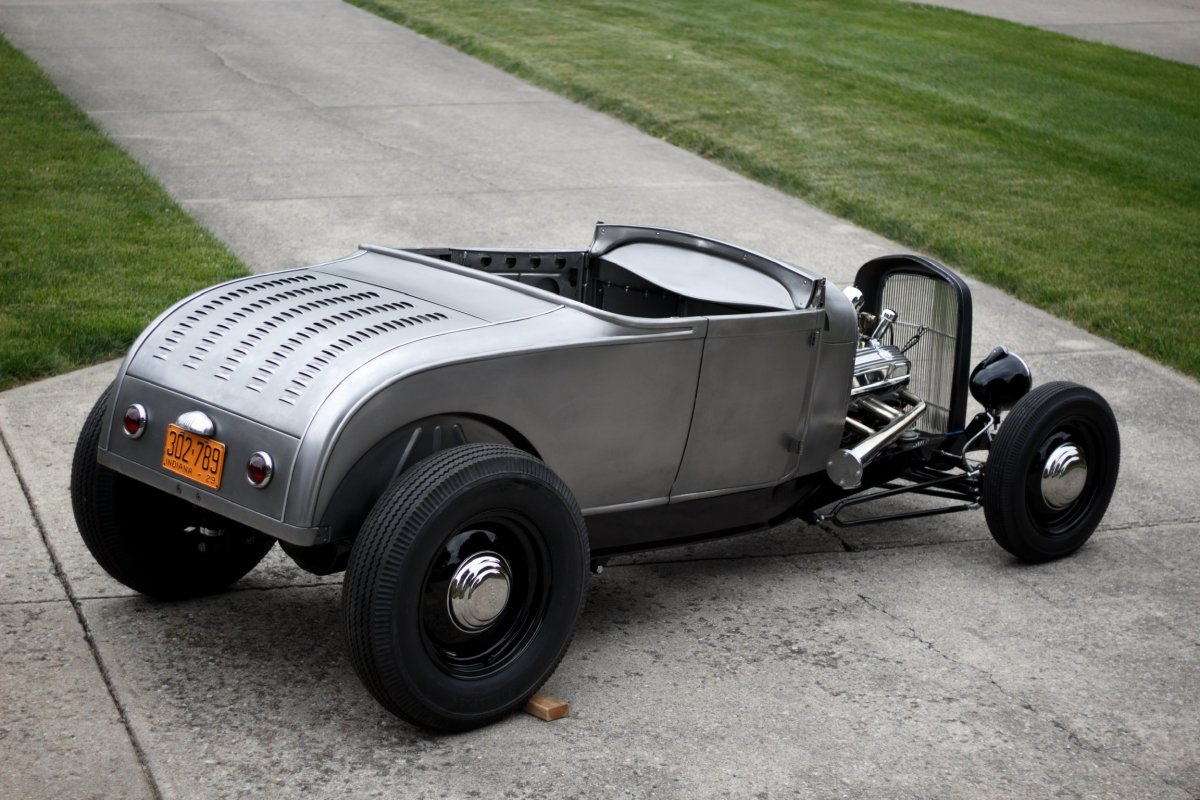

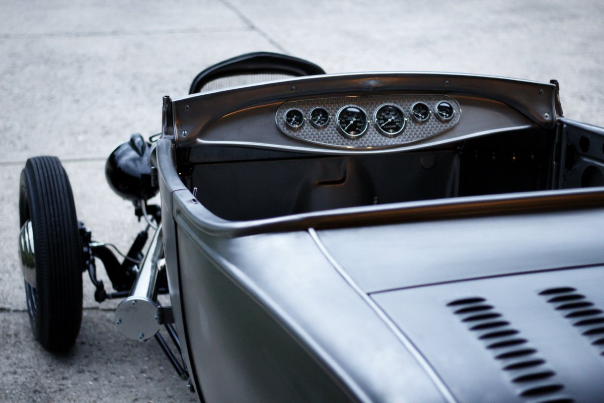

    I got the body sat on the chassis this weekend. I love the way it sits, it’s exactly what I wanted. I wanted to fit the pedals, transmission and steering column with everything together before I sent the body off to the body shop.

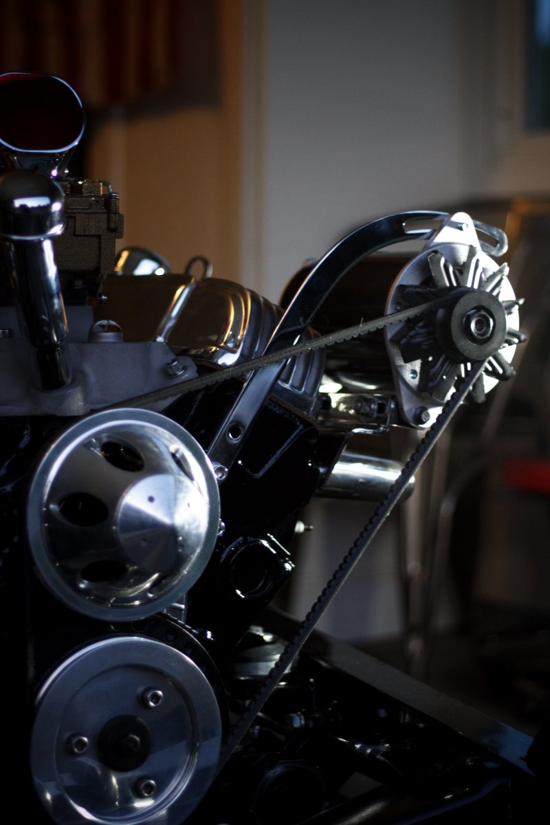

    Looks great, what did you use for an alternator bracket ?
  27. HerMink
    Posts: 173
    HerMink
    I bought a Mr Gasket bracket that mounts to the front two header bolts; I also bought the Mr Gasket arm that attaches to the water pump bolt.
    I also had to buy (Actually just had one made) a simple bracket that mounts between the bottom feet on the generator that attaches to that Mr Gasket header bolt bracket. These would have came on a factory generator but are not supplied with the PowerGen units. You can buy them repop from DanChuck TriFive Parts but it was cheaper to make one than it would have cost just for the shipping.

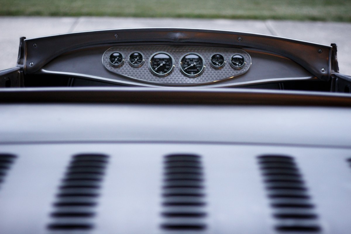

    I got around to drilling the dash for the gauges. I picked up a really nice machine turned bezel from Haneline Products and a set of Stewart Warner’s.
