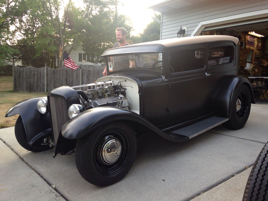

    Not too many updates. Been to damn hot to do anything. Going to install the tail lights this week and then order the roof wood kit. This past labor day weekend we had a Carbeque at the house. Here're a few photos for the hell of it.

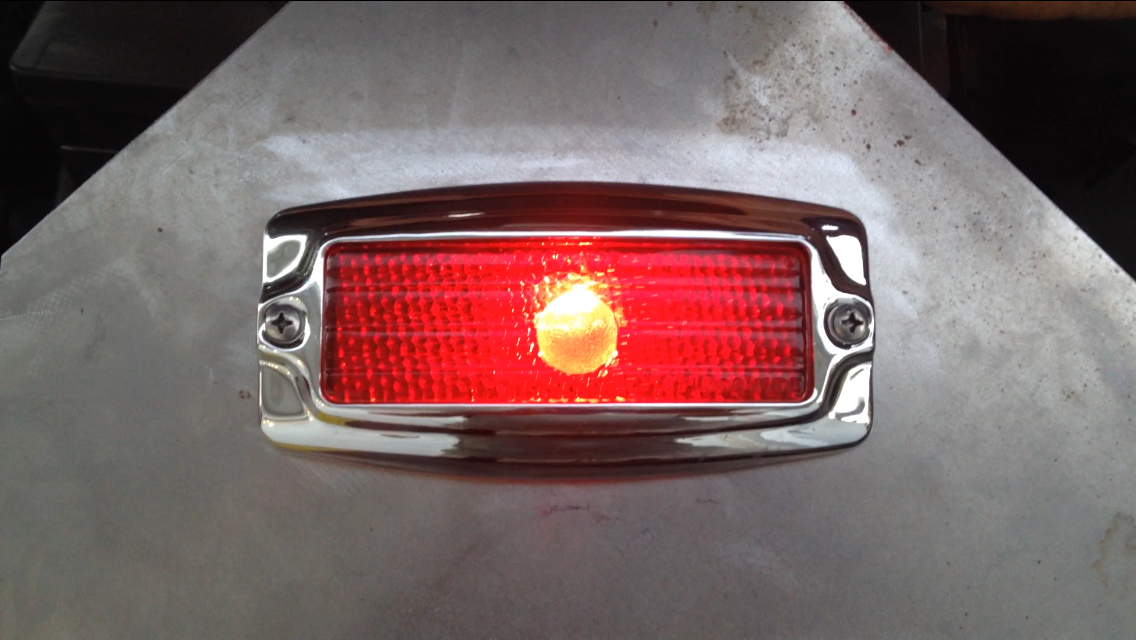

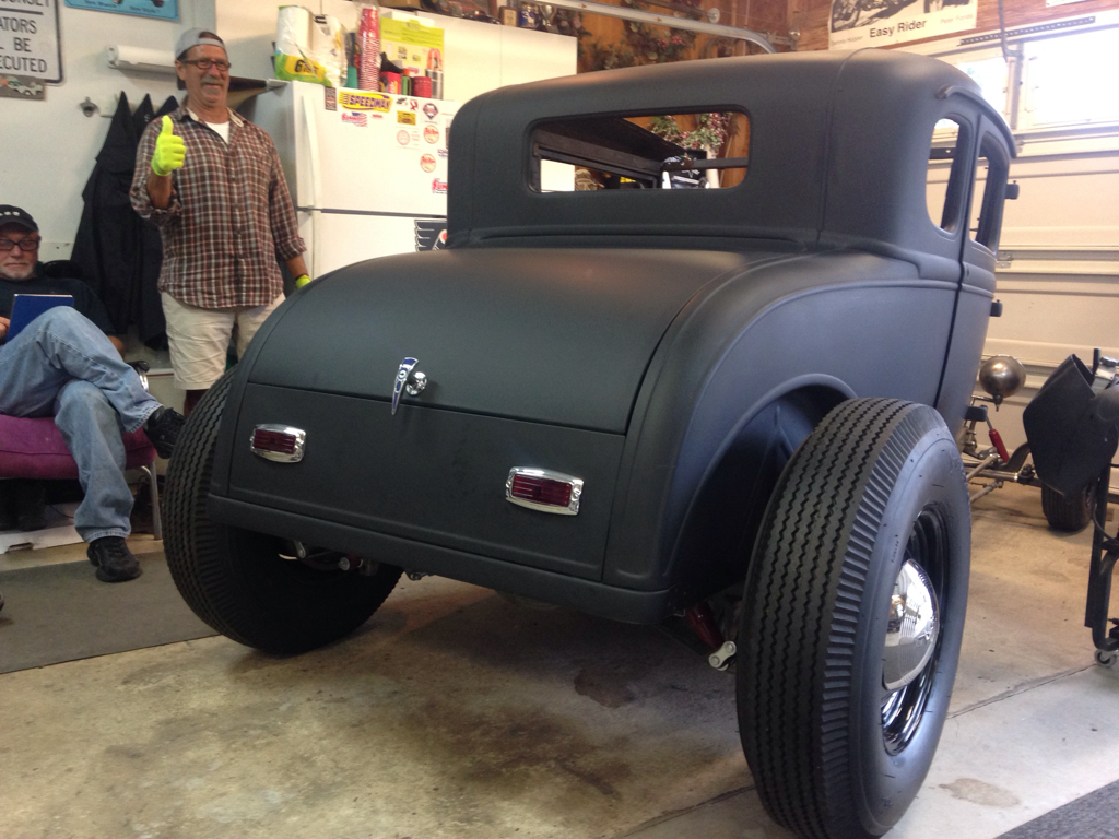

    Messed with the 1947/48 Kaiser Frazer tail lights tonight. Fitted in new 1157 plugs, blasted the buckets, fit them to a test sheet of metal, and checked the brightness. These'll be just fine.
    Studebakermatt and loudbang like this.
  16. loudbang
    Posts: 40,292
    Nice improvement over the old style lighting.
    HelmuthBrothers likes this.
  17. aplayer
    Joined: Dec 2, 2006
    Posts: 148
    aplayer
    Oh more than fine.
  18. HelmuthBrothers
    Joined: Oct 11, 2007
    Posts: 786
    HelmuthBrothers
    from New Jersey
    I was pleasantly surprised how bright the 1157 bulbs were. I didn't want to run LED 1157 bulbs if I didn't have to. Ive seen some guys run them and you don't even notice the LEDs in them because some of the lenses must been thicker than others, and then other times where you clearly can see an LED bulb inside the housing. No bueno. PepBoys universal 1157 plugs fit like a glove.

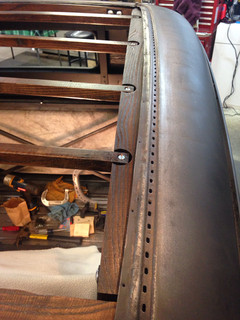

  19. HelmuthBrothers
    Posts: 786
    HelmuthBrothers
    from New Jersey

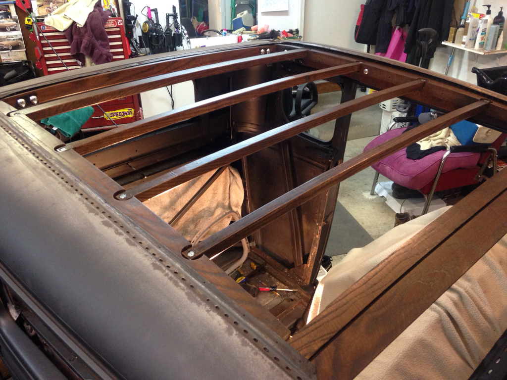

    Got the tail lights done today and started ripping out all of the original top wood which was an absolute mess but came apart really easy.

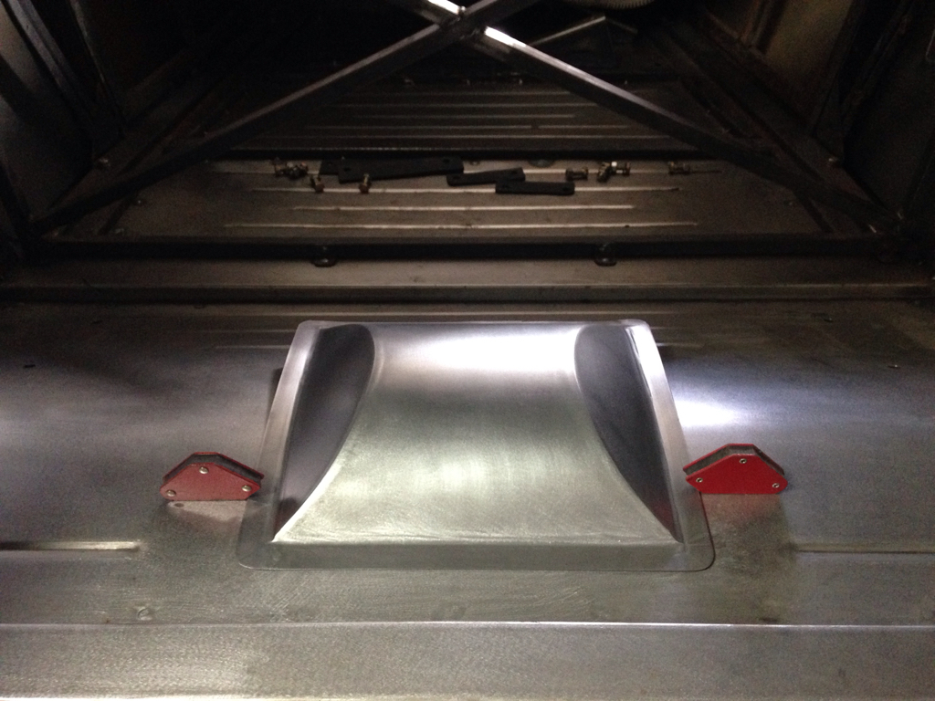

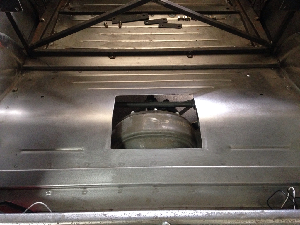

  22. HelmuthBrothers
    Posts: 786
    HelmuthBrothers
    from New Jersey
    Had to pull the tank back out to install the little pumpkin hump. Going to have to fit it to the floor a little better since its a universal stock 32 floor hump. We also removed all of the original top wood and started cleaning the metal behind where the wood goes. Fortunately no surprises back there.
    Studebakermatt and D-Russ like this.
  23. loudbang
    Posts: 40,292
    Wow this shot is like one of those optical illusions one. At first I was thinking you had it in UPSIDE DOWN then moved my head a bit and presto chango it looked right side up. o_O
  24. HelmuthBrothers
    Posts: 786
    HelmuthBrothers
    from New Jersey
    All welded in. The tank looks closer to the cover in pics than it actually is.

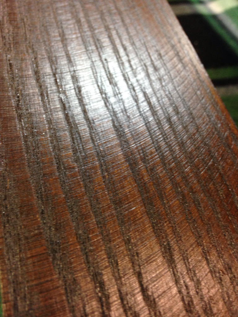

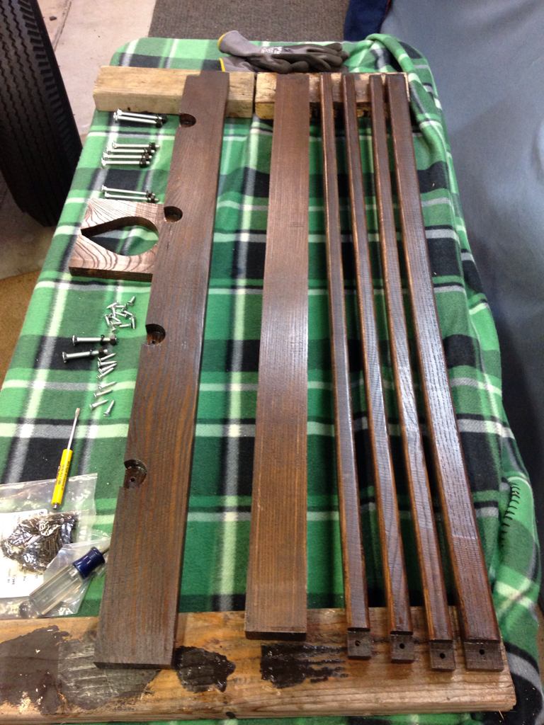

    Finished staining and installing all of the new top wood. Blasted all of the original brackets and repainted everything with rustoleum semiflat. My favorite rattle can paint.
    Question for you Model A guys...does anyone put anything between the top metal and the wood? Or do you guys just nail it right to the wood?
