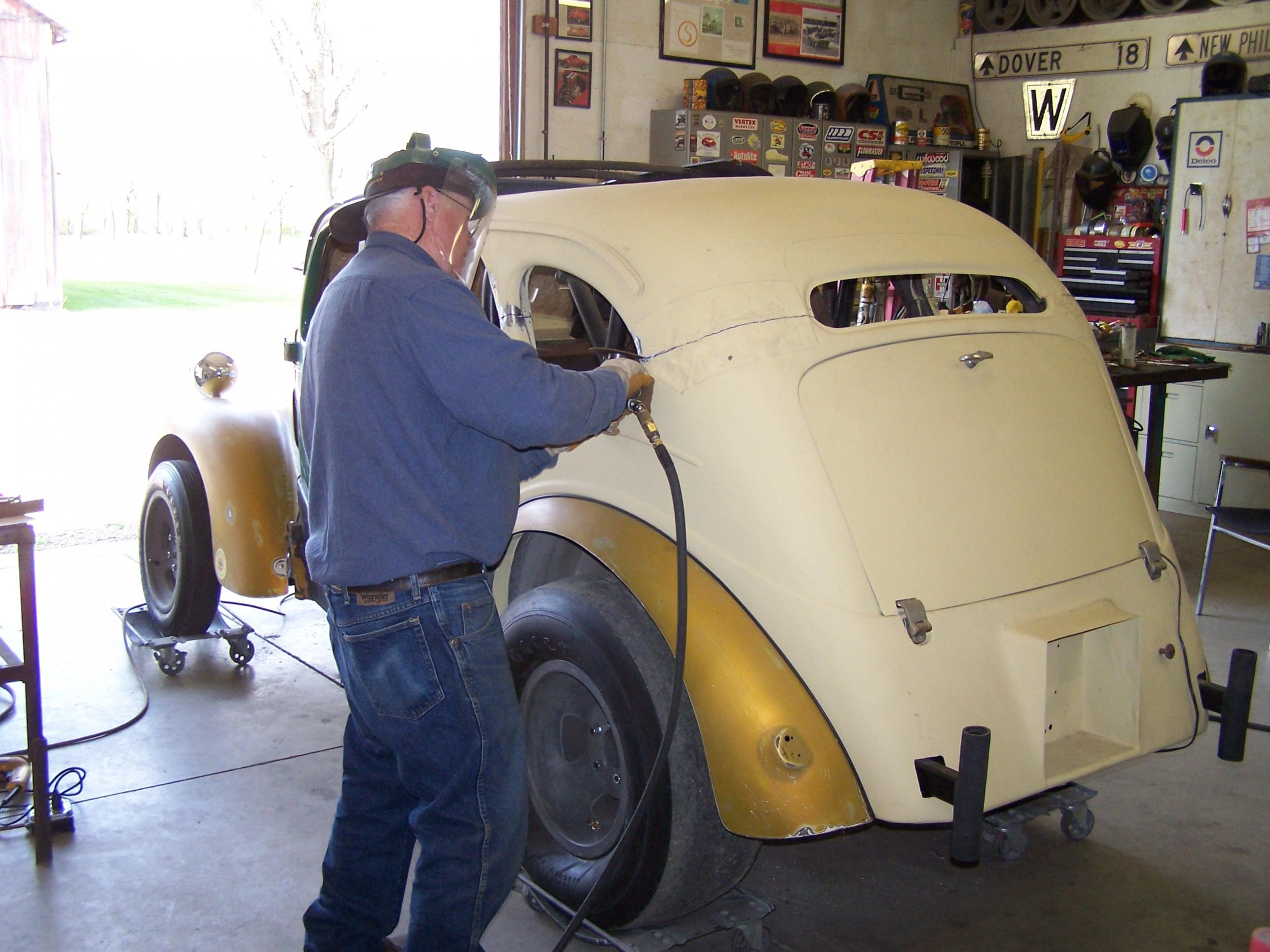

    More........

    More.......

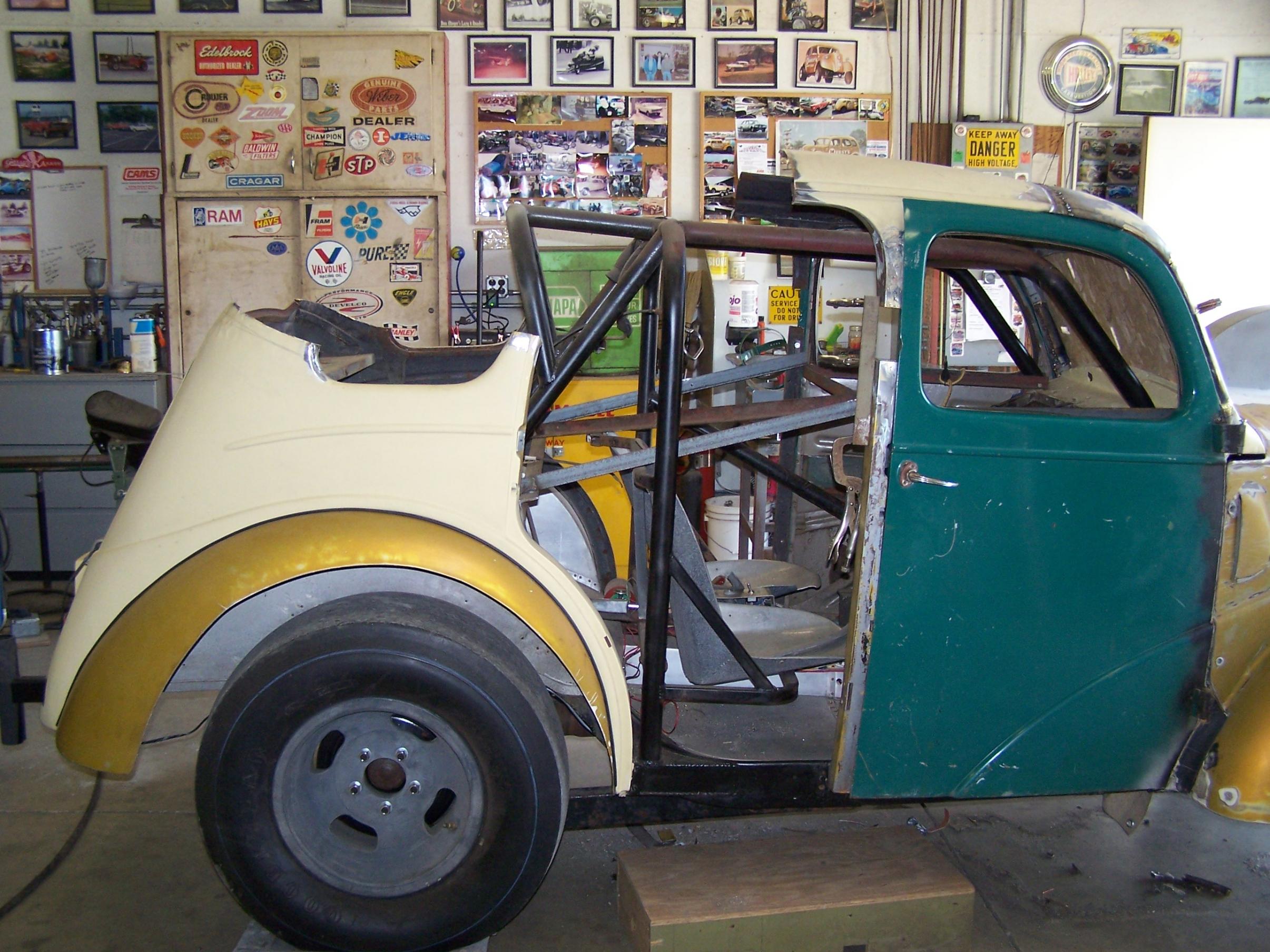

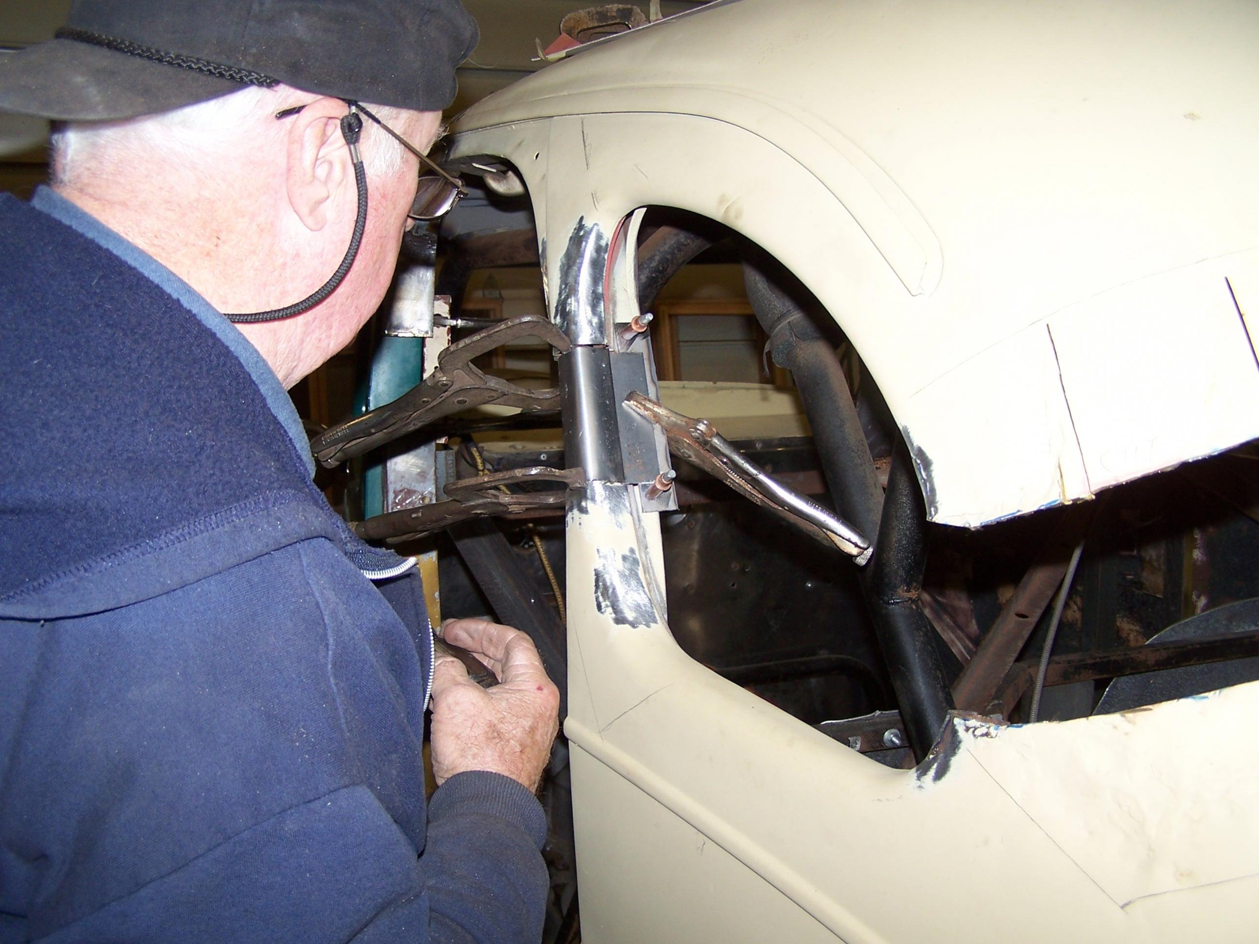

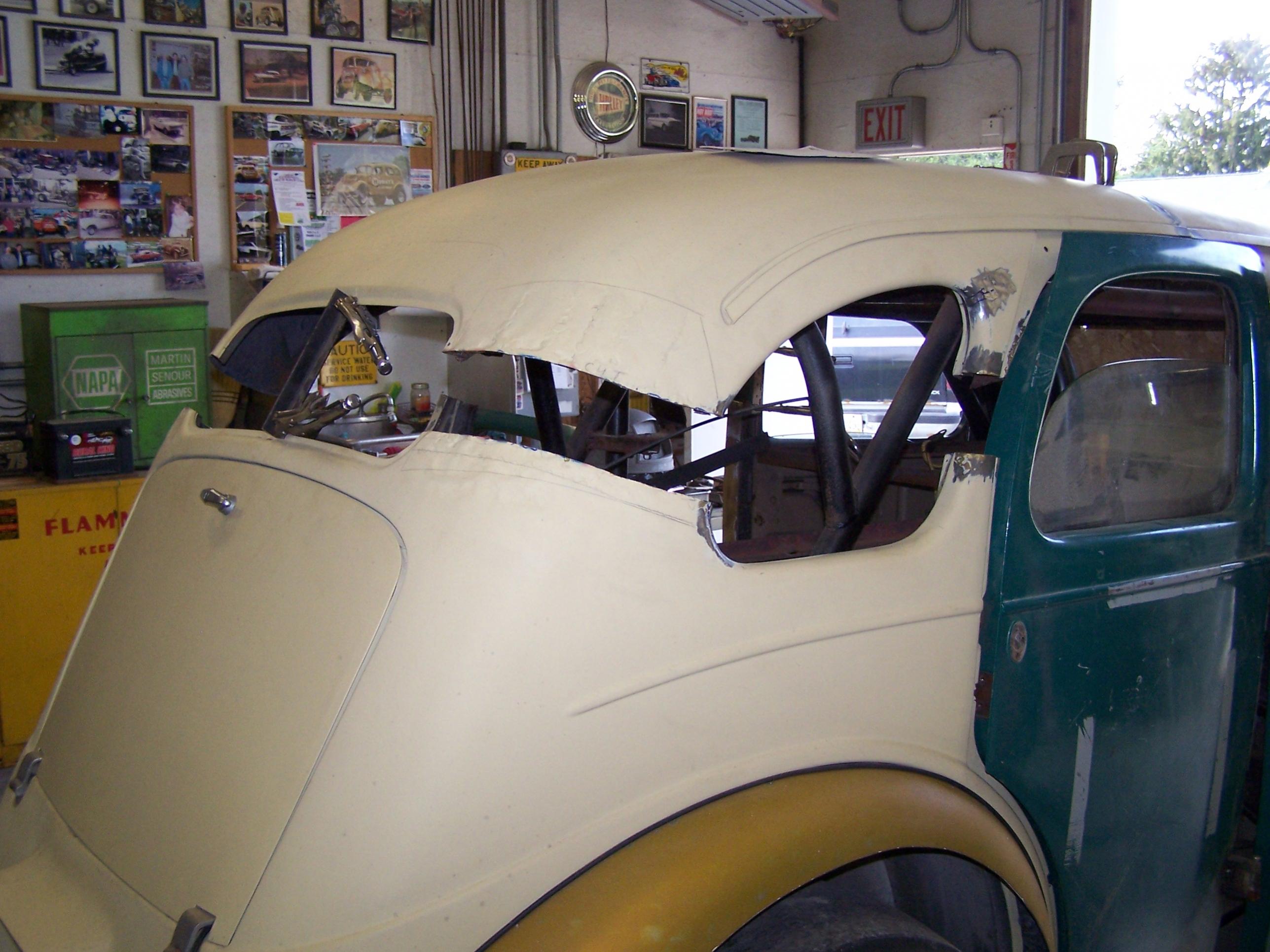

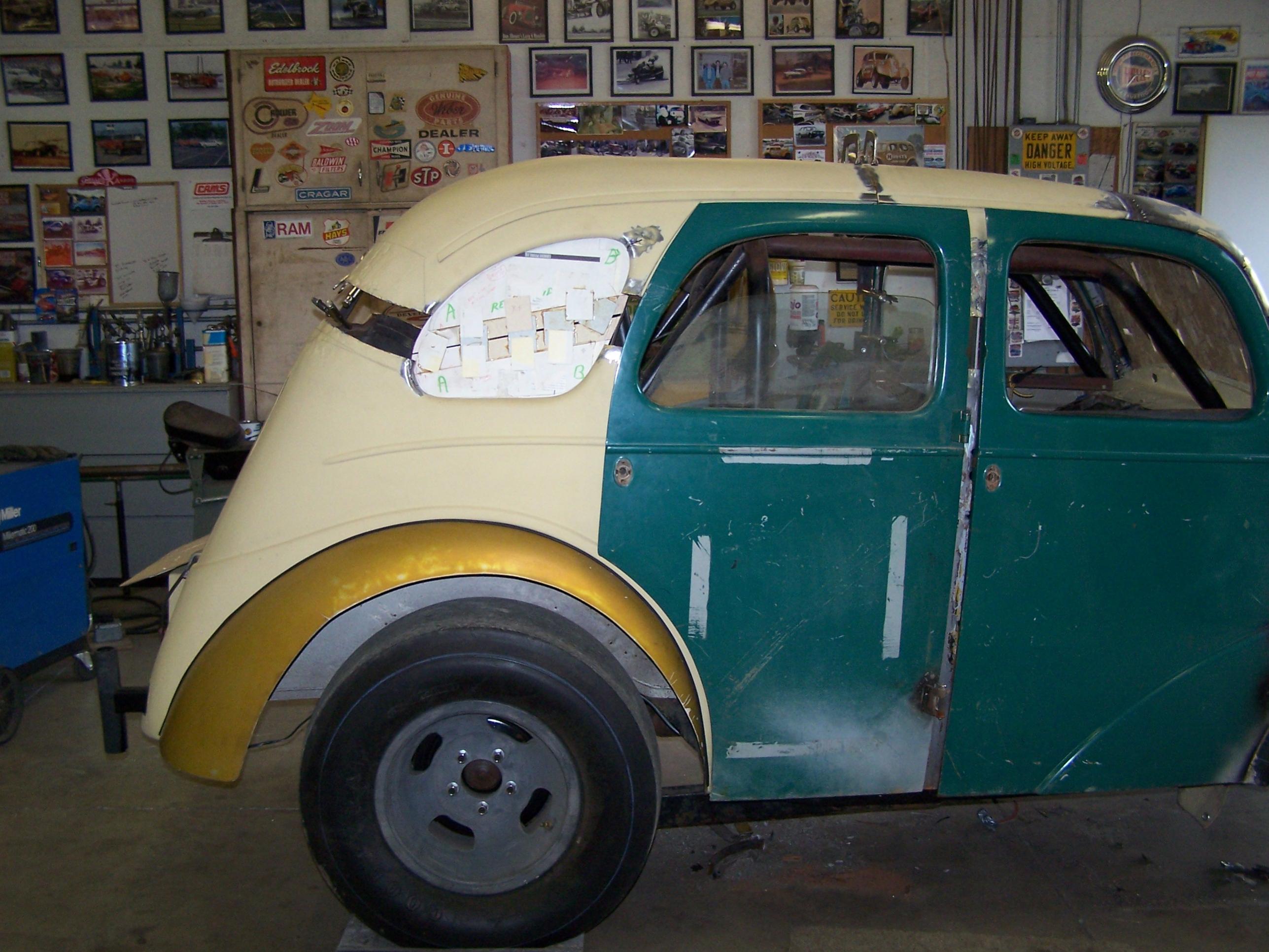

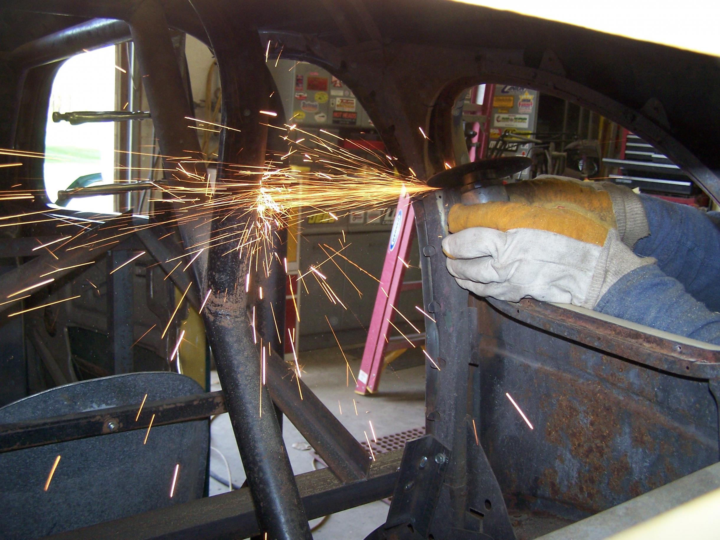

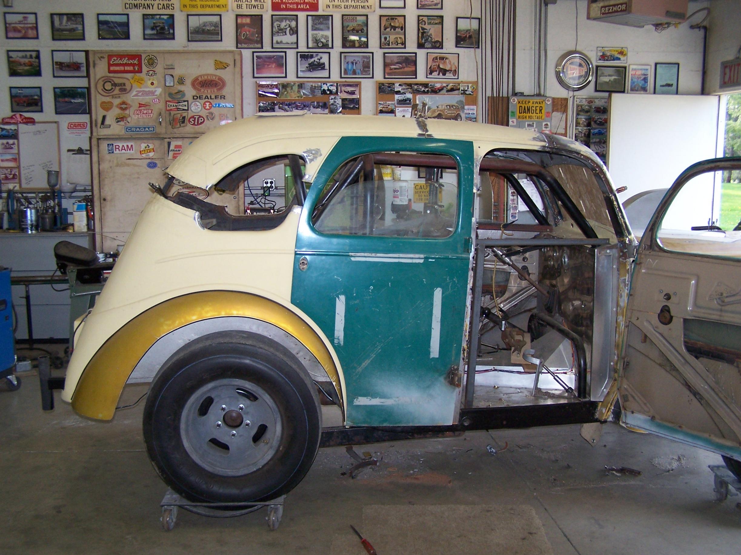

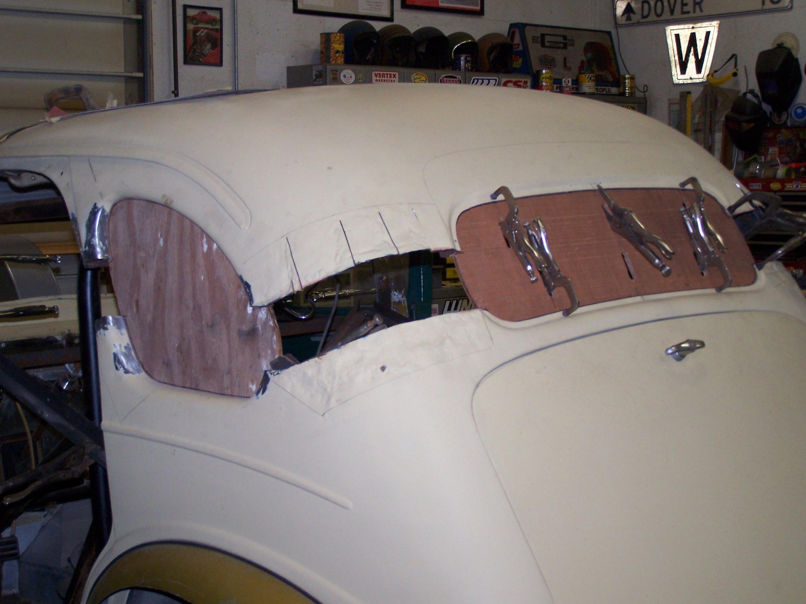

  3. Now all ya gotta do, is un-chop the rollcage.
  4. careyohio
    Joined: Jun 6, 2008
    Posts: 410
    careyohio

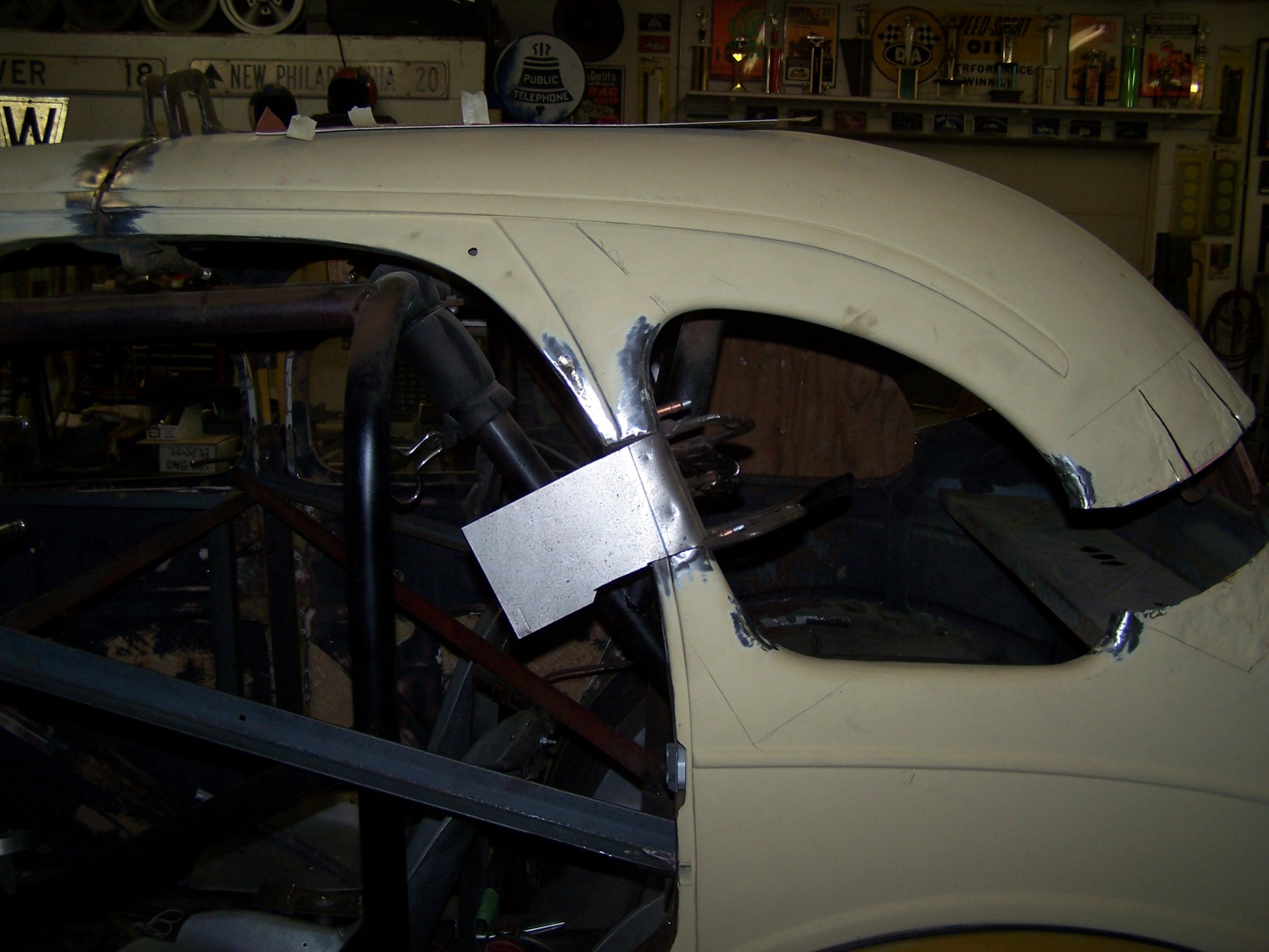

    The roll cage has to come out. See post # 282 for the style of roll cage that was originally in it...I think we may have one , but will have to measure to make sure it fits.

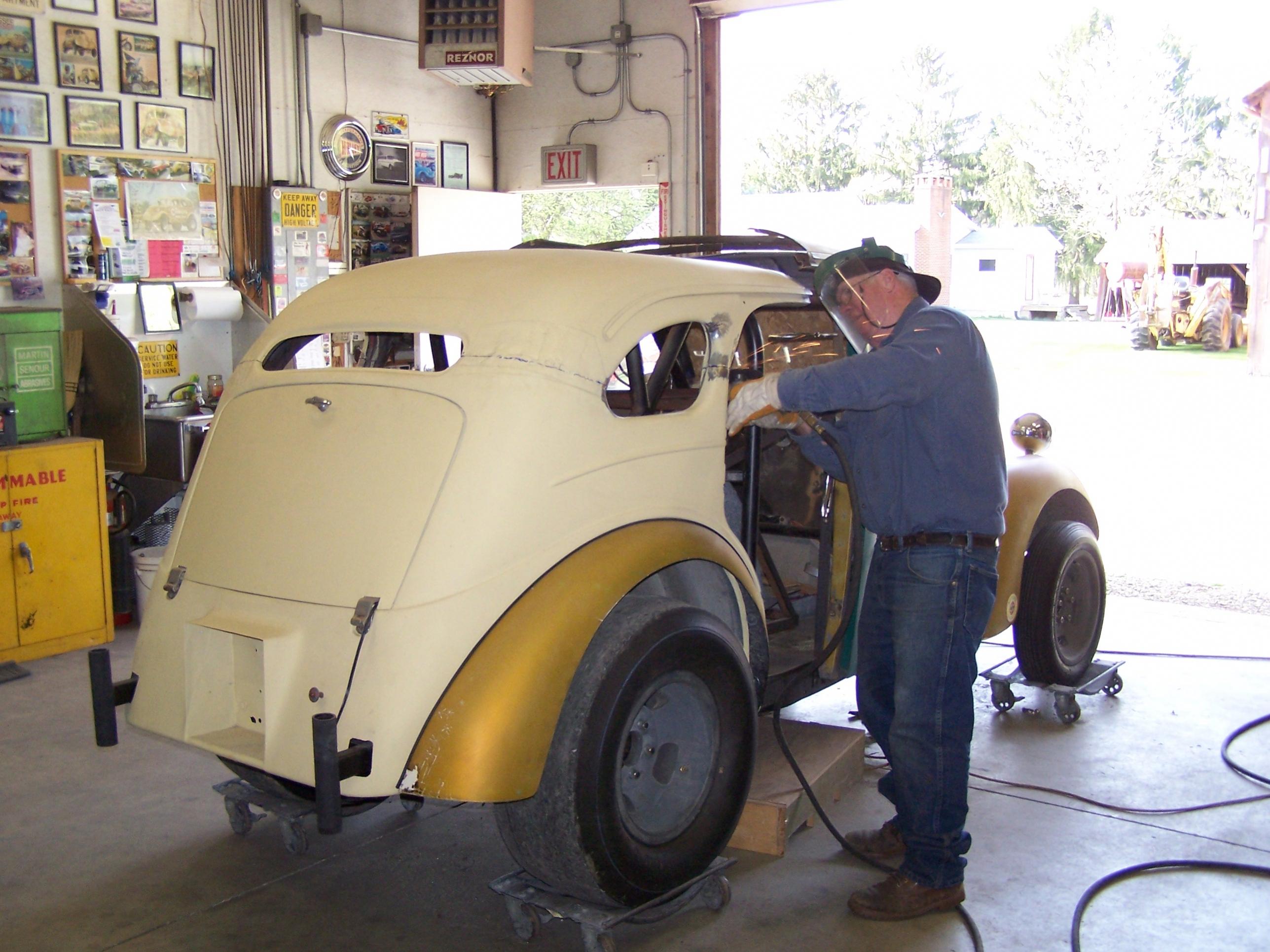

    More...........

    More.....

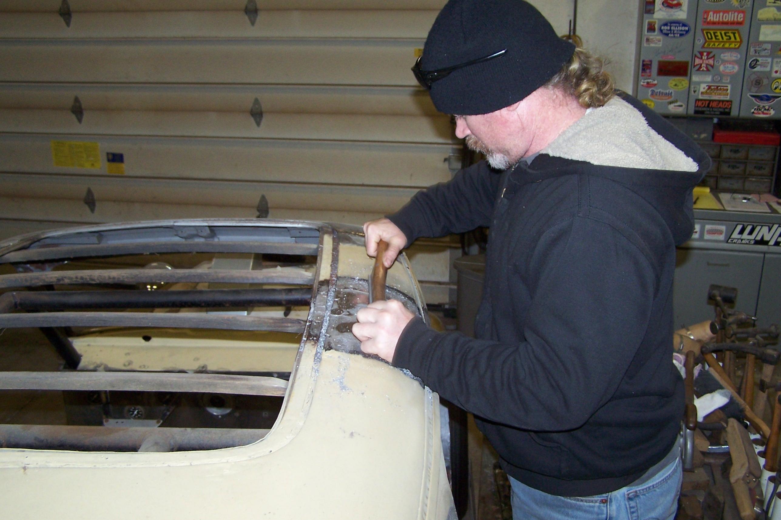

    More........

    Last of the early photos..........

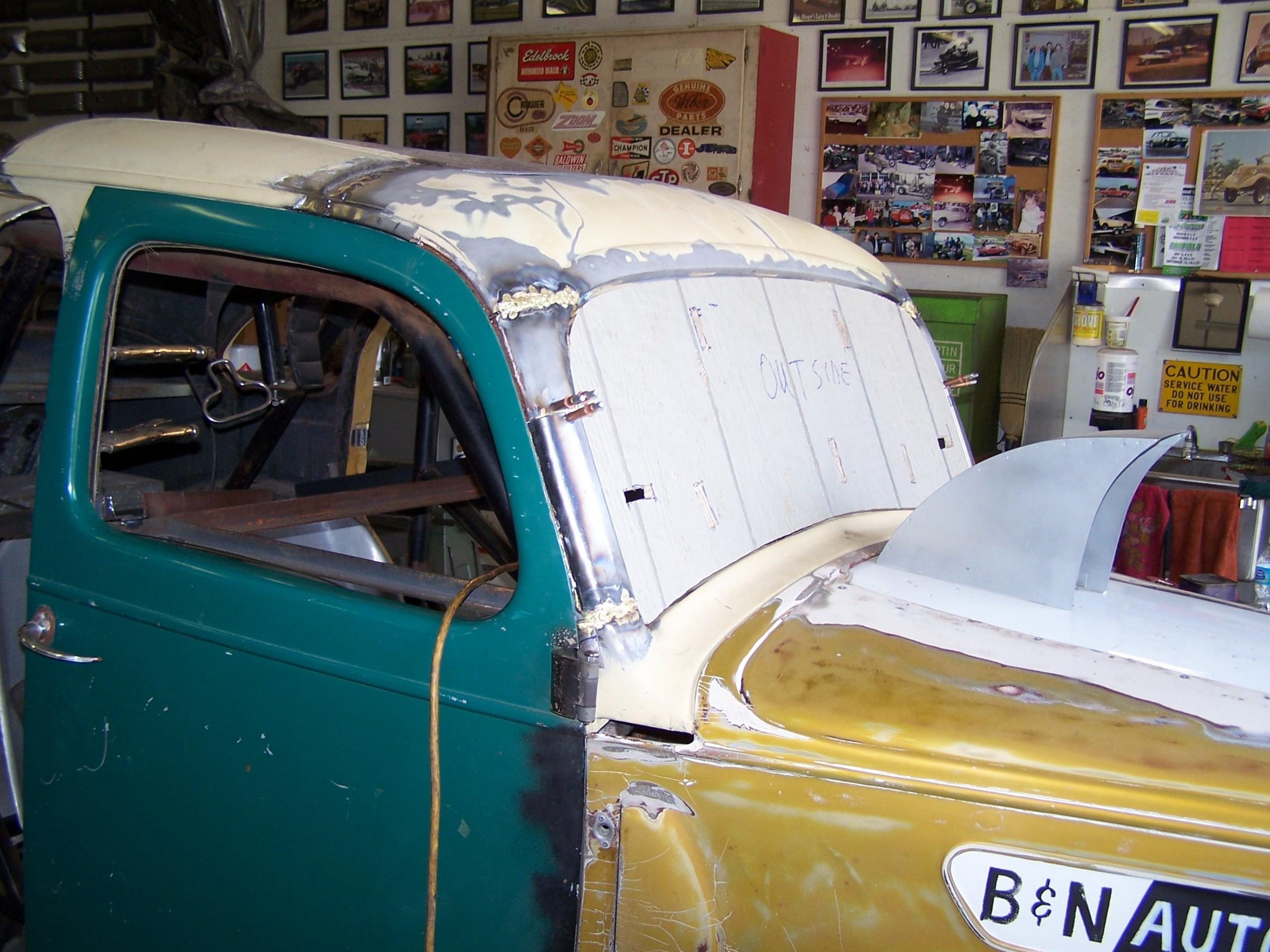

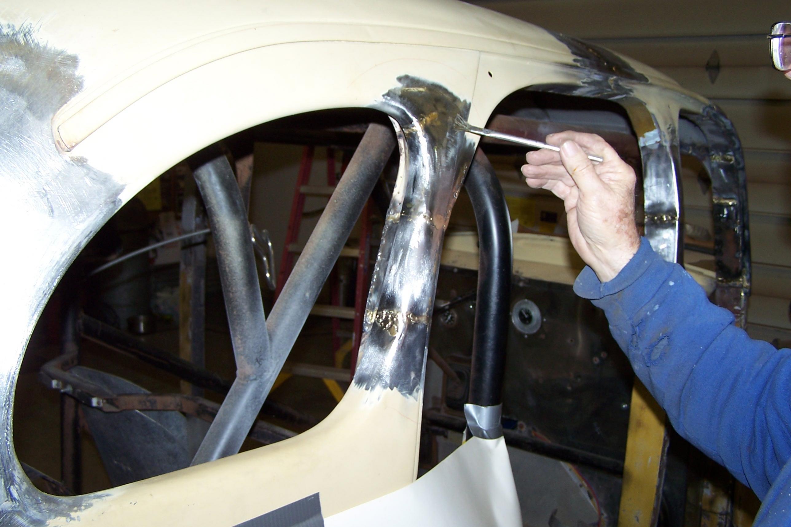

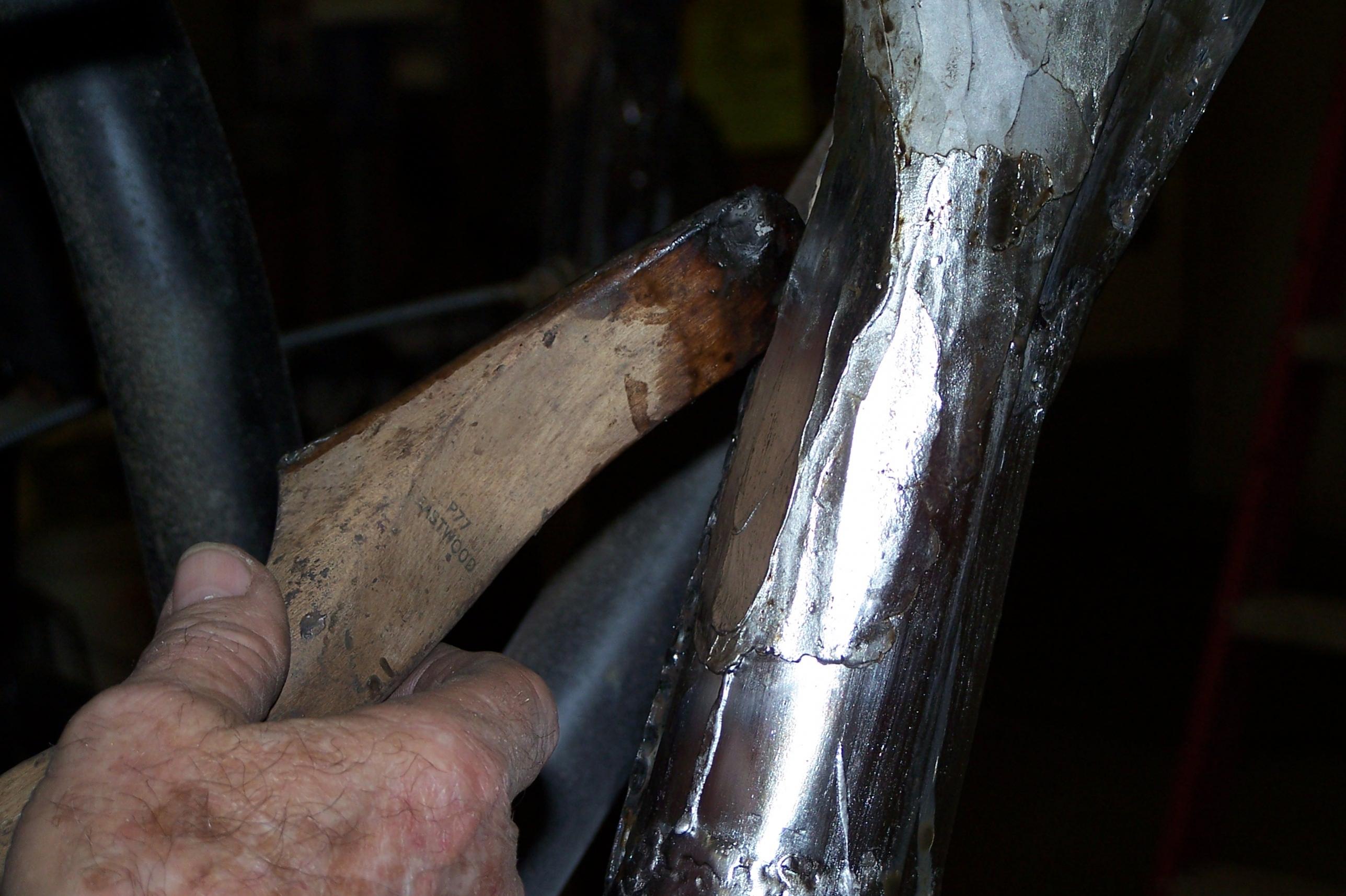

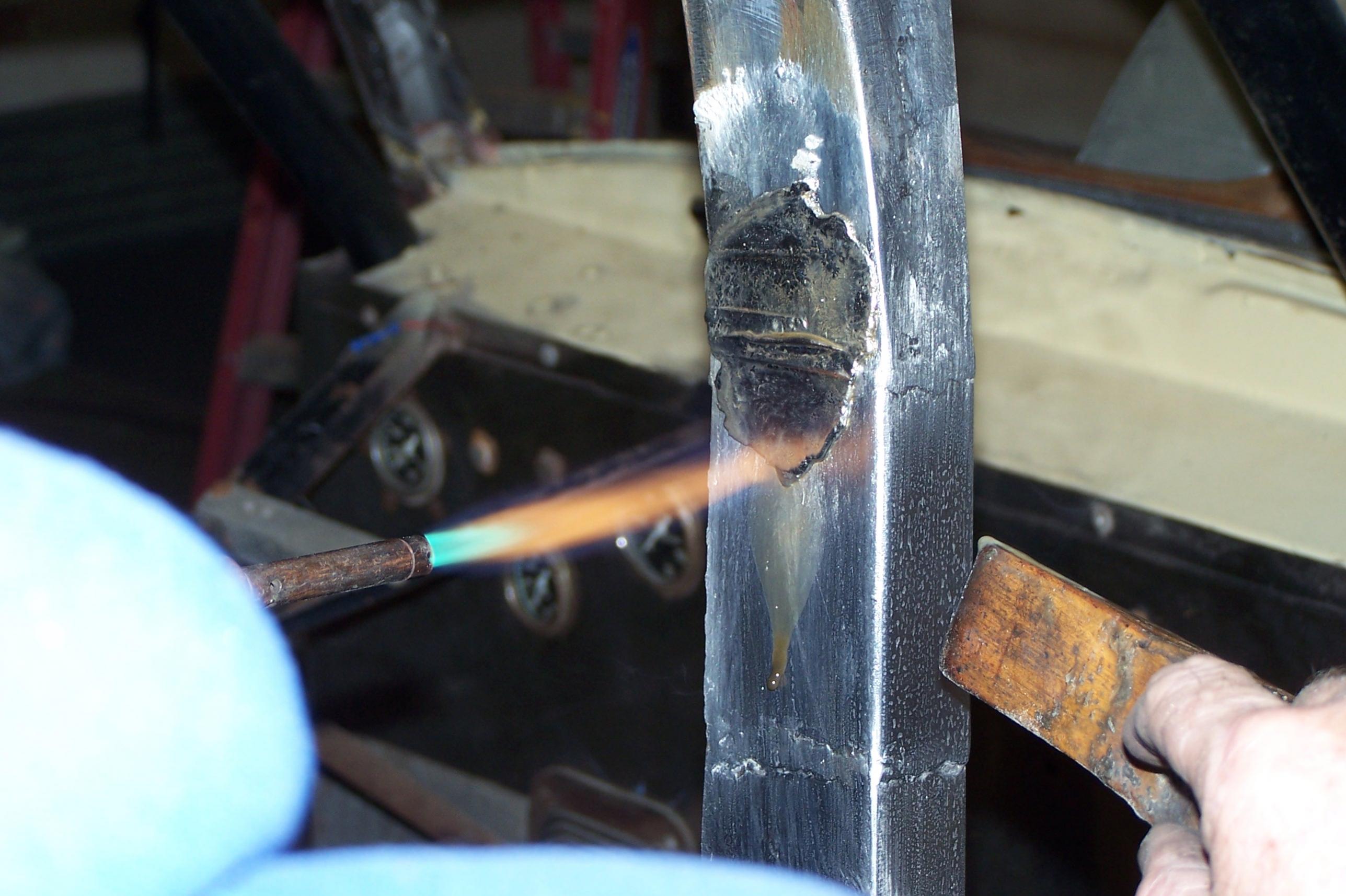

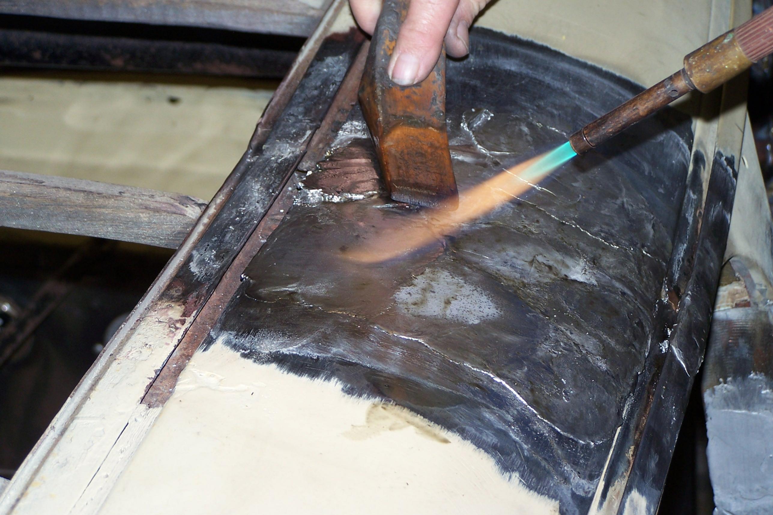

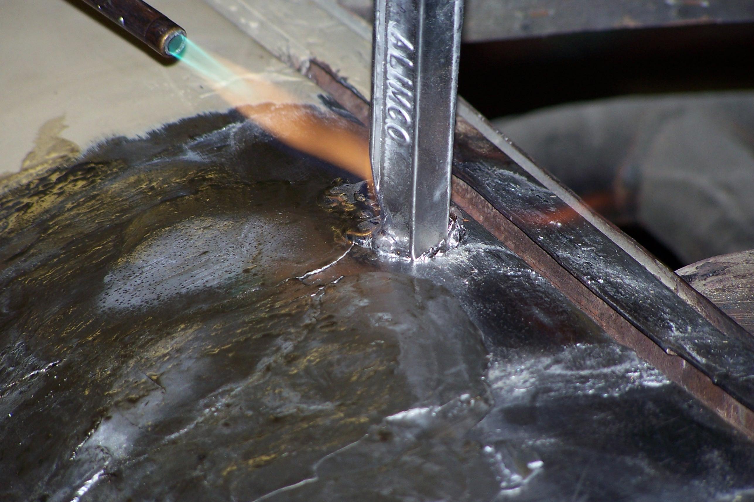

  13. careyohio
    Joined: Jun 6, 2008
    Posts: 410
    careyohio

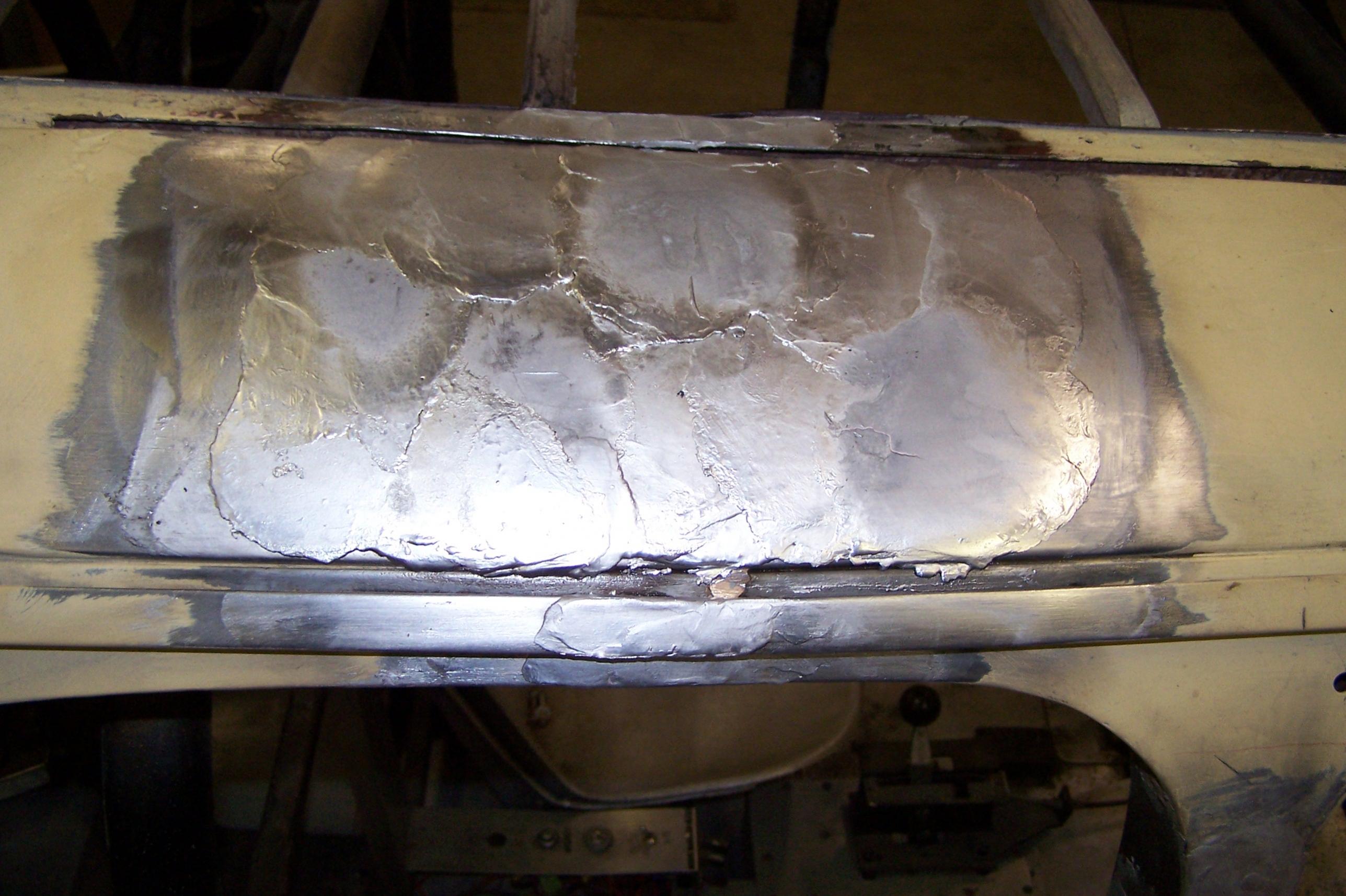

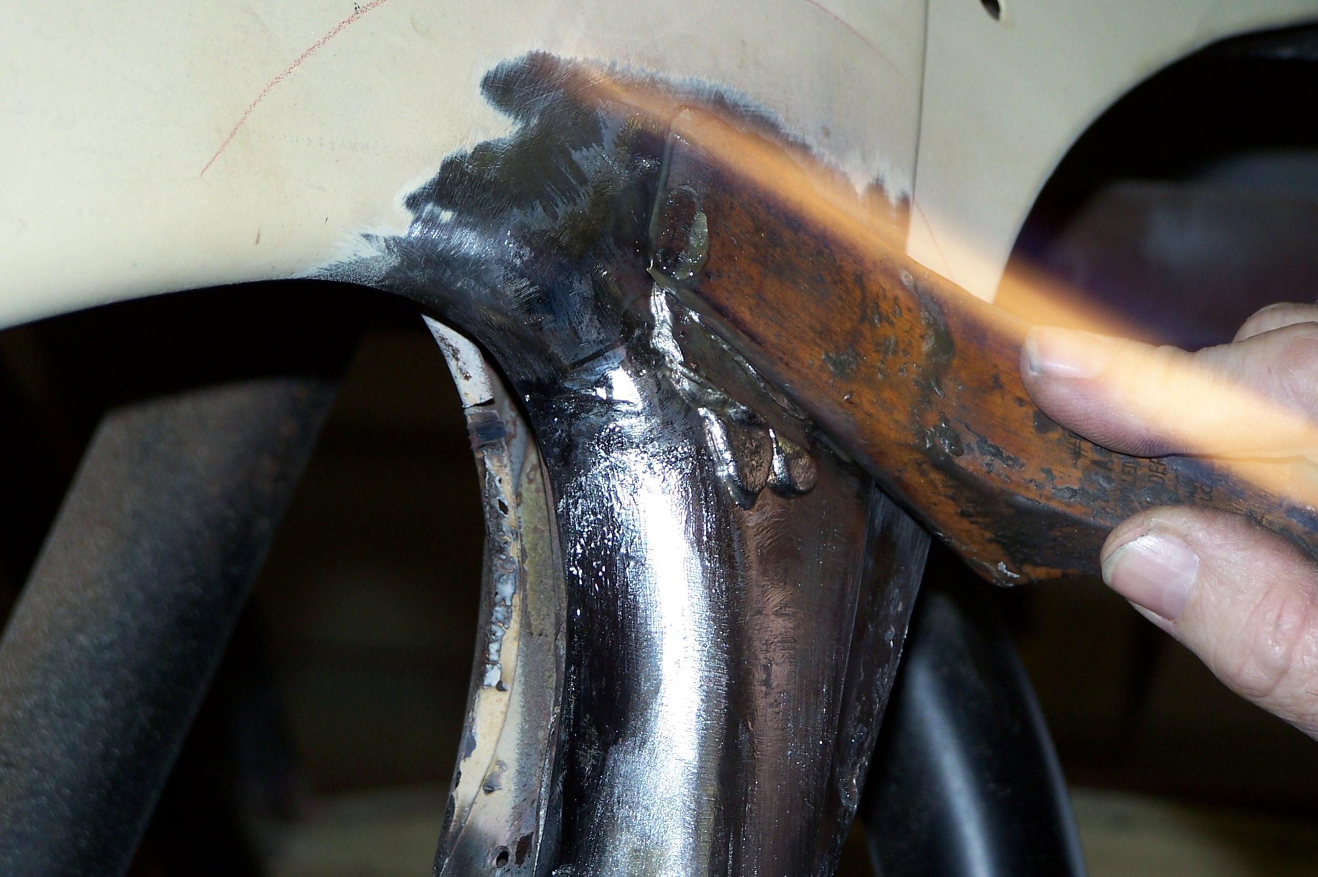

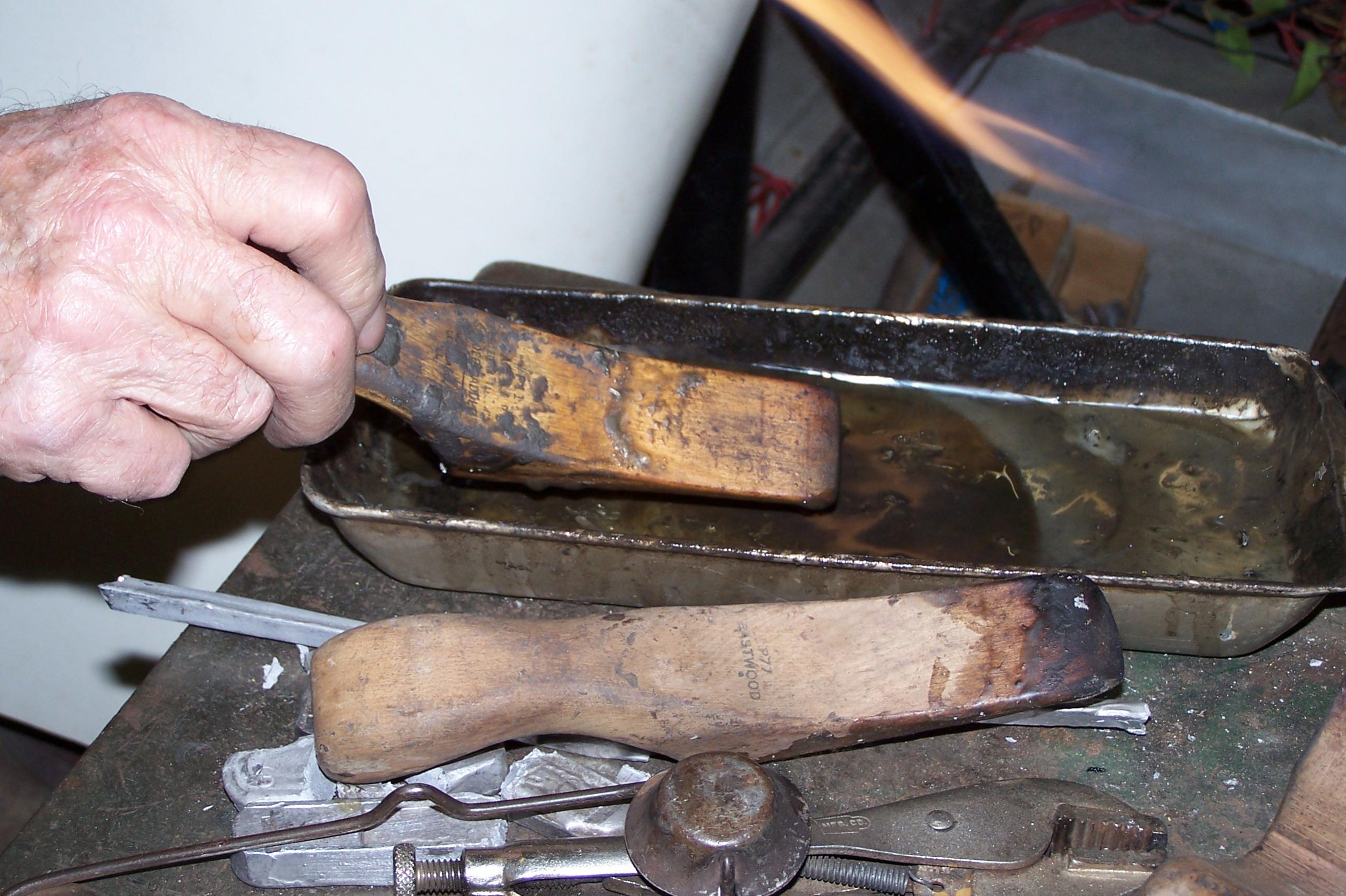

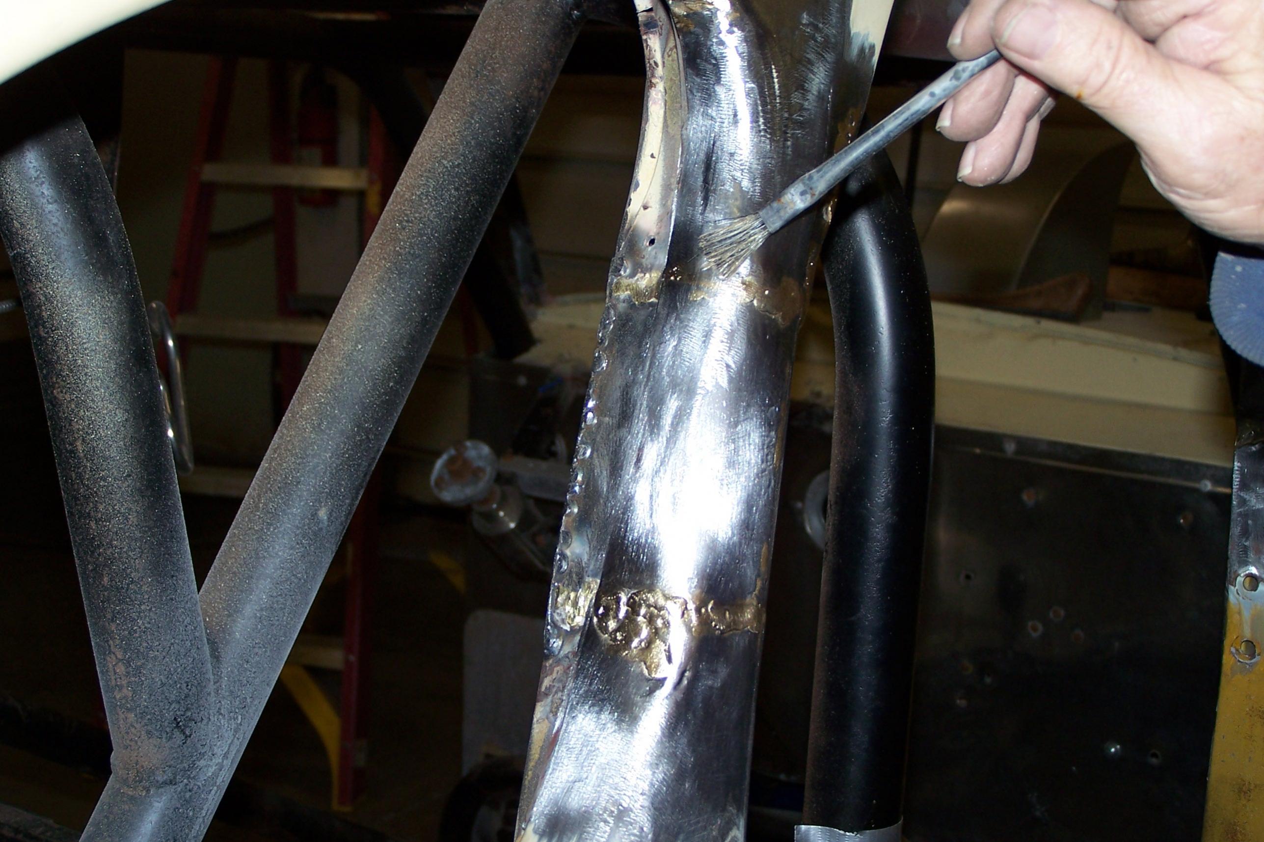

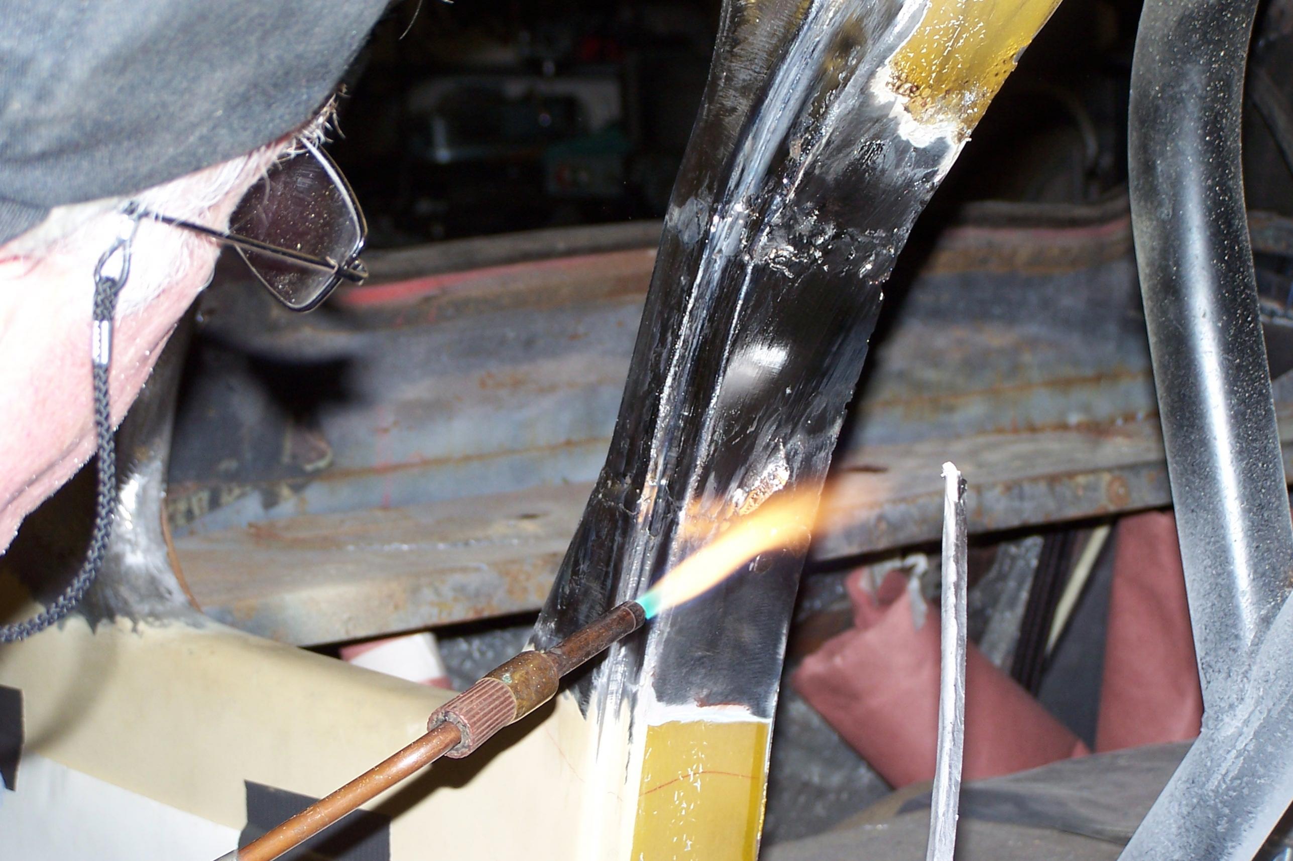

    Applying acid to cleaned metal.......
    Tinning the metal....
    Leading.......

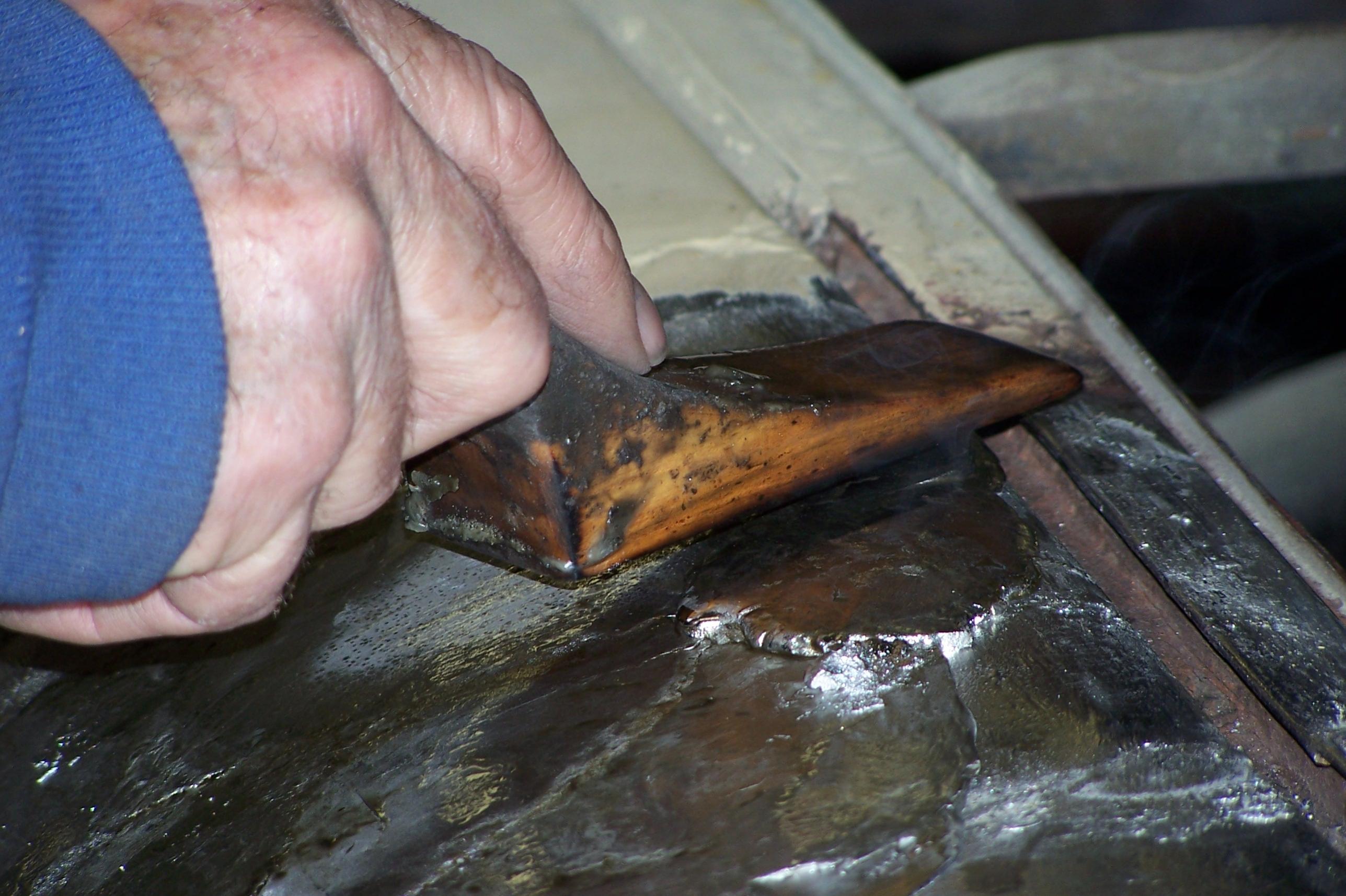

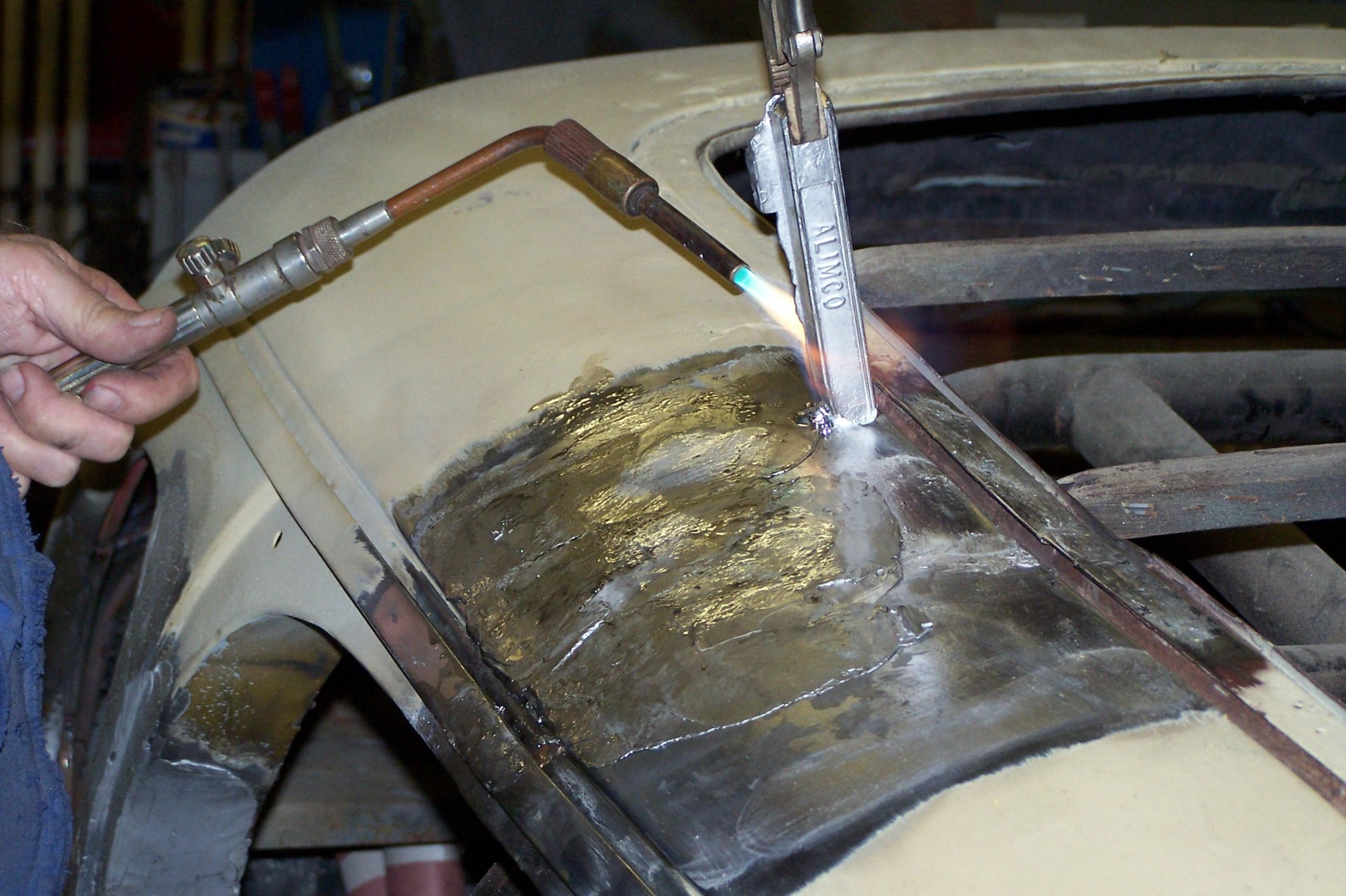

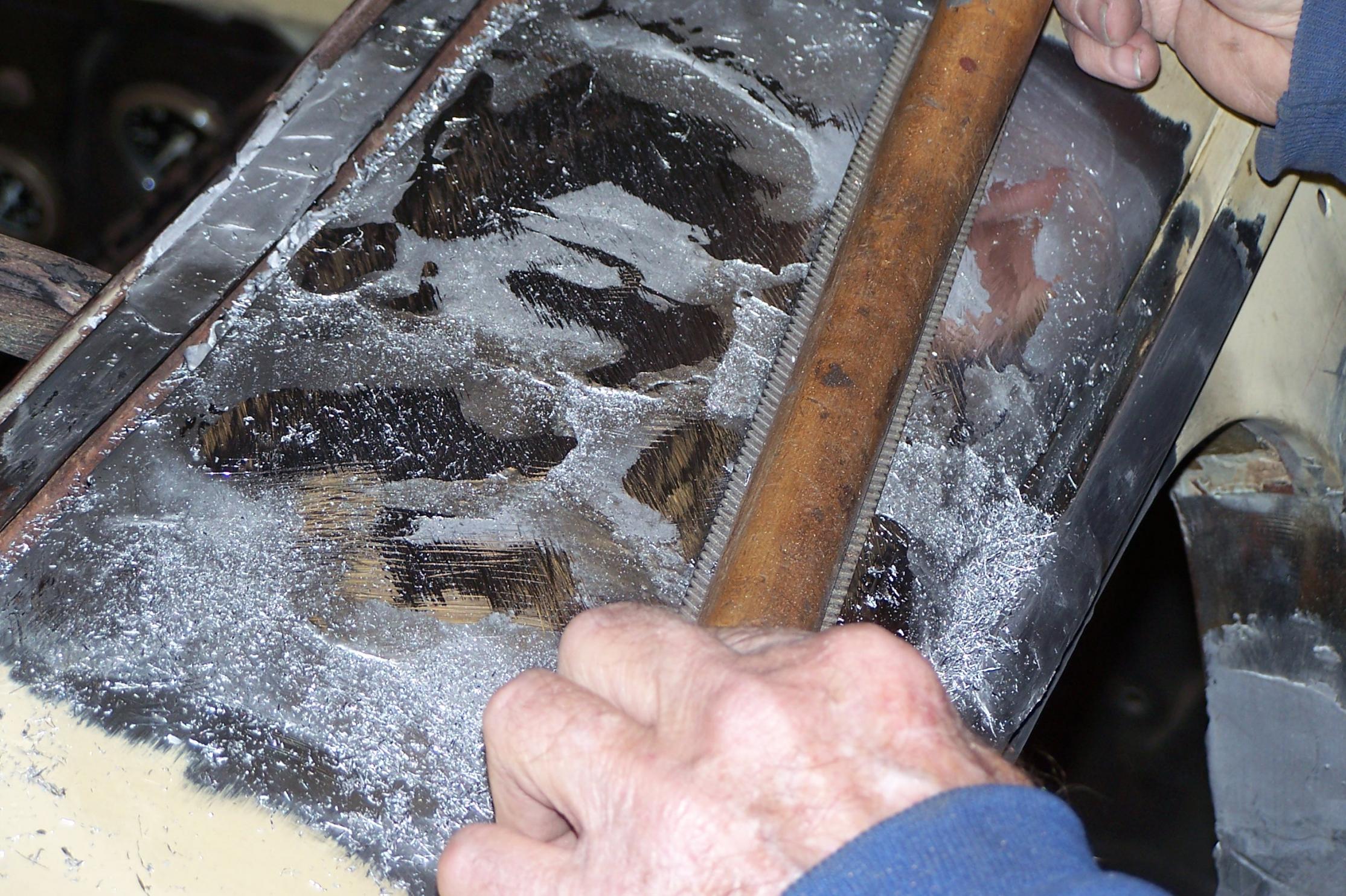

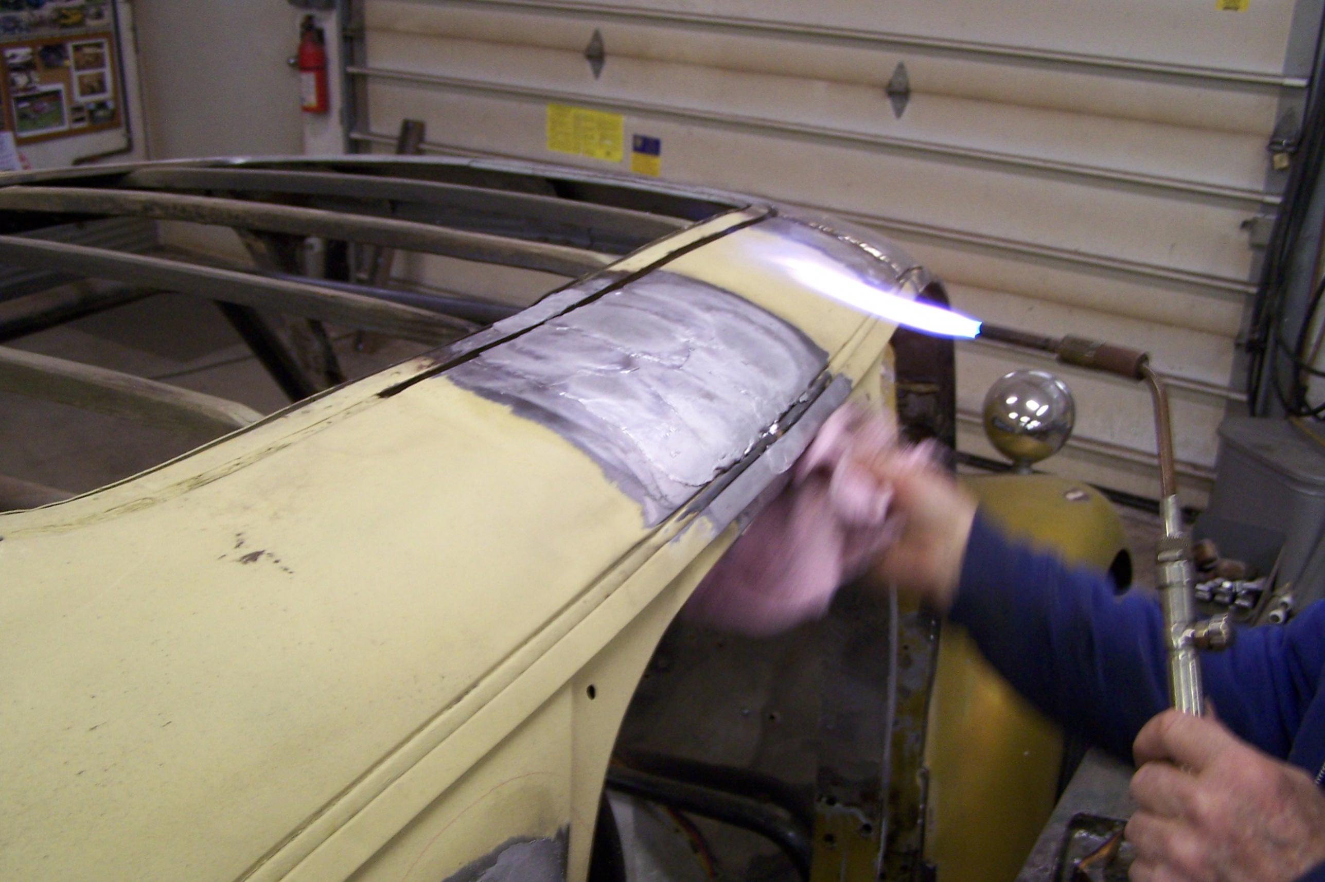

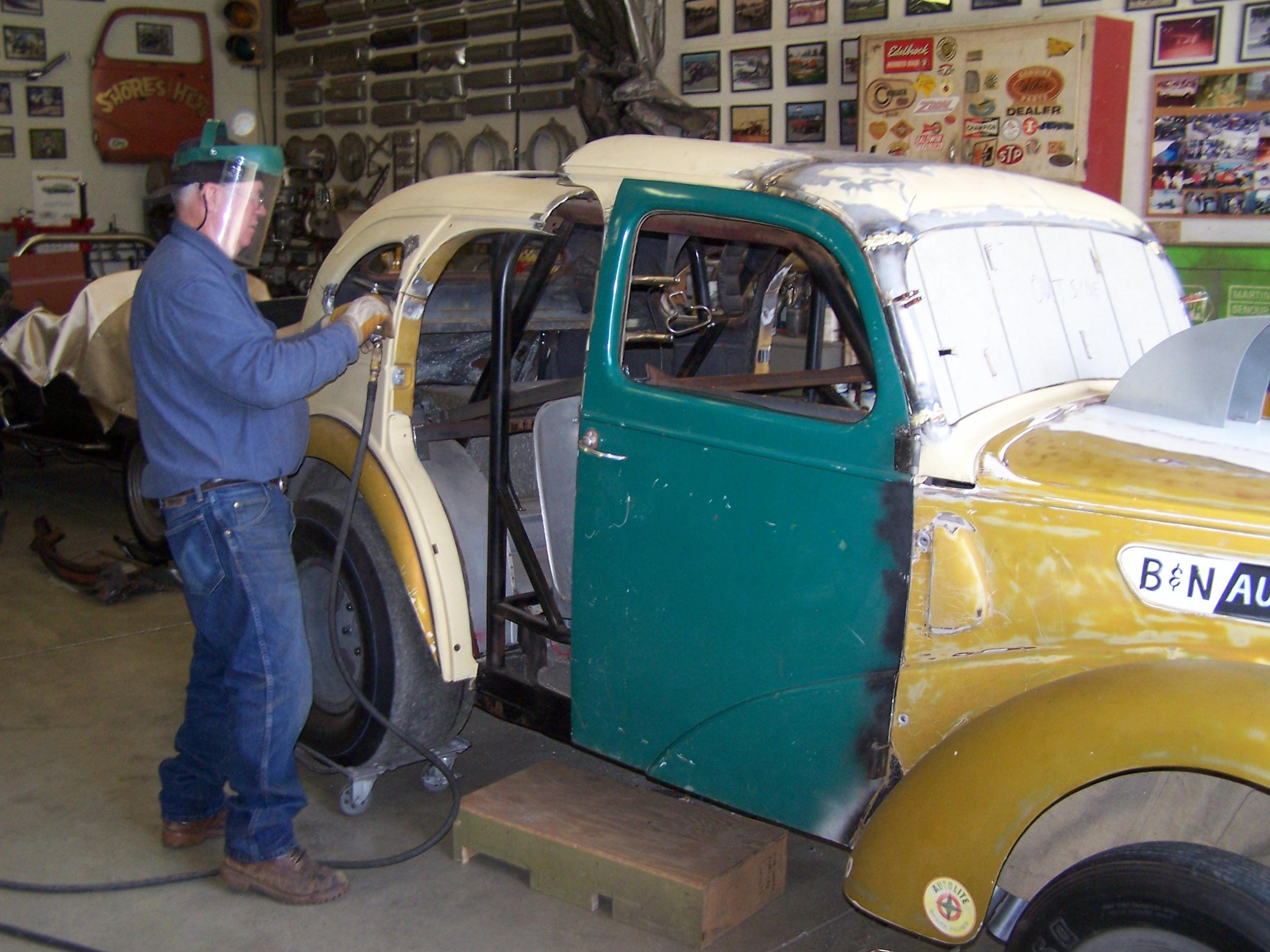

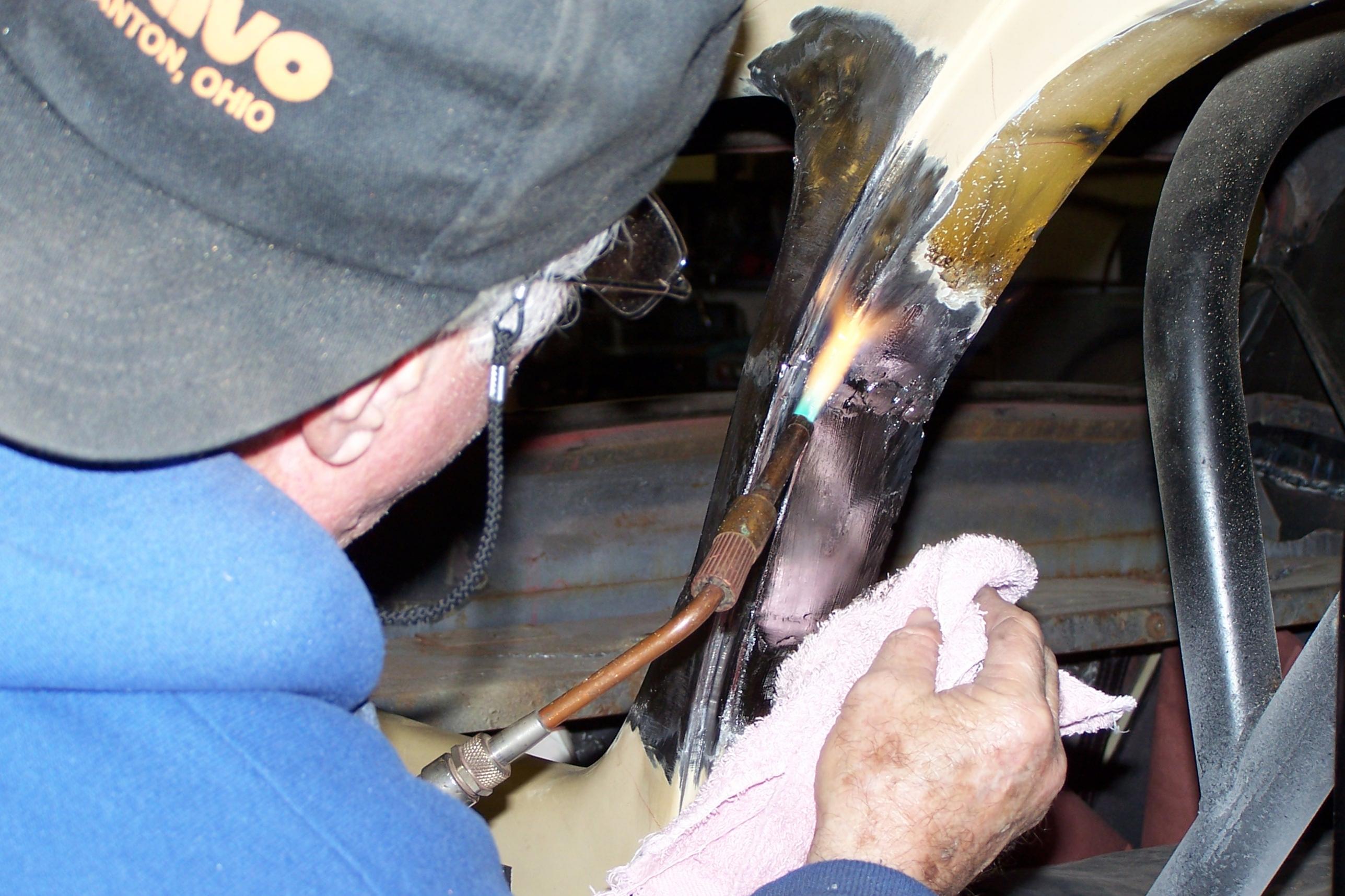

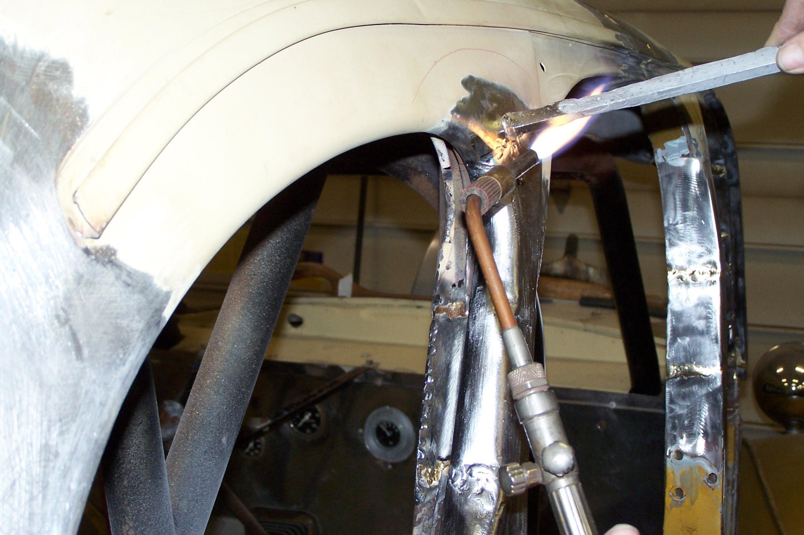

  14. careyohio
    Joined: Jun 6, 2008
    Posts: 410

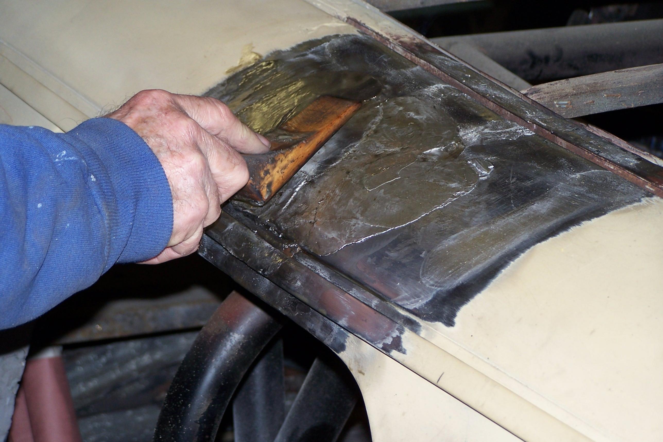

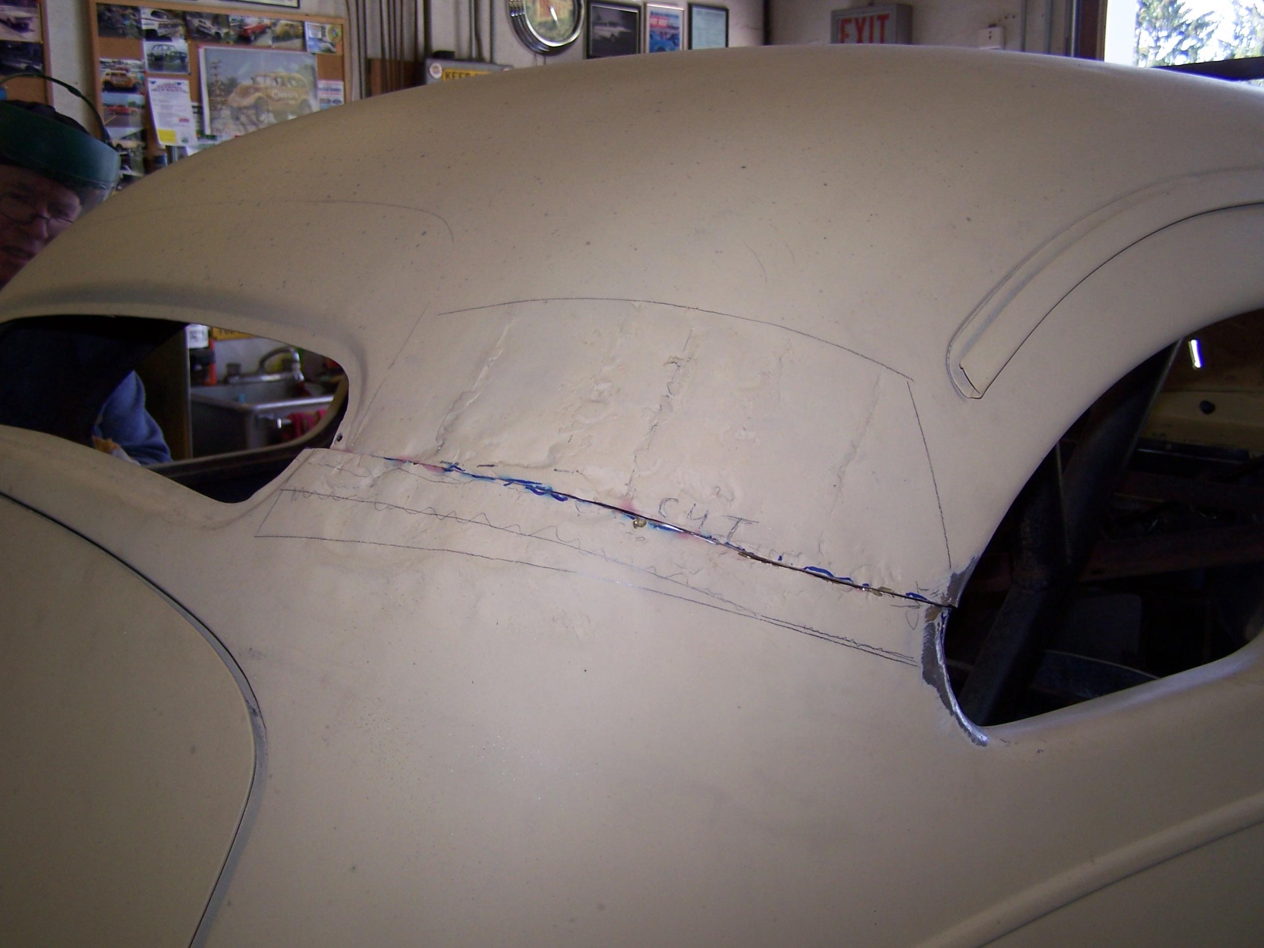

    careyohio
    Waxing the lead paddle .......
    Leading the post.......

    I use to watch my buddy do lead ,it's almost a lost art ,i always wanted to try it but i was afraid i would have more lead on the floor than the car:eek:, nice work==Jack
  16. careyohio
    Joined: Jun 6, 2008
    Posts: 410
    careyohio
    Everyone drops a lot of lead on the floor when starting out, even me when I first started , but the good thing is you can sweep it up, melt it and recast it back into sticks and reuse it.

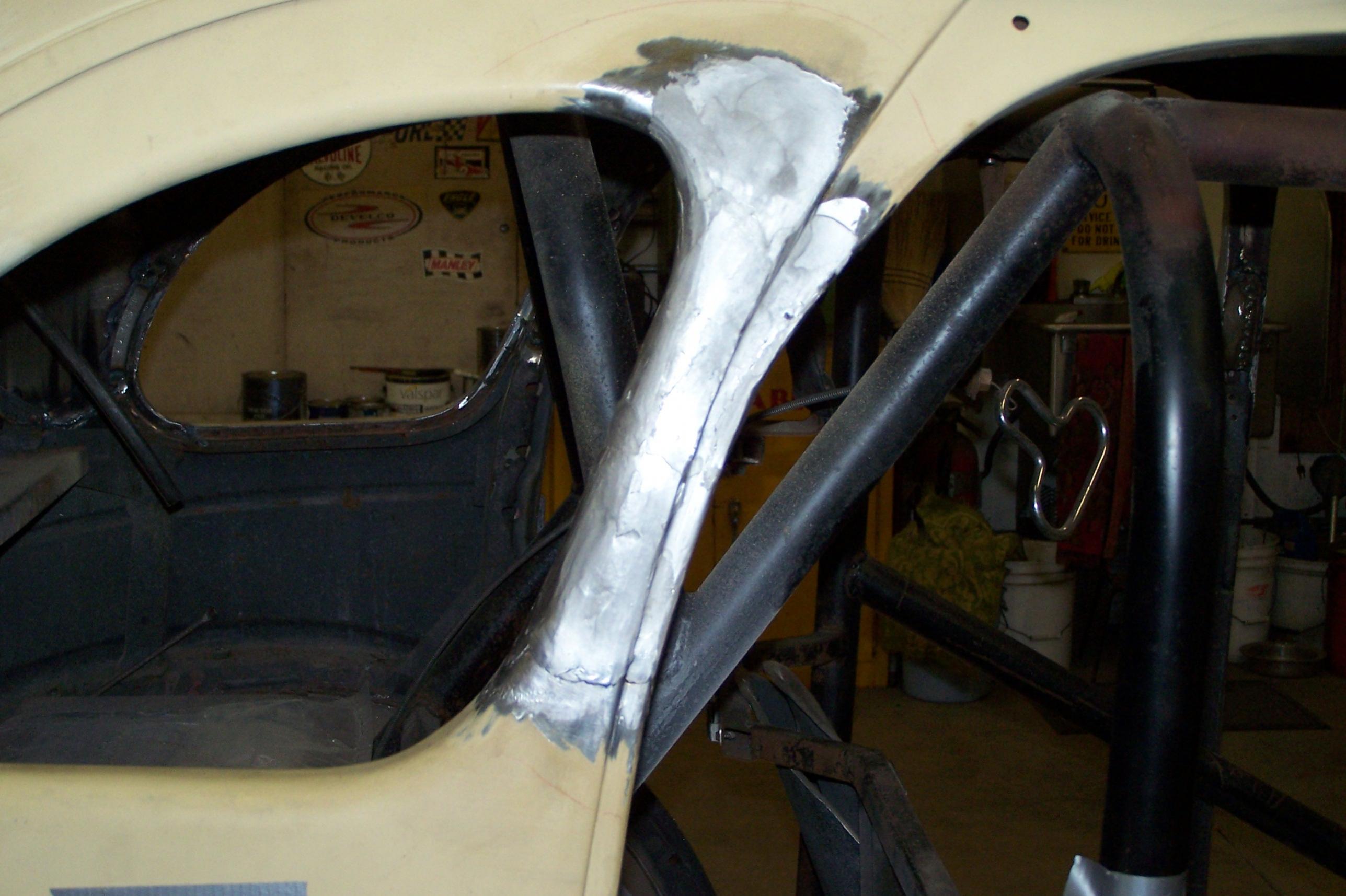

  18. careyohio
    Joined: Jun 6, 2008
    Posts: 410
    careyohio

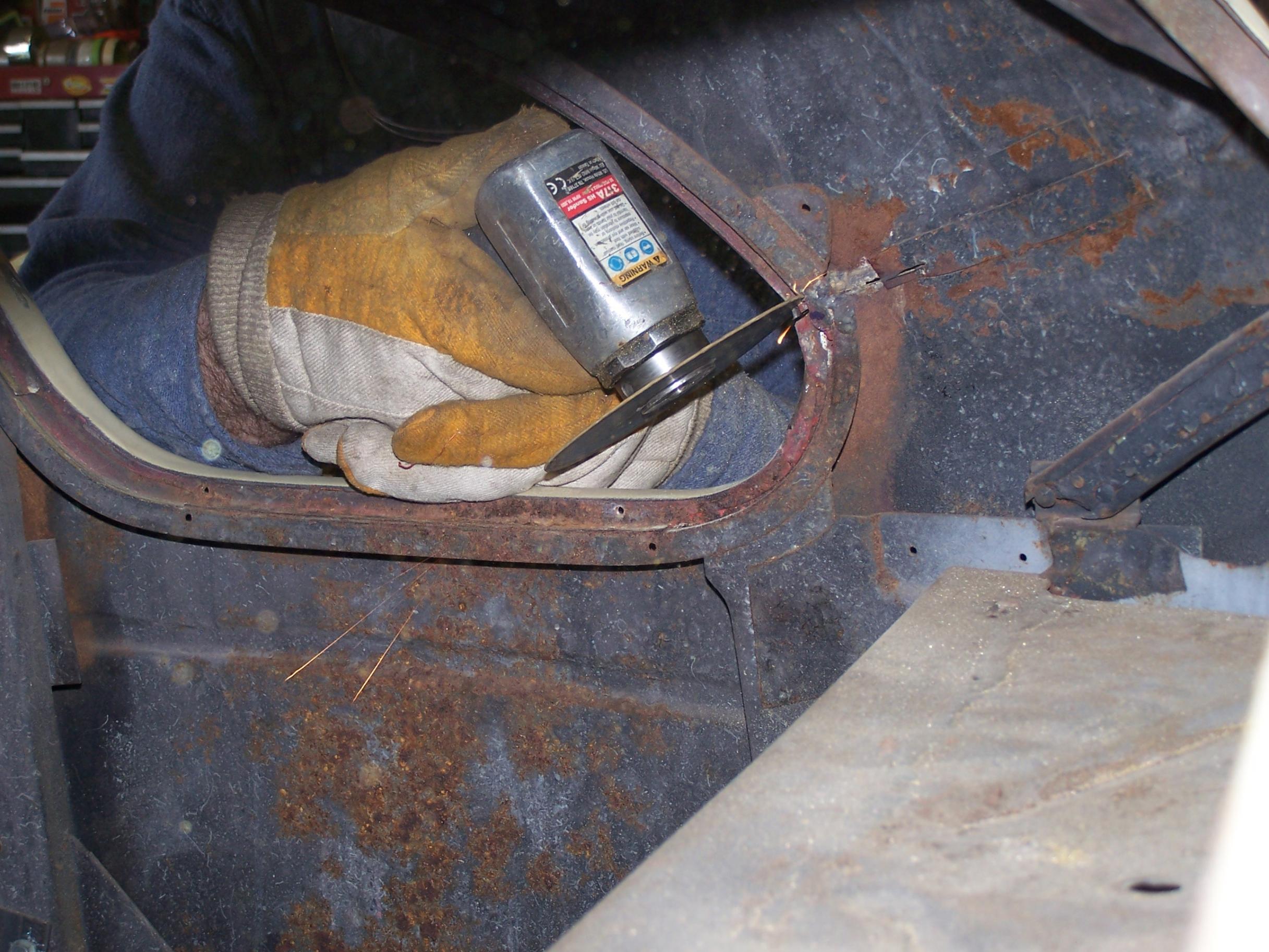

    More........
  19. careyohio
    Joined: Jun 6, 2008
    Posts: 410
    careyohio
    More..........

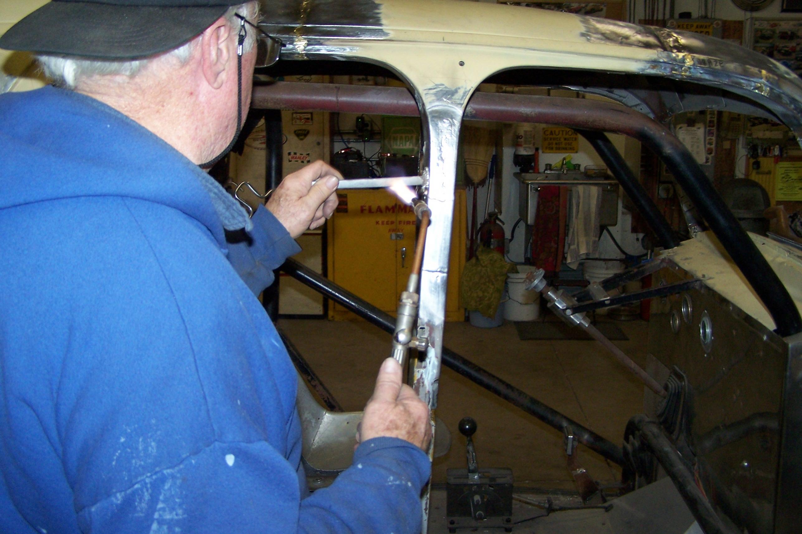

  29. Dream-on
    Joined: Nov 29, 2010
    Posts: 5
    Dream-on

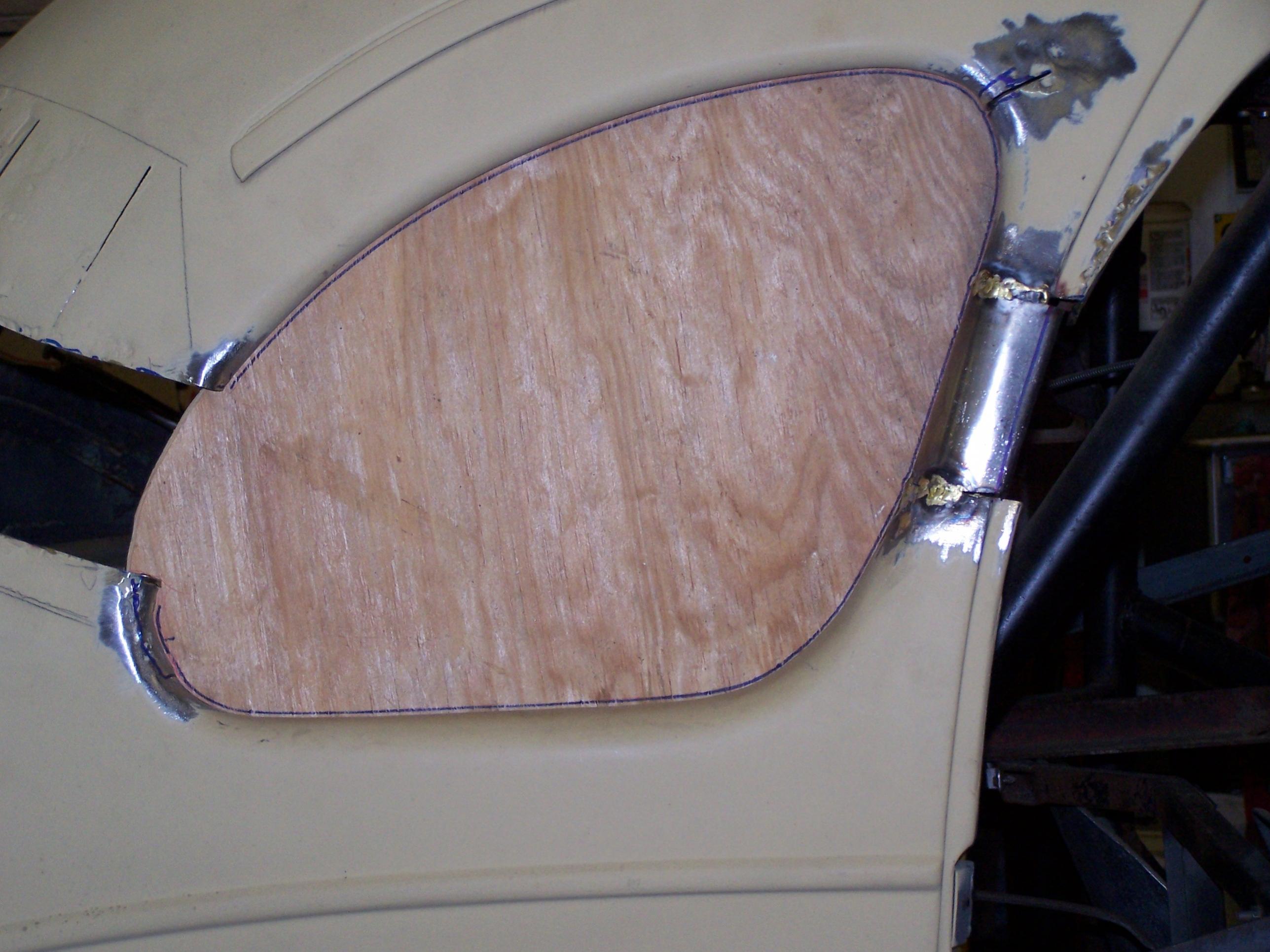

    Hey guys looking super great!!!..if I may put my two cents in as far as your using brazing as your median for welding. Have you ever considered using Silicon bronze wire with either Mig or Tig ? What is nice with that wire is it allows you to use less heat and it has lower tensel strength so it is easier to hammer out your welds, further cutting down on time it takes to finish and probably also would not have to use as much lead and the time it takes to get to primer.

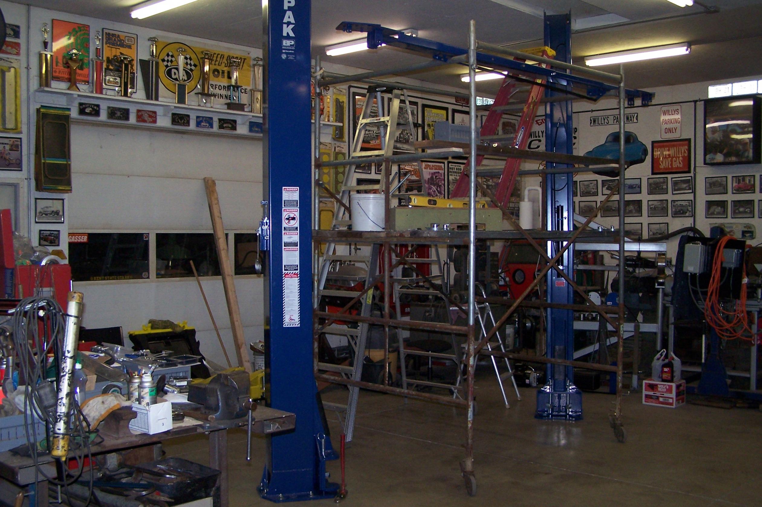

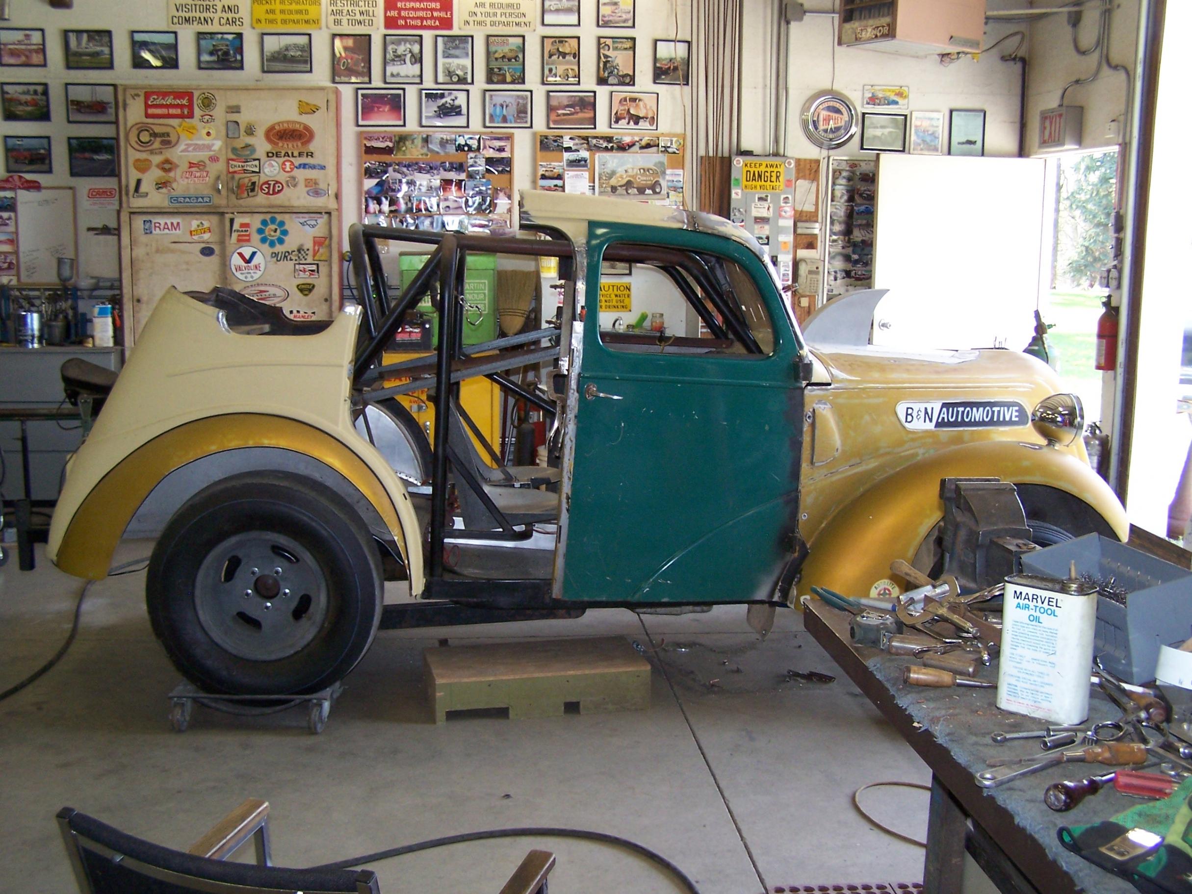

    We had to stop work on the Gasser Passer for a few weeks so we could install a new lift.
    A lot of work but it's going to make getting under cars a lot easier on my old bones.
    A couple more days to finish the lift, then back on the Gasser Passer.
