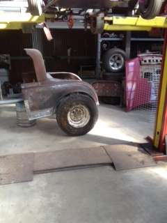

  12. jdownunder
    Joined: Aug 21, 2007
    Posts: 334
    jdownunder
    coupe.JPG a little mock up so we can see where this build is heading coupe.JPG

  18. jdownunder
    Posts: 334
    jdownunder
    man this has been alot of work i cant blame you for taking the easy road
    as for model a cowl i woudnt fit in a chopped an channeled a
    ill try and update weekly. i at least do one to two hours a day on it
    figure i have to. i want this badly!
