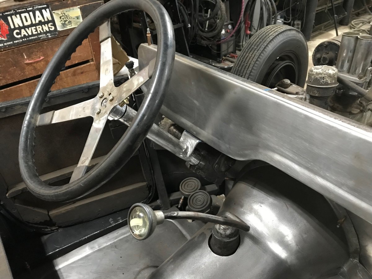

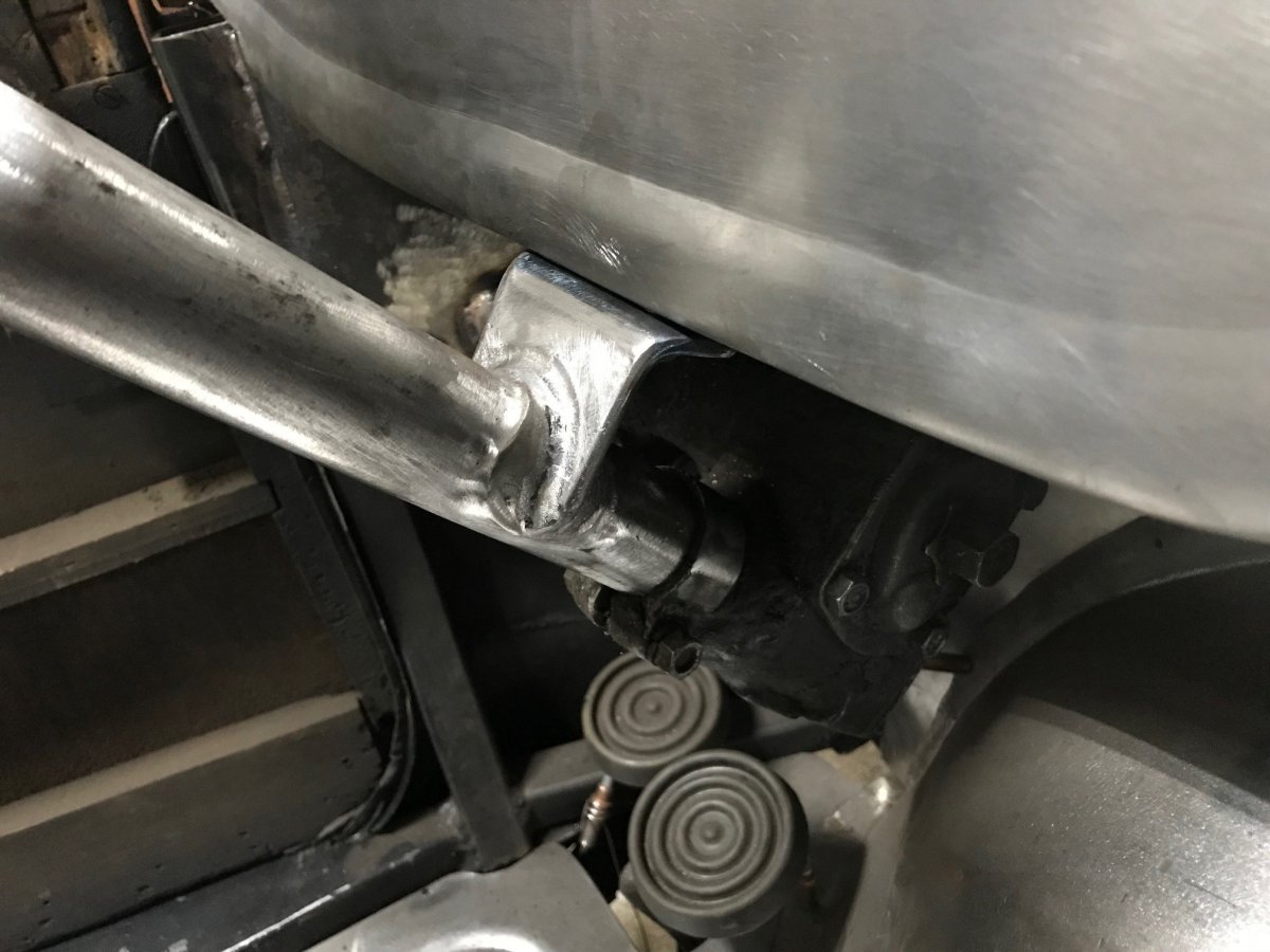

    Been busy doing small odd jobs to the car the past couple weeks. I made some side filler panels between the body and turtle deck and I finished up the Header to frame braces/mounts. I decided yesterday to whip up a quick steering column brace/mount. It still needs some blending and a quick pass through the blast cabinet, but I think it is a cool, simplistic design.
    column_drop6.jpg column_drop5.jpg column_drop4.jpg column_drop3.jpg column_drop2.jpg

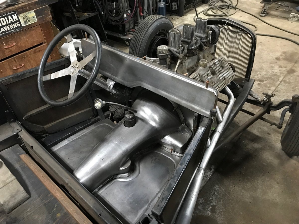

    The floor blows my mind. Tremendous use of a tiny space.

    If you had the T column you could run the original gas lever doesn't look like room for a pedal in there;)

    The pedals are all the way down in the first photo. The indent in the tunnel I made allows for a spoon pedal and your toe to operate the throttle like standard. Stuff is a little cramped using the earlier cowl, but I tried to make the best of it.

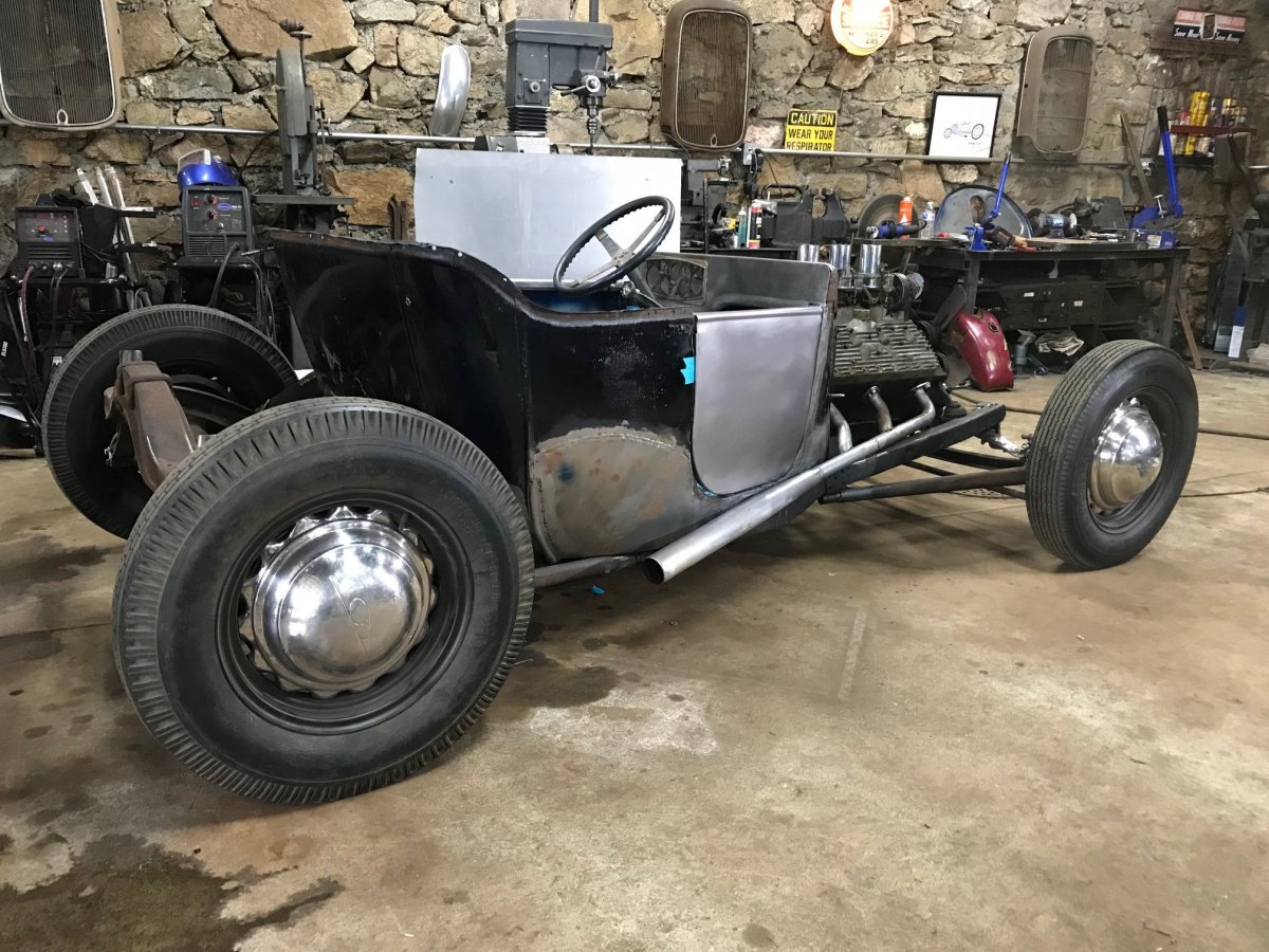

    I decided to skip rushing to get this done for this season and keep building the car to my vision. I recently got both doors I built 99% done. A lot of work to make them latch and hinge smoothly without flexing. I will say I'm super happy with how they latch and shut now. So solid! I'm now on getting stuff like the dash, firewall, and floors/tunnel welded in place. Soon I can separate the body from the frame and start finish welding everything. Custom radiator should be back soon and I'm dropping a Merc crank and 8ba rods off to the engine builder this weekend.

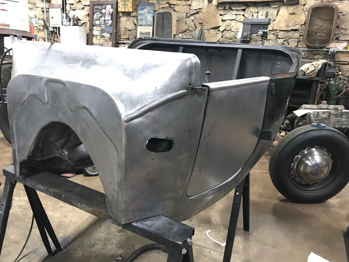

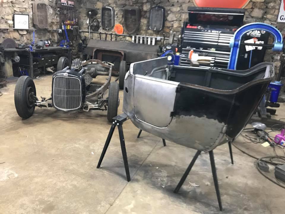

    Finally got the body off and I've been working on getting some of the metal work a little closer. Lots and lots of little odds and end things to do like welding seams in hidden areas and stuff I jumped over to get the silhouette of the car done. This is the crap that stalls a project but I'm going to try and get a least something small done every evening if I can. My buddy Mike that has been helping me with the car has been working on filling old rivet holes in the frame and getting boxing plate patterns made. Trying to stay productive!
    Also finally found a local crank grinder so I can get the Merc crank for the engine cleaned up. That has been a saga all unto its own!

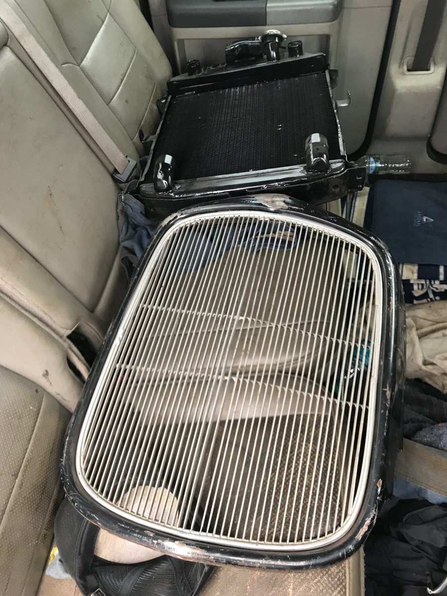

    Got the custom radiator back from Dicks Radiator here in Pottstown. Chris is always down to help with my silly ideas and I think we nailed it. Now to make some radiator hoses/tubing to drop the lower hoses down. Almost want to bolt the grill and radiator on and put the body back on to see it all together for the first time in a while!
    Some pics for now.

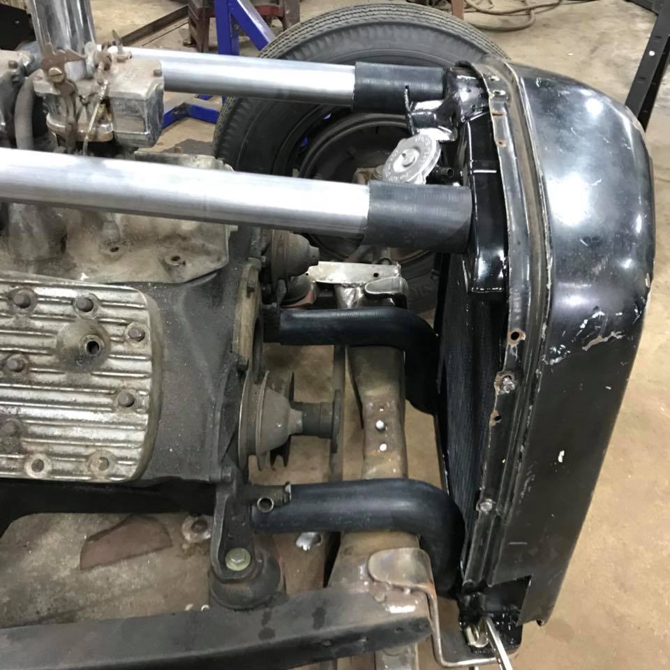

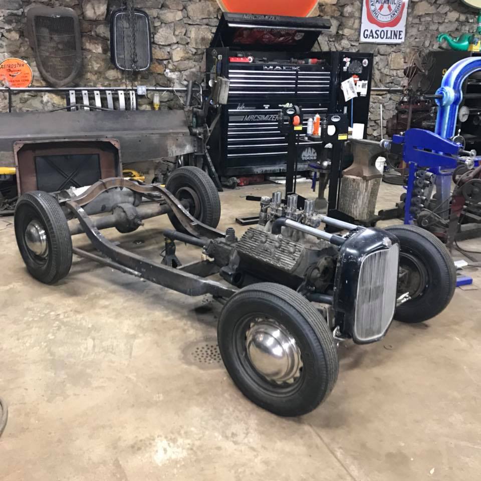

    Below are some photos of the current scene at the shop and the radiator mounted up with some formed hoses I found after hours of google searching. Should work pretty well and is a little cleaner than the typical ribbed bendy-hose you usually see.
    chassis-radiator4.jpg chassis-radiator3.jpg chassis-radiator2.jpg chassis-radiator.jpg
