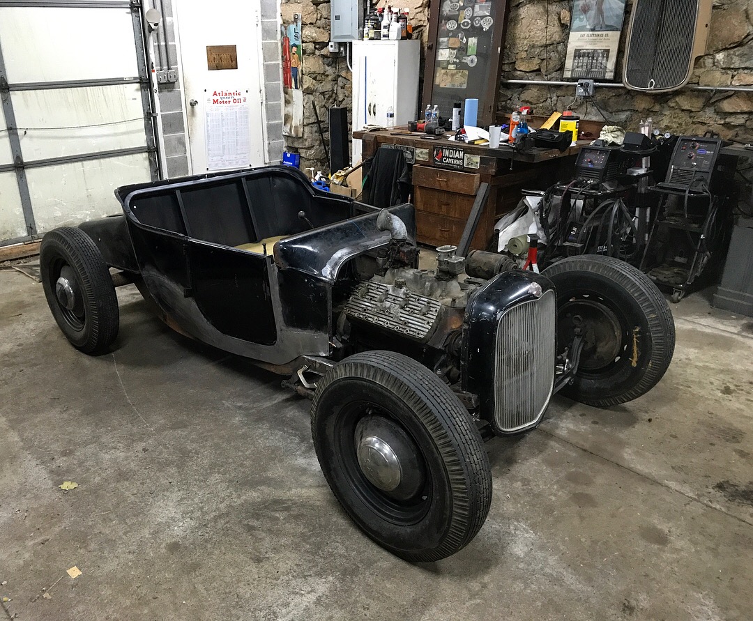

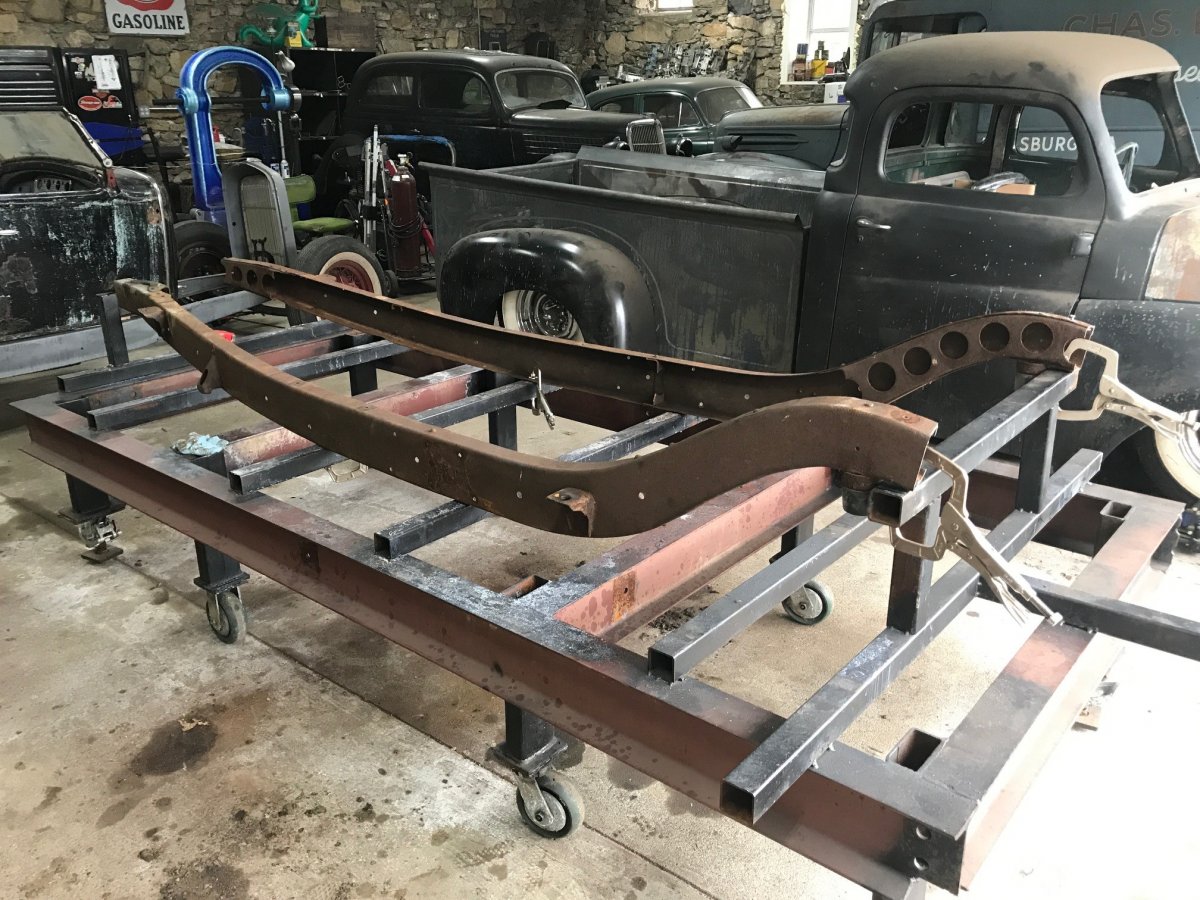

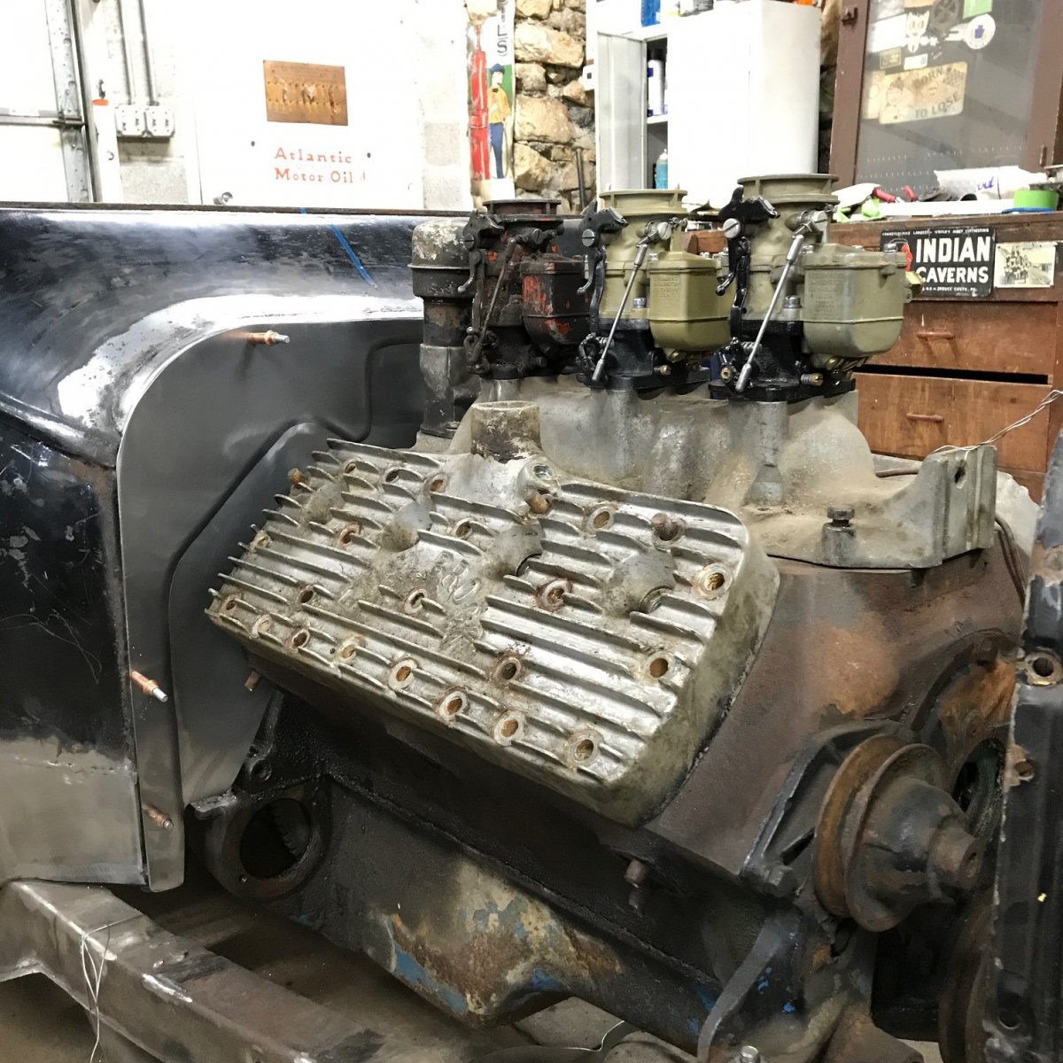

    Started with a free cast-away early Touring body, threw away the center section, slid the rear seat forward. Shortened a set of 46-48 Ford frame rails out of my scrap pile, and built them up with Model A cross members. Made new door jambs, "rocker" and rear side panels to connect it all together. Added a Flathead v8, make cowl steering out of an F1 steering box, etc. So far with horse trading and buying/selling stuff the car is 100% free so far. I'm trying to keep the cost down as much as possible using extra parts and cast away stuff I have sitting around the shop. The engine rebuild and stupid stuff like brakes, bearing, etc will blow that out of the water, but it still should be pretty low-budget when done!
    Hoping to have on the road this summer. Figured I'd give a cliff notes version of the pics below. The full build has been documented on my Youtube channel linked in my signature. Thanks for looking!

    Man that was a great body to start with!

    I should have dropped that info in. The body was from a horrible hack job restoration and thrown in a museum with ropes around it. The car was 80% fiberglass sheet laid over the rotten metal and then bondo and shiny black paint. The center section was fiberglass sheet about 10" up the sides. I had to cut all the way up to the wheel well beads out of the rear sides of the car and it needs about the bottom 6" of the back part of the body replaced. Believe me this thing was not "mint" just shiny! If you watch the first couple videos on it we show just how bad it really was!

    Great project! Coming along nicely, I like your use of the later frame.

    Nice job on the frame rails. I love the shape.
