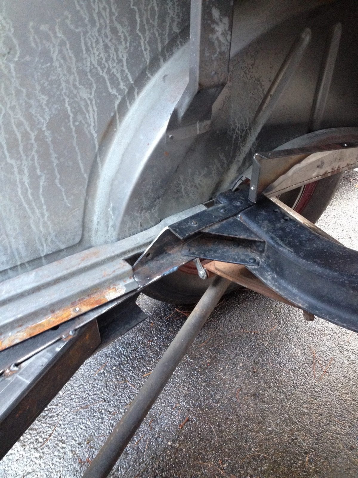

    We had some time yesterday to to trim the box cross member to make room for the S-10 tranny tail shaft and make a rear K member. Mike wanted to use beefy 2X3 rectangular tube stock and slide the rear portion inside the frame. I'll reinforce the areas that were removed for the tranny later. We also made the dropped tranny mount using 1X3 tubing. Rather that cut the tube and weld each piece we figured out the drop and the width, pie cut the top and the two sides, than we bent the tube and closed the gap leaving only 3 sides to weld.... Just need to drill a few holes and the mount will be done.

    looks good, are my eyes not seeing right, or is the rear bottom edge of the rail removed? Can I see the garage floor?
    I like that your using the original centre member but beefing it up, thats cool

    Your eyes are correct.... That's all going to be plated, boxed and welded.

    The body from brookville is set up for either stock model A or a 32 frame. Our frame is Z'd so we had to trim some of the sub rails as needed. We also added a new cross brace which replaced the one that was removed.
