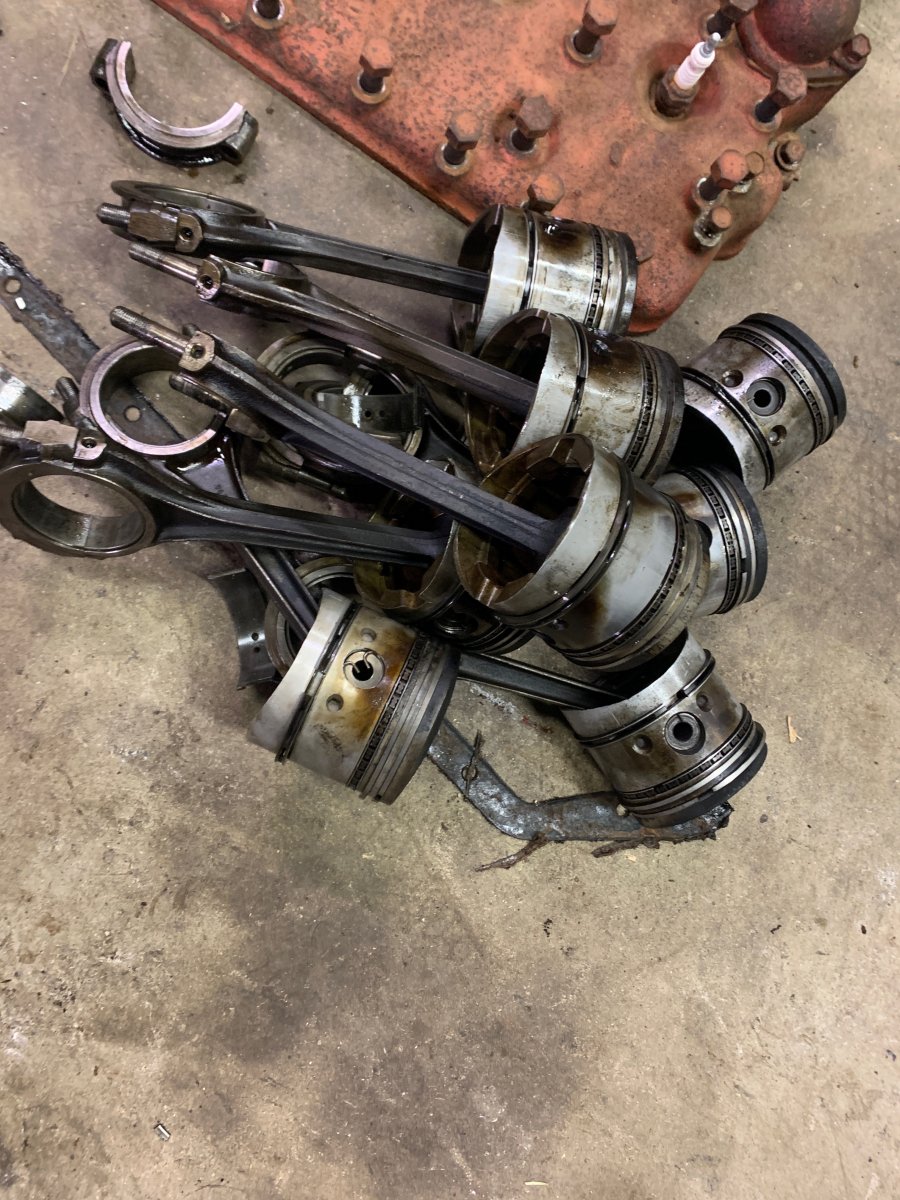

    IMG_0735.jpg IMG_0736.jpg IMG_0737.jpg Anyone can look back and see the other posts of mine about this '48 flatty. Plan on rebuilding and putting it in a '29 Coupe. Here's what I dug down into last night. The pistons are shot, they are cracked, gouged and the ring lands are wayyyy out of spec. The rods ends are egg shaped and the studs are spread out. All of hat is okay since these are available aftermarket. The good of all this is carnage is the crank. It appears okay and should clean up nicely. Any flathead connoisseurs in the central Jersey stop on by the beers are cold.

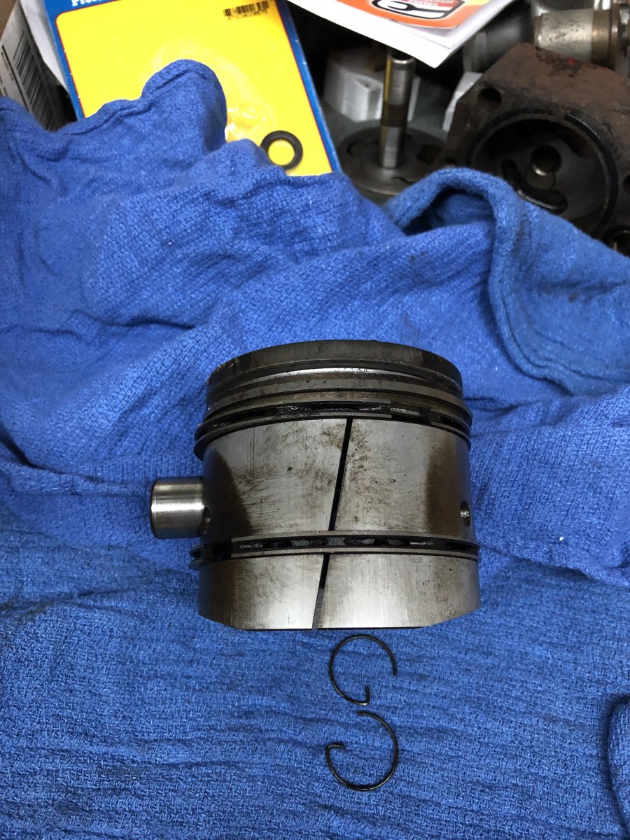

  2. 2AC35D6B-B84F-44BB-82E9-D670642682A6.jpeg Now,,,when you say the pistons are cracked,,,are you talking about the diagonal expansion groove in the skirts ?
    And the studs on the rods will spread apart a little after use.

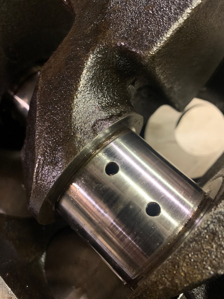

    And you are right,,,the crank looks really good if all the other journals look the same .

    No the cracks are around the ring lands and just below the wrist pins. Before I took the caps off they were really loose. Think farmer
    Ted who had this before just threw in some bearings but never checked anything else. I’ll grab some pics.

  5. Take some pics of the crank too,,,,after all these years you never know what you might have.
