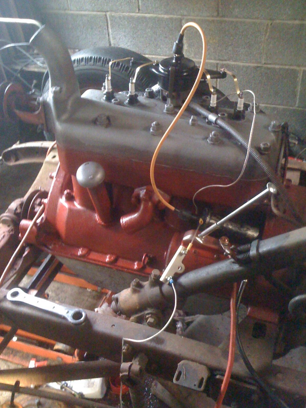

    ok Im finally in. I got a chance to look at what I bought and play a lilttle. had it for a few weeks. big learning curve here. I got it fired today. 29 chassis. putting my 31 roadster body on it. early 40's style. I will have a bunch of questions

  13. Here is a possibly premature answer. The 28 29 frames are different from the 30 31. Mainly the front crossmember. On the 28 29 the small area where the radiator pads are located is raised and if you put a stock 30 31 radiator and shell your hood won't fit correctly. Ask me how I know. What I nave done is have the radiator shop change the location of the mounting brackets up slightly and I plan on adjusting the hood fit by shimming the radiator up.
    Some people just modify the front crossmember. cut and weld a lower piece in. I have seen one where the guy just heated it and hit it with a big hammer.
    You know "If it don't fit get a bigger hammer"

    ha ha ha found that out this morning. I think I will just run a 28 rad. that should work?

    The radiator and shell are different in height between 28/29 and 30/31.
  16. You will probably lose the "LINE" plus the 29 probably has a different radius or curve so won't fit 30 31 cowl. Maybe just leave the hood off but "they" will point and laugh anyway.
    The easiest thing is to modify the crossmember unless you are building a "RAT Rod" and don't give a sh-t. or don't have a 30 31 radiator. I have 2 and several 30 shells. I imagine you are too far away though to benefit from my generosity!

    i have 2 31 surrounds and one 29. I have a 29 and a 31 rad. will the 29 rad fit into the 31 shell and look ok?

  19. No and no.
  20. I was gong to say just give up but the PC police get pissed if you leave smart assed answers so I didn't. You are asking about 2 different cars although they are both model "A"'s there were changes to the bodies and radiators and their shells. You can make the parts fit I suppose but not very well and you will have a lot of gaps. I have a late 31 coupe on a 28 29 frame so I know of what I speak. The hood never fit right for the previous owner and he told me that he had been told they were all the same and it just needed to have the front of the body raised, problem there is the doors don't want to close ETC. ETC. ETC.

    The only real issue is the front cross member, why not just replace the 28-29 cross member with a 30-31 cross member and be done with it? Then use the correct rad and surround for the year of the body...It all looks ugly otherwise.

    thats what im gonna do
